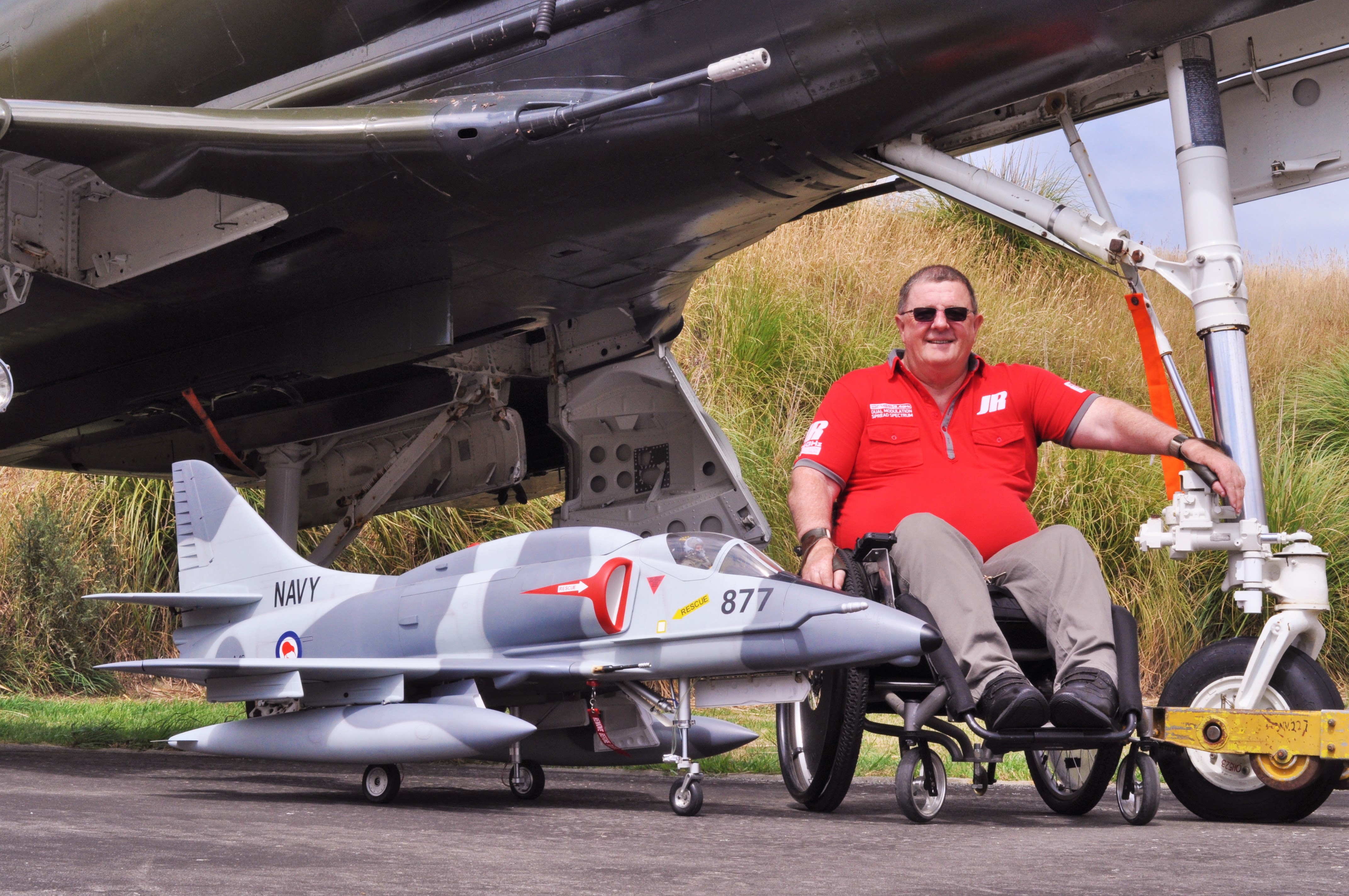

kiwijet 01-16-2016 01:16 PM
1 Attachment(s)
Whilst not a CARF A4 thought I would share my experience with the SM A4 hyd nws as mine works a treat.
I couldn't get rid of bubbles so swapped the supplied rams out for UP10 5/16"x 3/4" air rams which worked great. I used Tamiya #500 grade silicon damper oil (green) as fluid. I tried all the different Tamiya grades but the 500 viscosity worked best, tried other fluids as well.
The single UP ram at the servo end is driven by an 8511, to avoid sudden load on the hyd system and servo I run a 1.26 sec servo slow on nws which gives a smooth progressive feel and makes the taxi look great.
As a matter of interest my aircraft weighs 19.90kg fully fuelled and on the Xicoy balancing scales shows a weight on nose wheel of 5.266kg.
So...probably no help in solving the CARF issues but gives some insight into the fact hyd nws does work with a bit of tinkering and experimentation.
