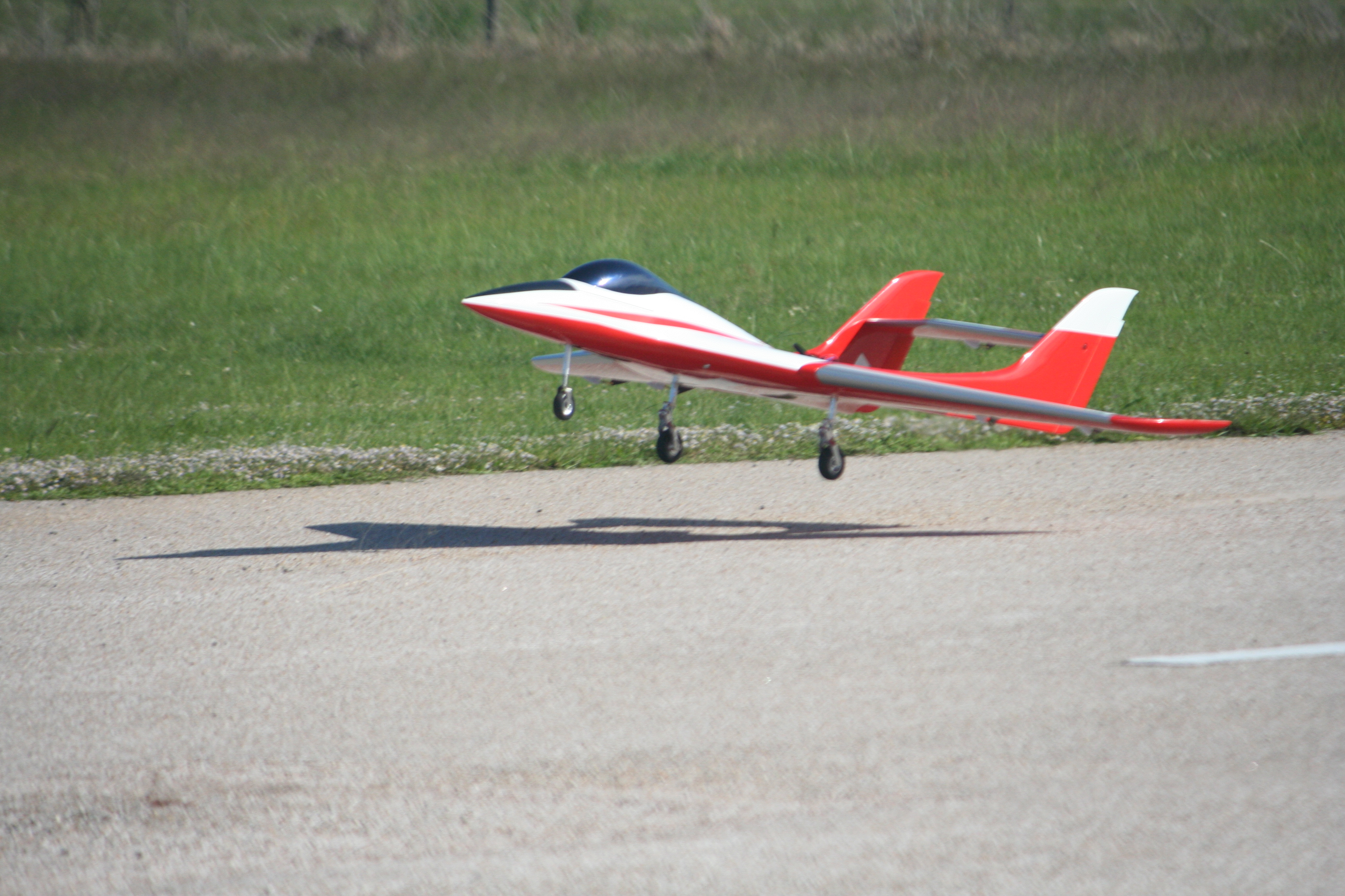

Pantherman 11-12-2013 06:50 AM
9 Attachment(s)
Congratulations Joe! It was great to see you get her in the air. I took a few pictures of your first couple of flights. Enjoy and let me know if you need anything else. Oh, and I have your rudder tabs when you are ready to start hovering! ;)
Woody
