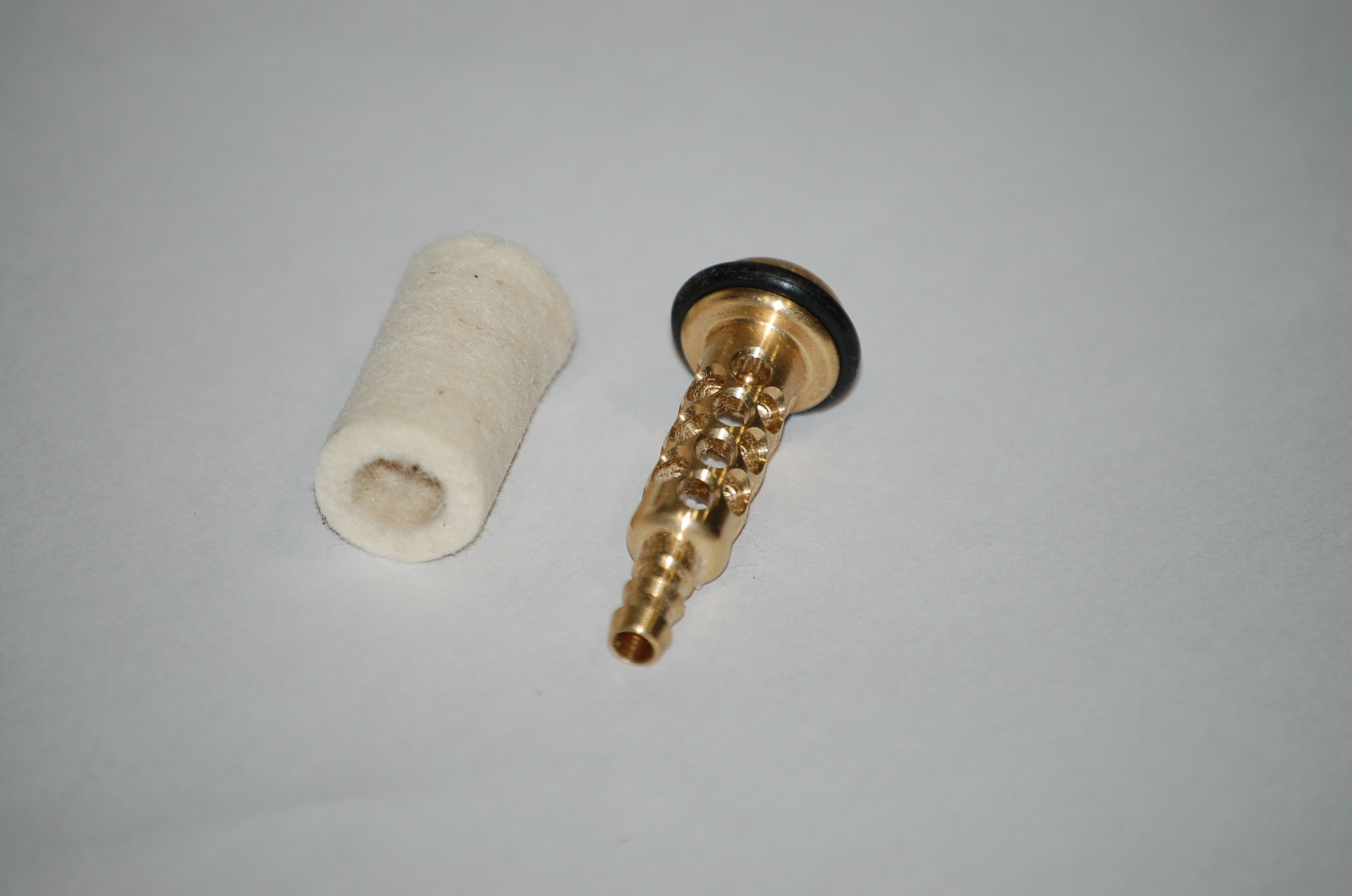

Dave Wilshere 11-06-2013 11:42 PM
1 Attachment(s)
Dr Honda is nearest. It should never be thought of as a filter, its like people who don't fit filters because of having a UAT!
Its biggest plus is the sponge affect and it allows moments out of the fuel with fuel being drawn from the felt (like in a low power dive) Tillotson clunks need the centre hole drilling out to 2.8mm, or we use our two sizes of Hi-Flow clunks.
The thing with most dubro tanks is that they are long and thin, so a felt clunk is ideal.
(Before installation attach a piece of tube and suck the loose fibre out and they run for years without issues)

Dave Wilshere 11-07-2013 02:09 AM
My fuel system has no dirt in it...so I fill through the bubble trap without a problem.
You will have to have something made at that weight, even our heavy std clunk is less than 20g

Dave Wilshere 11-07-2013 11:29 AM
All this talk of adding dirt! I have never changed a felt clunk or cleaned a fuel filter in 10 years. Not one. If your fuel has dirt in it, filter in more, if you tanks have dirt in them clean them before use (blowing glass tanks out with an airline will not clean it!)
Fuel from my MAP header tank is flushed through the inside of my felt clunks. I can count my flame outs, its a binary number...
I don't think of a felt or paper clunk/tank as a filter unit....its not.
Dave Wilshere 11-07-2013 11:58 AM
Sorry missed this!
Dave, thanks for your answer. You know if is necessary install 6mm tygon into the tank ? Or 4mm is enought, because the 6mm tygon need a lot of weight for move free the clunk. For big turbines of course.
Bigger is better, but 6mm o/d 3.2mm I'd is OK up to 160N. Above 160N its better to go 8mm o/d 4.1mm I/d if the tank/clunk is long enough
Dave
