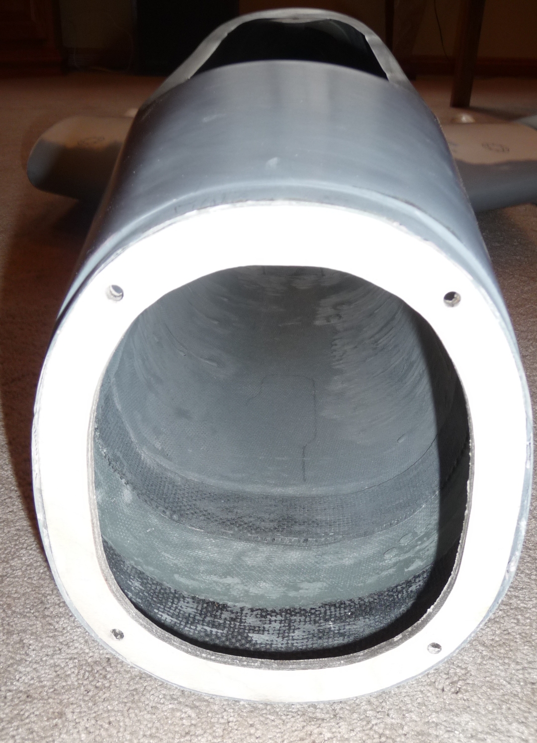

15 Attachment(s)
I would like to thank the gentlemen who took the time to send photos of the drawings and a pdf copy of the manual. It was a great help as I was able to re-produce the wood parts that I needed.
The following is a quick photo view of the progress that I made on the rebuild.
The project started a couple of years ago when my Buddy Jack and I were given parts from a crashed King Cat; so we started looking for more parts. Last fall Jack found some more broken parts on RCU, wings booms etc, he was still missing a canopy and a nose cone. We located gentlemen who had made molds for replacement parts, so Jack was able to procure the replacement nose, canopy and a lower belly pan. Now it was time to turn this basket case into a great airframe again. This is where I volunteered to put "Humpty Dumpty" back together again.
"Humpty Dumpty" missing a section of the forward fuselage, the left side section cut from the original crashed King Cat, this is why it is important to save all parts, no matter how small of piece....
http://www.rcuniverse.com/forum/atta...mentid=1975026
New nose cone, canopy and belly pan fitted up
http://www.rcuniverse.com/forum/atta...mentid=1975027
1/64" Plywood to create a mold for the missing section
http://www.rcuniverse.com/forum/atta...mentid=1975028
Ready to apply glass from the inside
http://www.rcuniverse.com/forum/atta...mentid=1975029
After the glass cured, wood form removed
http://www.rcuniverse.com/forum/atta...mentid=1975030
Belly pan has been tacked in up to this point, removed belly pan to gain clear access to upper fuselage section, carbon fiber and glass reinforcement applied to canopy rails.
http://www.rcuniverse.com/forum/atta...mentid=1975033
Now it was time to join the belly pan to the upper fuselage section, belly pan prepped
http://www.rcuniverse.com/forum/atta...mentid=1975035
Pan tacked in with CA, then fiberglass tape used to join the two sections
http://www.rcuniverse.com/forum/atta...mentid=1975038
http://www.rcuniverse.com/forum/atta...mentid=1975040
Carbon fiber added to areas where the nose wheel formers will be placed
http://www.rcuniverse.com/forum/atta...mentid=1975042
Next step was to glass the outside seams
http://www.rcuniverse.com/forum/atta...mentid=1975046
The next step was to apply the filler, then sand, sand, sand...did I mention sanding.
I forgot my camera so I will need to get the photos from my sons phone to post later.
Then it was time for Primer
http://www.rcuniverse.com/forum/atta...mentid=1975043
http://www.rcuniverse.com/forum/atta...mentid=1975044http://www.rcuniverse.com/forum/atta...mentid=1975045
http://www.rcuniverse.com/forum/atta...mentid=1975069
More later :cool:

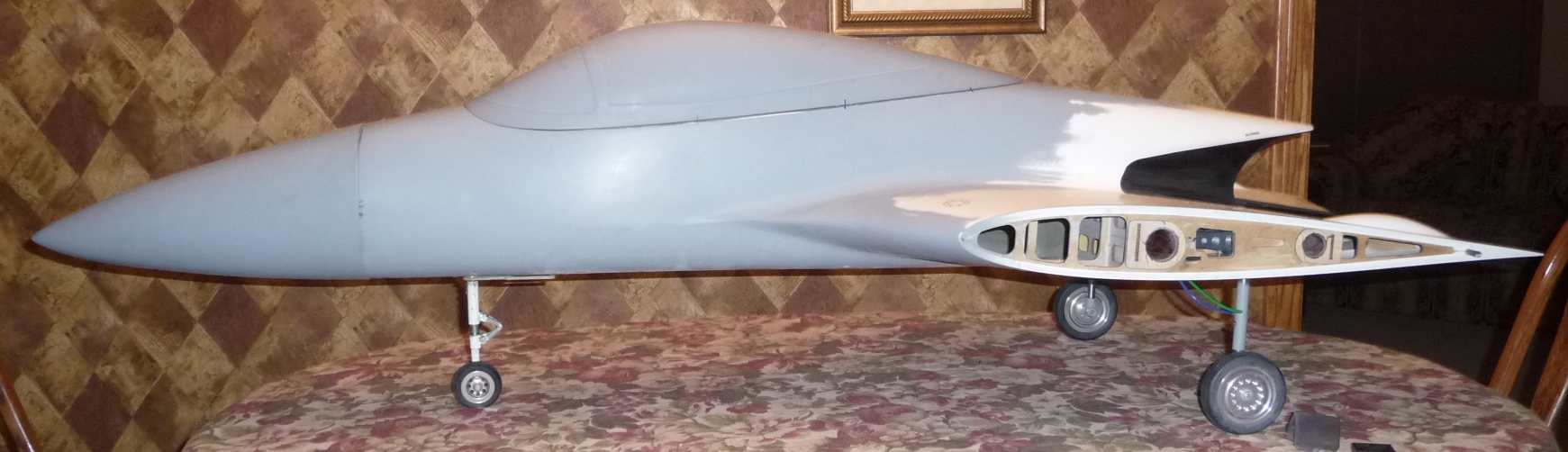

8 Attachment(s)
Some more progress
Retracts mounted, was able to adapt a set of Robart 635's and straight struts for the mains with Intairco 3 1/2" wheels and brakes
http://www.rcuniverse.com/forum/atta...mentid=1980562
http://www.rcuniverse.com/forum/atta...mentid=1980563
Nose wheel with direct steering
http://www.rcuniverse.com/forum/atta...mentid=1980564
http://www.rcuniverse.com/forum/atta...mentid=1980565
Fitting up the wings and booms
http://www.rcuniverse.com/forum/atta...mentid=1980566
New former designed and installed for nose wheel reinforcement
http://www.rcuniverse.com/forum/atta...mentid=1980567
Battery box installed
http://www.rcuniverse.com/forum/atta...mentid=1980568
http://www.rcuniverse.com/forum/atta...mentid=1980569
