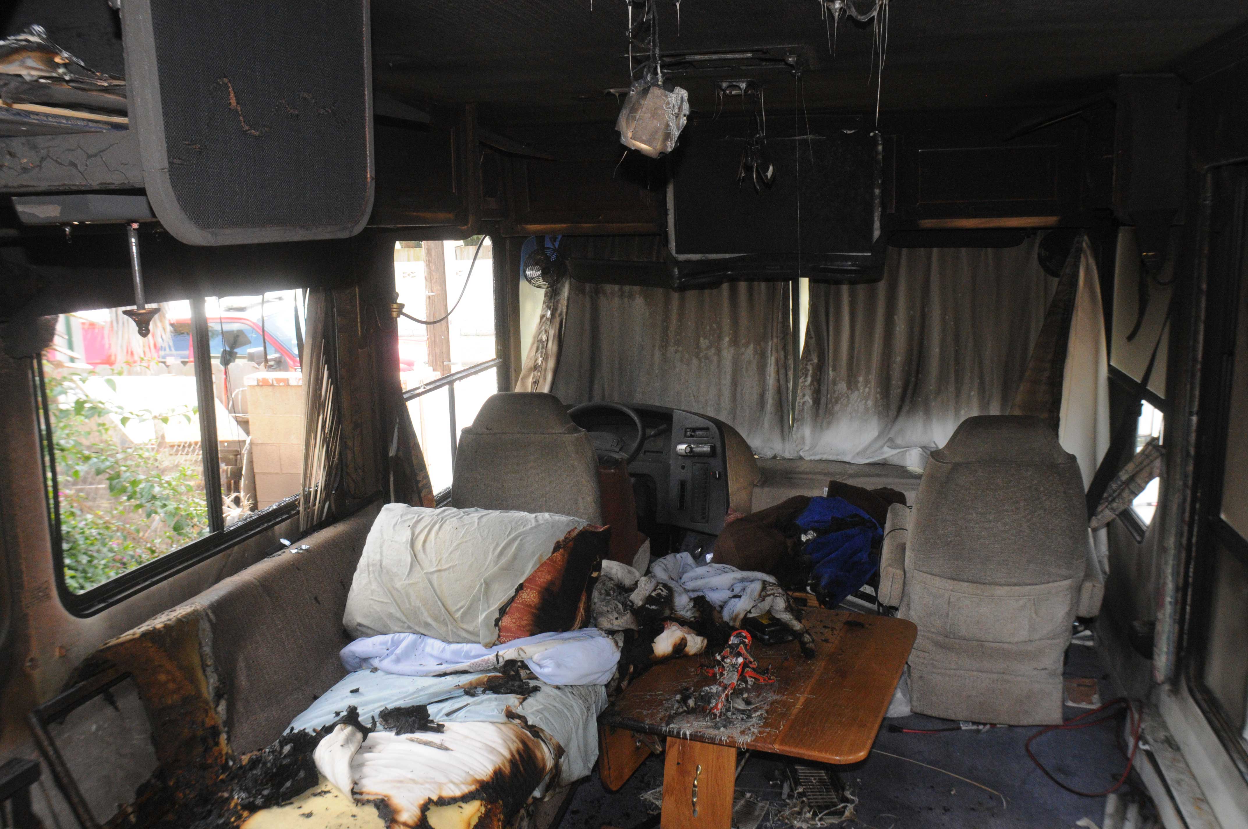

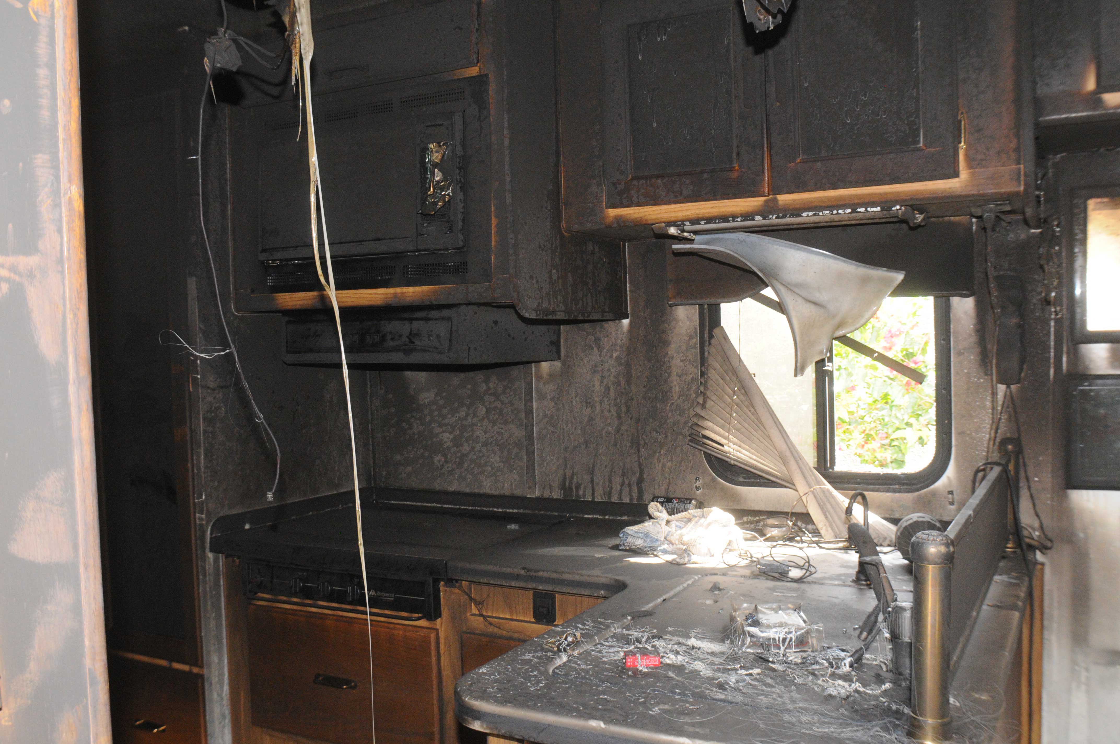

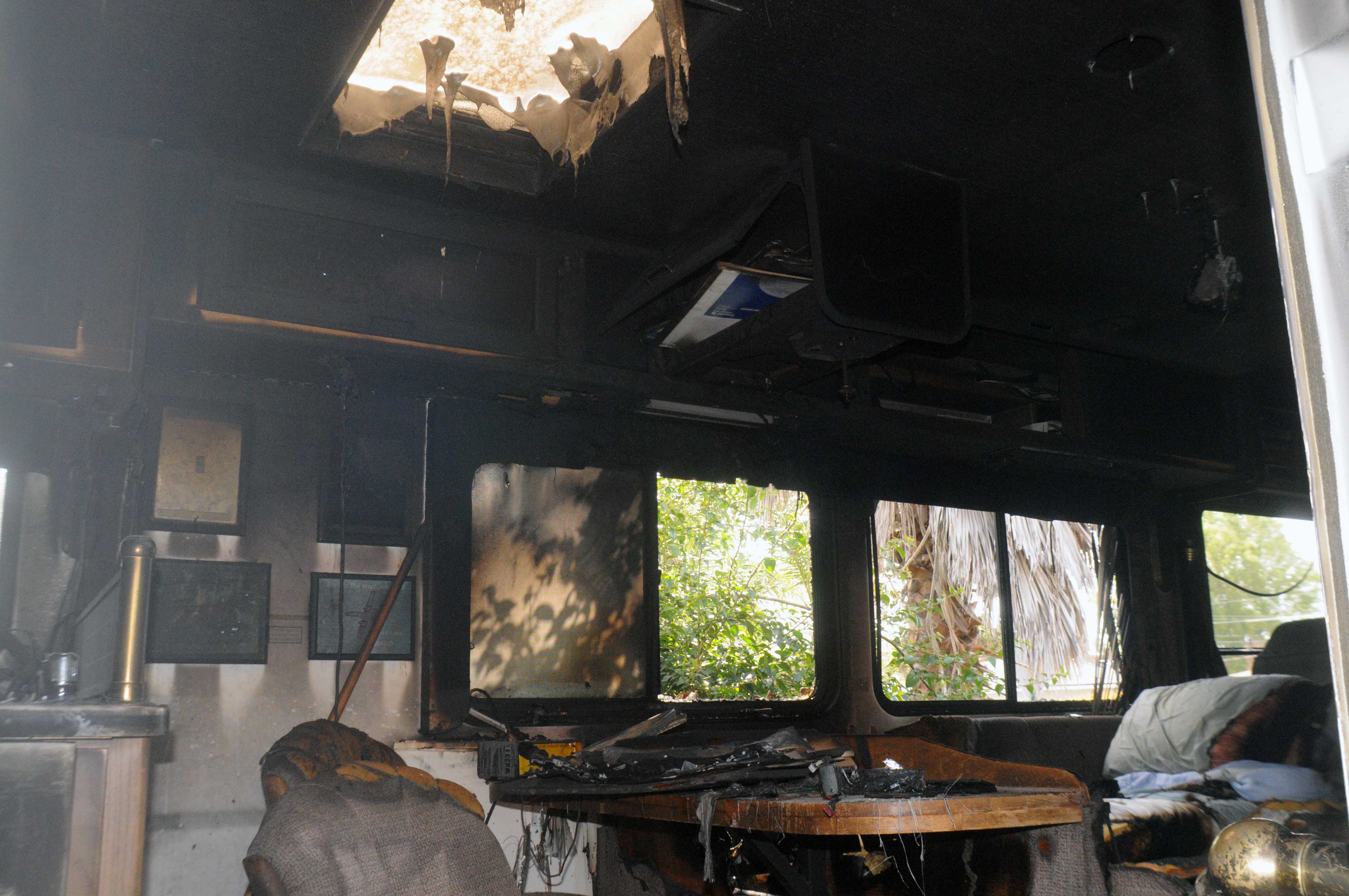

Packing my RV, getting ready to leave for ButtonWillow Spring Fling. I had a couple batteries on charge, so I'd be all charged up & ready to fly upon arrival. Left to go to the store, when I got back the black smoke was billowing out of the RV! This is what's left.

#1 I unplugged the battery just prior to leaving for the store, so they weren't left unattended while charging. Your ASSumption is incorrect. The failure had apparently already started prior to me unplugging it and continued to conclusion in my absence.
#2 I never claimed it was anything else other than my fault. But thanks for your statement of blame, we can all rest easy now.
Scotty,
I assume the battery was bad, as I had unplugged the final battery from the charger before leaving. It apparently went nova at some point after I left.
Raptureboy,
Yes I admitted my mistake in public, now comes my public flogging by those who love restating the obvious. Thanks for your concern.
If there is anything to be learned here, IMO, it is that there is apparently a period after charging that these things can still explode. When I unplugged the final battery I assumed I was safe. NOT SO!
