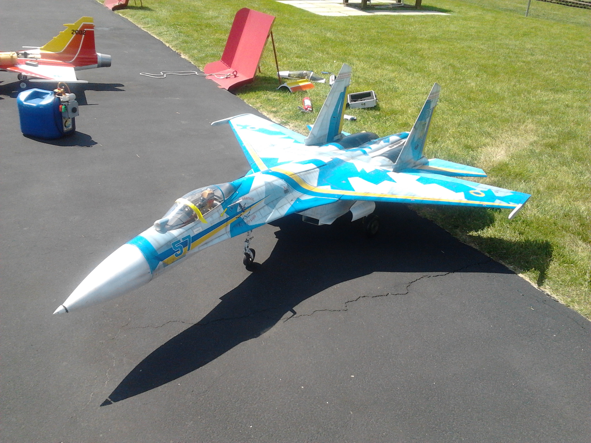

sysiek 06-24-2014 03:42 PM
1 Attachment(s)
No with Nick aviation design su-27 .http://www.rcuniverse.com/forum/atta...mentid=2008566
