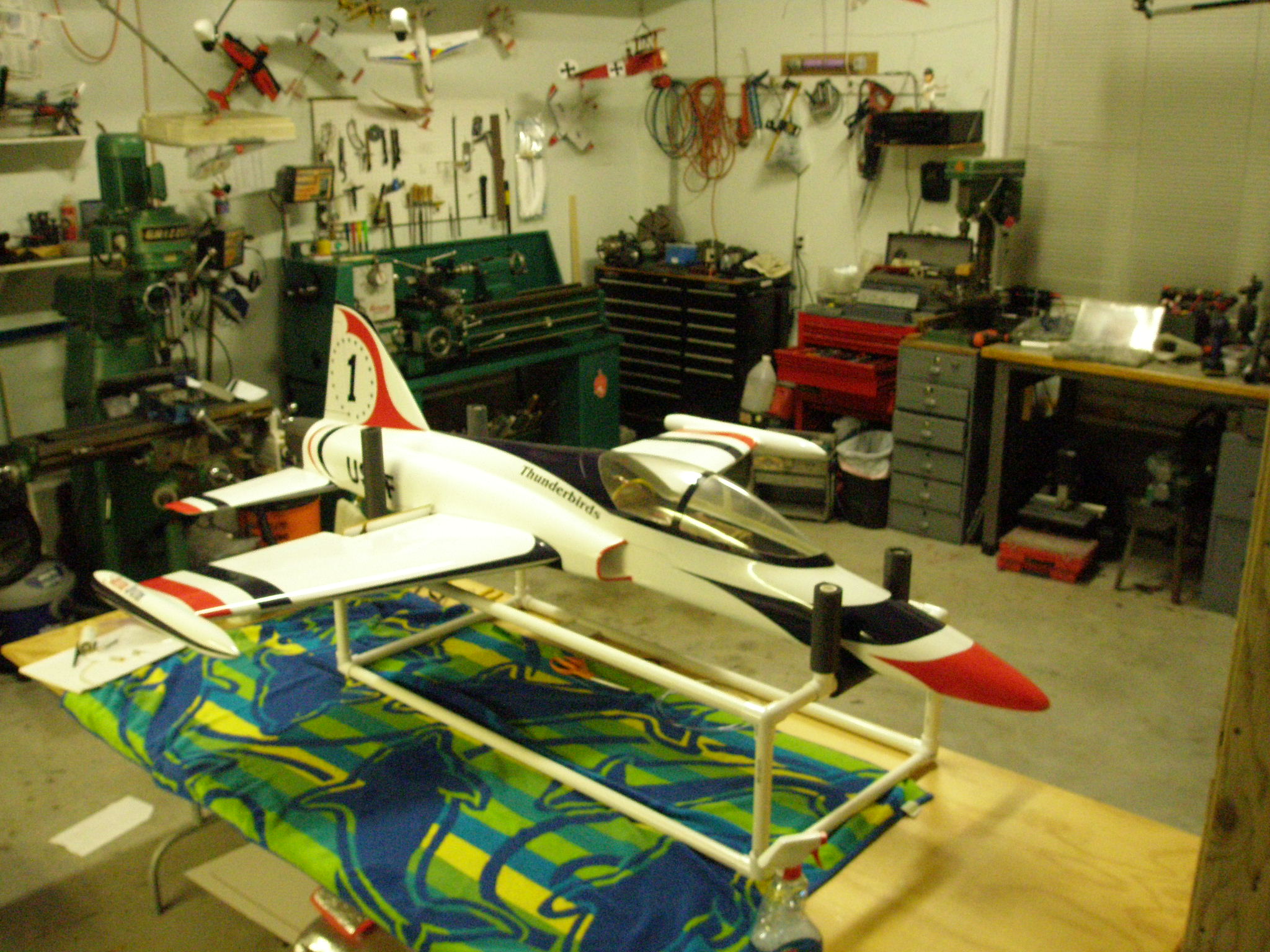

Dr Honda 08-21-2014 11:14 AM
I did that for a long time. I started with the "Import" stuff back when it was still cheap (I got the 7x14 for under $200) And converted the old HF Drill Mill to CNC. Eventually... I upgraded. Then... I left my day job as an R&D Chemist and made my own line of parts. I did that for 8 years, and I was making parts for Billy D (USA RC Jets) and Todd (DreamWorks). It was a lot of fun, but I just recently sold everything, and have scaled back.
Next summer... I'm going to buy a Hass SL10 with milling for the garage.
Anyway... the guys above have you heading the right way. But I will say this......
1) Don't buy cheap tools. They don't cut worth a dam, and leave a poor finish. Spend a few extra $$$ and get insertable tools with industry standard size inserts. That way, you can buy the quality and style you like. (I had a lot of toolmex holders)
2) On aluminum, you want high rake, and high polish on all tools.
3) For end mills (milling) I LOVED the gorilla brand tools. (Silverback was the line for aluminum) They aren't too expensive for the smaller tools, but will last a very long time.
4) If you need something quick... McMaster Carr.
5) Basic stuff can be bought from Enco. PLUS... if you do a search... you can generally find a free shipping coupon.
Up until 4 months ago... this was my "Hobby Shop". (lol)

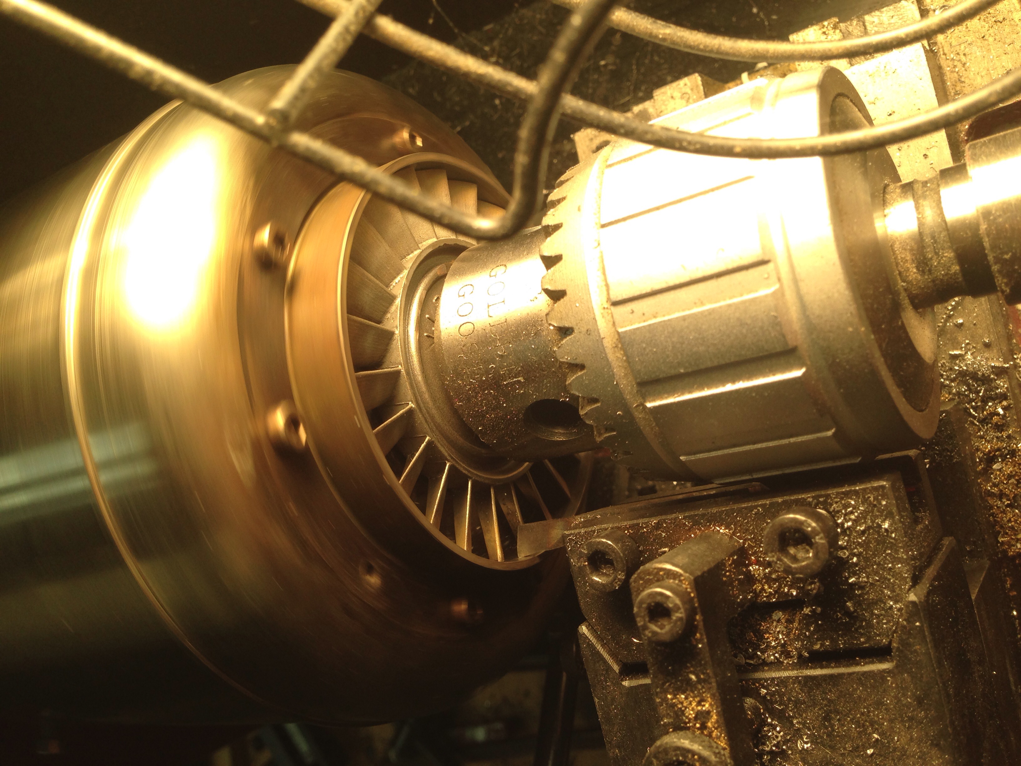

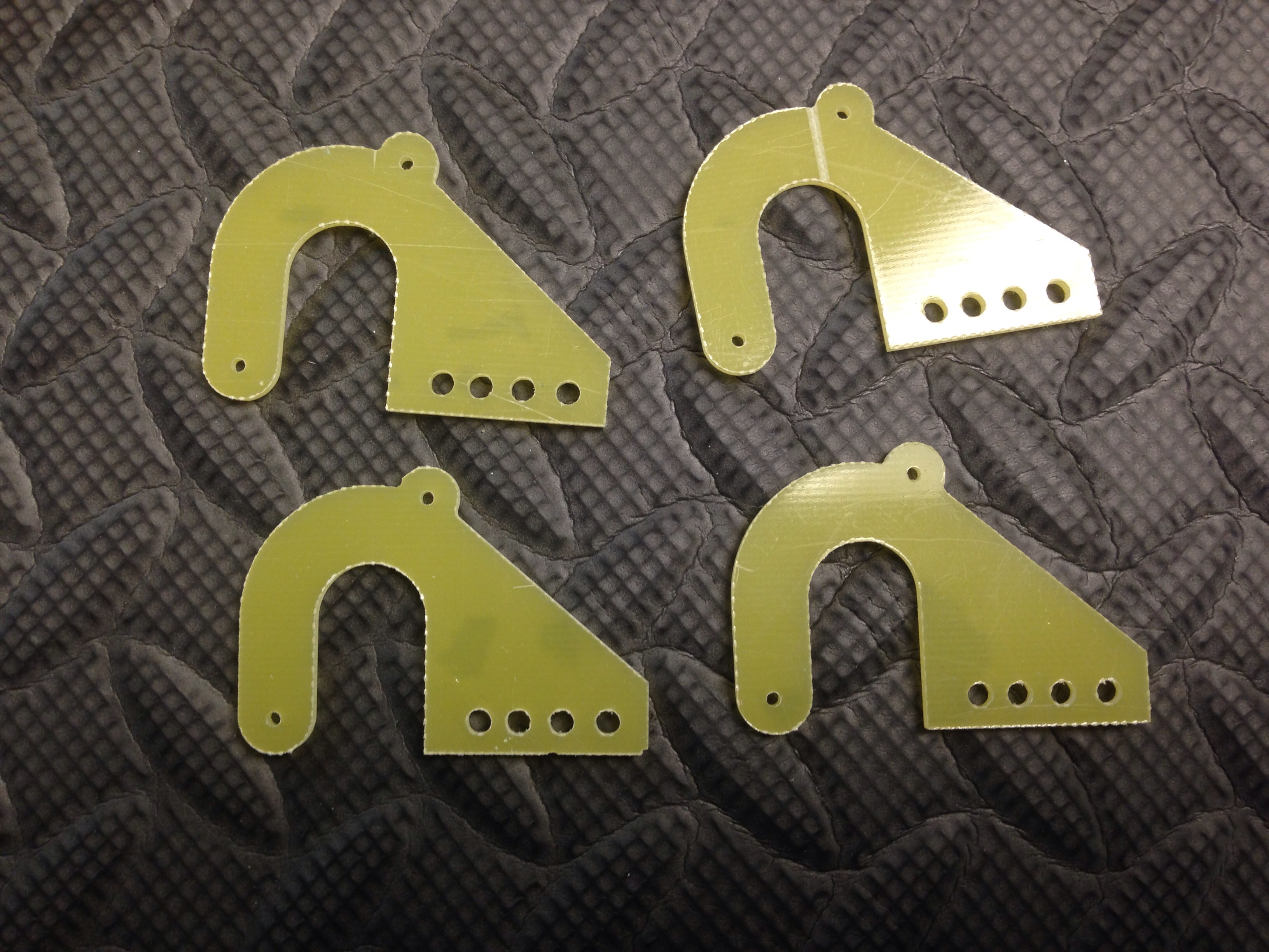

Gary Arthur 08-21-2014 12:56 PM
2 Attachment(s)
http://www.rcuniverse.com/forum/atta...mentid=2024540http://www.rcuniverse.com/forum/atta...mentid=2024539
I have a lathe similar to yours. While it's not great, it gets the job done. I do wish I had something a little more precice.
For mills, I have a taig converted to CNC and love it. I make all kinds of parts from service trays, landing gear parts, formers, ribs etc

Dr. Honda, now that's a hobby room!

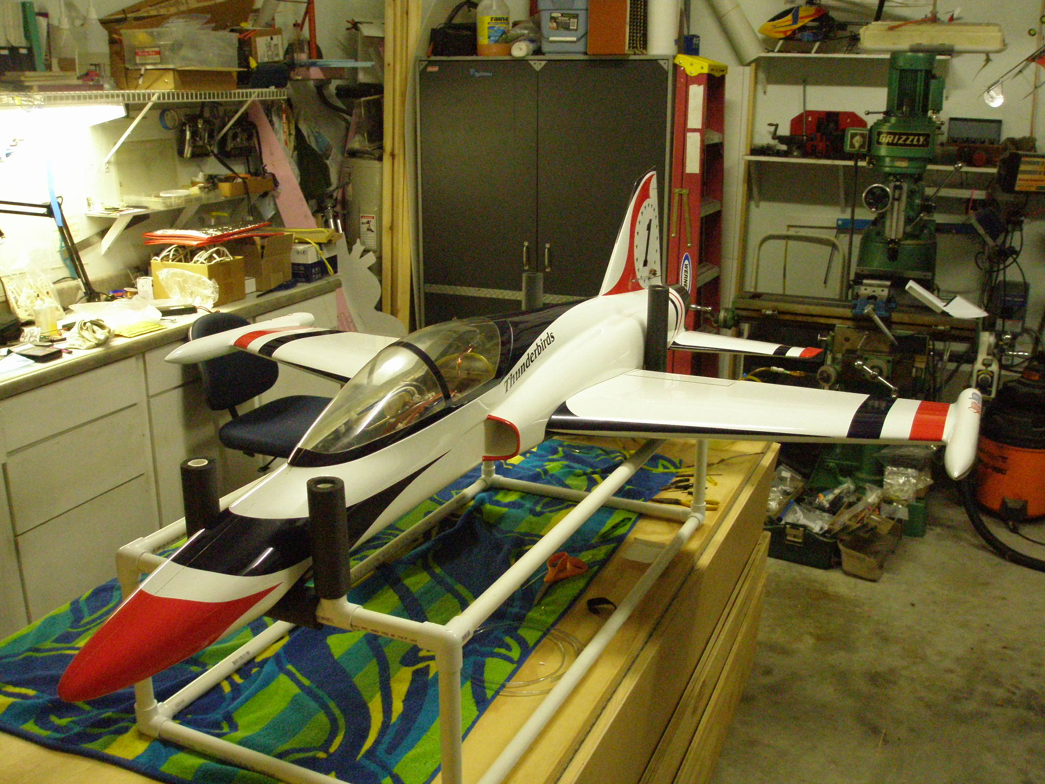

mitchilito 08-21-2014 03:43 PM
2 Attachment(s)
When I "took the plunge" I bought all Grizzly stuff and I have NEVER regretted it. I've had my machines for almost 10 years now.http://www.rcuniverse.com/forum/atta...mentid=2024581http://www.rcuniverse.com/forum/atta...mentid=2024582
