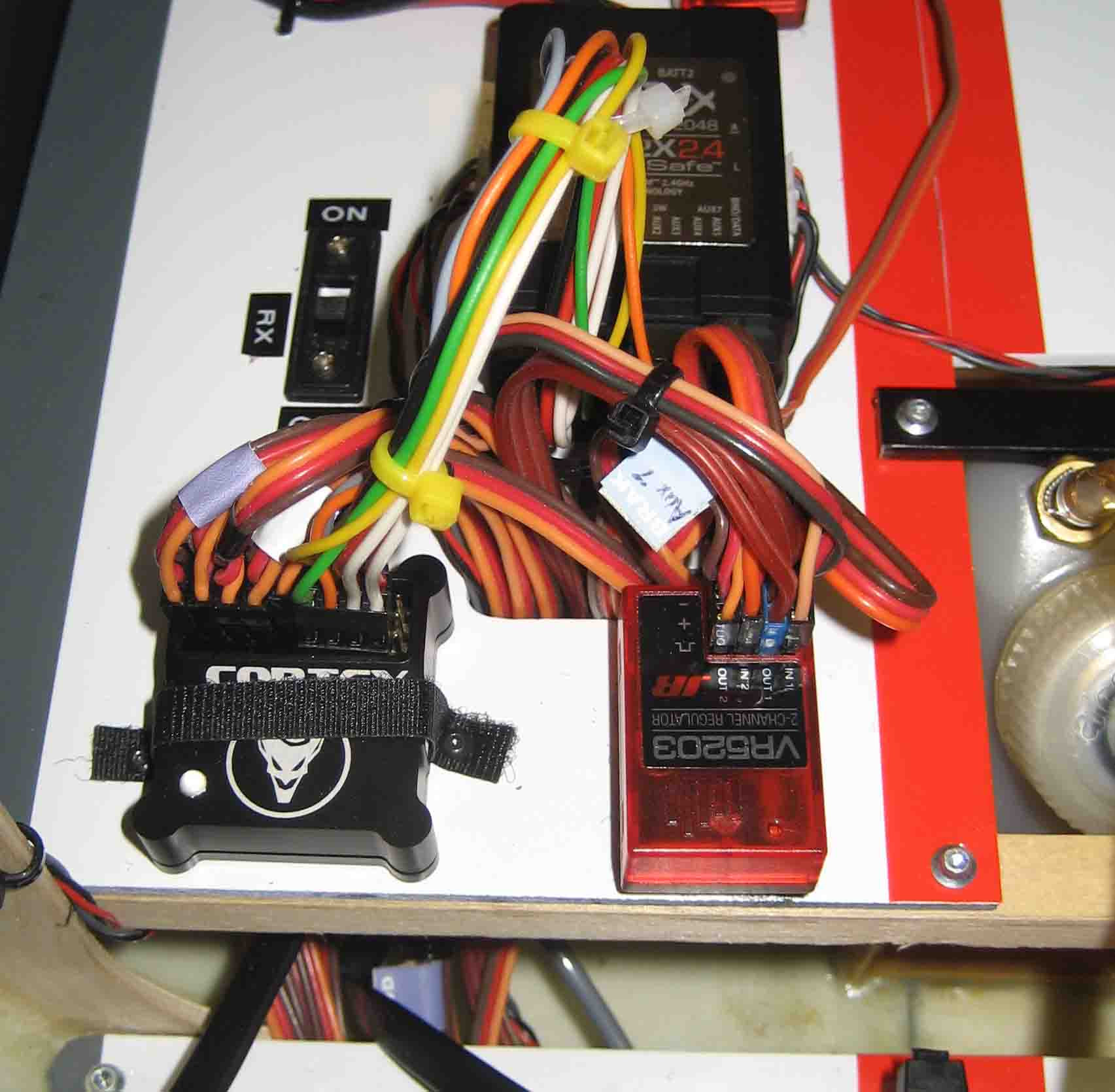

CraigG 09-24-2014 03:14 AM
1 Attachment(s)
Originally Posted by Springbok Flyer (Post 11886761)
Hi guys,
Am I suppose to power up the device? Why can't I find anywhere how to use the PC connection and do the download, even when I click to check online, nothing happens.........a bit ordinary, not all of us have the sense of a sniffer dog to figure it out??? I can see that the 'connected device has an 'unknown' firmware version.....so what???
I don't have the gyro installed, just took it out the box and connected it to my PC.....am I suppose to install it first.....if so, how am I suppose to know that?
I absolutely hate products without decent instructions.......ggggrrrrrrr!!!!
Thanks for your help.
Jan
Agree Jan. Something else that's not mentioned (or labeled on the gyro) is which way to plug in the leads. It's easy enough to figure out from the adapter plug that comes with the unit but why not make it perfectly clear? I needed to power mine up for the update just like you and was very nervous about plugging in the power backwards. Just for confirmation, the negative (black/brown) wire goes to the front of the unit.
FWI, I'll be testing mine in flight for the first time today at Super Jet South.
Craig
http://www.rcuniverse.com/forum/atta...mentid=2034703

So fellow Demon Cortex brothers, if one was to lose the jumper, would it just be the two outside wires that are connected, or all three? I set it up in an electric 3d plane, now transferring it to a jet, pretty sure the jumper is still out at the field....
smitty1001 09-24-2014 08:11 PM
The outsides - it is the same as a spek bind plug
bcovish 09-24-2014 08:29 PM
:-( My mistake.
DrScoles 09-24-2014 08:41 PM
I actually read all the instructions and found that its the outer two, good thing I didn't try the middle, says bad things happen.
So, This worked fine on my little 60" electric. I installed it in a jet with a futaba 14 channel rx. The first two channels work, none of the others do. Nor, does the aux. Any ideas? I'm positive I have polarity correct, I tried several combinations, only the first two ports work, the other three and the aux do not.
Bob_B 09-25-2014 01:01 AM
Can you post photos of your connections. Did you do the learning step with the jumper?
Meesh 09-25-2014 02:07 AM
Dr. Scoles, By any chance do any of your servo extensions have signal boosters in them?? I had some in my plane and had the same problem. After removing them I was able to set it up no problem. I also have a Futaba 14 channel Rx.
Bob

DrScoles 09-25-2014 05:13 AM
Bob B, I'm certain its connected properly, the two elevators wouldn't work if it wasn't. Zero chance the polarity is wrong on the leads. Even if I had them wrong, the rudder would physically move. I did not go through the learn process because the ailerons, rudder and aux did not work. I did plug the jumper in and watched it go through the steps, and the rudder did jerk. But it won't allow me to give input. Do I need to reset the gyro since it was already set up in another plane? The directions say no, but that could be it? I have not used the software yet confirmed which version of software/firmware I have. Again, it worked fine in another plane, so doubt that would be a factor either.
Bob#2, There could be boosters in the wires, I did not wire this plane originally, I will look. I'll take a servo and plug it directly into one of the ports and see if that makes a difference.
DrScoles 09-25-2014 05:52 AM
Ran out into the shop before going to the office. plugged a servo directly into the C port, no bueno…. Thinking I need to reset it???
wfield0455 09-25-2014 12:56 PM
Plug a servo directly into one of the receiver channels that doesn't appear to be working just to be certain the receiver isn't the problem. It sounds like none of the channels associated with the single wire connections between the Cortex and the receiver, are working, only the ones with full, 3 wire extensions correct? If you are positive that you have the single wire connections plugged in so they connect to the signal pin on the receiver channel then I would connect the Cortex to the PC interface. There is a screen that should allow you to monitor what activity the Cortex is seeing on it's inputs. You are using the provided wiring loom and not SBUS or something, correct?
c_makhija 09-25-2014 01:18 PM
Sorry if its been said before, but what is the correct procedure for flight setup. Are we suppose to preset the gain on a switch and activate it in flight or use a knob to increase the gain until we see the occultations and then back off a bit.
Gyro with 3 axis occultation could be viscious in flight i guess.
Chatty.
DrScoles 09-25-2014 03:18 PM
Hi Wayne, I did plug servos directly. I am positive i have the polarity correct. It worked on my other plane two minutes prior…. LOL I will do the pc interface. Wanted to avoid it because it worked fine in the other plane. Just wondering if the 14 channel rx is doing something different than the 6 channel I was using voltage wise??
