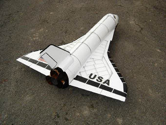

1 Attachment(s)
Here is a pic. of the two shuttles………. Back in the day I even purchased an official shuttle pilots uniform. I only wore it a few times flying the shuttle. I will have to find it and put on for a picture.

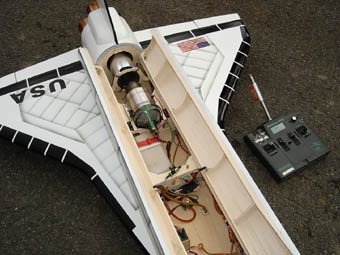

I replumbed the fuel tank with some Viton tubing. The regular old neoprene was starting to get hard. The fuel tank is a 1 gallon syrup jug. It is thicker than a dubro tank. All the hoses are friction fitted through the tank.

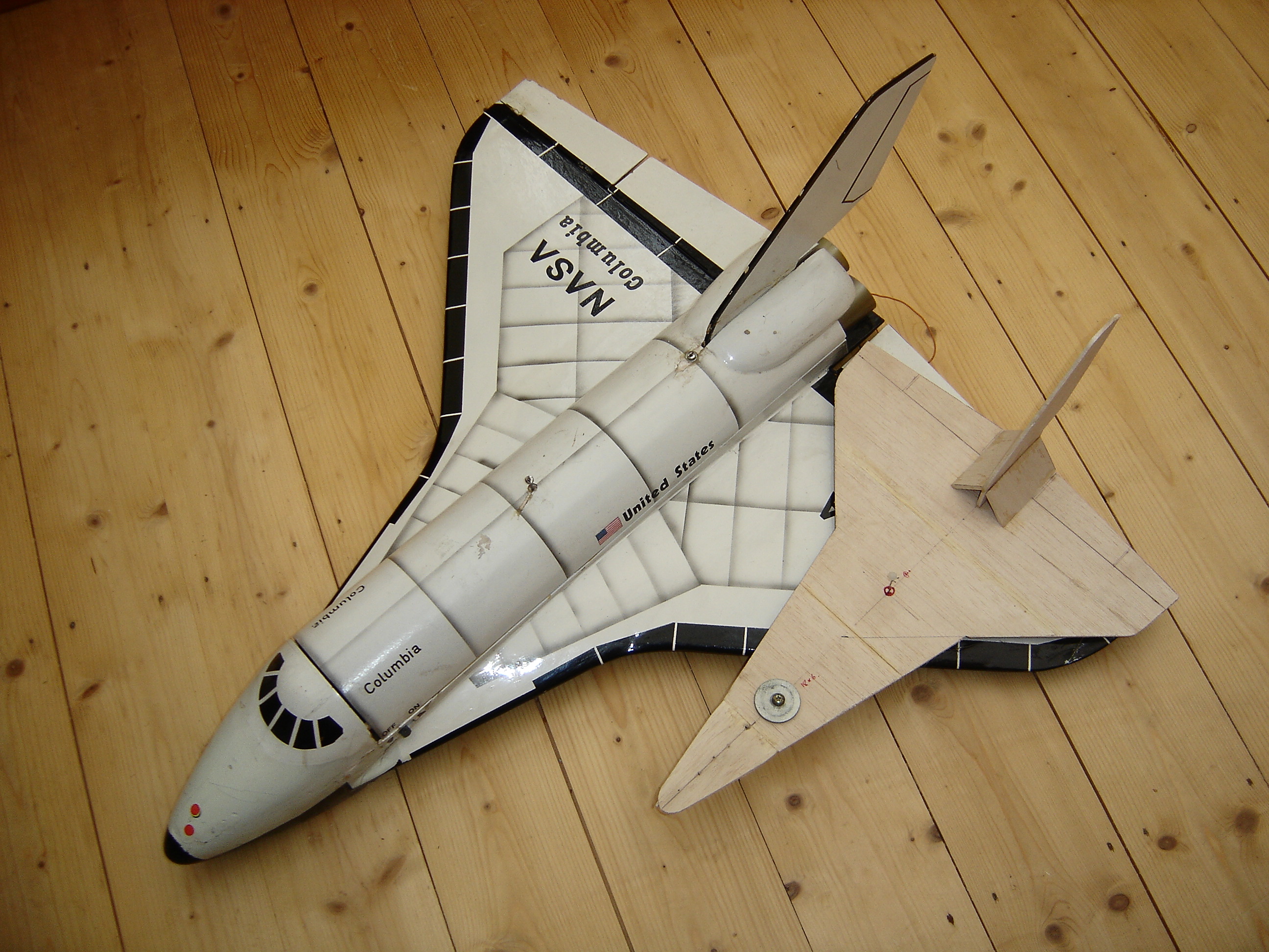

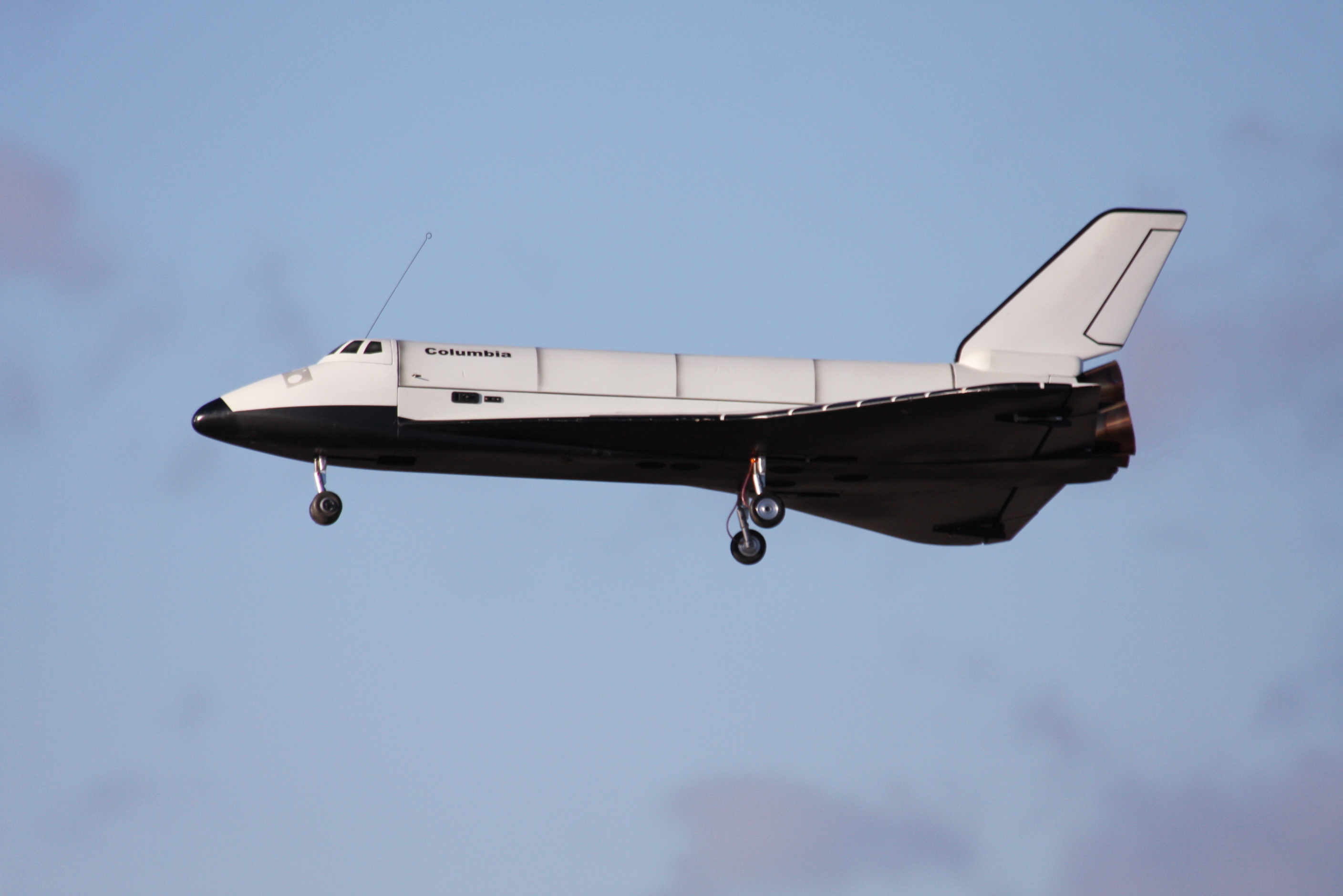

It was my shuttle that Gaspar & John Wright mentioned. The model is as scale as I could find drawings for except the fuselage is 25 mm too narrow. Flies very well now the CG is fixed, & aileron throws reduced. It uses a Super Sport engine & the U/C is positioned in a position to allow take off (the scale position is way too far back)http://www.rcuniverse.com/forum/atta...mentid=2151335http://www.rcuniverse.com/forum/atta...mentid=2151336

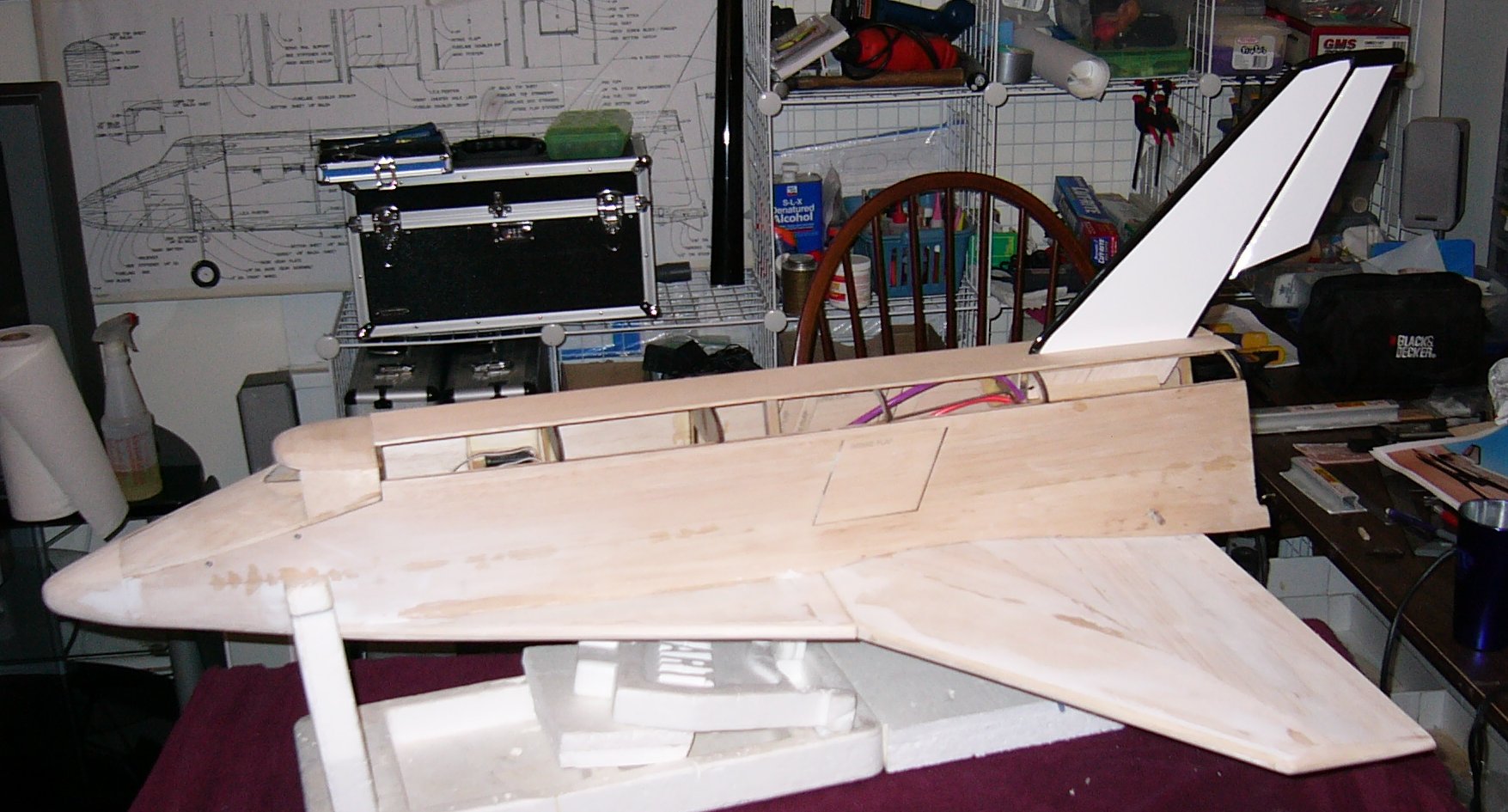

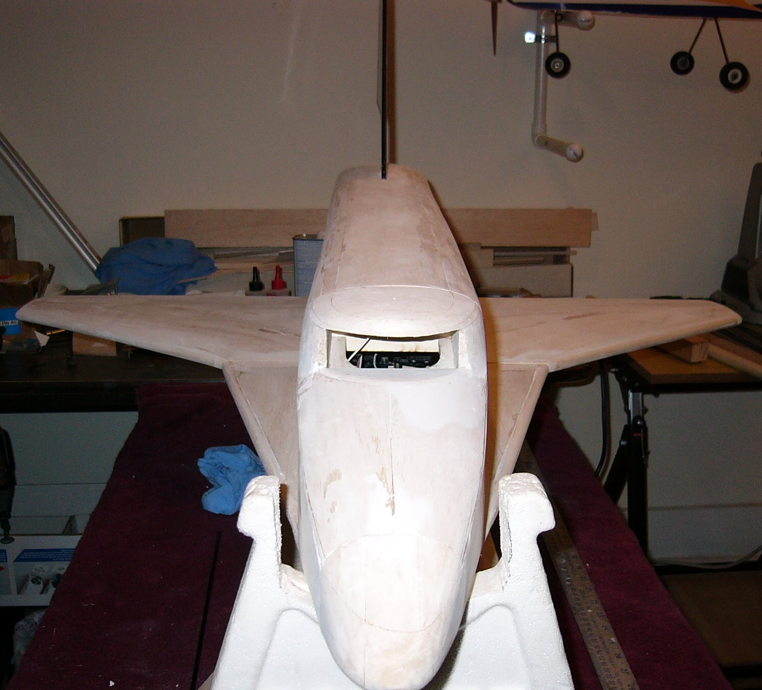

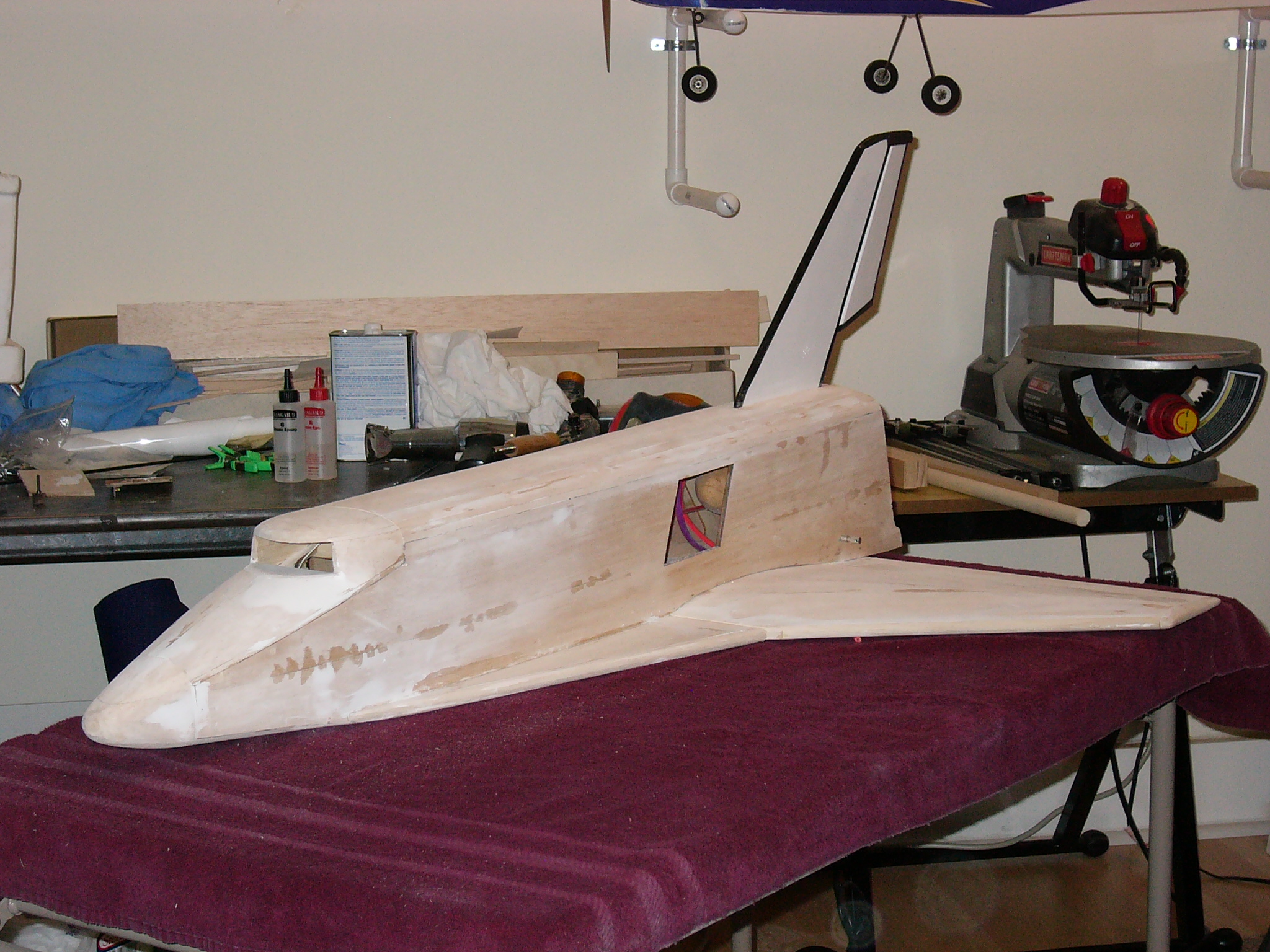

Here is how i came up with my shape. It is all foam cut except for the nose. Bulkhead A and B cut out a mail box shape, ( the cargo bay area). Bulkhead C and D made a loaf of baked bread shape( the engine compartment). The wings , leading edge extensions, and vertical stab. were straight forward foam cut parts. The foam parts in the picture were from the first one I cut out in 1997. It was hand launched to figure out the CG.

I sealed the fuel tank with some epoxy and fiberglass. I also made a few battery trays to make the batteries easily removable.

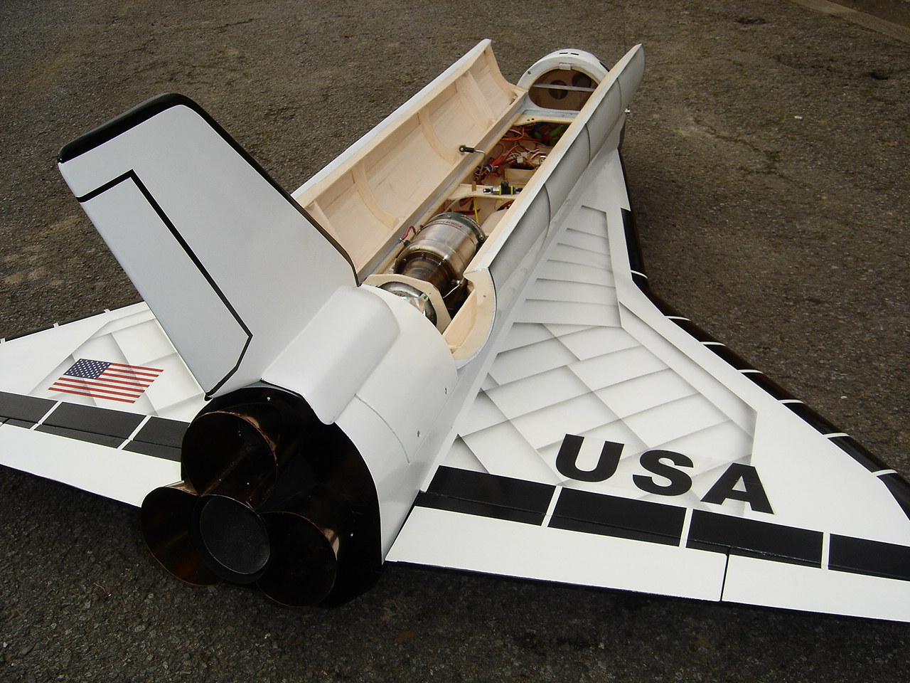

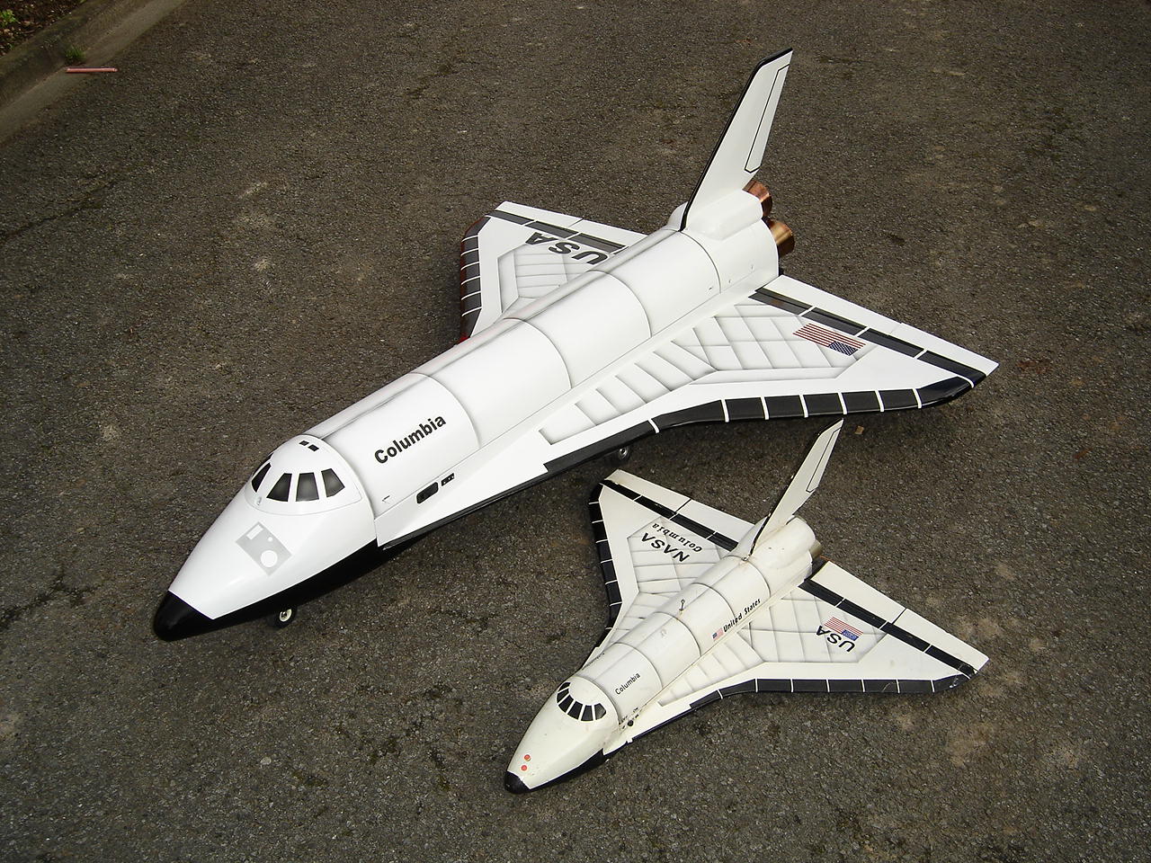

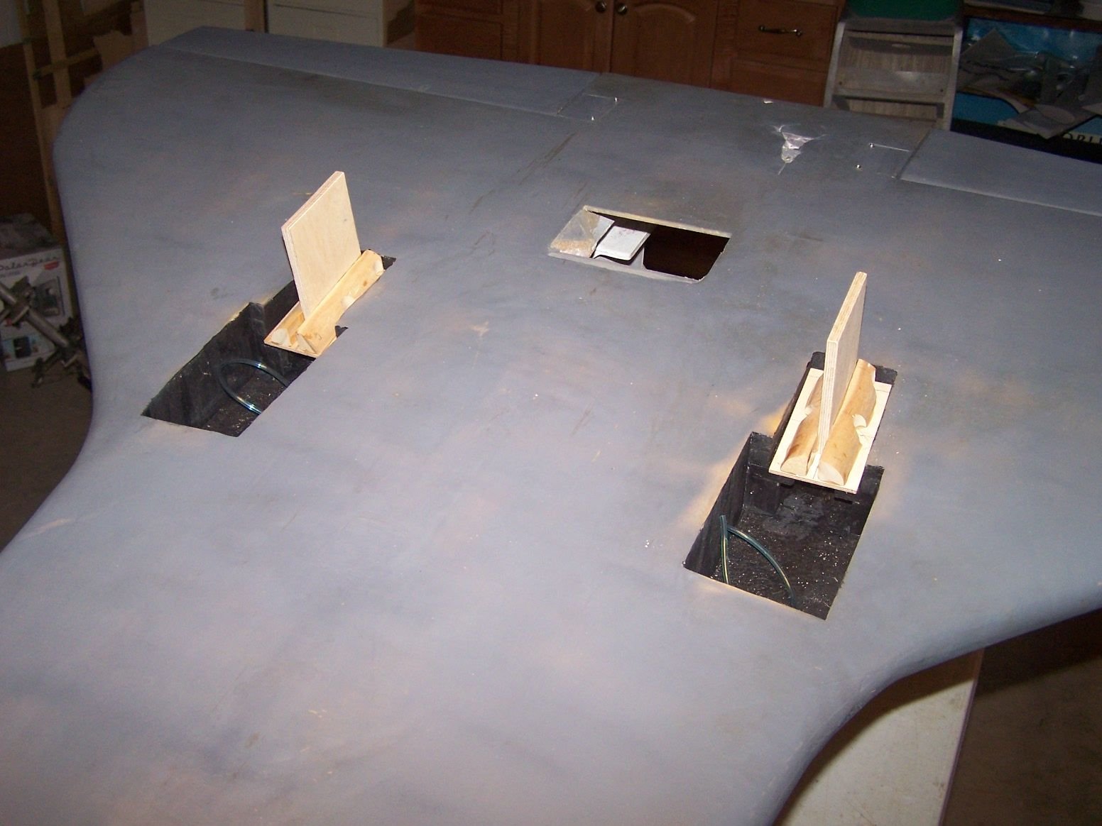

5 Attachment(s)
My model is 'Lite ply' balsa fuselage with foam wings. Span is 1220mm (48"). Controls are: ailerons outboard, elevators inboard, engine speed, retracts & brakes, opening cargo doors by radio. Some years before, I made a 24" span model to be carried 'pick-a-back' on various models, this flew dozens of times at various shows in the UK.http://www.rcuniverse.com/forum/atta...mentid=2151413http://www.rcuniverse.com/forum/atta...mentid=2151414http://www.rcuniverse.com/forum/atta...mentid=2151415http://www.rcuniverse.com/forum/atta...mentid=2151416http://www.rcuniverse.com/forum/atta...mentid=2151417
First pic with chuck glider to find CG. 4th pic shows turbine model & pick-a-back model. 5th pic shows dummy tail pipes & open cargo doors.
MJD 03-08-2016 08:06 AM
Where's your air inlet? Hidden on the black fuse bottom?
noveljet 03-08-2016 08:18 AM
Yes, holes in underside & covered with gauze (to prevent FOD) painted black so you can't see them when its flying.
