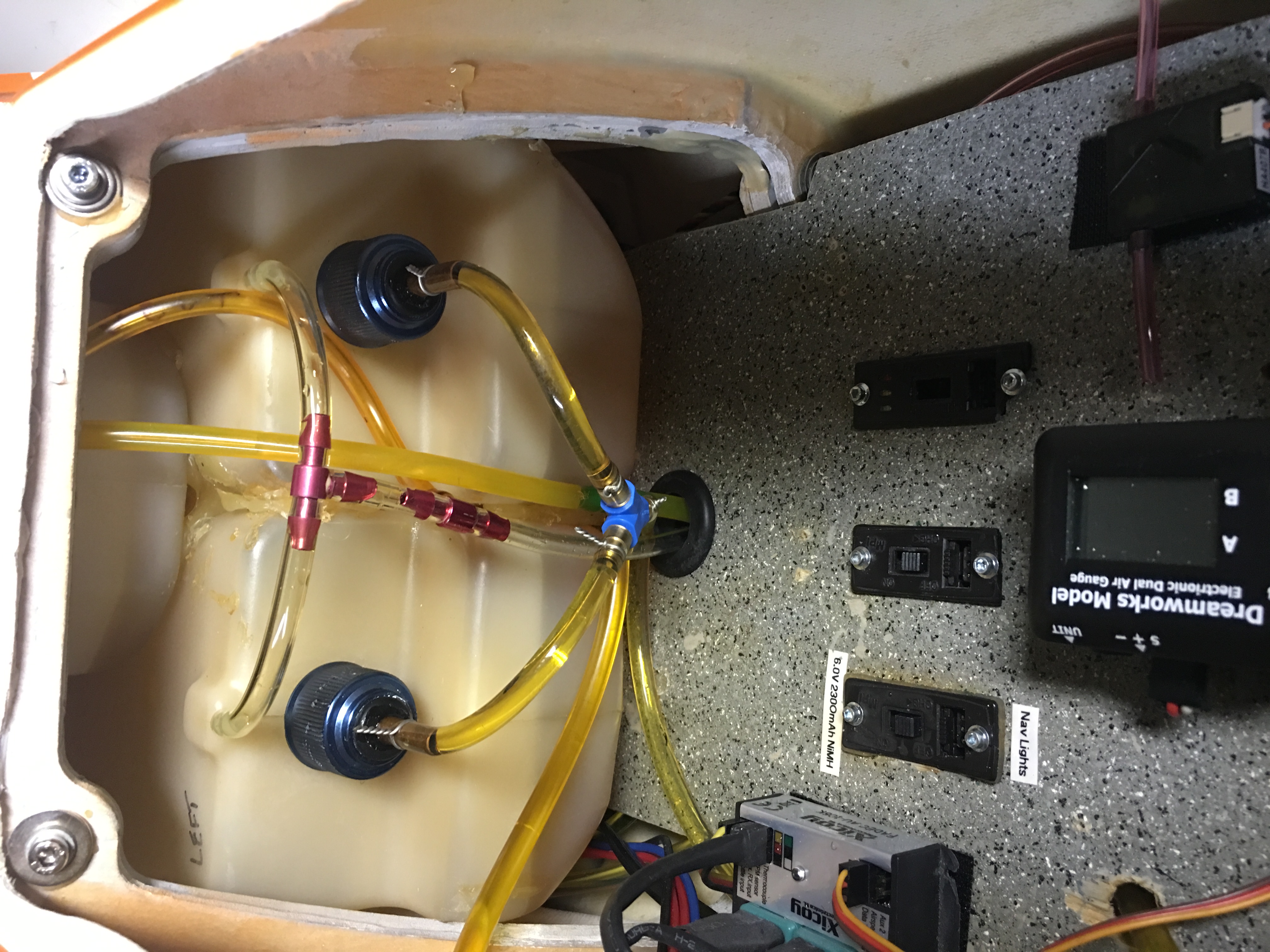

mikes68charger 07-24-2016 07:32 PM
Help can't stop the Bubbles and Sucking in of the UAT
This is like my 6th jet and I have never had issues like this.
I got 1 1/2 flights on my new JL 1/5 L39 gen 2. With K180
Madden flight was great only used full power on take off the rest of the flight at 1/2 - 3/4 no issues
2nd flight after takeoff go to do full power low fly by and at the end it barely did the vertical, it felt like full power was 1/2 stick. Then flame out.
Got it down no issues, the UAT
http://www.dreamworksrc.com/catalog/High-Flow-Air-Trap
Was full and the Kingteck said max pump voltage reached
Went to drain the system and the UAT suck in on the round paper element and was putting air bubbles in the 5g fuel jug
so I think kinked 6 festo line from the tanks Y to the UAT so I pull it out from under the receiver mounting plate and run directly.
Then disconnected the line from the motor and ran it to my fuel jug and used the KT program box to test pump. At max fuel pump voltage I was getting a stream of air bubbles from UAT to pump and from tanks to UAT and UAT was sucked all the way in.
I clamped off the left the right tank to see if there was a different with no luck.
Also disconnected each vent line incase the vent line was two small
I used all brass adapters for the UAT from Dreamworks with metal wire twist ties in all connection.
Im lost. Is this a big motor thing were I need a composite UAT?

mikes68charger 07-24-2016 08:16 PM
2 Attachment(s)
I think the bubble are coming from the rubber that holds the brass fuel tub into the tank. It comes out with 6 size festo tubeing into a 6 size festo Y the straight to the UAT were there is a 6 to 8 size festo brass adapter
The vent is all 6 size festo with a T, ( the second purple T in the vent is for the Smoke tank above) one drain port on the bottom.
I was thinking vent restrictions too and pulled all hose off the tank and the UST still sucked all the way in against the round paper filter

mauryr 07-25-2016 02:12 AM
If the bubbles are already showing in the tubing right after the tank, you may want to try these:
http://www.dreamworksrc.com/catalog/Fuel-Line-Barb-532
It seems from the pictures you have a brass tube and PU hose on it, without any kind of barb.
The problem could be there, or inside the tank on the pickup line.
If the UAT is sucked in, then you probably need a more rigid one
olnico 07-25-2016 02:48 AM
Cavitation, Mike.
something is creating too much suction drag upstream the air trap.
1. Connect your air trap to a simple jug with a large bore tube. If the air trap still sucks in, its filter is the culprit.
2. If the air trap does not suck in any more, then your tanks have a problem. Could be coming from the clunk lines or the fuel stopper. In that case, you could try one tank after the other to see how much restriction you get with only one connected.
Please report here with pictures and we'll try to help you.
grbaker 07-25-2016 03:38 AM
The picture appears to show all 3 tank lines connected to the same vent line. I'm betting you are pumping fuel out faster than the vent line can keep up with.
gunradd 07-25-2016 03:59 AM
Mike take Olis advice he is 100% right. What you are seeing is cavitation. When under high suction the fuel will get air bubbles all through it. Something is causing a restriction someplace.

mikes68charger 07-25-2016 06:18 AM
Thanks guys, Cavitation is a new one for me, air leaks yes, LOL
I'm currently only using the 2 main plastic tanks, there is a 30oz dubro tank on top, but that is the smoke tank, My boy told me that the smoke vent line had little pressure and there would be no issue tying into the main tanks vent line so there is only one vent whole on the bottom of the jet. But at this point I don't want any extra issues so I will make it separate.
I hope its not the filter as its a new UAT, with only 4 test starts and 1.5 flights, but I did have a huge issue with algae in my diesel last year so I will do your test when I get home from work.
Thanks guys, Its crazy, this is the most simple fuel lay out of any of my jets and its the one that causing me issues.
sysiek 07-25-2016 06:42 AM
change the 4mm to at least 6mm on suction from tanks to uat this might be the problem + eliminate all the reductors connections 4to6 and 6to4 make all one larger size at least 6mm .

mikes68charger 07-25-2016 05:43 PM
Well the results. My K180 had a hart attack!!!
So I'm going to call my self out here. So when I ordered this bigger UAT I was unaware of the fact it had 2 8 size festo lines and only come with one adapter. So I did the old put CA on the 6 size line and jammed it in the 8 size line.
Well i tested it and had a few air bubbles so I spent another $40 at Dreamworks for the correct adapters and a few feet of 8 size line. I replaced the hack and all seemed good.
Well when I pulled the main line from the UAT to the y on the tanks and found a 1/2in chunk of CA sitting in the line like someone waiting on a hart attack.
Upgraded the line with 8 size from the UAT to the main tanks since I was there.
Crazy right
Never seen, now I know.

User error. I know right who ever admits that. The clear tube peace I had I thought was size 8 was not. And I had little air bubbles during my testing so I added more ca around the tubeing trying to get it to seal.

I thought so, I got 3 flights yesterday. First flight was mild flight and I had a lot of air inside of my UAT once on ground with 1/4 fuel left in both main tanks,
2nd flight was more aggressive and it the UAT was almost 1/2 empty but not sucked in like before. Could not find any leaks or restrictions
So 3rd flight was very boarding, Flew flat and level for the whole flight no loops or splits S and only went to Full power 2 times for a few sec, and it was 1/4 full of air.
I don't see air bubbles when defueling, or when using the pump with the controller.
I pulled the UAT apart last night and the filter is very clean, I did add a bigger vent adapter that goes throw the bottom of the fuse for more vent airflow so I'm not sure if that will help things I'm gong to fly it again today to see.
I was thinking of Connecting an air compressor to the fill line and fill the whole fuel system at 10psi or so and spray with Windex to look for leeks, What do you think? The main tanks are plastic, so Im not so worried about blowing up a tank.
Dave Wilshere 07-27-2016 07:41 AM
What are you sealing the fill line on the bubble trap with? Biggest cause is air leaking there.

mikes68charger 07-27-2016 09:08 AM
Just the aluminum stopper that came with the UAT.. I look into it. Thanks
