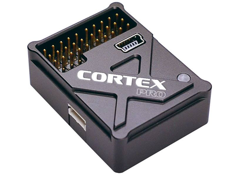

gooseF22 09-05-2016 04:02 PM
Bavarian Demon Cortex PRO is here!!
1 Attachment(s)
Hey guys I just saw this and called Danny to be sure..
The Pro Version of the Bavarian Demon Cortex is available. Its being distributed through www.demonaero.com
Soon to be available through
https://www.aeropanda.com/products/b...mon-cortex-pro
http://www.espritmodel.com
http://www.dreamworksrc.com
www.Chiefaircraft.com
And other sellers soon
Price: 299$
Additional Manufacturer info:

Cortex Pro/ Jeti Initial Impressions
I have just finished swapping out a Cortex for a Cortex Pro in my Ultra Flash.
I am running a CB200 with 3 R3/RSW receivers (2 as receivers and one as the switch). I have installed the Cortex Pro between the 2 R3/RSW receivers and the CB200 using the EX-Bus interface. During final checkout with the Cortex Pro, I noticed the following:
1. The CB200 is now invisible in Device Explorer. All that is visible are the 3 R3/RSW units. Refreshing Device Explorer does not fix it.
2. All telemetry (Xicoy ECU interface, Jeti MGPS, CB200 internal data) is missing. Refreshing the sensors deleted them all and none were subsequently detected.
3. Disconnecting one of the RX inputs to the CB200 does not result in any change to the Antenna Strength or Signal Quality readings (9/9/100%, 9/9/100%). Only when disconnecting the R3/RSW input to the Cortex Pro or both Rx inputs to the CB200 do you get a loss of signal indication.
4. The Cortex Pro seems very sensitive to servo position during power-up initialization. I did the learning process with flaps up, but with flaps in any other position (Take-off or Landing Flight Mode) it will not complete initialization and will sit there with a flashing white LED due to the individual flight mode trim values. Returning the Flight Mode to Normal results in an immediate completion of the initialization routine. Following some testing, it looks like you have to be less than 15% trim points away from the learned position to get it to initialize.
I bypassed the Cortex Pro and fed the R3/RSW receiver inputs directly into the CB200 and confirmed that everything was working correctly with the basic installation. Reconnecting back through the Cortex Pro reconfirmed all the above issues.
I have not flown with the Cortex Pro, and with the above issues I am not inclined to until we get them resolved.
Can these issues be relayed back to Demon and fixes implemented.

DEMONjoe 09-23-2016 11:30 AM
In regards to the reported initialization issue, I assume I know what the source is: are you using a mix with your flap setting, like applying elevator to the flap setup? If so, and if that is not only a little, then yes, it is that the gyro does not see the center it expects and will not initialize.
Simple solution: initialize with flaps up, so no mix on any other function like ail, elev or rudd.
Regarding the telemetry, as mentioned before: we are working on this and will supply an update soon, together with the software you need to carry out the update. I ask for just a little more patience and am sorry for any inconvenience this brought up.
Joachim
