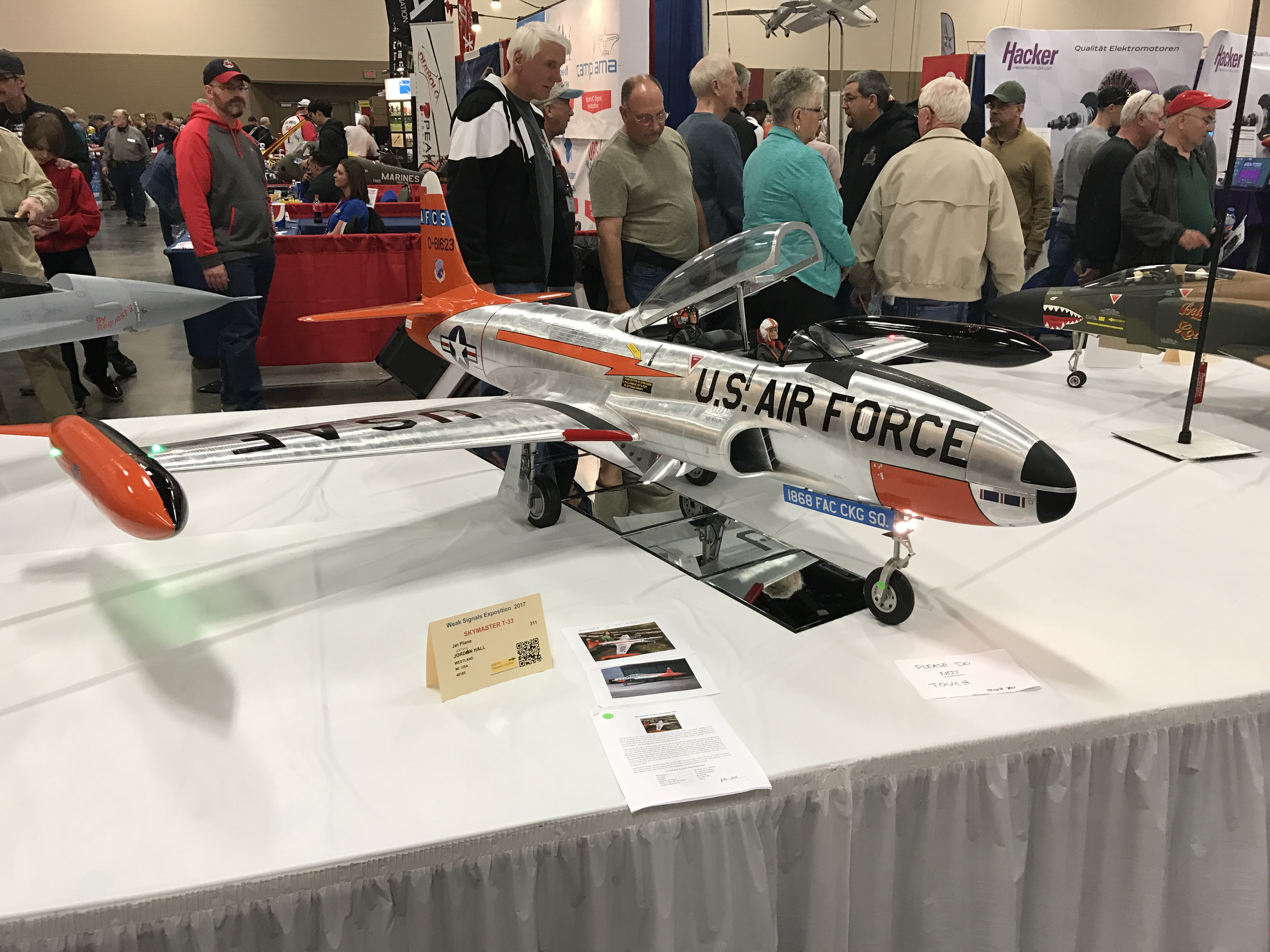

FlyingJ664 04-03-2017 04:58 PM
1 Attachment(s)
All set for the Toledo Expo!
http://www.rcuniverse.com/forum/atta...mentid=2208311
K.O. 04-03-2017 06:25 PM
Originally Posted by FlyingJ664 (Post 12323075)
I see two winners in this picture. Superb workmen ship. You've got my vote
K.O.

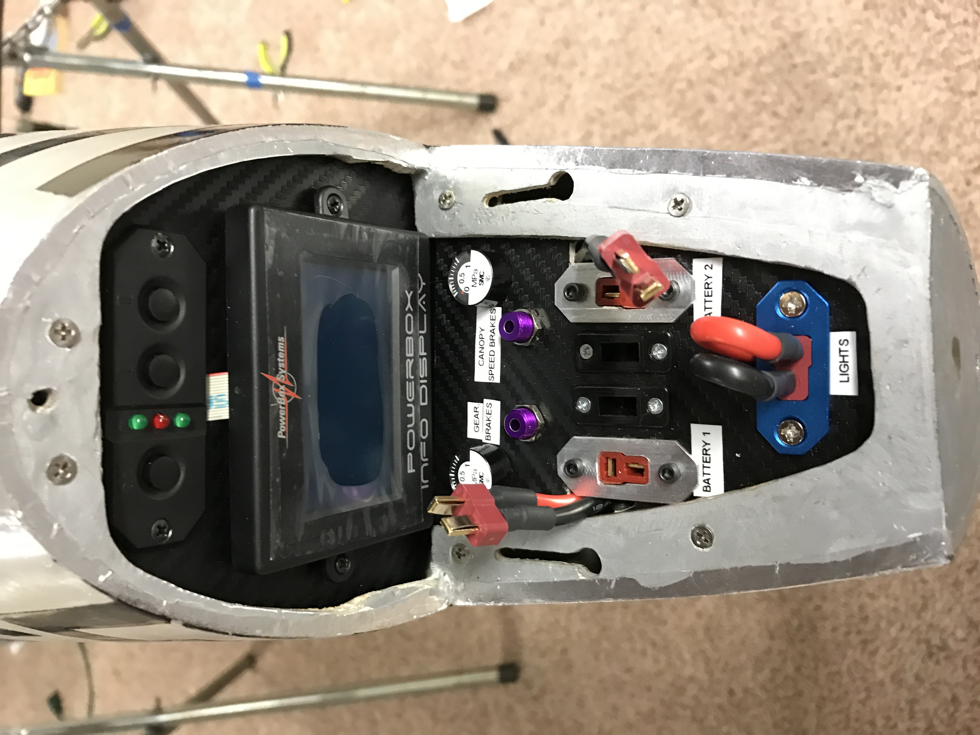

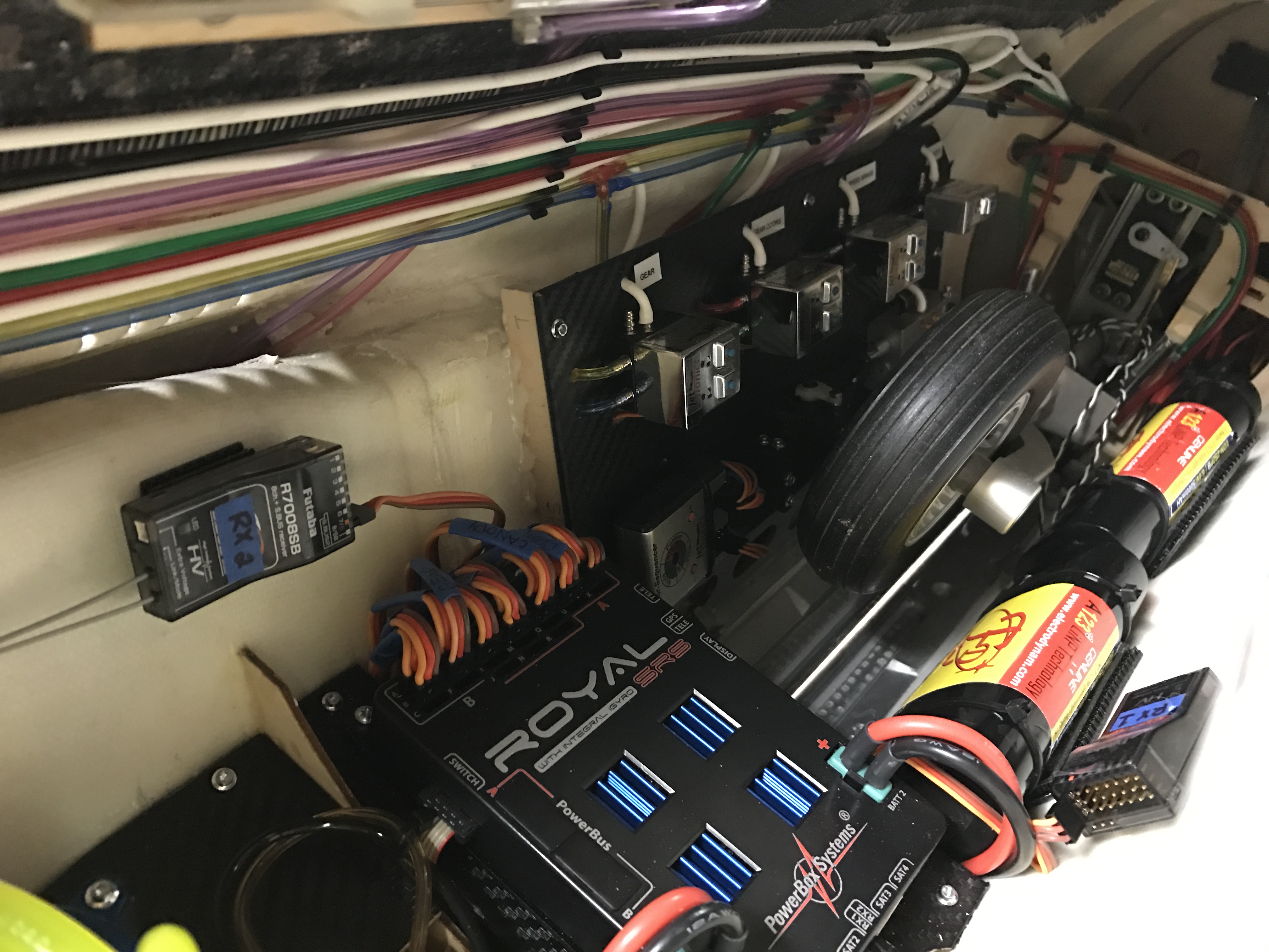

2 Attachment(s)
Here's a few pictures of the inside of the plane:
http://www.rcuniverse.com/forum/atta...mentid=2209064 http://www.rcuniverse.com/forum/atta...mentid=2209065

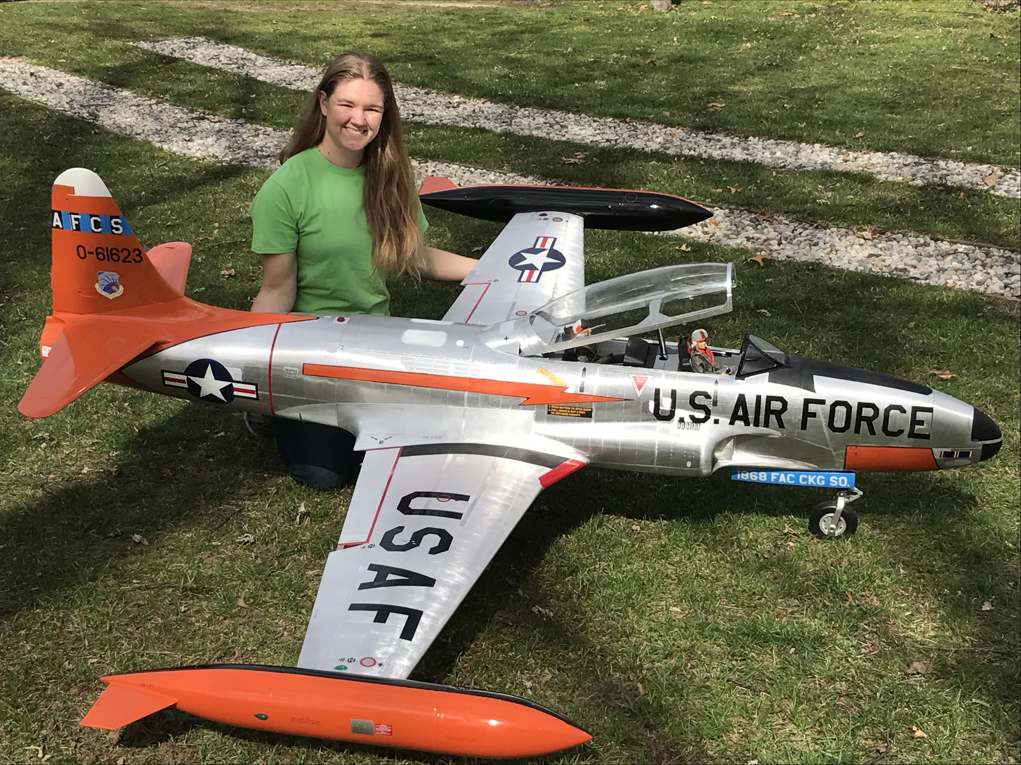

3 Attachment(s)
I did get the T-33 to the RC Expo in Toledo. Finished 2nd place in the Jet Category and won the People's Choice Award!
http://www.rcuniverse.com/forum/atta...mentid=2209072 http://www.rcuniverse.com/forum/atta...mentid=2209073 http://www.rcuniverse.com/forum/atta...mentid=2209074

IFLYBVM2 06-20-2017 02:12 PM
Running the light wires in the wing ?
Hello-
Regarding the lighting wires that had to be run from wing tip to wing root, were you able to run the wires down the middle of the wing, or did you have to run them down the trailing edge ?
If you would be kind enough to explain what method you used to get the wires from outboard to the wing root, I would very much appreciate it.
Thanks-Mike O.
FlyingJ664 06-20-2017 02:47 PM
The light wires had to be run down the trailing edge of the wing along with the servo wires- I would have preferred them to exit at the front of the wing, but I would've had to break through the spar to do that.. There was a clear path through the wing already along the back side except for the area in the servo box, which needed to be cut for the aileron wires anyway. The hardest part I had was getting the light wires from the tank to the wing.
To get the wires out, I have a small flexible piano wire that's about 40" long. I attach a long string to the end (looks like a fishing pole) and push them both through the wing. The wire helps to get the string through without getting caught on anything. When I can see the piano wire at the wing tip, I remove the string from it and tie it to the end of the servo/light wire. Then you can just pull the string back through the wing. Works for me and saves a lot of frustration.
