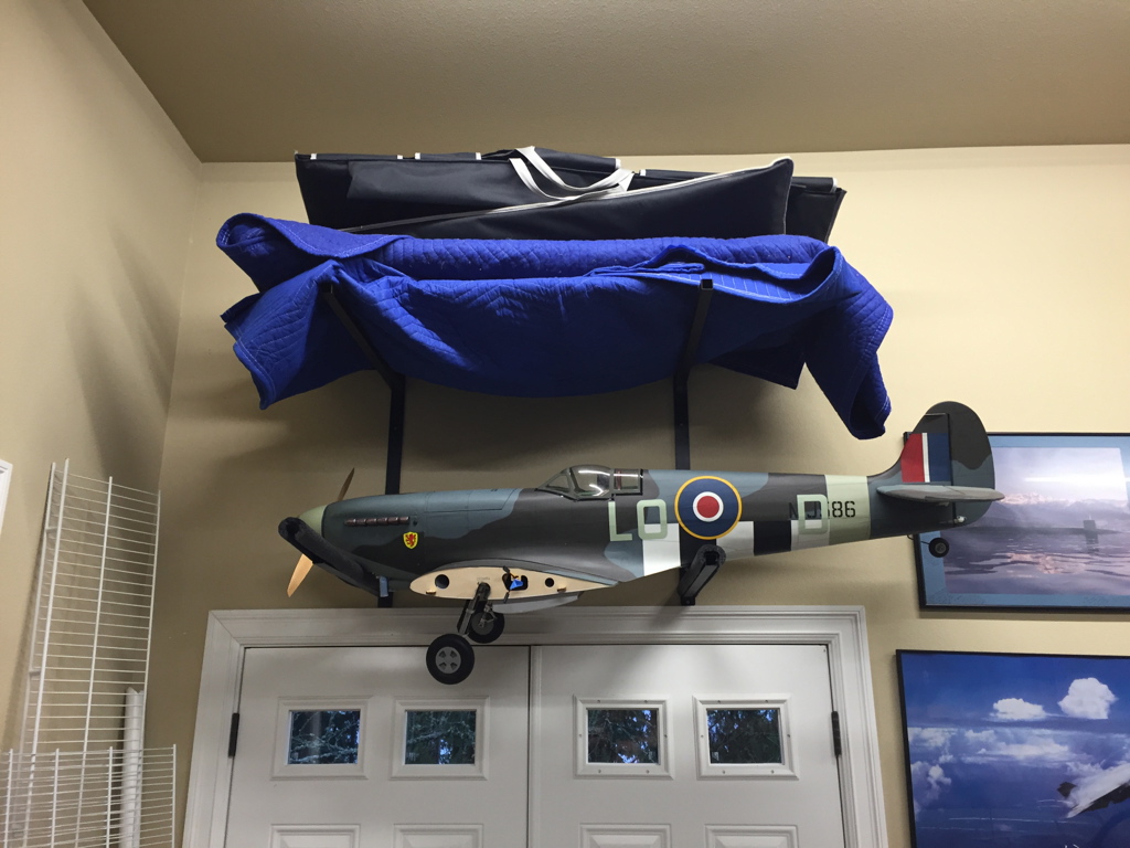

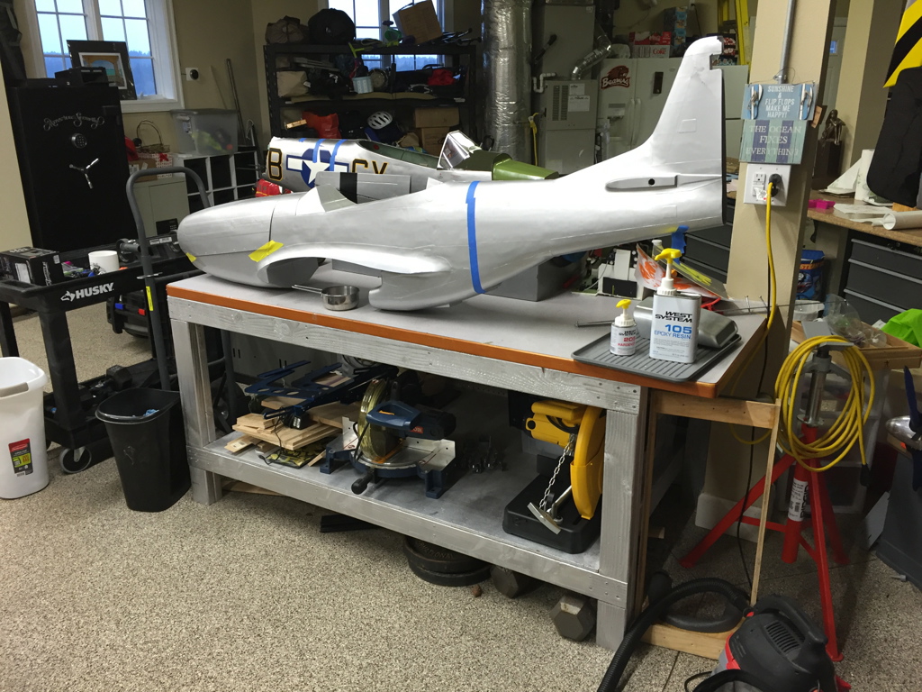

4 Attachment(s)
I made metal racks to hold planes. I screwed up and ordered 3" tubing, you could hang a motorcycle off these racks... 1" is fine. But it was free standing, so I wanted it stronger. The one against the wall is 1"
http://www.rcuniverse.com/forum/atta...mentid=2206812http://www.rcuniverse.com/forum/atta...mentid=2206813
I think having free tables with storage underneath is key. You can buy, but making is much cheaper and not that hard. I did the formica countertop on this one, won't be doing that again! Pain in the ass. http://www.rcuniverse.com/forum/atta...mentid=2206814http://www.rcuniverse.com/forum/atta...mentid=2206815

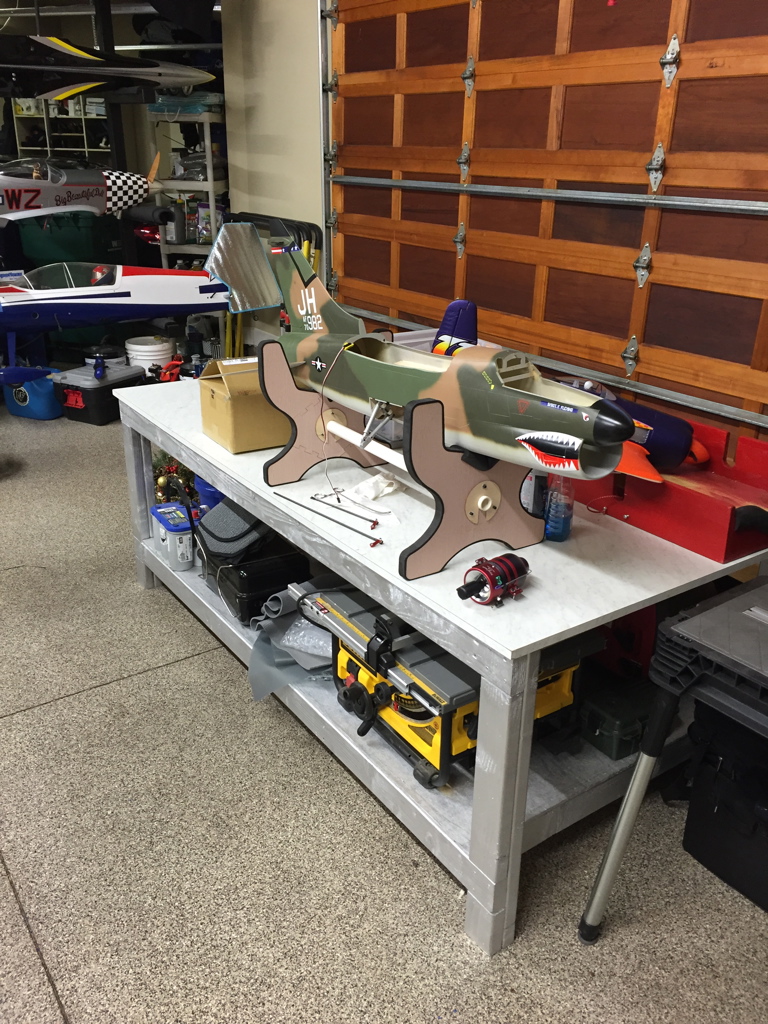

1 Attachment(s)
If you need space use the walls gets the planes off the floor and if don't need workbenches painters stands work the best for building.... I got one workbench and 3 painters stands
Damo

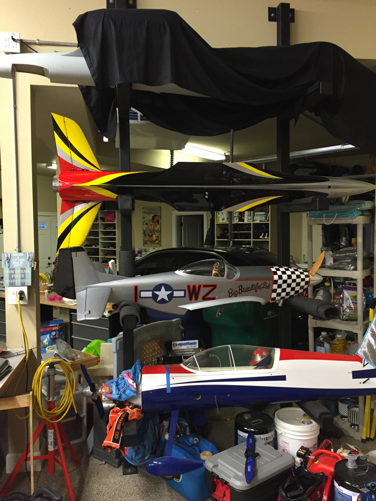

3 Attachment(s)
I have a 30x40 shop, the more floor space you can keep open the better,,I built a large double sided rack on casters, I keep 8 giant scales on it, and can easily roll it around. Dont forget the ceiling, I have 5 planes hanging from my shop ceiling 50cc up to 120cc. The key is to get them out of the way when not working on em. The LED lighting trays are the way to go, the bright white, and you can use all the light you can get. Also if you got a Hotrod, watch out cause they eat up room too.

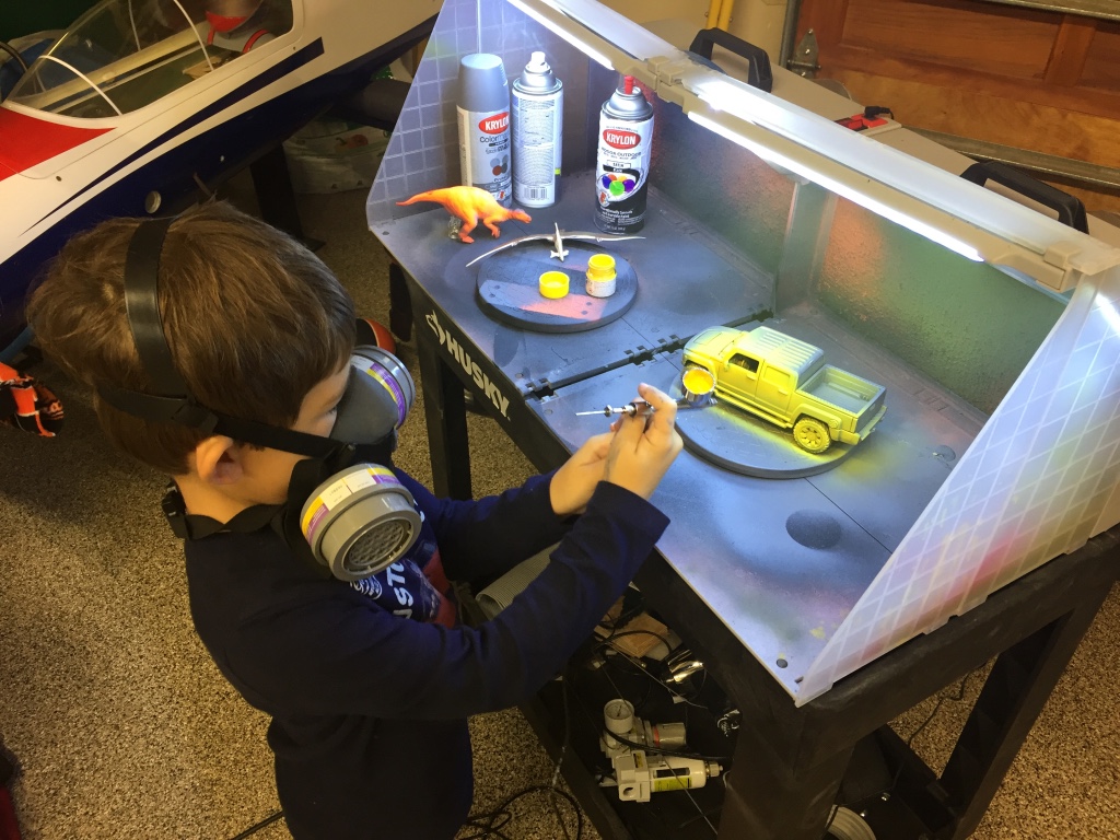

1 Attachment(s)
Like someone mentioned above, if you put in an epoxy floor, make sure its light colored! My floor has too much black speckling and parts disappear. I don't even look for them anymore.
Amazon sells these little paint booths that have a suction and filter. With two together, you can paint pretty much everything but an actual plane. http://www.rcuniverse.com/forum/atta...mentid=2206946

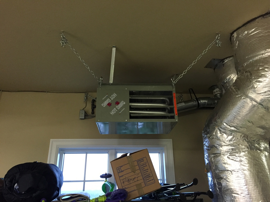

2 Attachment(s)
Just a 1.5 garage for me. Just want to mention I do a lot of painting and sanding in the area so I invested in a heater that draws and expels air/gasses to and from outside. No worries of an explosion now. ;)
