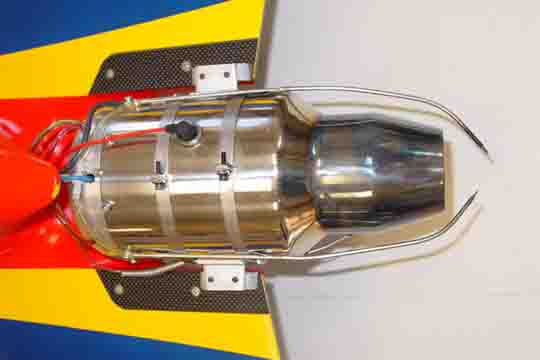

Charles,
Correct, the "hook" part of the injector is oriented away from the turbine exhaust. Seems backwards but that's how it's designed.
Regarding the injector placement, it's not critical. There are no special "rules of thumb" like the distance from the turbine exhaust cone to the start of the tail pipe. In general, you want it closer to the exhaust cone where it's hottest. 1" or 2" inches behind is probably fine. Position it just off center so the spray is into the center of the exhaust. Again, precise positioning doesn't seem to be critical in my experience.
Here's a picture of the smoke nozzles on my old KingCat. They worked just fine.
http://www.rcuniverse.com/forum/atta...mentid=2208669
Craig
