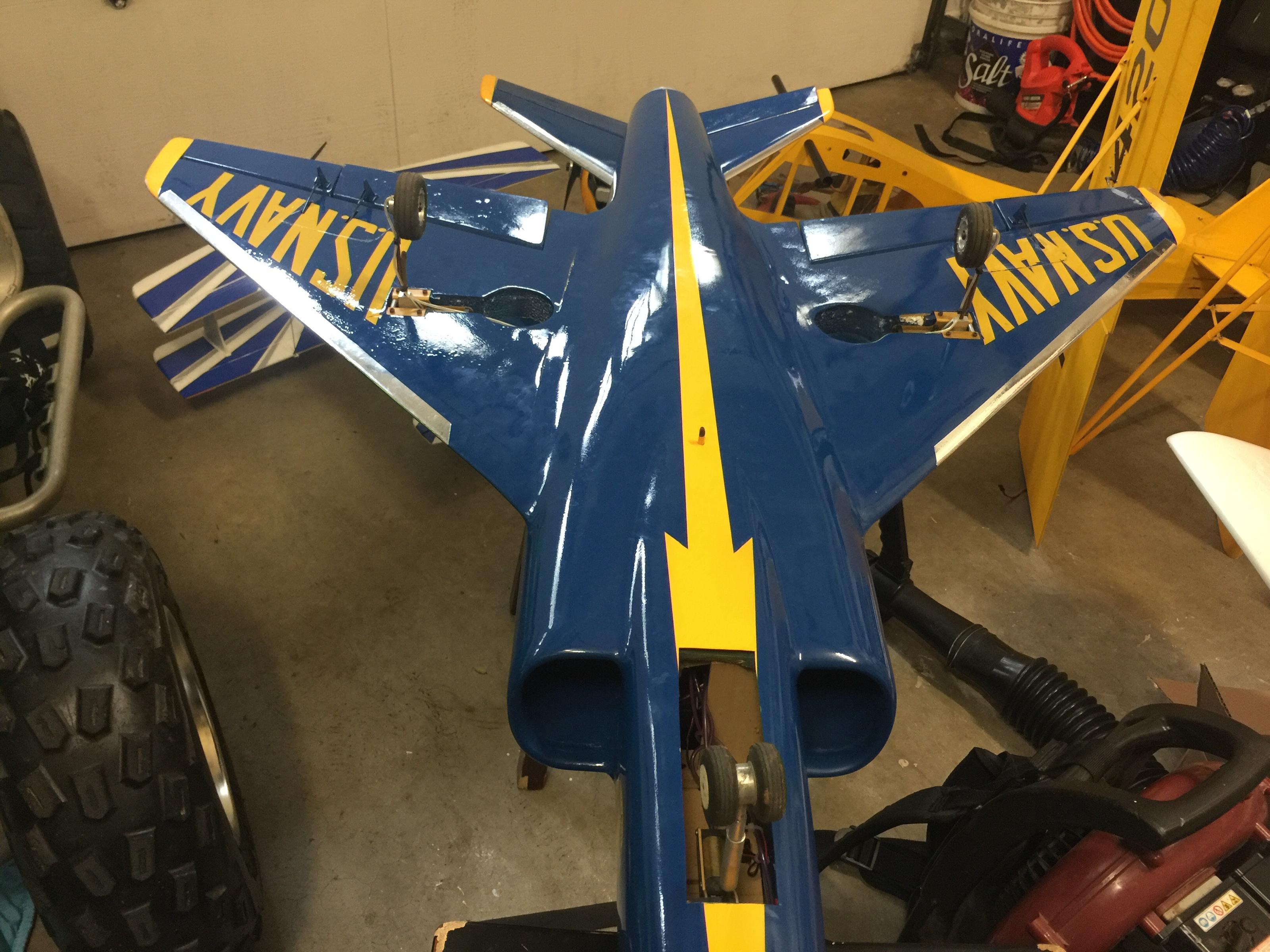

thunderchief 04-28-2017 03:26 PM
CG location
Does anyone know the proper CG location on the Top Gun Interceptor. A friend worked all Winter on one but was not sure of the exact location. Today he tried to maiden the plane and it would not rotate even at 50+ mph.

Wing image
2 Attachment(s)
Attachment 2212399
Since I have seen at least two different wings on these planes, I wanted to show which one Thunderchief and I have on this plane.

Larry J 04-30-2017 03:46 PM
Thanks again to everyone for the responses. So I would like to share some results. Jofunk, I checked with the protractor and wow, the 15 degree angle points about 1.50" behind where I had the CG. In contrast Jetmaven, the online CG calculator indicated 0.25" ahead of where I had the CG. :(
I think I know why no one makes this plane anymore.... :(
I would like to simply change the CG to the 15 degree pointer mark on the protractor. The problem is, the fuel tanks cannot be moved any further aft. This CG location would be completely behind the tanks...

Larry J 05-05-2017 04:09 AM
Changing the CG
So Thunderchief and I made several checks on the plane. We found that the wing, stab and motor thrust is all at a very nice +1.0 degrees. This practically leaves only the CG to blame.
If I move the CG back as I stated above, it will be behind the fuel tanks. This effectively generates a different CG for dry (no fuel) vs wet (full fuel load).
Those numbers are as follows, if I target half a fuel load as the center-line:
Dry, the CG would comes out to 33% MAC and wet would be 23% MAC. This is too large a swing in my opinion. But I am not an Interceptor expert (yet)...
Would some of you please chime in? Is this too much of a swing for this plane?
