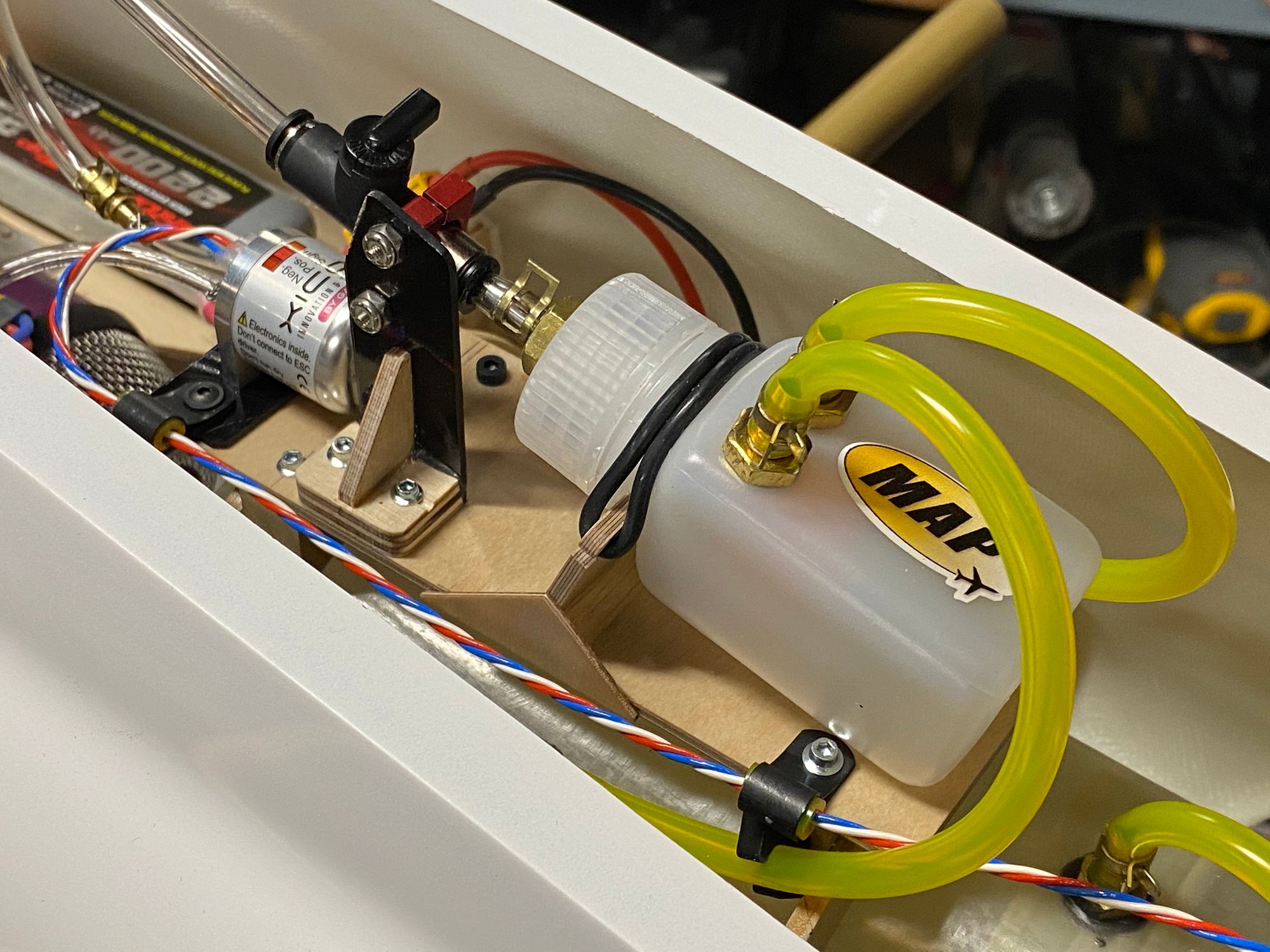

I've made up platform to support the UAT and X45 pump. Getting the tank out of the Wizard is quite a puzzle as support frame is wider than the opening of the fuselage.
I try to think out maintenance and repair of my jets as build them. I hate when changing one servo is a six hour job because everything is buried. The parts of my fuel system are accessible and can be removed easily.
https://cimg2.ibsrv.net/gimg/www.rcu...77755be03.jpeg
https://cimg3.ibsrv.net/gimg/www.rcu...d29f03d69.jpeg
RCISFUN 05-07-2021 09:06 AM
I agree, I try to make everything modular, 4 screws and I can lift out my entire fuel system out of my Sebart mini Avanti
https://cimg6.ibsrv.net/gimg/www.rcu...ac868fecba.jpg
Bob_B 05-07-2021 09:10 AM
Rich Turn the pump around, Xicoy recommend the nipples be upward! It is to minimize bubbles.

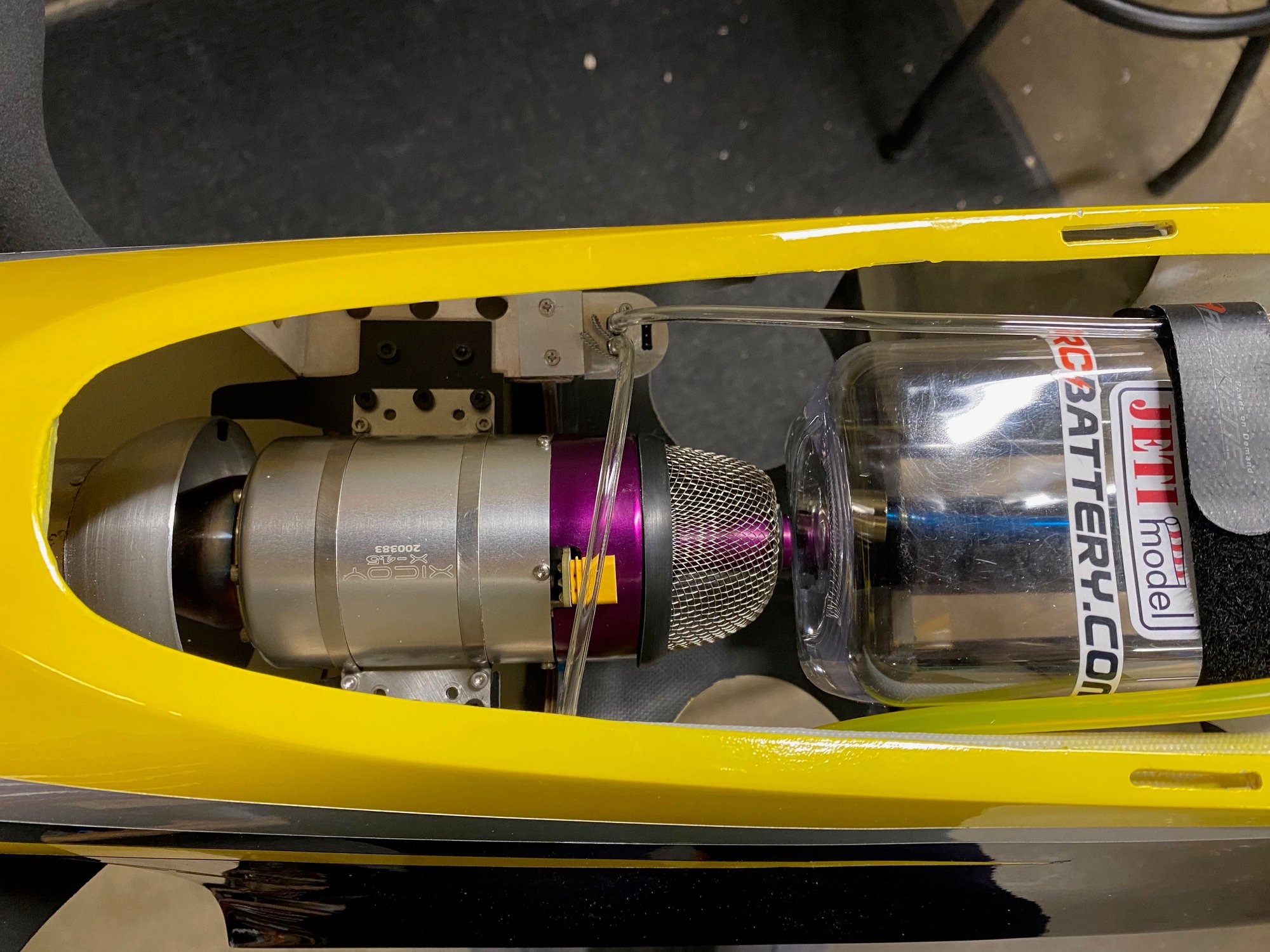

Didier 05-08-2021 08:11 AM
Originally Posted by jvaliensi (Post 12676826)
Hi,
I would like to see your install.
However, the tank is installed the way ZN Line designed. There are no options. I assume JP knows what he was doing when he designed it.
JP is a great designer and the Wizard is a great jet but even great designs can be improved. I already had discussions with JP concerning the CG of the little Wizard but also on the ventral fins that are a big improvement on stability as well. Anyway, the Wizard will fly great with the tank set-up of JP. Can it be improved? In my point of view, yes.
In my Wizard you can clearly see my tank is on the CG and my engine is on the back part of the engine rails. I have flown many EDF jets (airworld cougar, eflite habu, mini avanti) converted to turbine in the past and all had the same issue with commercially available turbine mod kits. Fuel tank in the battery pocket, resulting in noticeable CG shift during flight.
https://cimg9.ibsrv.net/gimg/www.rcu...3f3286903.jpeg
https://cimg0.ibsrv.net/gimg/www.rcu...095abfb1b.jpeg
jvaliensi 05-08-2021 10:36 AM
You fuselage formers are different than mine. I'd have to build an entirely new tank mount to push the tank over the spar and rearwards. I'll see how much the CG changes when I get the gear down.
Your tank looks small for a 70N turbine - whats the capacity?
I did use a Fuji-type bottle in my latest Avanti build and was able to push it back much further than a CM tank can go. The Avanti tends to be nose heavy so this helped quite a bit.
https://cimg2.ibsrv.net/gimg/www.rcu...e78621262.jpeg
Didier 05-08-2021 11:10 AM
This is during the build in 2017 (before I painted it). My formers seems to be the same as yours? The small former in front (red arrow) I made myself to support the front of the fuel tank. My fuel tank is 1.1 liter and it is more then enough for 6 minutes flights with mixed throttle settings. My Wizard is extreme light, so hardly use full power. Only for big loops and verticals.
https://cimg9.ibsrv.net/gimg/www.rcu...31ea75353.jpeg

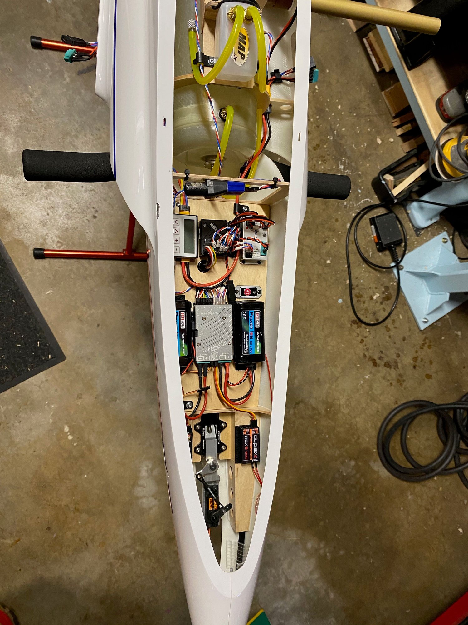

jvaliensi 05-11-2021 11:50 AM
Making progress.
So far, empty weight is 5kg. I think takeoff weight will be under 6.2kg. This is about 1.5kg lighter than my Rebel Hot and it is a similar sized airplane.
https://cimg0.ibsrv.net/gimg/www.rcu...b12f53bc8.jpeg
https://cimg2.ibsrv.net/gimg/www.rcu...785364e0b.jpeg

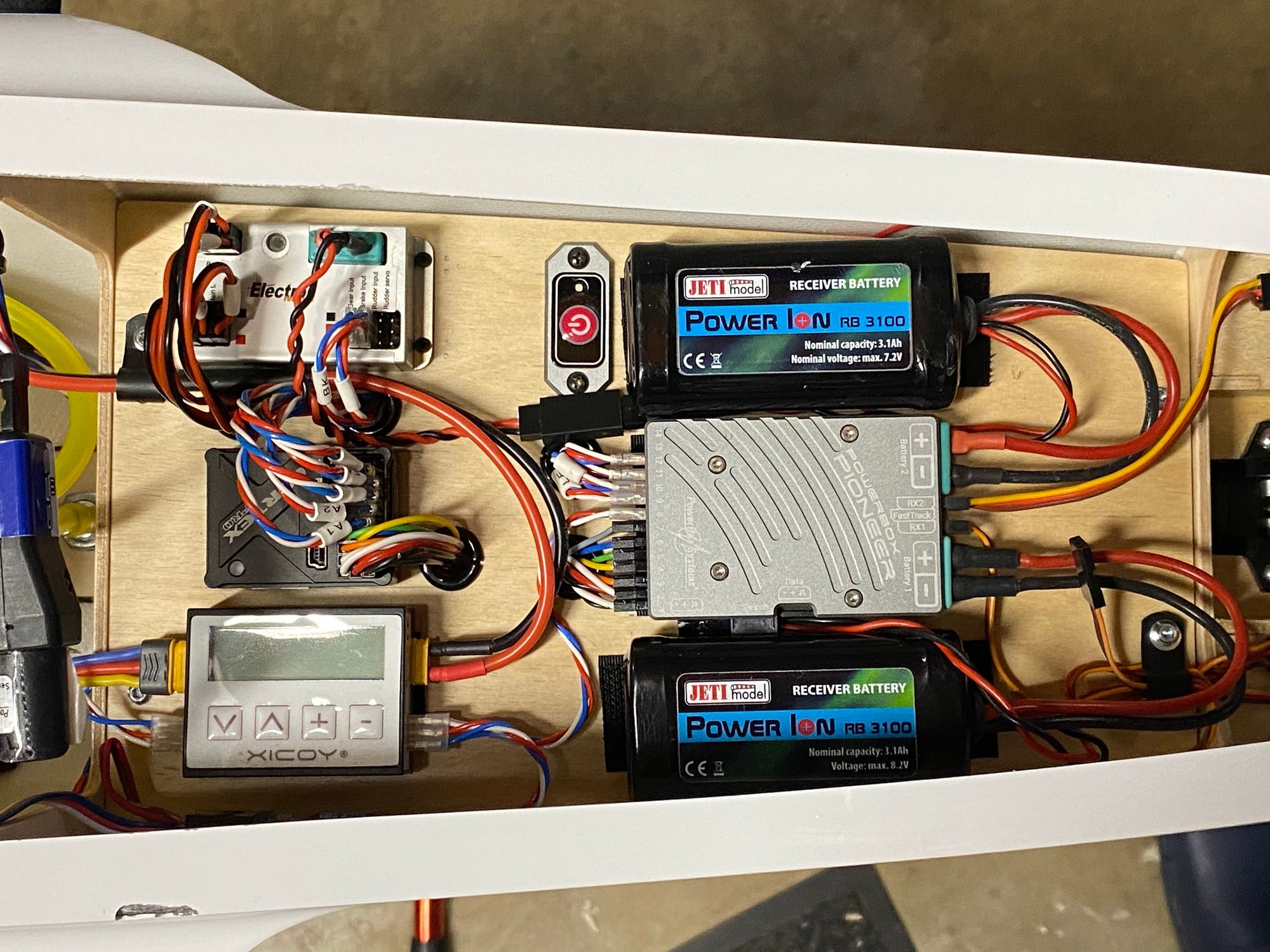

jvaliensi 05-16-2021 06:12 AM
I redid the fuel valve and finished the electronics install. I ended up with three batteries. I just works out better with the Pioneer.
I had bought the Pioneer w/ the iGyro satellite but couldn't figure out how to make it work so I used the Cortex. My wiring arrangement looses the ability to see the Cortex in Device Explorer but I know the Cortex well and can live without that benefit.
Shortly after the photos were taken, I put in the last jumpers, for steering. Even though I've made hundreds of jumpers, I some how shorted out the one between the Cortex and Electron controller. When I powered up, there was sparks and fire. The jumper completely melted and took out another wire. But the Coretx and Electron controller are okay. So, I have to take it apart and replace some wires that got too hot next to the shorted one.
https://cimg9.ibsrv.net/gimg/www.rcu...484f66f12.jpeg
https://cimg0.ibsrv.net/gimg/www.rcu...06576a85b.jpeg
https://cimg1.ibsrv.net/gimg/www.rcu...8f82d3862.jpeg
https://cimg2.ibsrv.net/gimg/www.rcu...ba4b31608.jpeg
https://cimg4.ibsrv.net/gimg/www.rcu...349e01781.jpeg

If you are a Jeti user, why do you use a Pioneer and not a CB2xx? Seems to me so much more convenient? Why do you use 2x 3100mah for RX? I guess you only have to charge once a season. ;-)
I use one LIFe 2S 2100 mah for RX only and one 3S 2100 mah for gear and turbine.
jvaliensi 05-16-2021 09:29 AM
I think what happen was the steering plug goes in to the last (6) spot of the Cortex Pro. Its possible to miss-plug spots 4, 5 & 6 and get the negative pin on the positive pin. This is because the program jumper pins align with the servo pins. Others have done this. If its going straight to a servo then it is not a disaster. But in my case, it was going to the Electron controller, so it made a dead short.
So, far everything still works. I think all the heat went to the jumper and spared the electronics. I will test everything thoroughly.
I lost an airplane because of a CB200. It was my error, but I'm not giving it another chance.
I bought the Pioneer with Gyro for the same costs as a Cortex Pro. And I get dual batteries and telemetry. Seemed like a good deal. I cannot figure the Gyro out and I really like Cortex anyways. The Pioneer made the wiring neat and I do get the other advantages noted.
The Cortex is a very robust device. I've beat the crap out of them (bent cases and bad crashes) and they keep going. I've had at least six of them and no issues. I know how to set it up and like the way the airplane flies.
Two batteries are for the receiver, the third is for the turbine. One RX battery is connected to the landing gear controller.
I could have done the whole thing with one battery and a REX12. Thats how I set up my Avanti S. This airplane is so light the extra batteries do not matter.
