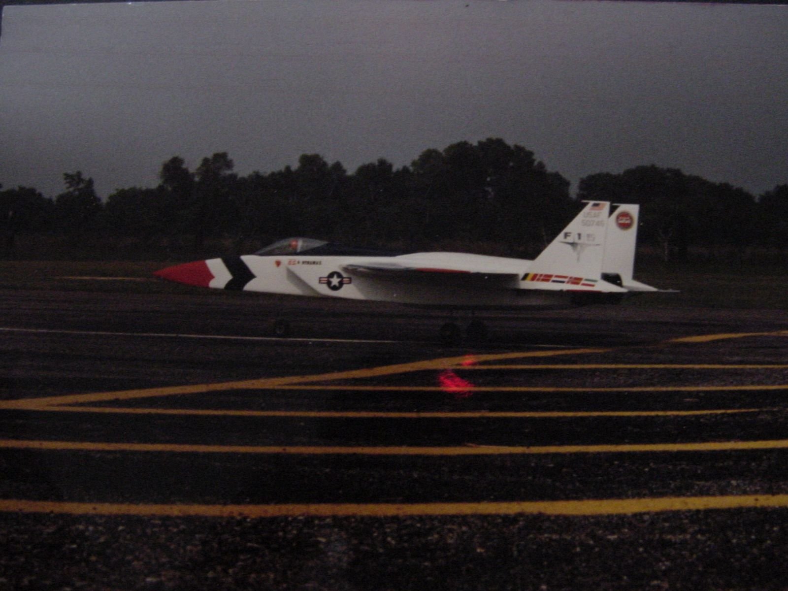

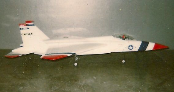

In the early 80's I attended an event in Mulberry Florida and came across Bob Parkinson in the parking lot. After a little talk a friend with me explained that Bob made kits. He had one left in the back of his station wagon, so I purchased my first Regal Eagle.
I was still learning how to fly at this point. The ruggedness of the Regal Eagle proved more durable than any of the other planes I had built till then. ARF's really didn't exist, so if you wanted it you built it. I since then acquired as many kits as I could afford and saved them up for future builds. These were all gas ducted fan designs, most I have yet to build. Since starting with turbines I have been trying to come up with modifications to fly these kits with turbines. The problem being that they are mostly of the size for small turbines, and I only got a small one this past year.
I rebuilt that plane several times till I wore out the pieces. There were three gas ducted fan planes, one designed around a Byron system, one a Dynamax , one a BVM OS 91 system, and one I modified for EDF. Over the years I built four, and eventually crashed them all, from motors blowing up, broken connecting rods, engine flameouts, or battery failure. I saved all the big pieces like wings and had three sets of sheeted cores in the attic.
Flysfloats contacted me about some construction details that were not at all obvious from the prints and this has inspired me to make a modified Regal Eagle out of some of my scrap. He then kindly copied his blueprints and instructions and sent them to me. Thanks Ford!
This latest iteration will be modified for an Xicoy X45 turbine or possibly a 60 newton turbine. The plane will probably end up around eleven pounds dry. I plan on reusing my wings, fins with rudders, horizontal stabs and elevators. I will try and document my process, but will probably do a poor job of that as I have a tendency to problem solve in my head for a while and then descend on the process and build it that night.
If there are any questions, or anyone is interest in pictures I will try and provide them if I haven't already covered up that portion of the build. As I have done most of this build multiple times I have most of what I consider to be problems already worked out, so I hope this will go quickly. That said I am making a major modification at the rear so that may slow me a little.

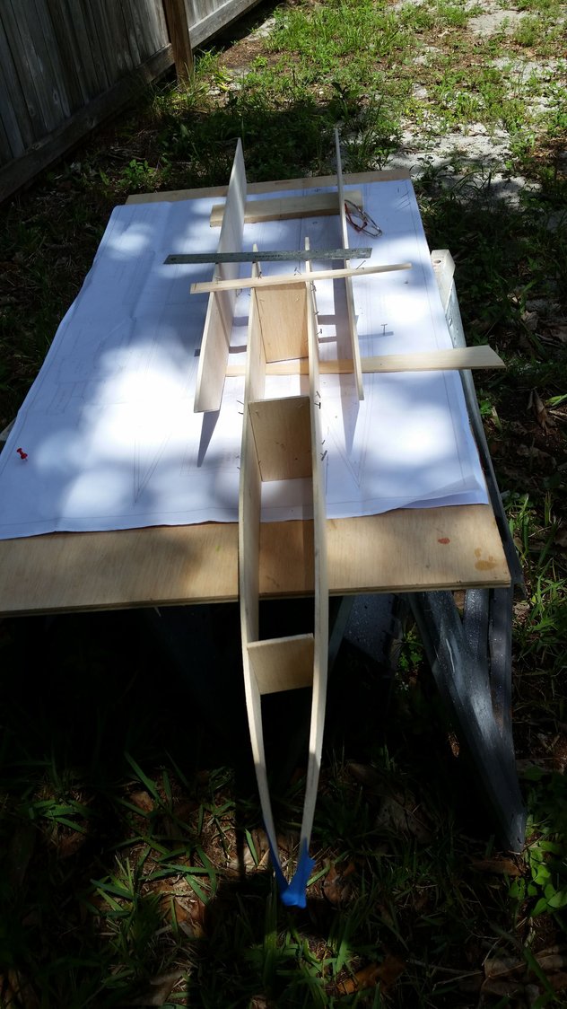

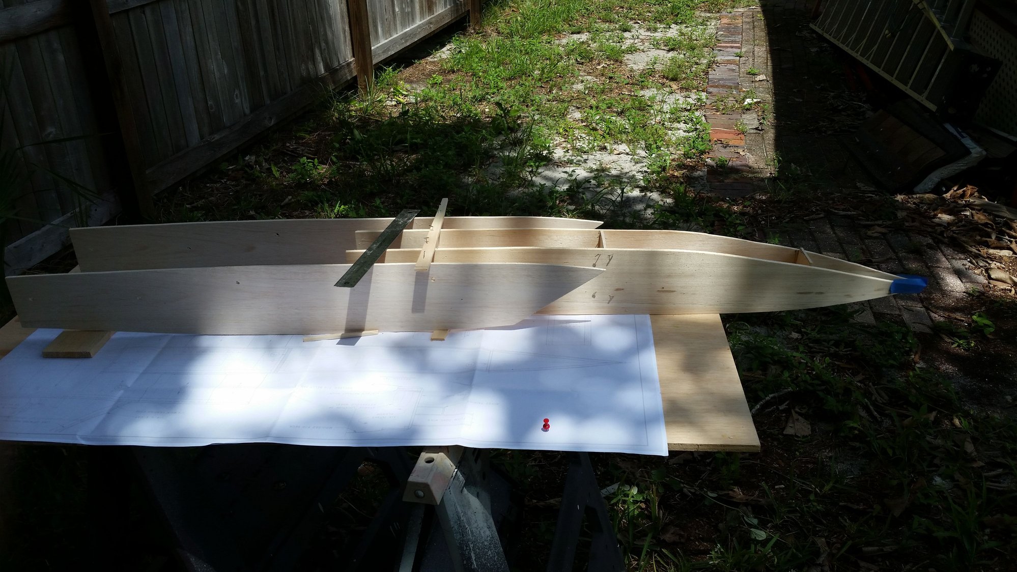

The first upgrade in the build is to reinforce the nose section. I accomplish this with a section of 1/64" wing skin laminated to the inside of the fuse side. This after lining the top and bottom edges with 1/2" triangle stock. The stock is to allow rounding of the corners during the shaping process. An almost 3/4" radius can be achieved this way. Looks way better than a squarish looking corner. I apply the wing skin with Elmers wood glue applied to both facing surfaces then pressed together. This is done before the formers are installed.
I'm ready to put the two sides together as soon as I make and install the nose gear mount. It should be noted that the tip should be propped up during the install of the plywood to allow bending of the side. It isn't as easily done once it dries.

Flysfloats 08-24-2020 01:24 PM
So far I don't see any of the "nose block" triangles?? In these pictures do you consider the sides of the nose block to be finished, except for sanding??

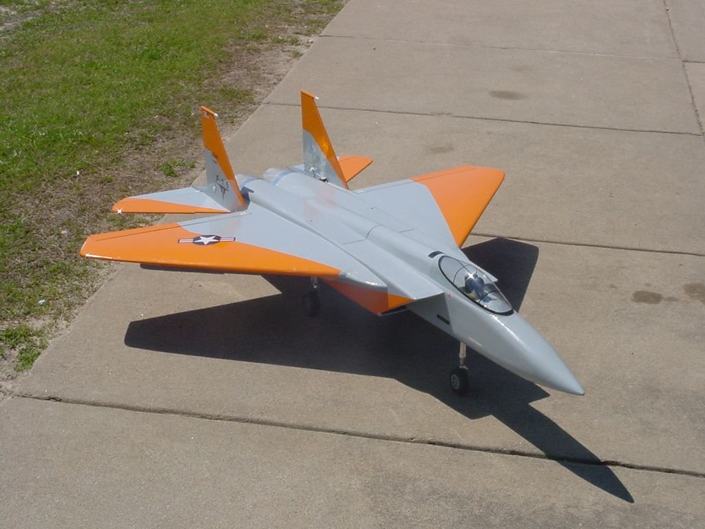

I'be built a few
https://cimg9.ibsrv.net/gimg/www.rcu...762807f517.jpg
First
https://cimg9.ibsrv.net/gimg/www.rcu...a540afac4e.jpg
Second
https://cimg6.ibsrv.net/gimg/www.rcu...99a9b83225.jpg
Third
https://cimg5.ibsrv.net/gimg/www.rcu...a87c6105ab.jpg
Last
https://cimg8.ibsrv.net/gimg/www.rcu...5b1f00654b.jpg
The first was Byron powered. The rest were Dynamax powered.
john491 08-24-2020 02:10 PM
Ford,
The method I used on the nose does away with the triangles. You had the correct orientation in your pictures, my method simply saves a lot of sanding and will also be a little lighter I think. I simply have to sheet the top and bottom and round it all off. I will hold up on sheeting the bottom of the nose for now in case I have to add lead in the nose for balance.
