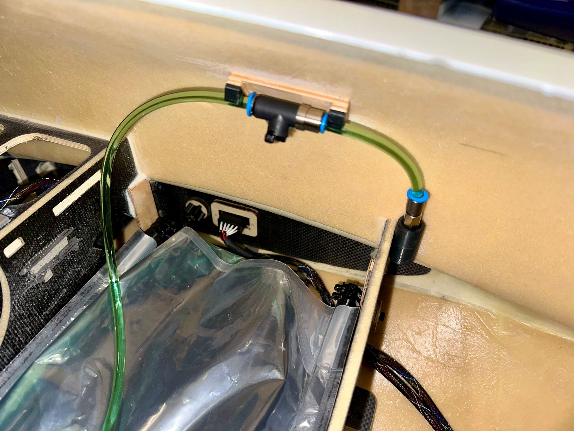

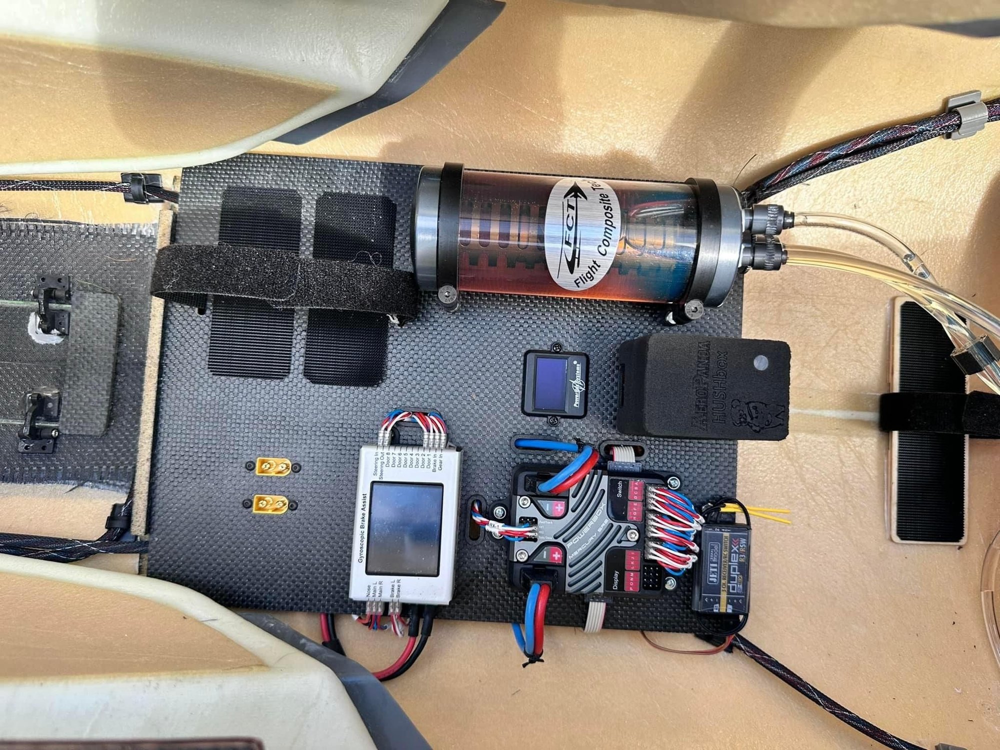

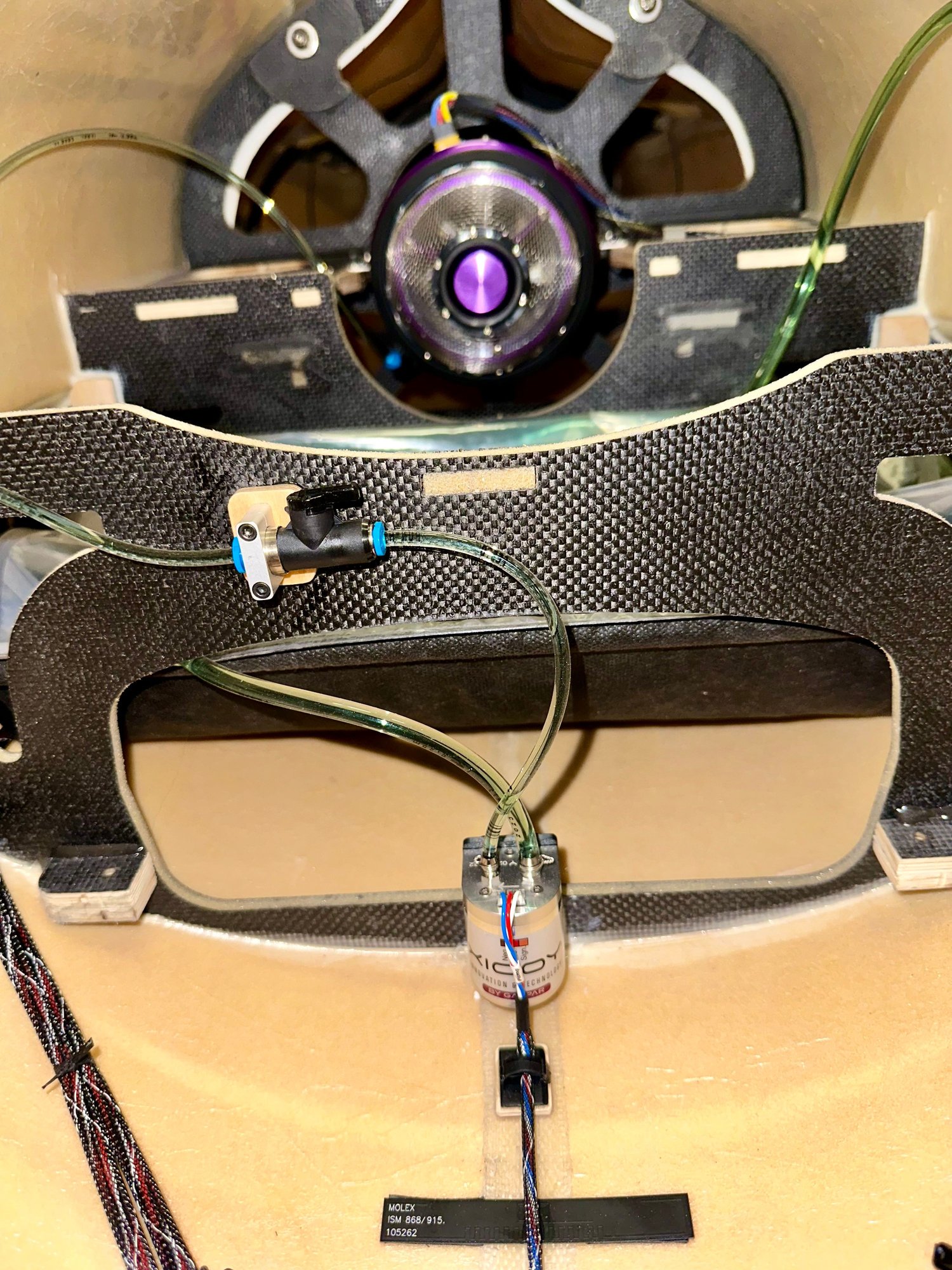

Maiden flights complete on my new Kinetix. Went with a lightweight setup on this one, including a fuel bag in place of the standard tank and UAT. A full set of my new flush mounts keeps the equipment install super clean.
Xicoy X-195
Jeti REX R12/R3 900/R3 RSW
bavarianDEMON Cortex Pro
MKS HBL599/599SL
Electron ER40/GS200
5L fuel bag from Herbert Theil
Empty weight: 14.5kg
