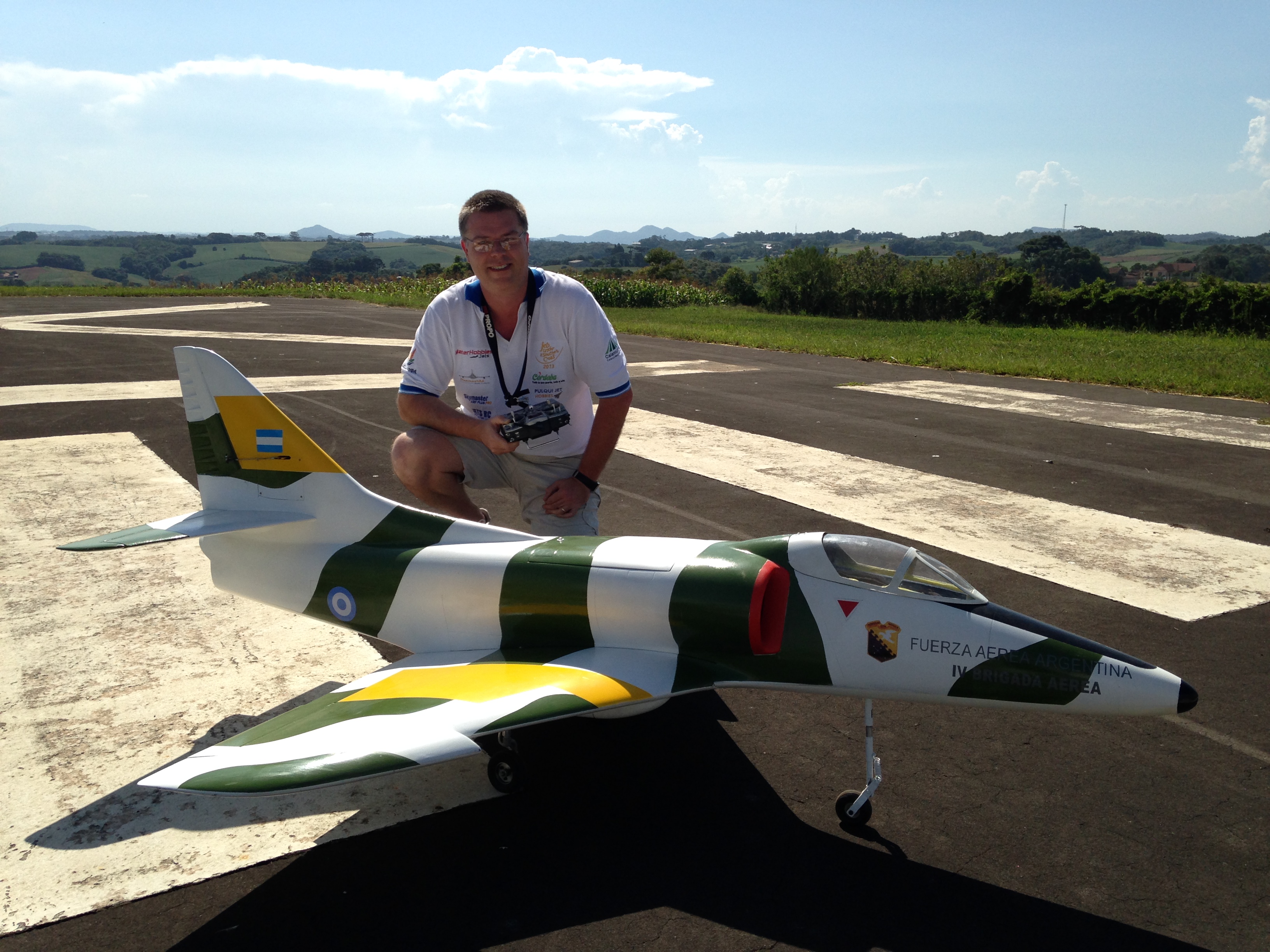

erbroens 02-01-2014 05:34 PM
1 Attachment(s)
Well, I took my time.. but it was well worth the wait! Today I flew it and it is a great jet.. seems that the mod worked very well, and the estimated CG was perfect. Very solid in the air, and viceless at stalls. The day wasn´t ideal, very hot and 90 degrees crosswinds, however everything went well!

erbroens 02-02-2014 03:40 AM
Thanks U,Joe! This place is nice, but kind of unforgiving with jets. 600 feet of strip is plenty enough for normal operations but as it is surrounded with slopes , included steep ones at the headings is easy to break or even loose a plane if something goes wrong with the engine or a landing that isn´t well done. Anyway, I like it very much as it was the best we could do 14 years ago.
