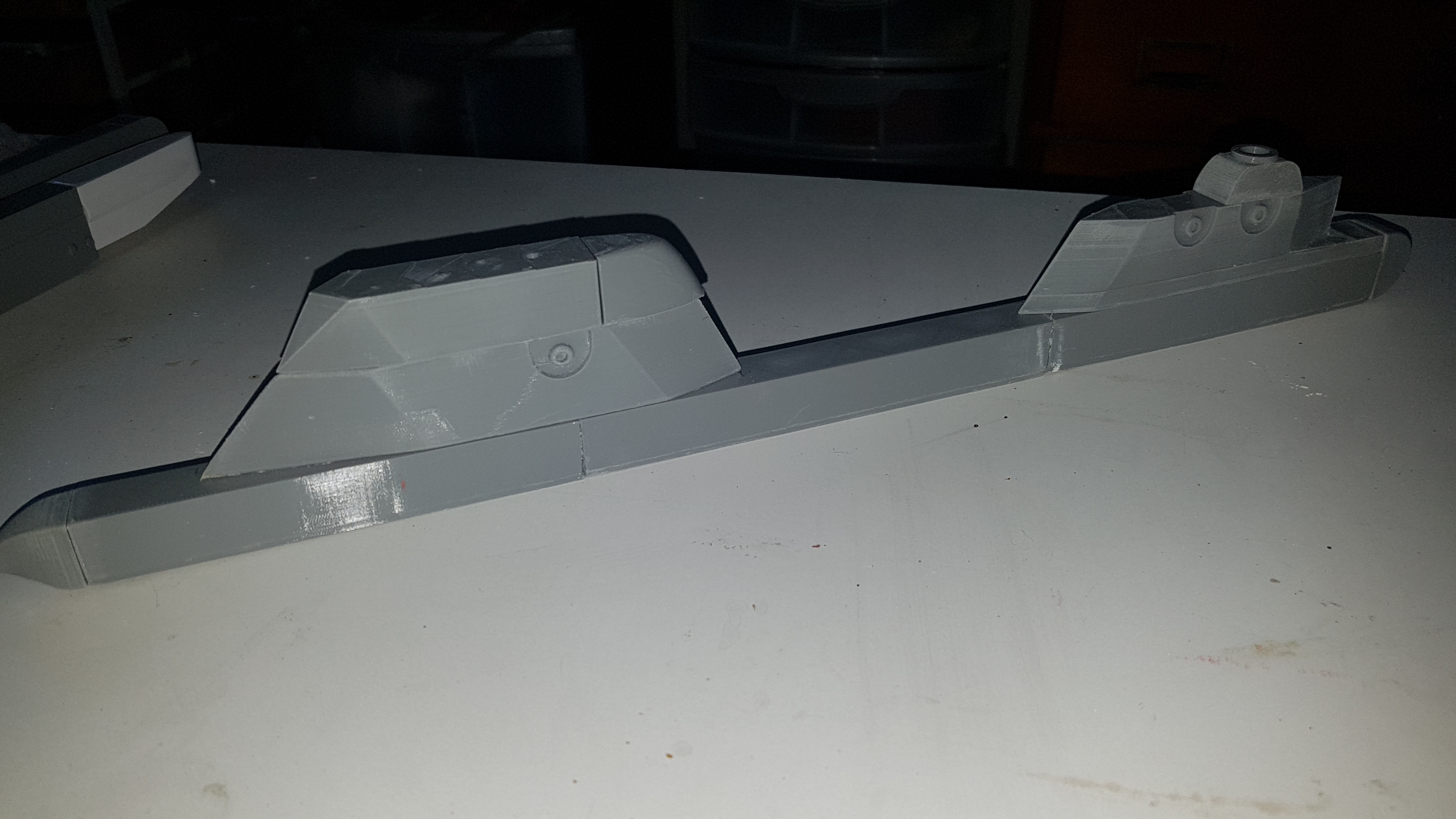

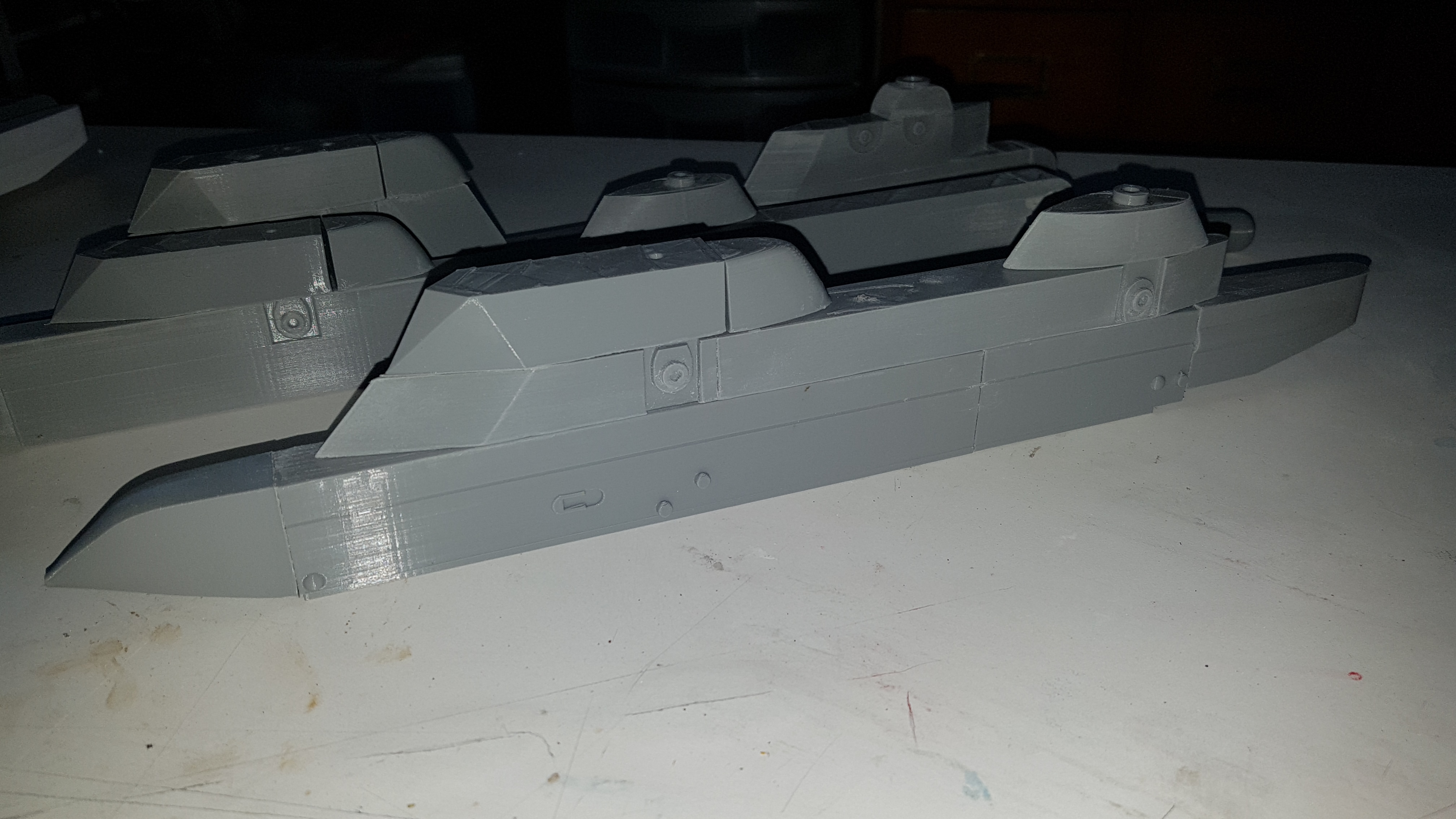

gustavo Campana 02-22-2017 03:16 AM
7 Attachment(s)
http://www.rcuniverse.com/forum/atta...mentid=2202264http://www.rcuniverse.com/forum/atta...mentid=2202265http://www.rcuniverse.com/forum/atta...mentid=2202266http://www.rcuniverse.com/forum/atta...mentid=2202267http://www.rcuniverse.com/forum/atta...mentid=2202268http://www.rcuniverse.com/forum/atta...mentid=2202269http://www.rcuniverse.com/forum/atta...mentid=2202270
dears
this is what I have.
maked by 3d printer, my self,
understand , its not a commercial item, just for me.
to make a scale parts, you must to work for details,
maked in pla.
thanks
gus

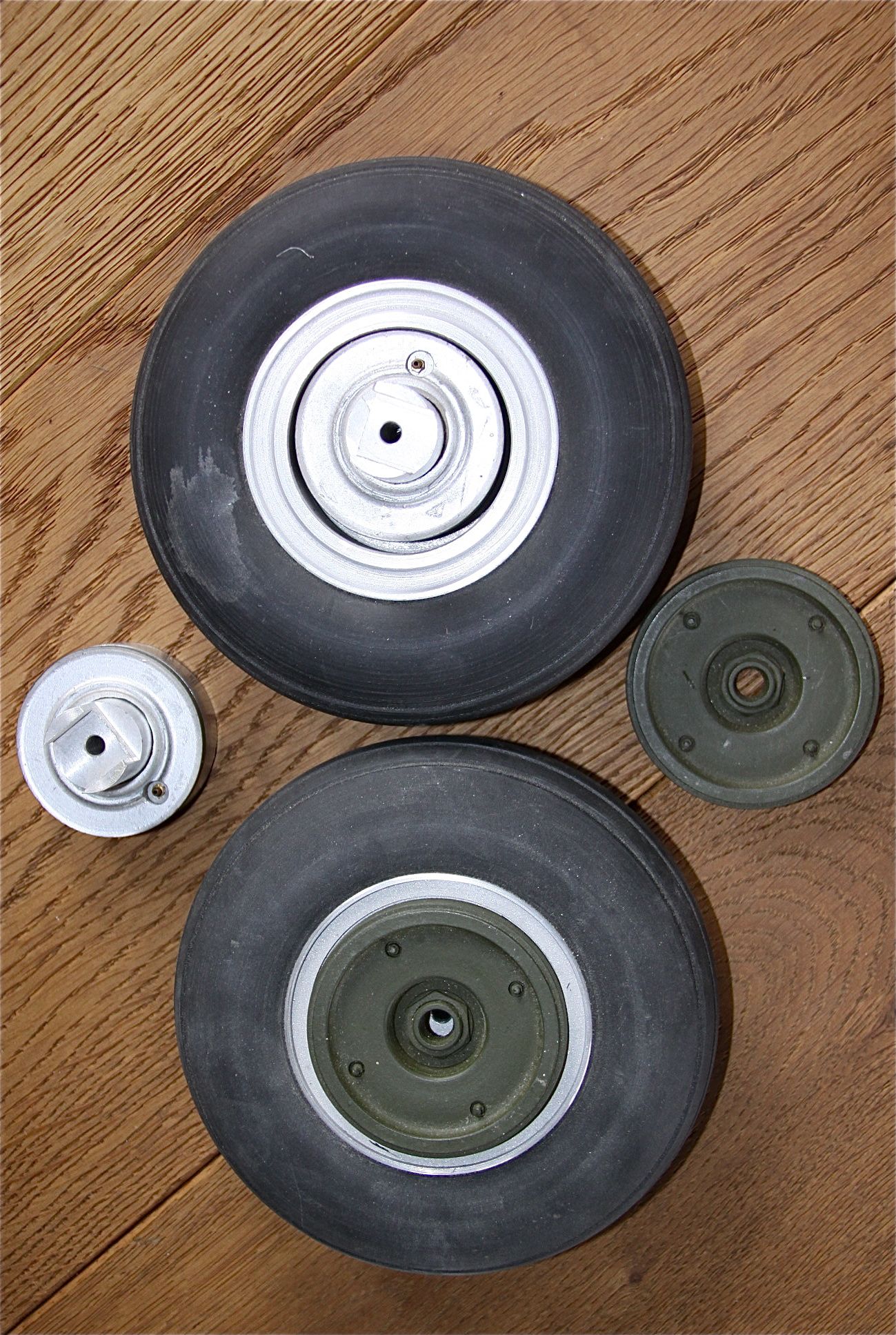

David Gladwin 03-05-2017 09:17 AM
1 Attachment(s)
For Spaceman, Mig wheels !
http://www.rcuniverse.com/forum/atta...mentid=2204028

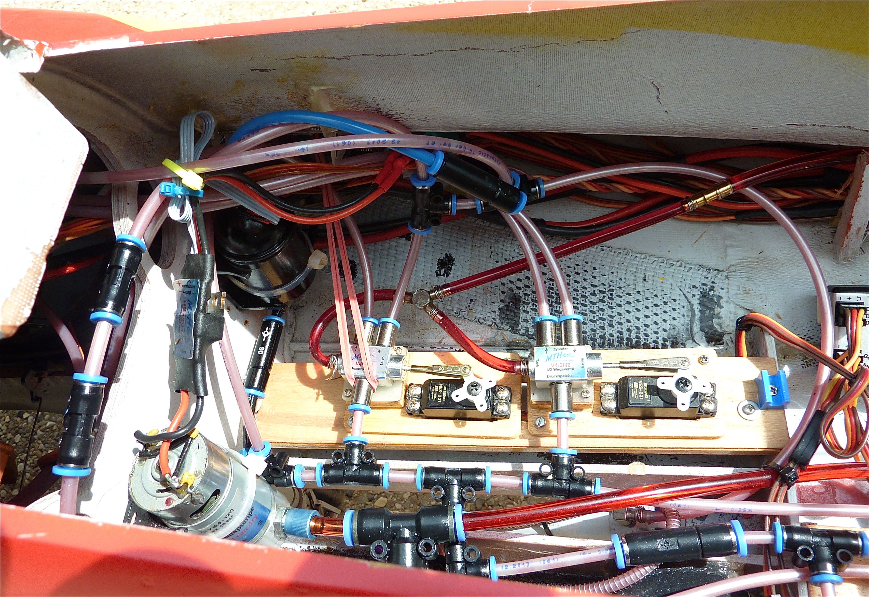

How many solenoids are used with the Hausi system for the landing gear. The original block was three? I want to make sure I order enough. I was thinking of using the hydraulic system only on the gear and doors and use air for the rest. What do you guys think
Johm
David Gladwin 03-07-2017 06:01 AM
1 Attachment(s)
No solenoids, just mini servo operated valves.You need one for gear, another for doors, another for intakes if you use them, and another for speedbrakes, mine s.b. s and intakes are locked open. You could easily use air for these.
David. http://www.rcuniverse.com/forum/atta...mentid=2204301
