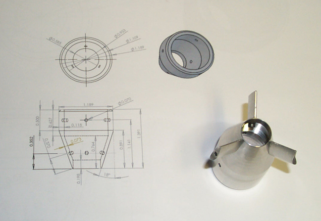

sidgates 03-22-2015 06:35 AM
5 Attachment(s)
Coka - Your last post reminded me that I replaced the "flat" nut with a conical one I purchased from WREN. You can buy one from them that has the magnet. I was also able to move the motor thrust bearing from the burned out motors to the new motors.
A larger bendix was used and I got a couple from someone in Florida. It uses set screws to retain the bendix. I was able to pull the old bendix off the motor but destroyed the motor but that didn't matter because it burned out any way. The new larger bendix is much better and easier to work with. I found some pictures and I think this is the right drawing but not sure.
http://www.rcuniverse.com/forum/atta...mentid=2083138http://www.rcuniverse.com/forum/atta...mentid=2083139http://www.rcuniverse.com/forum/atta...mentid=2083140http://www.rcuniverse.com/forum/atta...mentid=2083143http://www.rcuniverse.com/forum/atta...mentid=2083141

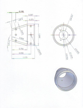

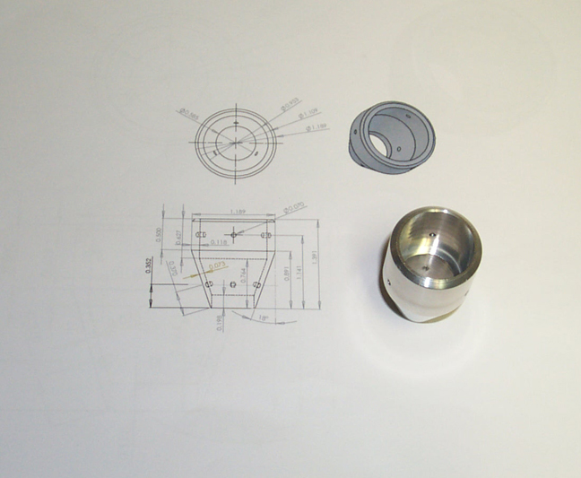

rjpmodel 03-22-2015 08:03 AM
I have some of the latest bendix with set screws available.
coka 03-23-2015 12:34 AM
Bob
Any picture?
Price?
Some further info?
rjpmodel 03-23-2015 06:24 AM
3 Attachment(s)
I hope the pictures sof the bendix show here. This is brand new from Modellbau purchased from Modelbau a number of years ago. $25 which is what they sold them for years ago. These are special bendix with set screws rather that pressed fit. The pressed fit ones are Very hard to remove. These are for the latest spinner nut shown in picture but I do not have any available.
