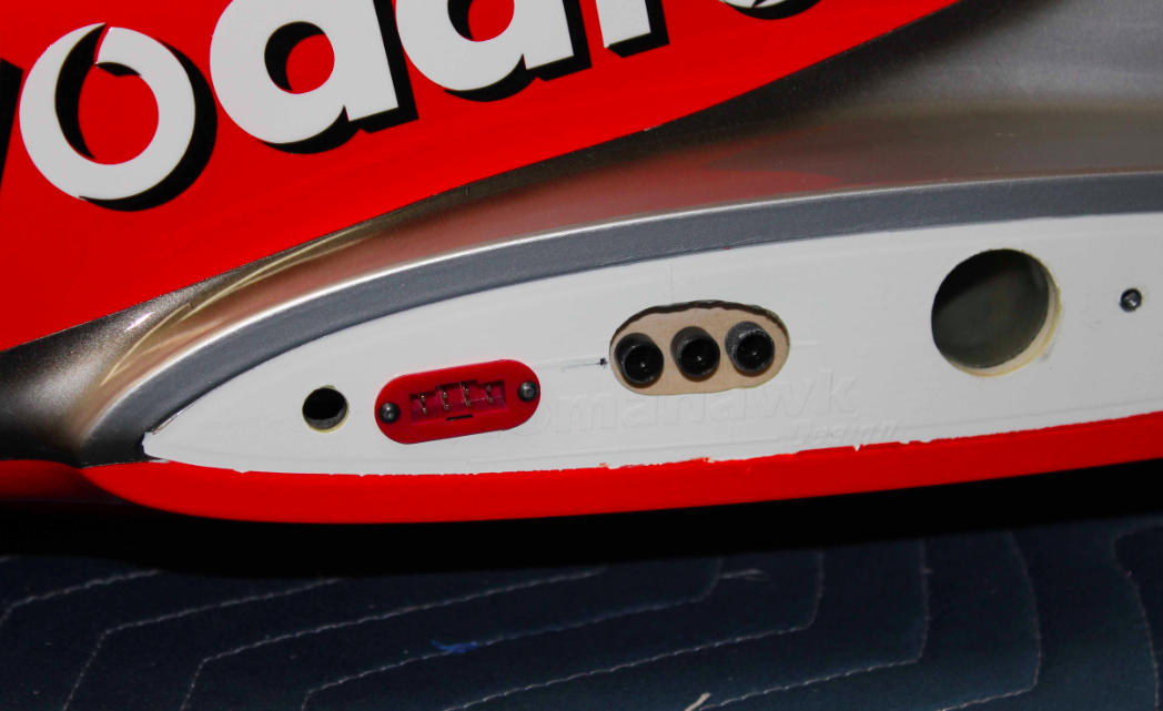

siclick33 01-05-2014 12:44 AM
Could I please ask how people have routed the servo/air cables in the wing? I would like them to exit the wing root forward of the wing tube and I see many others have done this, however there is no obvious hole to pass the wires through.
Do I need to cut a hole in the forward wing spar? If so, do you think I can make the hole big enough to pass a Multiplex plug through without weakening the wing?
DrScoles 01-05-2014 06:03 AM
2 Attachment(s)
I bought mine used, but added the plug in air fittings and the red connector. I can't stand those little white air fittings. You could get away with much smaller holes than you see here. I did all the soldering after the wires passed through.
http://www.rcuniverse.com/forum/atta...mentid=1954522http://www.rcuniverse.com/forum/atta...mentid=1954523
siclick33 01-05-2014 06:16 AM
Thanks very much for the pictures; that's pretty much what I want to do.
I assume that the cables pass through a hole in the forward spar? I can't see how else they can route from the gear/servo area to where you have them exit the wing.

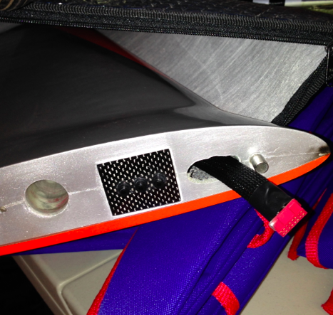

lxfly 01-05-2014 11:22 AM
1 Attachment(s)
Even no problem to open like this: http://www.rcuniverse.com/forum/atta...mentid=1954624
siclick33 01-05-2014 11:53 AM
But where do the wires go inside the wing?
Have you made a hole in the forward wing spar (e.g. near the aileron servo mount) or have you routed the wires over the outer wing tube?

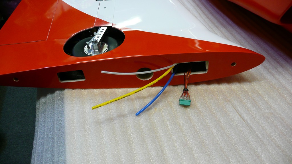

Zeeb 01-06-2014 01:14 PM
1 Attachment(s)
Well I'm going to have to eat some crow as mine finally showed up but it was just two days shy of 4 months. I'd have never ordered it if I'd known I'd be waiting that long but in truth I wasn't exactly sure I was even going to get one. With that thought in mind I've bought two other jets since I ordered the ViperJet and figured if it ever did show up I'd probably sell the thing.
That said; the little sucker is just gorgeous, the workmanship is outstanding and that landing gear which I paid for the electric conversion is just a work of art. I may have to keep the thing.....
For siclick33; after your questions and Rene's responses I went and looked inside the gear wells of the model I just got. The spar is built solid outboard of the gear mouning area. But right there the thing looks like it splits into two pieces with one running down each side of the tube. Each of those sides has square holes cut out of them where they glue the tube and there looks to be enough room to run wires or airlines forward of the wing tube. The spaces on top of the wing tube are not very big, you may have to pull the plastic housings off your servo leads to get 'em through and put those back on later but should not need any drilling of the spar if done that way.
lxfly 01-07-2014 01:05 AM
Thanks Zeeb for setting the point. I couldn't find any photo of my tube rooting, but I think to remember that I passed servo cable and 3mm tubes through the spar just over the wing tube (about where the wheel opening is). As I use the MPX plugs to connect servos, I always cut off the original servo plug and as normally you also have to extent the cable, getting throug these small openings is no problem.
Zeeb: nice scheme, here is mine from the 2.5 :)
