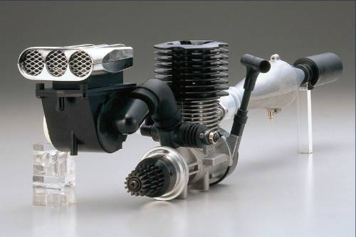

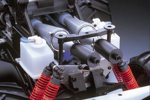

Sounds simple, but the Giga Crusher DFs use a lot of cost cutting so the engines don't have mounts and actually screw right to the motor plates. The engines are also ABN. I walked away from this project before because it is like $300 in Kyosho parts to convert a non GS engine to a pair of regular 21 engines (not including engines). I really studied it last night and I think I can do it for a much, much lower price so I am going for it ($100 total). Along the way I am making some big changes.
Here is a stock Giga Crusher DF. You can see how the exhaust runs down the center and that the tiny little gas tanks sit off to the sides.
I am going to move the exhaust to the outside of the frame rails with a custom exhaust and put 1/8 buggy fuel tanks on the inside for better run times.

First step- get GS-26's outta there. I have to remember to thank Kyosho for the .02 cents they saved for casting the mounts into the engines instead of having a standard .21 mount. Thanks Kyosho. Really.
This is what I am up against-
Here is an MGT engine mount that I will reverse engineer onto the Giga. Not a good fit like this.
Mount goes on a lot better backwards. Bingo! Plus it keeps the stock holes untouched, so I can always put the stockers back on.
Only problem with the brace is the angle support won't clear the engine backplates. Probably important for an MGT, but since this truck has the cool integrated roll cage, the cooling head won't take a direct hit. So, off goes the angle supports.
Before-
After; Positions the engine perfectly for a good mesh.
The next step is to remove some material from the MGT engine mount so the engine shafts sit at the same height. You can see that the GS-26 is lower by about .242". I will remove .12" from the top of the MGT mount and .12" from the bottom of the mount.

Today went EXTREMELY well. After I played with the MGT a bit, it adapter very well onto the chassis. I got the engine bolted down with the perfect amount of adjustability to get the clutchbell/spur mesh right. The mesh is perfect.
The Mach 26 you see is just a mock up engine. Just a placeholder for the Axials. So far the upgrade is 100% reversible! I am happy with that.
Here is pic one of the engine mounted and screwed to the giga chassis. Plenty of clearance from the front driveshaft and outdrive.
Pic of the alignment and gear mesh. I am confident that the mount will not be able to readjust and wipe out the plastic spurs. This went better then expected. Hopefully the mount holds up being reverse mounted and weakened from the material I took off. I suspect it will hold up ok. There is still a lot more material then your typical 1/8 buggy mount.
This is where I got really excited. My exhaust idea was PERFECT from what I pictured in my head. I bought the stuff without knowing if it would work or not. I used a Savage header to clear the rollcage assembly and then an XTM manifold/pipe from a Monster MT to route right down the side of the chassis. It turned out exactly how I hoped it would. I will get some nice matching silicone couplers when the truck gets finally built. Also, I am going to brace where the two headers meet. Picture one of those fire breathers on each side of the truck!
Finally a teaser shot with the body on and the exhaust poking out. Looks pretty wicked to me.
