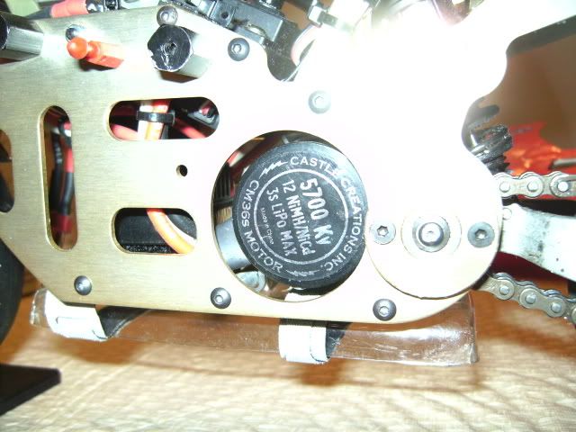

I have the same bike that you just ordered.. I gave up on the stock motor as soon as I squeezed the trigger the first time.. I installed a MM sidewinder and mm5700 motor.. I didn't bother running a lipo in there for the simple reason of crash protection.. I have lipo's in my Rustler and Heli but when the bike crashes, it can be very violent.. I just couldn't justify ruining a $80 lipo for a bit more speed which isn't needed unless you are racing... I can still pull a wheelie when I can get enough traction.. I'm running a 14 pinion with the upgraded chain and rear swing arm.. I changed the steering to a shock damped push-pull system.. that alone should be one of the first upgrades.. Obviously changed the front and rear tires to nitro tires.. Rounder and softer... I kept the rear shock stock.. I added a traxxas shock spacer to adjust the ride height, but I like it on the soft side... The front forks are stock, but I changed the spring rates to a slightly softer rate.. The parking lot where I run has some cracks and objects on the ground and I want the bike to absorb the bumps, not launch over them.. The stock radio works, but you should upgrade to something with a dual rate.. the steering is too sensitive in without this...

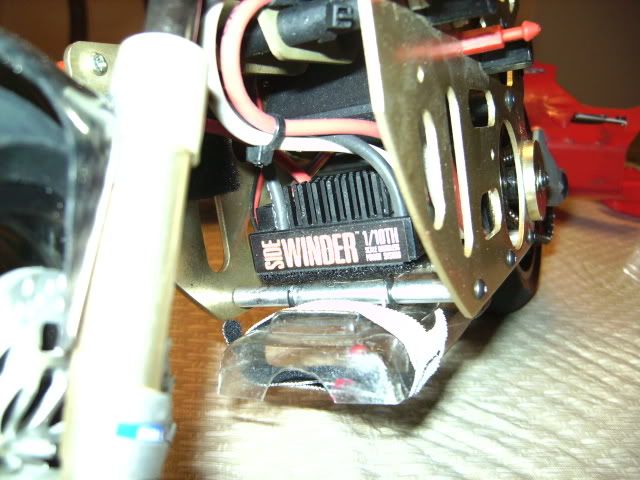

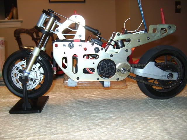

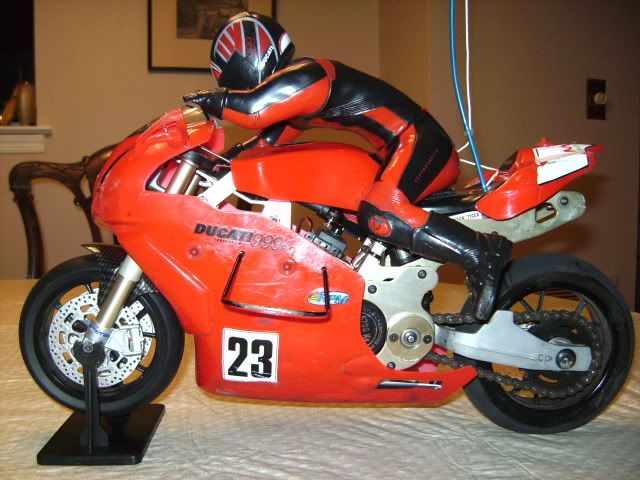

She arrived today! I quickly threw open the box, took one look at the radio system, and said, "not gonna even run you!". So off with the body work to stick my Spektrum SR3001 RX. Then After looking at the ESC....not bad, but I have a Tekin R1 pro sitting in my box with a 3700KV motor, that will do nicely! After dropping the battery tray the motor just drops out after removing 2 screws...easy enough. So after replacing the electronics and adding a deans connector to the battery, I programmed everything and set-up the esc, she looks good, but I noticed the chain was extremely tight, so I loosened the rear axle and put just a little play to the chain, now the motor doesnt sound like it struggling to get the rear wheel moving. The next thing to go was the rubber bands holding the batt in, I had a set of velcro straps left over from my Scorpion crawler that worked perfectly....She was ready to go. I must say the bike is really well designed and looks rugged, I didnt get my new tires yet, so I'm stuck with those terrible kit tires. My front tire is the V shaped one, and right away when I tried to run it, any small deflection of the steering makes it go into a turn. So it seems you're either going straight or in a steep turn......nothing inbetween. Guess the new front tire will cure that. So far I'm pleased with it, and will run it after the new tires show up.

I found the same thing with the "V" shaped front tire. A round shaped tread is the way to go. Did you also install the steering damper? Post up some pics for us!!
