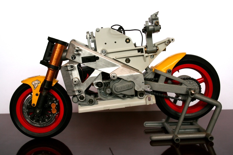

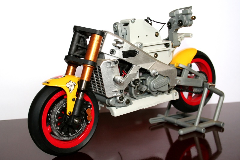

#47
Join Date: May 2010
Location: New Cumnock, UNITED KINGDOM
Posts: 9
I've been busy painting the bike
The swing arm is not painted because I already got the single sided swing arm conversion set on sale (Atomic - 53.00 USD) but, first I want to get used to operating the bike.
I only have two pics for now.
