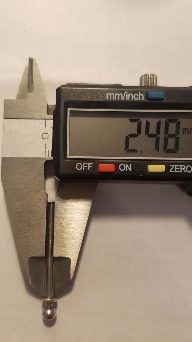

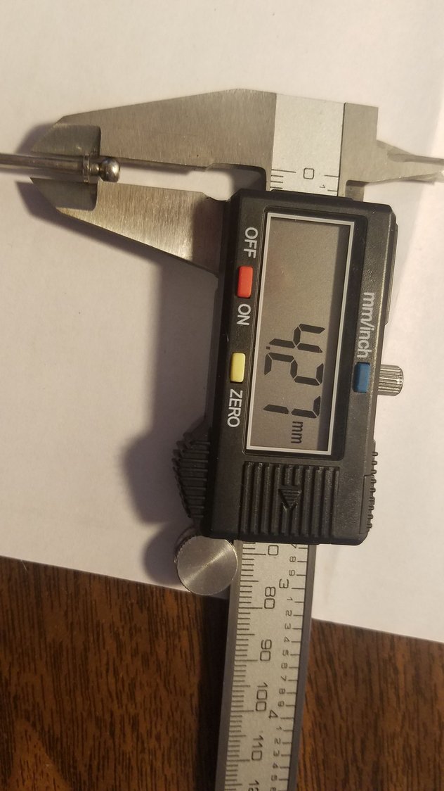

Got the original adjustable servo saver shaft pretty cheap and found out that i had 5x8x2,5mm bearings, so i thought to draw the plastic parts for it:
It took couple of tries, but now it should be smooth (final test print ongoing, 30min to go).

Duratrax kingpin measurements,
please note there are 2 length measurements, one to the slot for e-clip, one total length.
hope that helps!
sorry for the delay in getting those to you.

HiTec90 (03-09-2020)

But yea, as for the topic; that helps greatly! Overall length is not needed, i can see that the balljoint stud has enough space for the balljoint ends to turn freely on full suspension compression.
Big thanks! Im ordering those right away.
