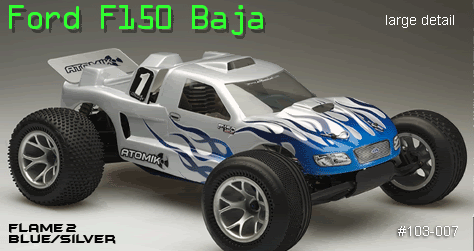

k, well this was what I wanted to do... i want a silver base coat with flames on hood and from fenders with the colors of light blue fadin into a dark blue with white outlining of the flames.... so would I do the silver(base) first?or the blue flame first??? bcuz I read that ur supposed to do the darker color first... ? I want it to look like this...

Ok cut out the outline that your gonna do in white. then spray the outline white. Then use a hair dryer to dry the paint then peel the flames out and paint the lighter blue then the darker blue. Practicing fading on a 2 liter cut in half first though so you get used to fading. I hope this makes sense. And the yes was to the question you asked about if you lay the darker colors first. I'll post a pic of a truck I did that was silver with flames that fade from light blue to dark blue.

No white outline though. It also color shifts to red.
