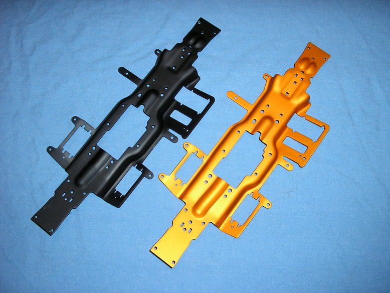

These are a couple of Revo chassis we anodized.. WHat do you think?? What colors would you like to see?

how do you go about doing that?
is it like electrolysis?
nice job btw [8D]

Thanks.. It involves water,Lots of distilled water, stripper,degreaser,desmutting, battery acid, 6amps of power for about an hour... than dying the anodize and sealing...

do you connect the chassis to the anode or cathode and another electrode to the opposite of what u connect the chassis to?

The chassis is the anode and you connect the postive lead to it.

ok i know, but thanks anyway [8D]
i was just wondering if it was electrolysis - which it is
i turned a 1p into a 5p by electrolysis once (Pounds sterling)
