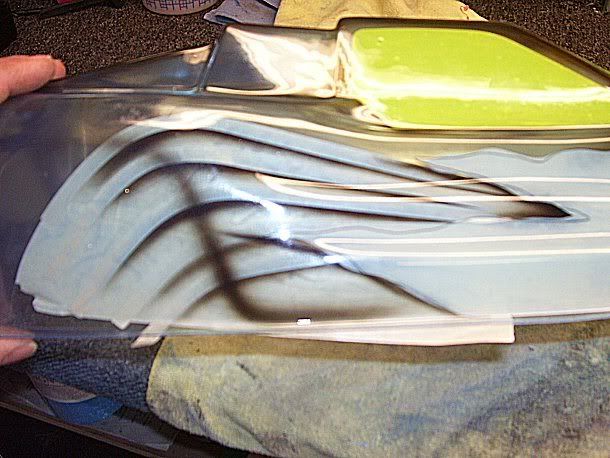

now for this pic i used a Iwata Eclipse HP-CS same ones we let or Students use and run around 95.00 to 100.00
if you get one of these be sure to get it with the "Teflon Needle Bearing" that way you can spary "Anything" water based Lacqure based and the ever Popular Poloyurethanes used more and more here in California
but what ever brand you use or Get, be sure you "Feel" comfortable with it... no need to get some $400.00 Custom Iwata Micron
there great we use those too but mostly for our "Photo Restoration" we do as well...

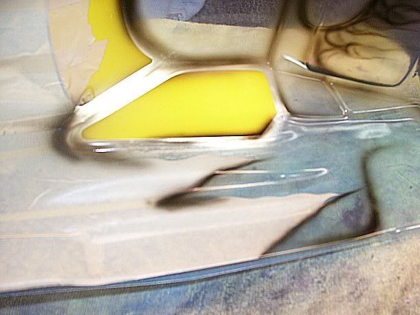

ok, so here the customer wanted some Black shading, so we hita Quick shade around some of the edges.

i just pulled the tape off because the "White" when we hit it will not be "Super White" but a few shades different...
so it doesn't look "Totaly all White"
and then hit the entire body with the white, and Viola!! the end result....
i do hope tis can help, and Instill everyones "Confidance" to try it...

and becasue the back where the stripes are i did those "Undershadows" remember those...
