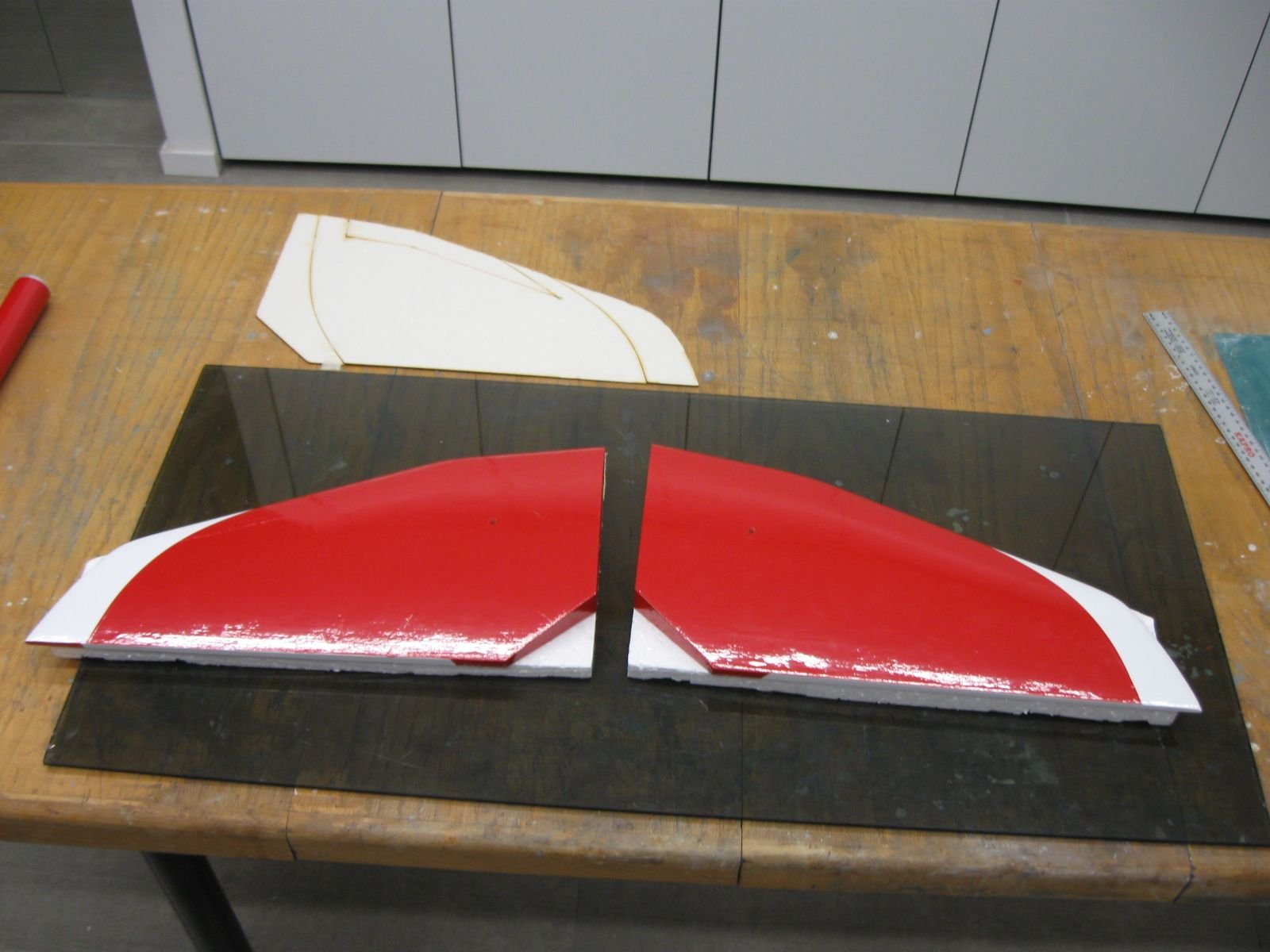

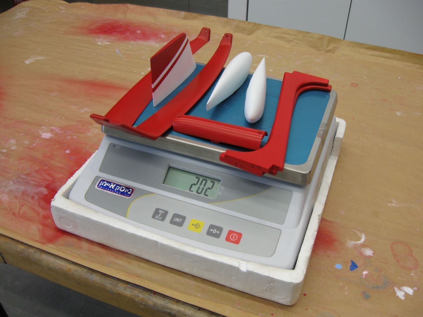

Old 06-26-2018, 01:13 AM
  #53
najary
najary's Avatar
Join Date: May 2003
Location: Ramat Hashrone, ISRAEL
Posts: 1,158
Received 28 Likes on 25 Posts
Finish process, step 1
Old 06-26-2018, 10:22 PM
  #54
najary
najary's Avatar
Join Date: May 2003
Posts: 1,158
Finish process, step 2

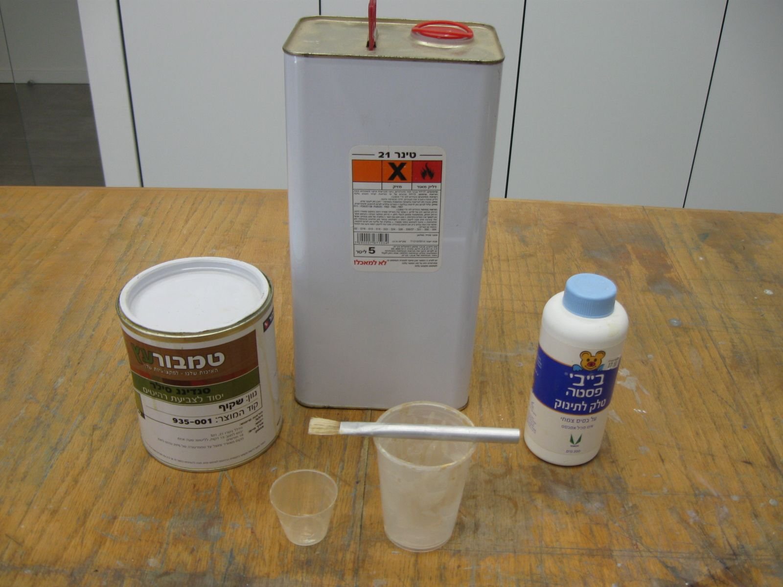

Originally Posted by RuneG View Post
Hi
I see you use silk how is that to work With compare to glas? do you have a link to the type you use?
Hi Rune,
I have used micro glass (18 gram/meter) with epoxy many times, but after using the silk with sanding siller (10 gram/meter) I will never go back to the micro glass!!!
The weaving of the silk is much denser so you do not have to use so much material to fill the holes in the fabric.
Sanding the sanding siller is easier than sanding the epoxy, and if you sand too much and go through the fabric; with the micro glass and the epoxy it is very difficult to fix that, but with the silk you even don't fill it, maybe because the balsa and the silk are both organic materials.
Here is a link to a shop in Japan, just send them an email, they deliver worldwide [email protected]
ƒtƒ‰ƒCƒgƒzƒr[»ƒVƒ‹ƒN
Best regards,
Isaac Najary

Originally Posted by MAVROS View Post
Hi Najary,
What sanding sealer are you using.....is it like dope.
Sorry my Hebru not so good.
regards
It is some thing like this:
https://plascon.com/products/product...sanding-sealer
Best regards
ISAAC najary
