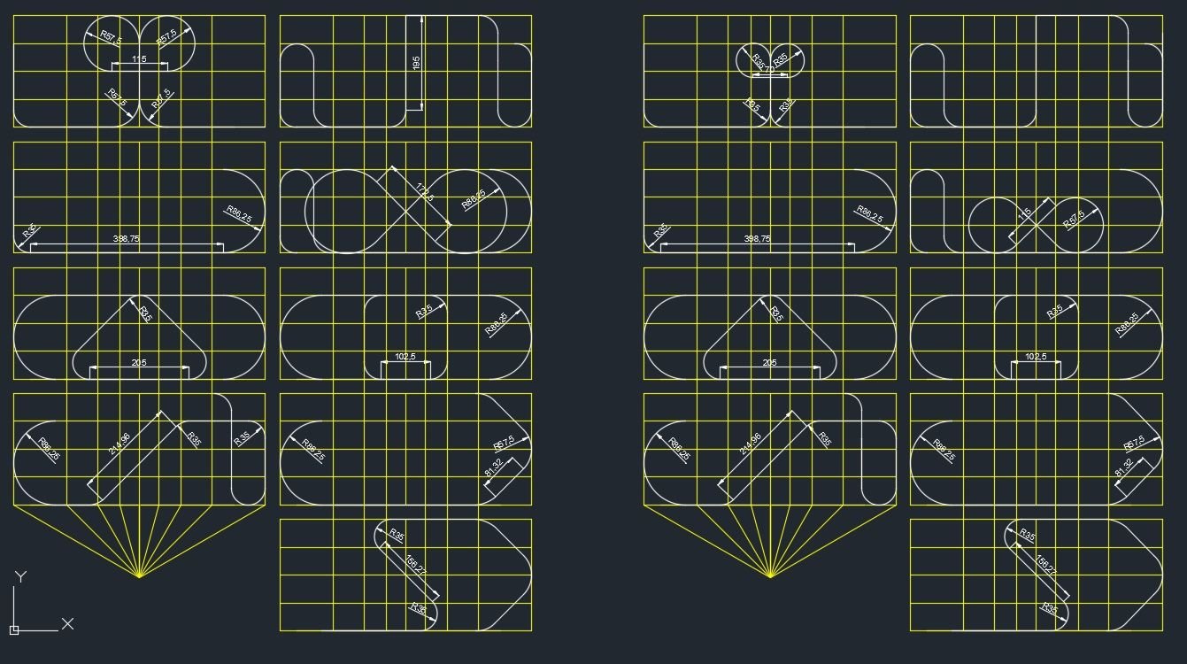

Gents - for your consideration. I believe strongly that P21 is a train-wreck of a sequence, due to its flow. In general, the turnarounds finish too close to center. While there are some nuisances; the worst part starts from the Figure Z, Comet, 4-Point Roll. I have less satisfaction flying this sequence than any other USA Pattern or FAI P sequence, at anytime.
Are there any options to solicit input & correct this sequence? I don't think it is possible that a group of pilots seriously flew this prior to assigning, and believed it would be a good sequence. Perhaps I am the only one that feels this way.

Come into Figure Z slow with tight radius just past center, making the maneuver not too tall at the top as a result. Start the comet later, make the down line shorter and resulting 3/4 loop high and tight which brings it down with enough room to do straight and level before the 4 point.

Thanks Don,
I'll give the later-high/tight comet approach a try. Hope all is going well for you.

I haven't done it for the past sequence but given the discussion I might do it for P21, that is draw the sequence in AutoCAD. Drawing up the sequence in CAD is a good way of figuring out how a sequence can fit together and what sizes things may need to be flown.
I started doing this after reading something on the control line stunt subject where somebody was wanting to animate a stunt sequence for a project and realised some of the geometric judging criteria could not be met on some maneuvers by an aircraft flying on a hemisphere.
For the rough estimate speed I fly I try to pick two radii for corners and part loops and see how it fits together. For me a good starting point for a loop radius is one where I can comfortably integrate a 1/2 roll in a 1/4 loop section without it looking forced. Here's the drawing I did for P15, just looking at how things fit in a "typical" 60 degree box at 150m with a 40m baseline height. Not many maneuvers could be flown to the full top height in that one if you wanted reasonably consistent radii and everything to fit.

Originally Posted by Don Szczur View Post
Jim,
See you,
Don
Are you sure performing the loop high gives you more room for the 4 point roll?
Comet Loop Low vs High. Much more distance from exit to centre when performing the loop low.

Going all the way to the top of the box simply isn't going to work here.
That Z then Comet probably needs to be flown like "4" to make room for the 4 point roll.

Loop higher meaning picture number 3 with a smaller radius (than I was originally flying). The loop is visually "higher" at least that what was going through my mind when working the maneuver into the sequence flow. I am sure the sequence will present fine at the competitions. See you in Muncie!

I found the transition from P19 to P21 was difficult even though there were no really large manoeuvres that had to be centred like the Cuban 8 and Double Key in P19.
As regards the Comet to 4 pt roll, I seem to remember that there was a similar issue with a Comet ( entered from low and climbing at 45 deg into a 6 sided loop. What worked then was to fly the manoeuvre based on the roll in the middle of each line and not centreing the whole manoeuvre. If you did the latter, you barely had time to get level before entering the 6 sided loop. The same approach then, an asymmetric manoeuvre but with the rolls centred worked for me then and works now for the Comet to 4 pt roll. Yes, you don't have much time but then again it's not impossible and it can be made to look good.
I agree with Don that you need to keep the height of the Fig Z down and a tight entry and exit loop helps in that regard. Provided both are the same radius it should cause the judge to downgrade you.
I find the transition from the Split S into the Golf Ball also poses the same problem and again a tightish radius for the Split S loop helps me to make the manoeuvre not look as if it's rushed. Of course, the trick is to get all these points right on the flight that counts! Something I'm still working on!

Seriously gents, if you don't have CAD just grab a compass and set square and actually draw what we're supposed to be flying.
Not many manoeuvres can be flown to the top of the box without being ridiculously huge or encroaching into the next maneuver. A Double Immelman takes nearly the WHOLE box if you want to fly it to the top and a Cuban Eight simply doesn't fit in the box if you take it to the top. Given consistent maneuver size is supposed to be considered, 3/4 way to the top of the box is a very good compromise for consistent height for things, except for the one or two odd, tall and skinny things such as entering a stall turn from mid height.

It's a cruel fact of geometry that flying closer in or further out doesn't change some relationships. No matter how far or close you fly, a Cuban Eight flown to the top of the box must be out of the box at each end.
For sure, we can manipulate a few things legally within an individual maneuver, but sometimes when you draw things up it's easier to see some fixed relationships. It's like those four drawings of the Figure "Z" into the Comet. Two things that jumped out at me when I drew that was that in order to give yourself plenty of room for the rolls following the Comet, the 3/8 loop to 45 in the Z, must start pretty close to centre and the 1/8 loop down to 45 for the Comet must start pretty close to centre as well. If they don't and the exit the Comet has plenty of room before the centre for the rolls, then the geometry for the Comet must have been a bit off. If somebody flys 30 degree past centre before pushing into the Comet then they're in trouble for the rolls or willing to take the points hit for the Comet geometry.
