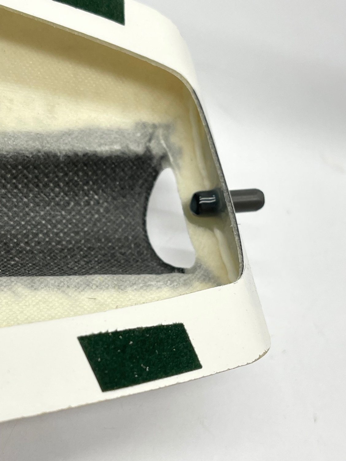

The first thing that I always do when starting a new project is weighing the kit parts.
Isaac Najary

The second thing is writing an Excel worksheet with all the parts weights and the moments from the planning C.G.
The moments are used to know in advance where the motor battery tray will be and how much the battery should be moved in order to move the C.G. 1 cm' so the battery tray can be planned properly.
In glow planes, one can know in advance, if the plane is going to be tail or nose heavy and try to eliminate the problem.
I update the Excel during the course of the building process with the actual weights and mark them in green.
The KARAT Excel enclosed herewith,
Sorry for the Hebrew,
Best regards,
Isaac Najary
