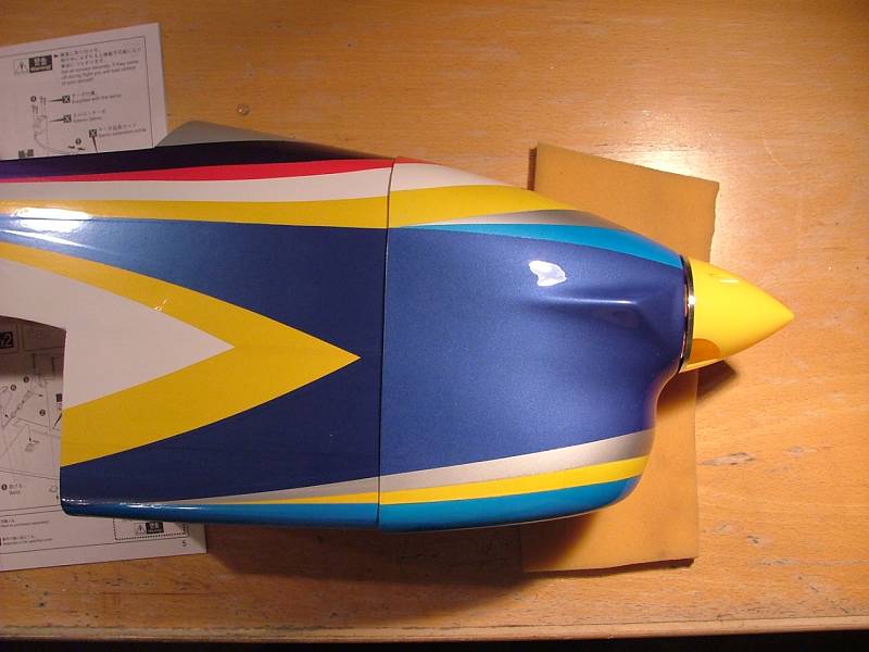

The colors on the cowling almost match the covering, and all lines fit perfectly! (This is the first model I've seen this good work on the transition between fuse and the cowl).

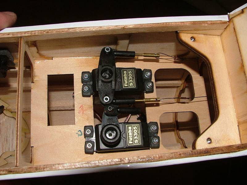

- Futaba 3305 for elevator & rudder control
- Futaba 3107 for throttle

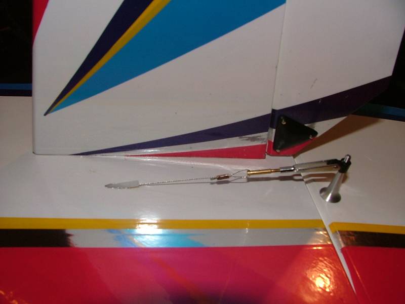

I spent a couple of hours in my hobby room tonight, and got the following things done:
- Joined the wing
- Made holes for the servo cable (I cut rough holes first, then use a soldering iron to seal the edges)
- Installed CA hinges on the ailerons and rudder
- Mounted the wooden "dots" to secure the wing to the fuse
I'm now waiting for the wing to cure so I can continue...
I know the Hyde mount/Hattori setup is slightly heavier, but I'm always trying to keep my models as quiet as possible.
The instruction manual shows a rather "sorry" looking fuel tank securing system, so I'll build something new there I guess. The best solution is to keep the tank from touching the fuse, but I'll see what I come up with. It should be light, functional and easy... -Using the KISS principle.

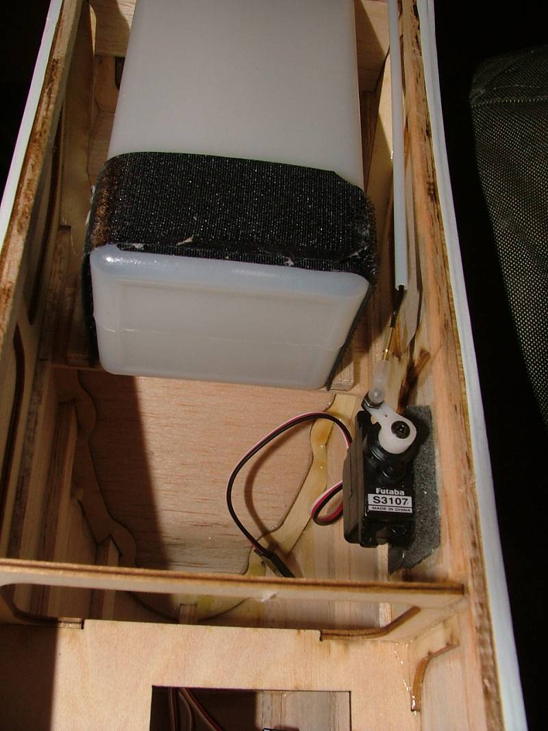

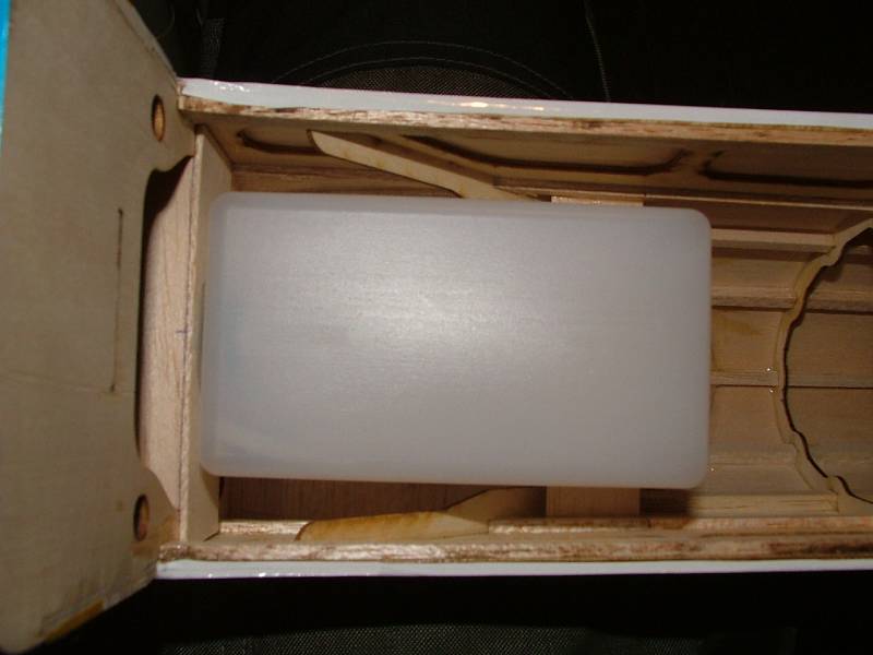

Fuel tank:
I spent 10min figuring how to mount the fuel tank without adding weight.. As you can see in the pictures, I used 1,5mm balsa and made a "Nose-ring" system (as used in my other F3A-planes). Now all I have to do is to add another locking beam behind the tank and one on top. It is really close to the wing, but I think it's going to be OK.

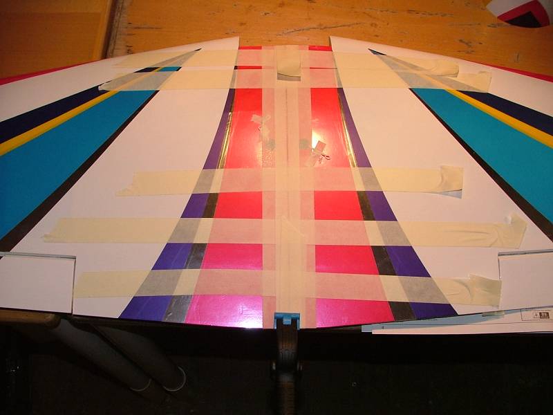

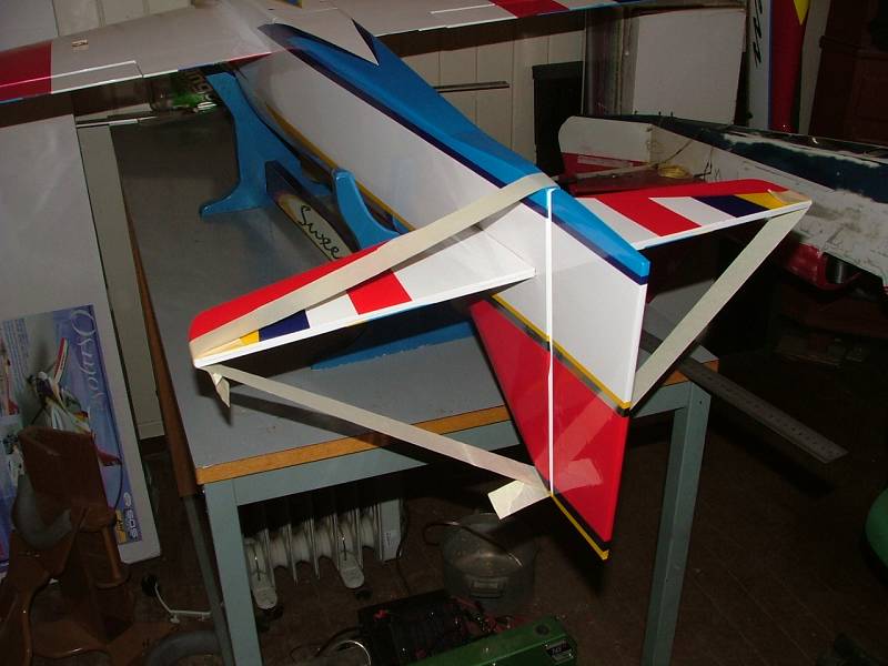

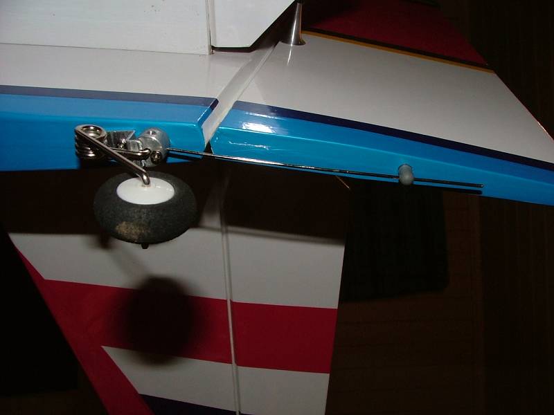

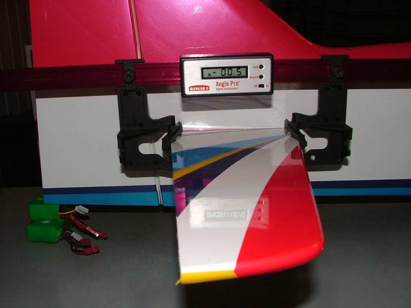

Wings/tail:

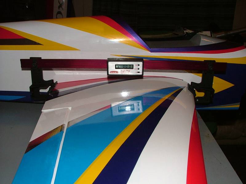

When drilling the holes for the wing bolts, I was a bit nervous about aligning the wing (once the holes are drilled, that's pretty much it..). Nothing to worry about! It was dead on!
Then I test-fitted the stab to check the incidence. WOW... With the main wing set at 0deg, the stab had a promesing -0,5deg. Perfect!
So to the not-so perfect.... The stab tilted quite much, so I had to cut out the opening on one side to make it aligned properly. Task for next time: Align and epoxy the stab into place..
The stab covering was slightly off-center in the center section. That's OK, just a bit annoing.

just an idea on securing your fuel tank.
how about a small peice of velcro on top of the tank and on the rear support you made, to stop backwards movement and then 2 holes either side of the support with a zip tie going through the holes and around the tank.
lite and simple.
this how i have the tank secured on my integral and it has been trouble free.

Jaycey; I thought of double sided tape.. I have welcro-bands (or hvatever you like to call them..) on my Oxalys, and I might be using the same method here. But thanks for the tip! Always good to get more ideas..

Romulo: For this aircraft, digital servos are not a must, but they give you a more presice handeling. A good quality analog servo should be more than capable!
I would use 3-4kg on the ailerons, 4-5kg on elevator and 5-7kg on rudder. The throttle servo should be a quality servo able to withstand the engine vibrations! I'm trying the Futaba micro-servo, but I am a bit curious if it is up to the task... Maybe I'll add a bit of anti-vibration in the servo-assy.

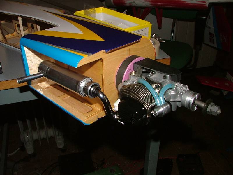

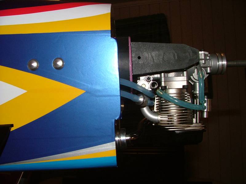

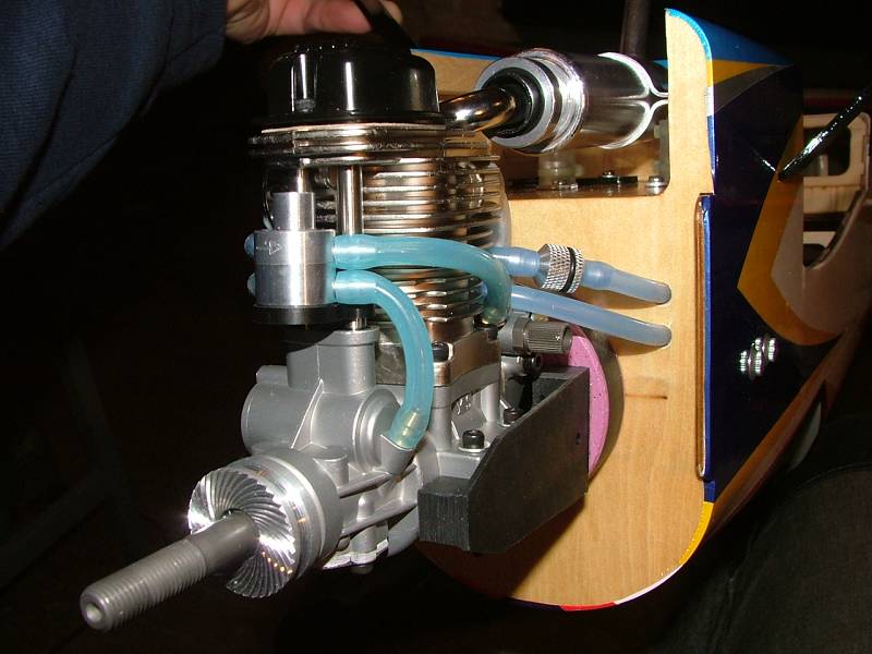

I got a box from Central Hobbies yesturday, so it was almost Chistmas for me! Did not have time to do too much though, but found out I forgot to order an adaptor for the TruTurn spinner (The Norwegain taxes set me back approx. $150 on the shipment (tot. of $500 from Central), so I will find a cunning way of getting back at them somehow...)
The Hyde mount gave me a 210mm distance between firewall to the spinner backplate. The instructions on the plane states 180, so I need to tweak the cowling a bit. Everything went together perfectly (Thank you Hyde..), so now the engine is in place! It is really tight to get the self locking nuts into the back of the firewall, but after a bit of svearing and sweating it came through.
It looks quite cute actually with that tiny Hattori header and pipe!
The stab is also in place, so I'm on a roll.... Will not be able to do too much the next couple of days, but once I get out in the workshop I plan to get quite a few things done. The box from Central was full of "things I did not know I could not live without", so everything should be there to complete this bird.

Hi, thats my Osmose 70. I have used an OS55AX which fitted well in the cowl after a little trimming!! This kit is much better then the Oxy. The covering looks like it should stay on ok. The only things I have changed are the aileron links. I dont like the bends and plasitc keepers they supply. I have had three flights with the model so far and its superb! It locks into the manovers very well, rolls superb and spins fantastic. If the UK rain and wind ever stops I will go and fly it again....but that looks some time away at the moment.
Old 09-05-2008, 03:41 PM

Default RE: Kyosho Osmose 70, Sort of build thread (slow..)
ORIGINAL: Nigel202
That's great news!
My guess is that the model will "brake" better on downlines with the Ys63 than the 55AX. I had a 55AX in my previous 50-size (TM Shadow), and it is a fantastic little engine! (I used Karl Mueller header and an Asano pipe combined with a rubber engine mount and nose ring... That thing was silent!).
I will change oyt the rudder horn with MK Alu.horns. Also, I'll fit the MK horns (plastic w/threaded 2mm rod) on elevator and ailerons. I bought carbon pushrods (mini pushrods) for the ailerons, and will have a think about the elevator pushrod..
I now fitted the aileron servos with no modification! I put in a couple of alu. fuel dots on the fuse side. I will mount a similar ignition system as in my other models (ie plug in the fuse side).
The pipe also got fitted last night.
I had a think about the micro-servo I'm using for throttle. I might just use a couple of layers of "servo tape" (soft, double sided tape) on this. I will then get rid of a lot of vibrations! Just have to make sure the tape sticks!
Regarding the covering on this bird... Most of the trimming ends has a small "punced hole" to ensure that it stays on! It looks as though someone has gone over all trim ends and put some extra effort into this... Good job! Stil, I might seal the ends off with "fuel-proofing", a strange smelling mixture bought in the local hobby store.

Here are some pictures from yesturdays' progress.
What has been done:
- Elevators in place
- Tank (and fuel system) installed using welcro. I fitted self adhesive welcro in a matter I've seen on a Japanese site some years ago.. The adhesive locks the aft movement while the welcro keeps the tank in place.
- Throttle servo installation complete. I just stuck the servo onto the fuse side using strong double sided tape and CA.. Looks dodgy, but feels rock solid..
- Muffler mount in place
I might get a couple of more hours out there tonight. Let's hope the little toddler is fast a sleep... (Yeah right..).

Old 09-10-2008, 03:05 AM
Thinn
Join Date: Jan 2003
Location: Vestby, NORWAY
Posts: 159
Got an hour working on the Osmose yesturday evening and finished the folowing:
- Tail wheel assembly
- Rudder pull-pull system
Just a little comment on the tail wheel assy... NEAT!!! Easy to assemble and looks like it will work great!
The only "negative" comment I would like to add is that the pre-drilled hole in the fuse (for the tailwheel foundation) needs to be enlargened to Ø6mm (if I remember correctly..), and the instruction manual shows a Ø3mm hole in the rudder. This should be Ø5mm (again, if I remember correctly...). Not really a show-stopper!
I don't like threading the pull-pull wire directly onto the servo horns, so I bought DuBro Ball-links. Also, the plastic linkage in the hardware pack looked a bit too soft, so I changed them..
I had a couple of MK horns laying around, so I added these for the rudder. The rudder has a hardwood dowel built in, so just drill a hole and fin in place! The pre-drilled holes in the fuse were perfectly aligned.
The control horns for the elevators were started, but I'll have to finish this job next week or so. Tonight I'm packing for the last contest in the Norwegian cup at Tynset... Competition days Friday through Sunday.
