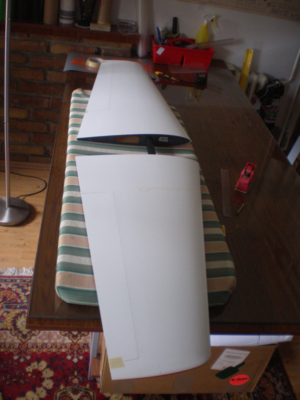

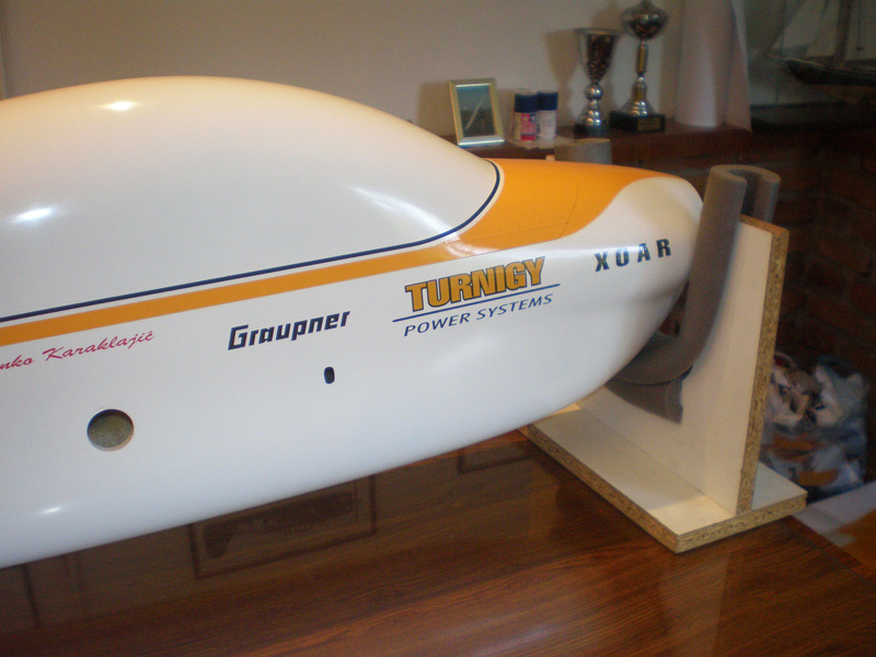

Last few days I spent working on color scheme on my friends F3A model Bravo.

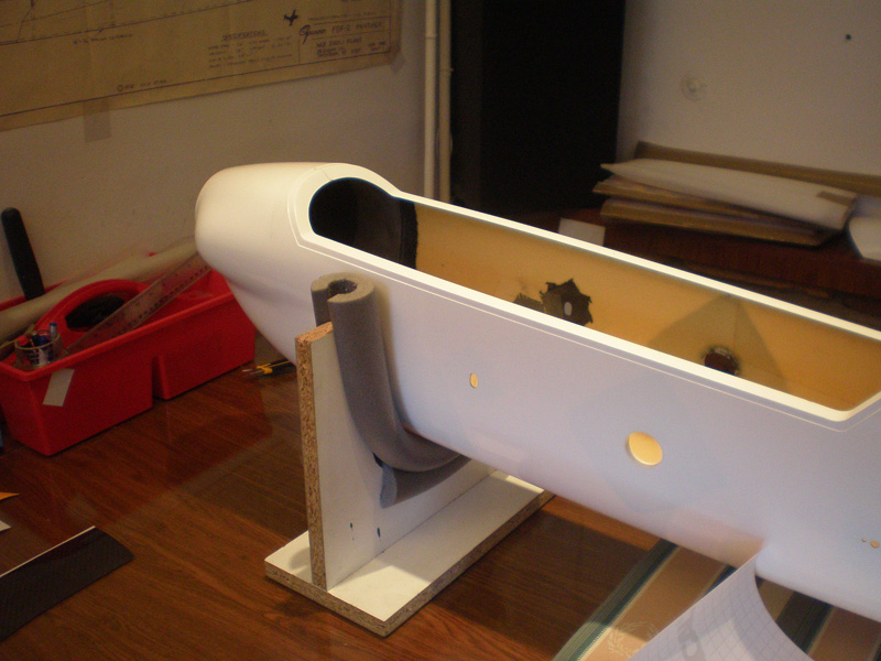

He bought it from Lorenz Modell from Germany. Model was white, and I have job to design and made finish on this model.

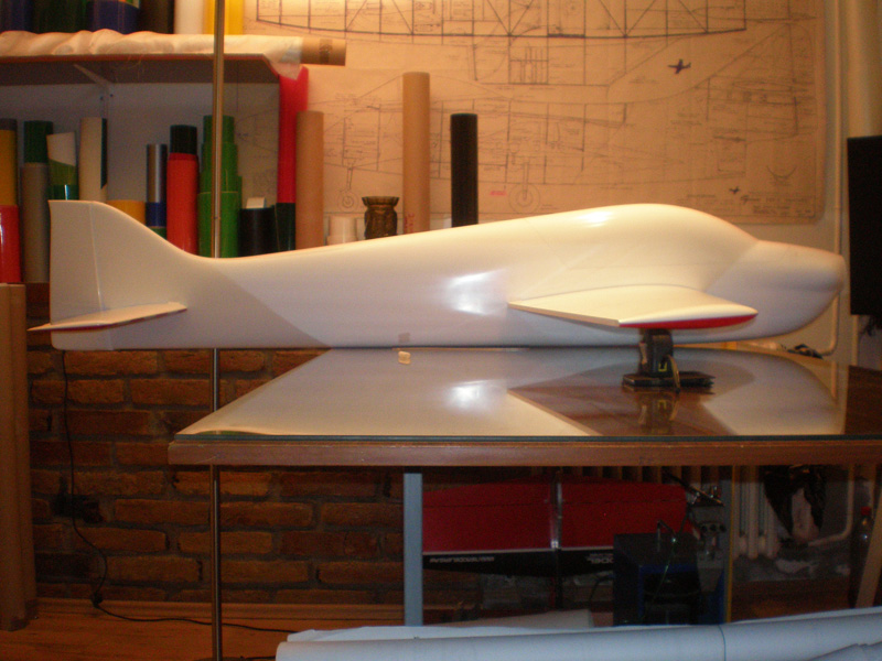

Model are extremely easy, so painting it wasn't option, because first must add primer, than color, and everything must be paint with clear cote. So many layers will add to much weight, so we decided to made finish with self adhesive foils.
Self adhesive foils are grate on flat surfaces but it can't be apply on rounded shapes. So, I must create design which will match with model...
On Bravo upper surface and complete fuselage are white, and botom side of wings and elevators are red.
My friend have wish to color scheme be totally different on upper and lower side.
But before story about color scheme, look few pictures about model...

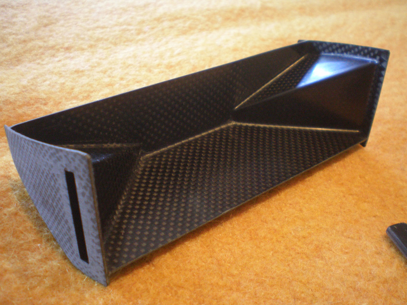

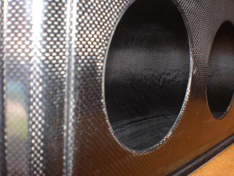

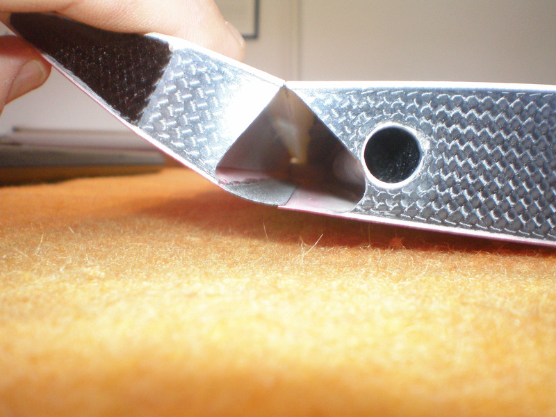

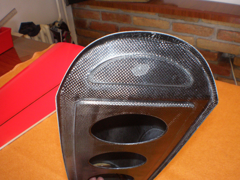

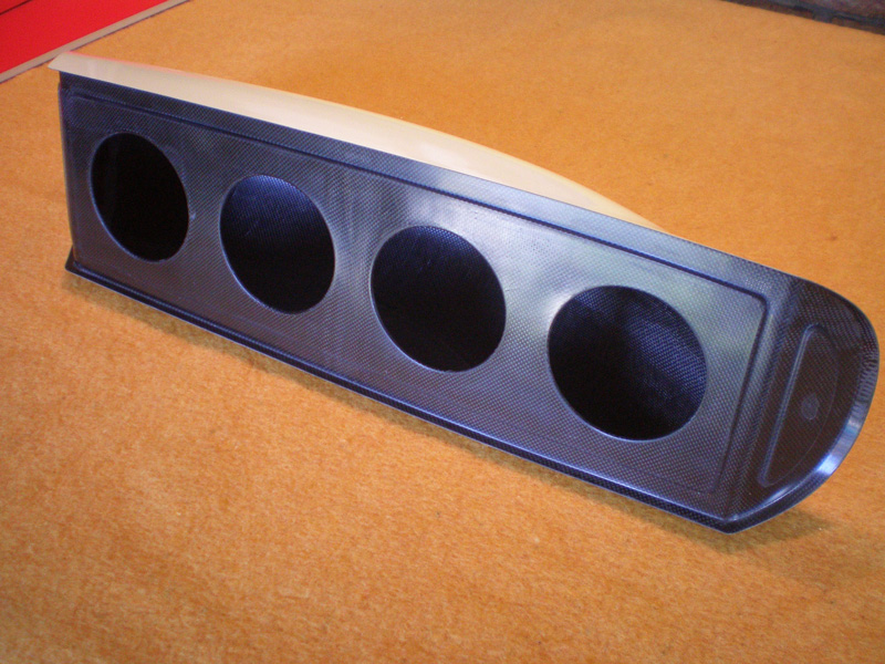

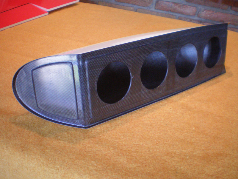

Bravo is last generation in full composite F3A model...
Attachment 2236439
Attachment 2236440
Attachment 2236441

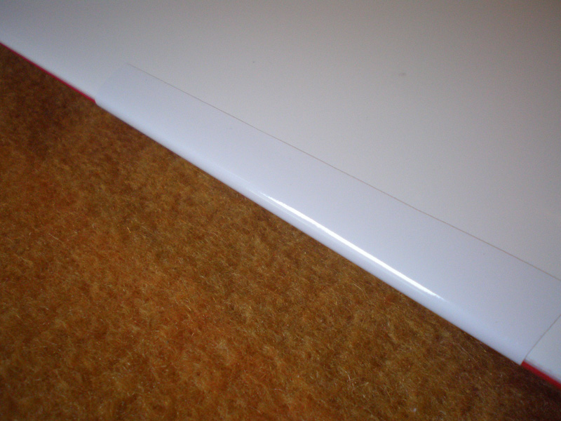

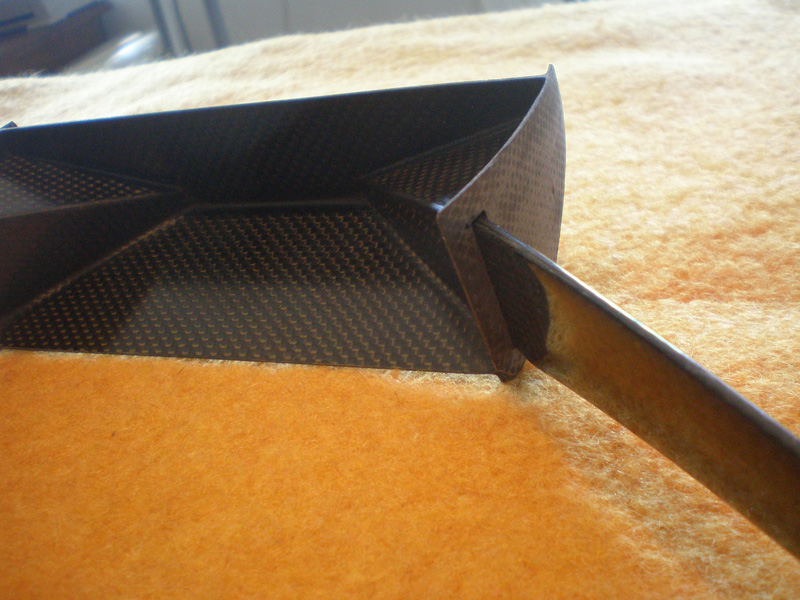

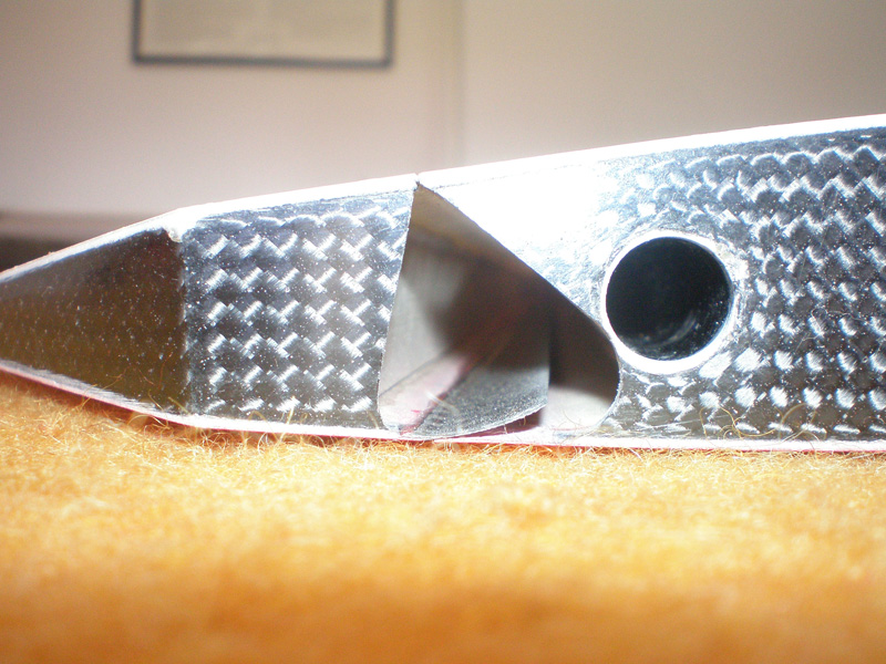

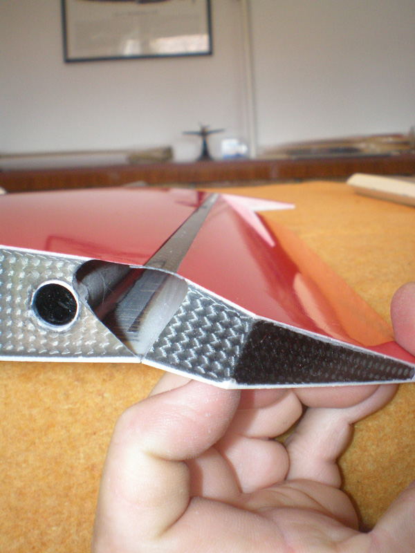

Trailing edge...
Attachment 2236444

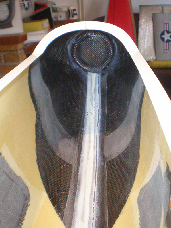

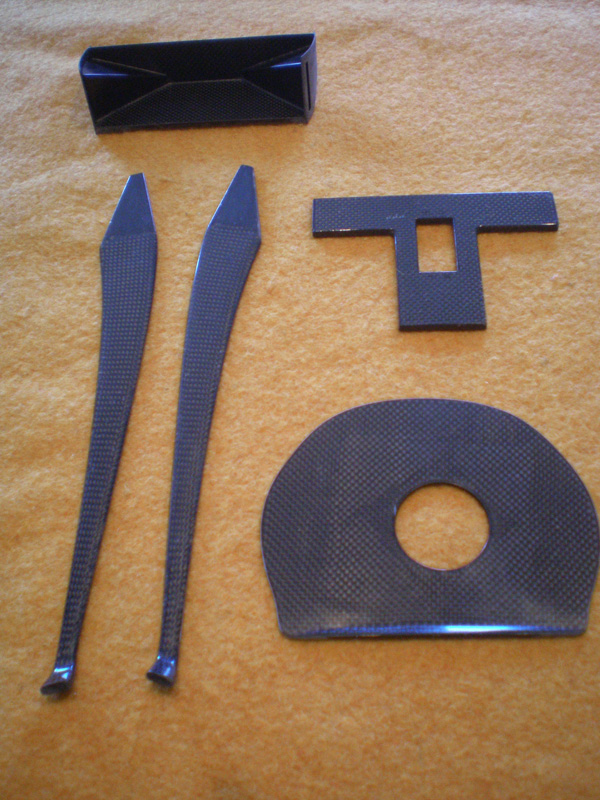

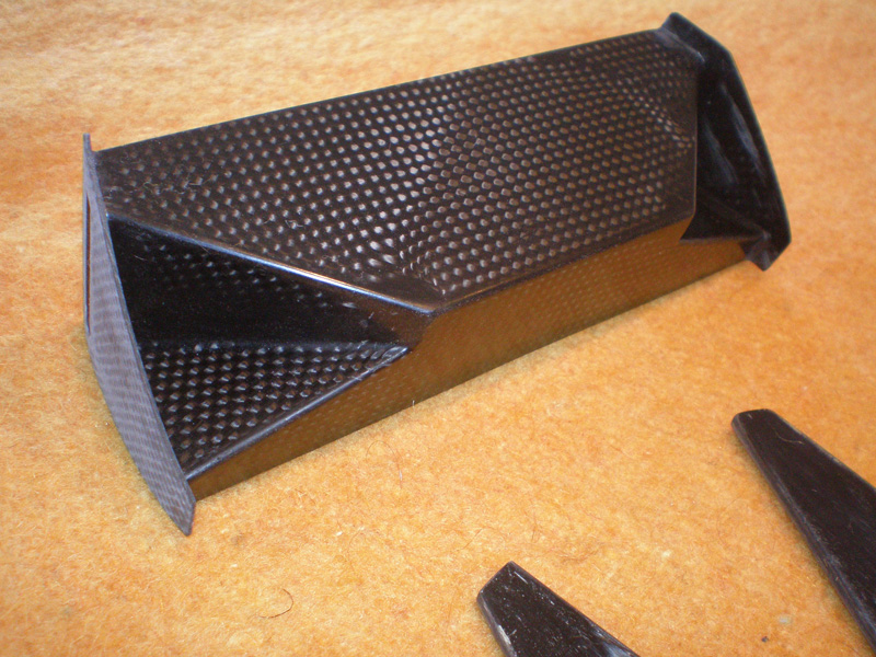

Cabin is made from thin carbon...
Attachment 2236445

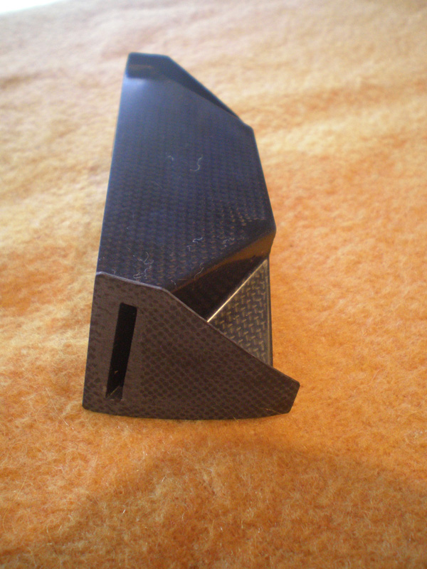

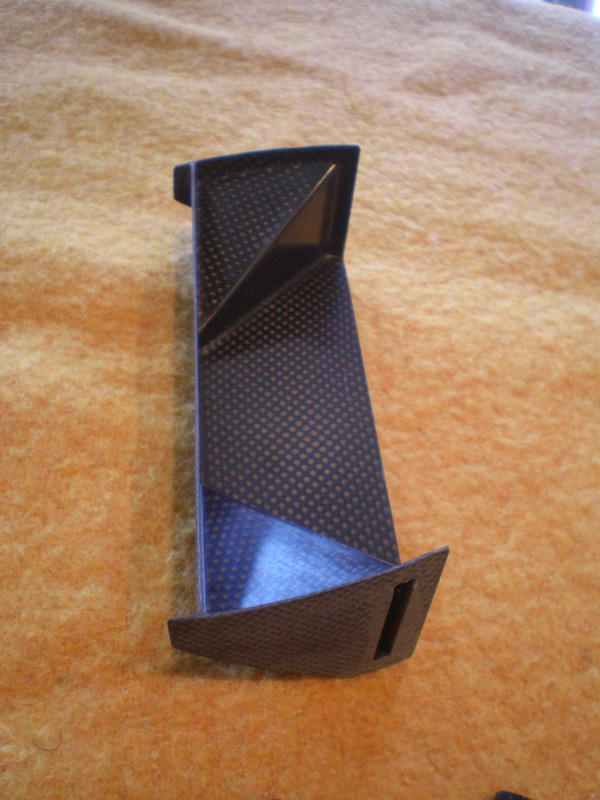

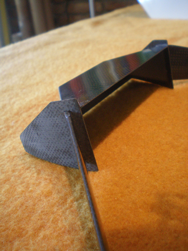

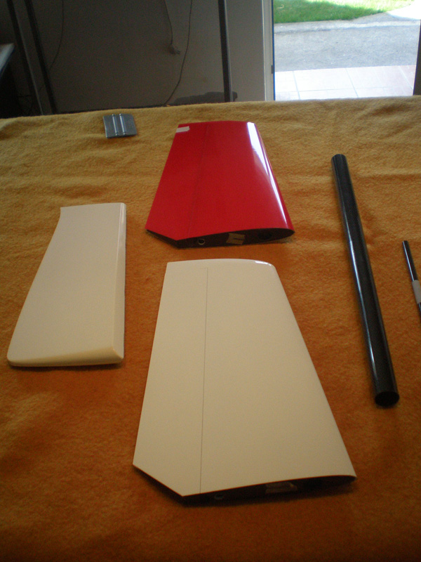

Elevators was made with same technology as wings...
Attachment 2236450

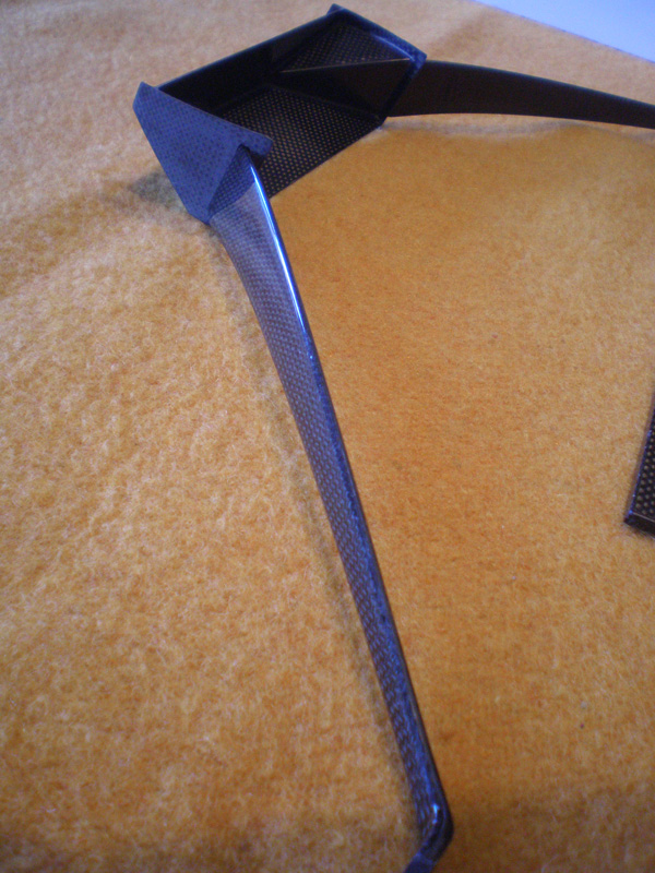

Few details about landing gear...
Attachment 2236457
Attachment 2236458

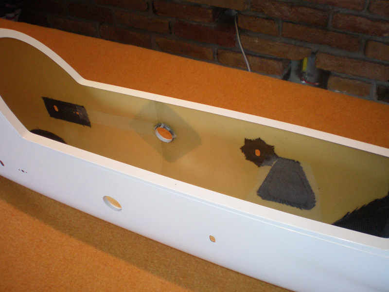

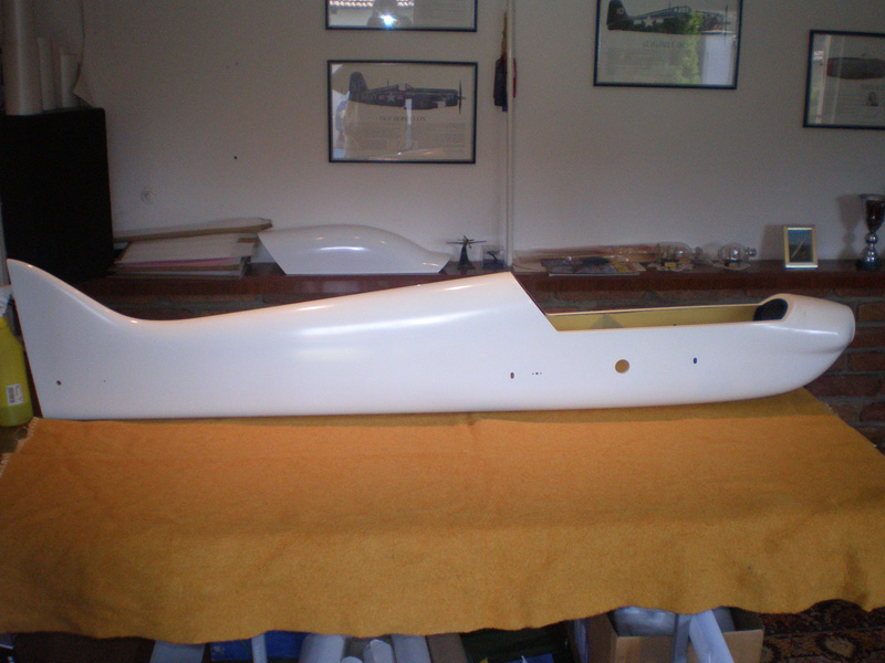

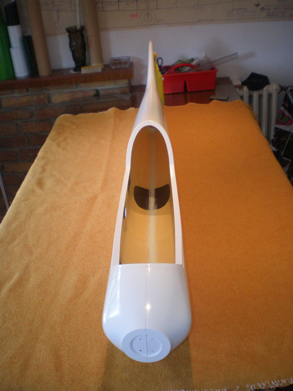

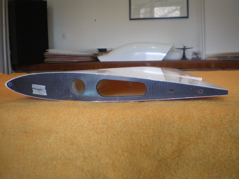

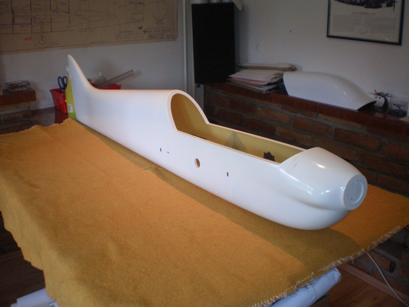

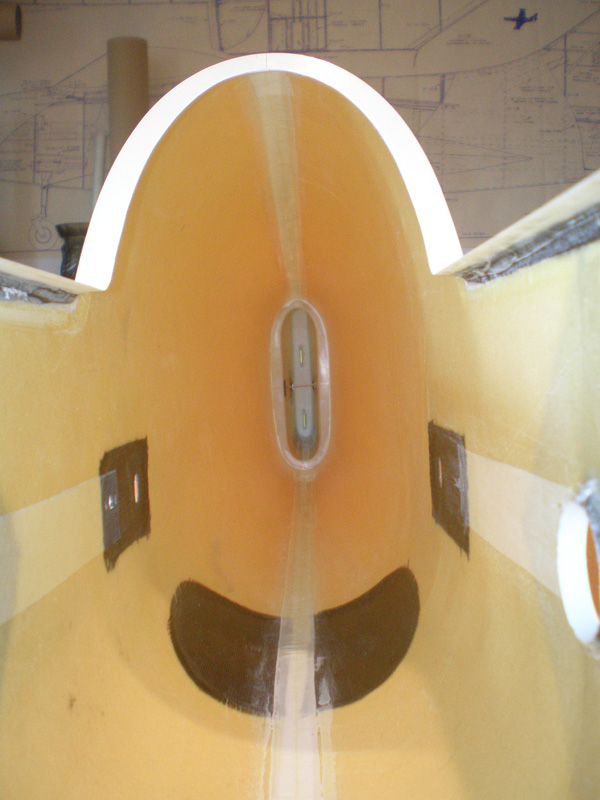

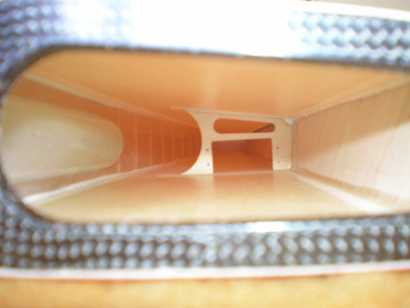

And finally fuselage...
Attachment 2236465
Attachment 2236466
Attachment 2236467
Attachment 2236468
Attachment 2236469
Attachment 2236470
Attachment 2236471

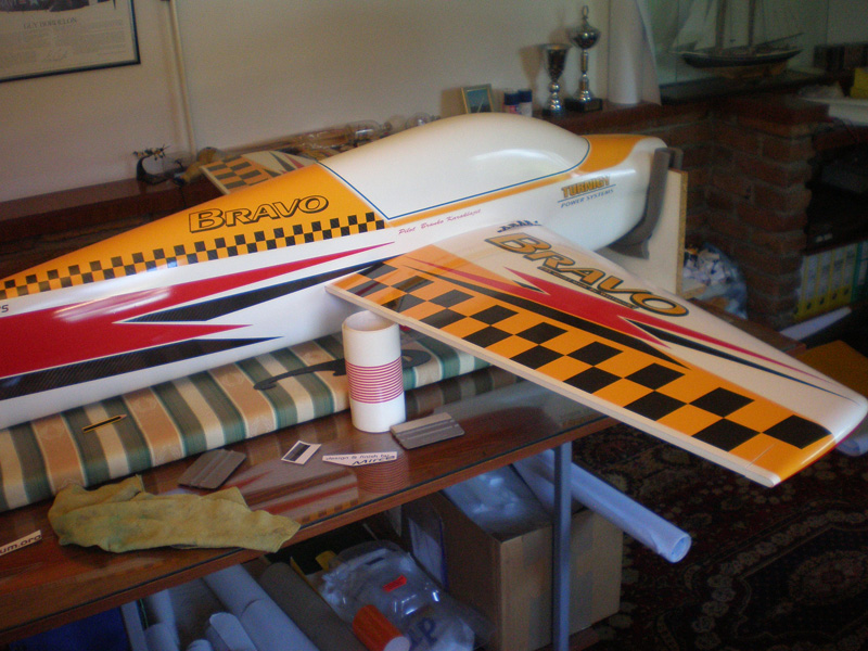

OK, now when we know how model look, lets start with work.

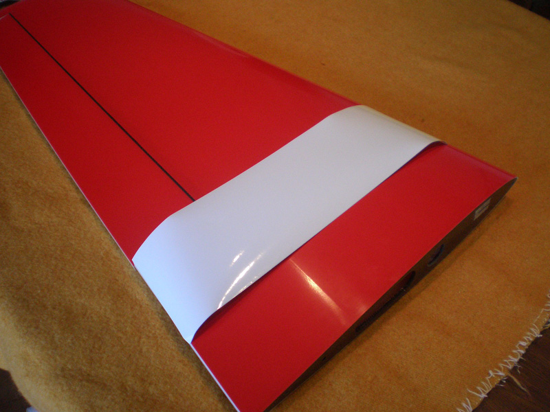

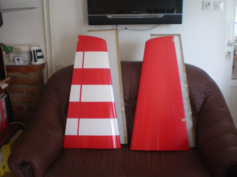

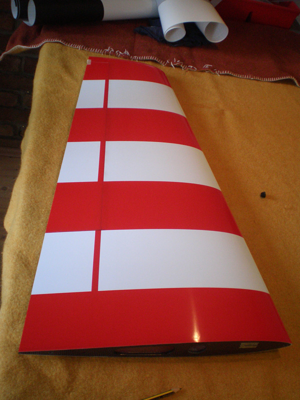

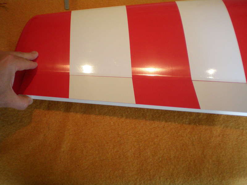

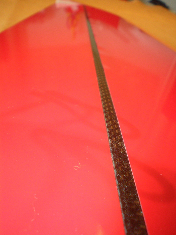

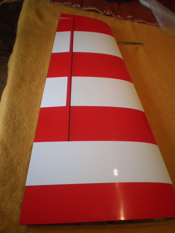

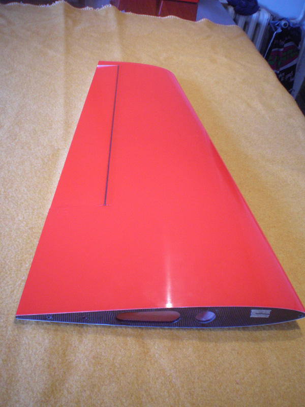

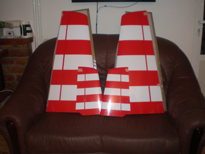

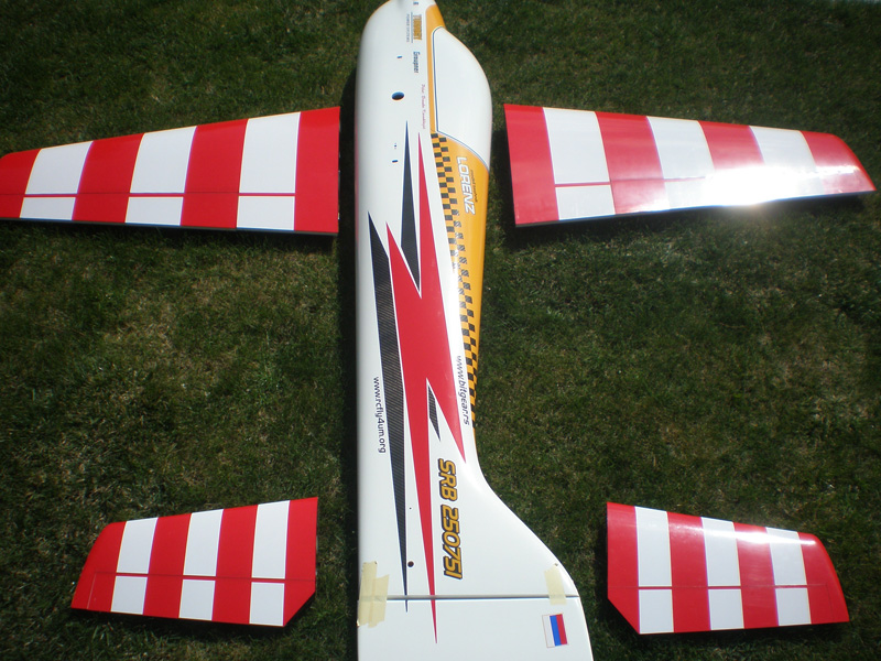

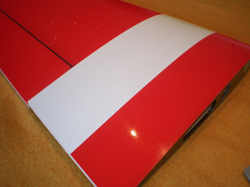

I start working on lower wing side, and apply three white stripes...

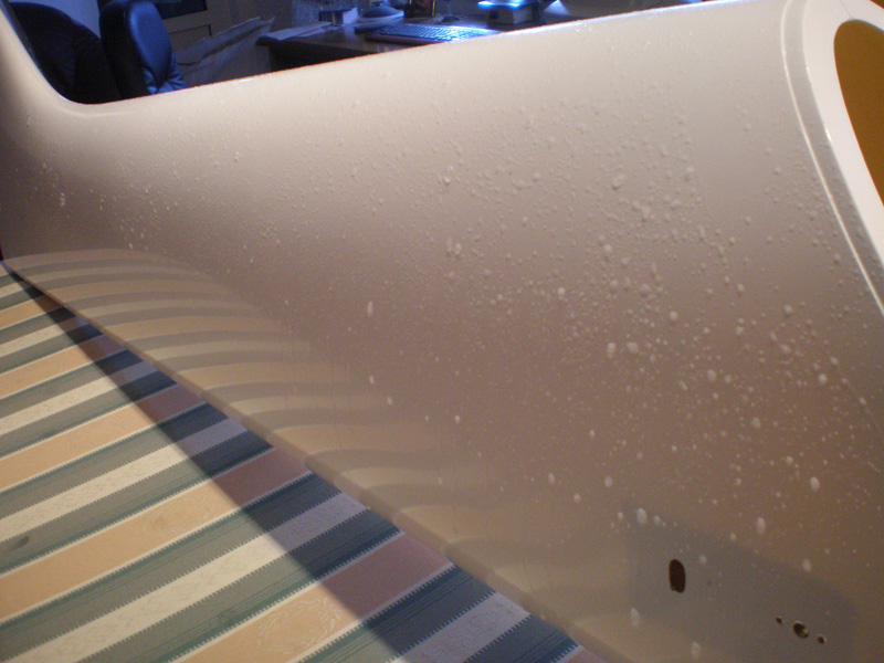

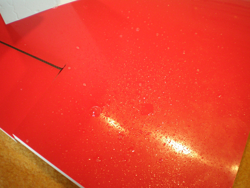

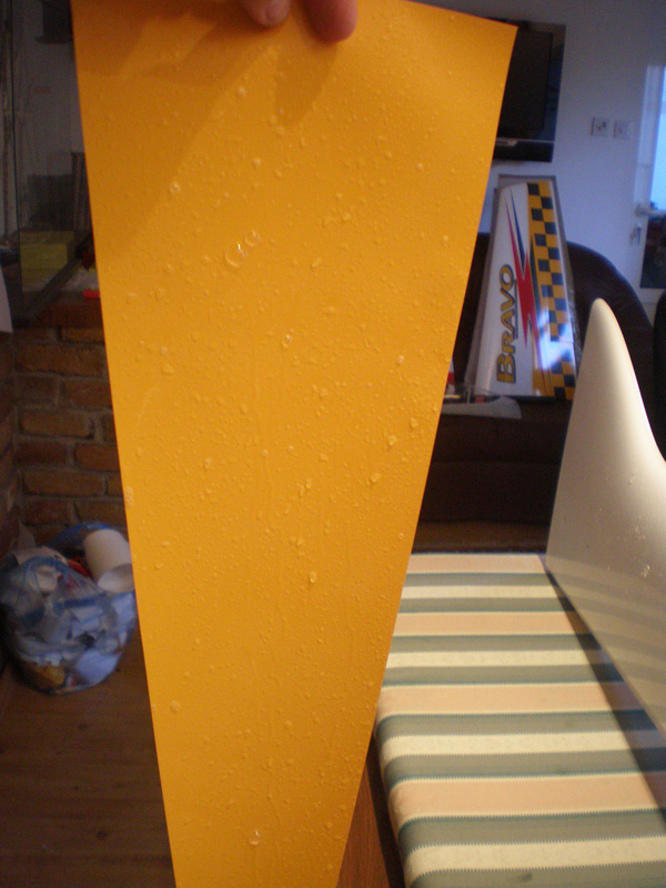

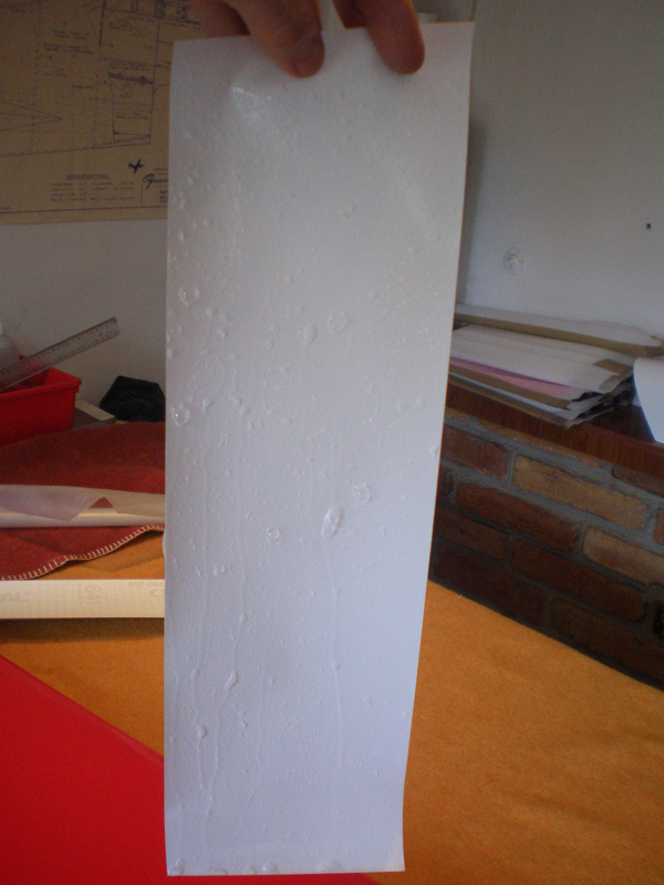

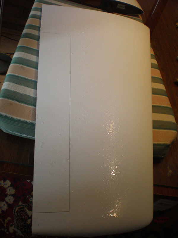

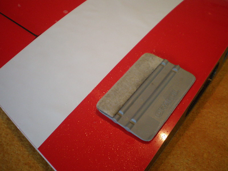

I use Oracal 641 self adhesive foils. Because wing surface are plastic, very thin and gentle, I use water for applying foil. System is simple, add water on surface, add water on sticky foil side, and aplly foil on surface. Bacause foil is wet, I could position white line very precise on wing...
Attachment 2236472
Attachment 2236473
Attachment 2236474
Attachment 2236475
Than I used this little tool, and squeeze out water...
Attachment 2236476
Attachment 2236477
Surface are without any bubble...

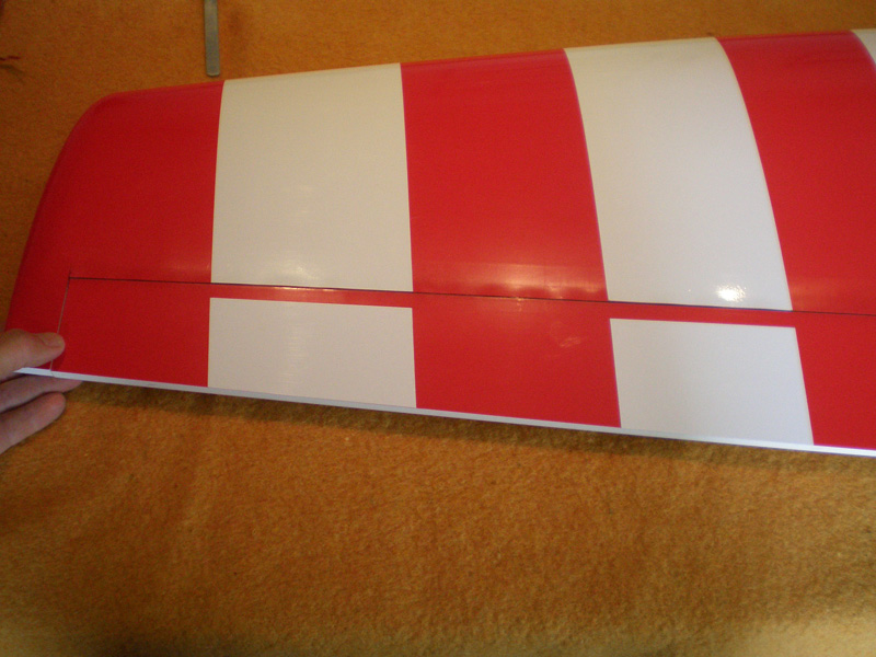

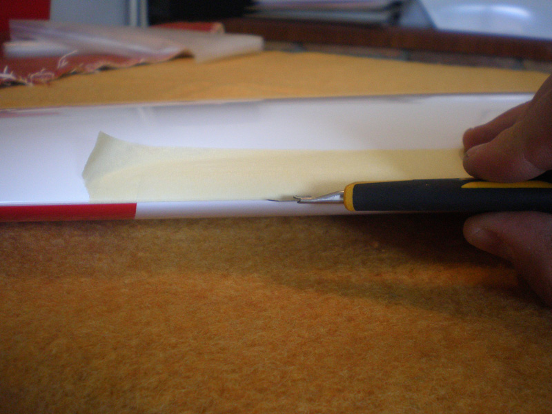

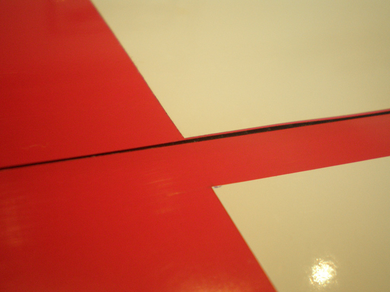

When water dryed I add masking foil in edges which I want cut...
Attachment 2236478
Attachment 2236479
Attachment 2236480
Attachment 2236481

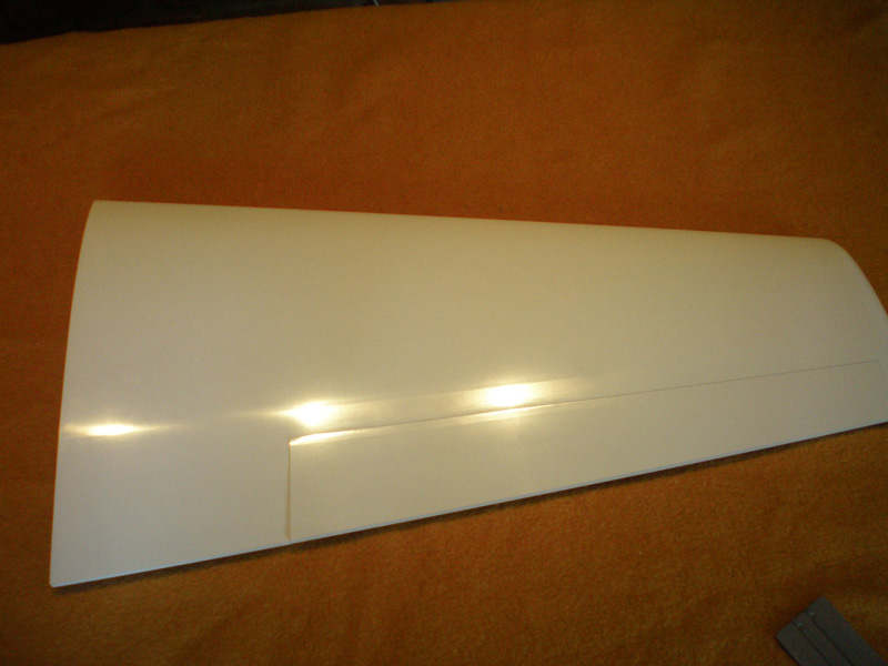

On ailerons I must move white line from edge where aileron come inside in the wing. Gap is so small that foil will stuck on the edge...
Attachment 2236482
Attachment 2236483
Attachment 2236484
Finally, I add one red stripe on first white line to made all lines same...
Attachment 2236485
Attachment 2236486
Attachment 2236487

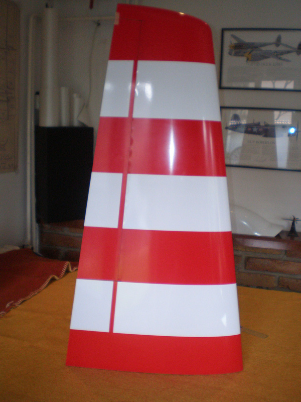

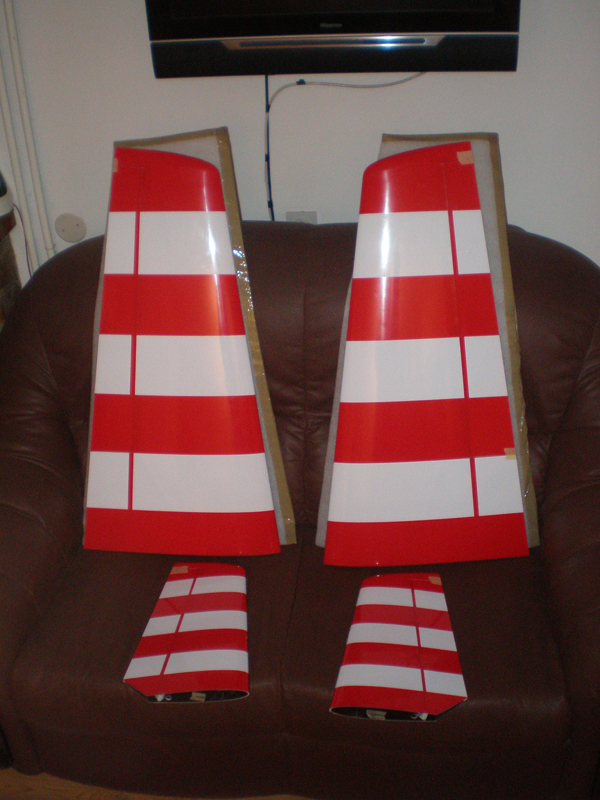

Than I made this process few more times, and get white lines on bottom sides... Same procedure was for elevators, but for applying white stripes I was not using water...
Attachment 2236488
Attachment 2236489

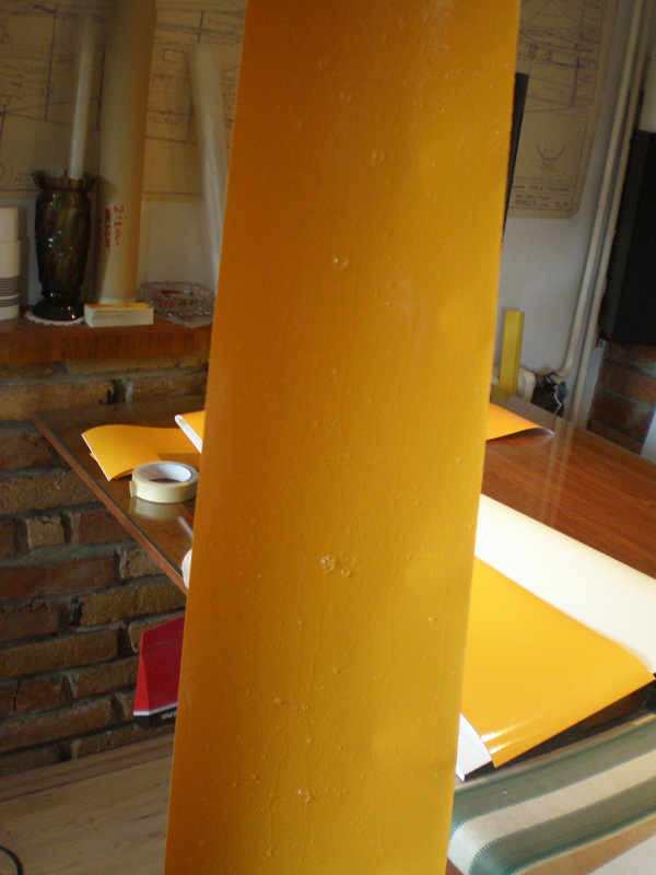

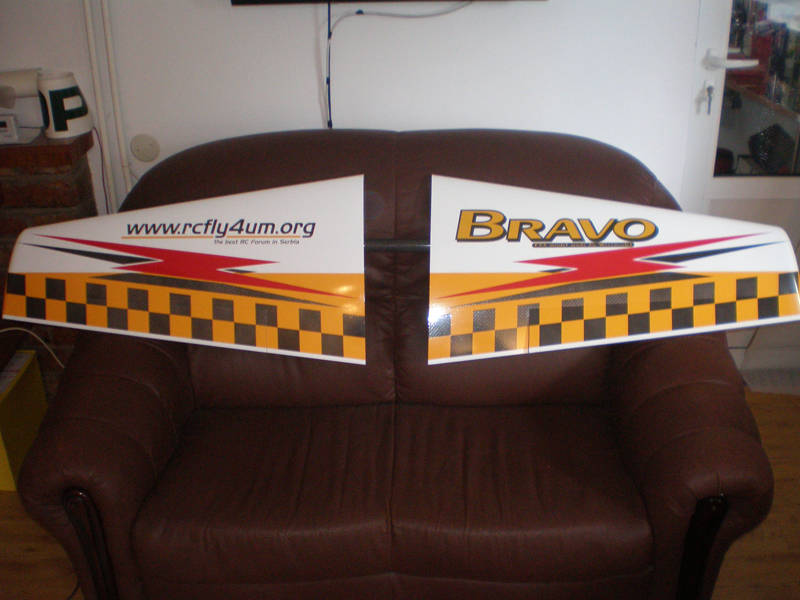

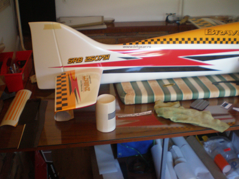

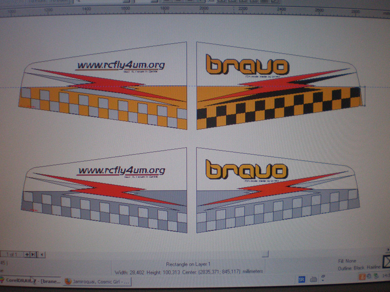

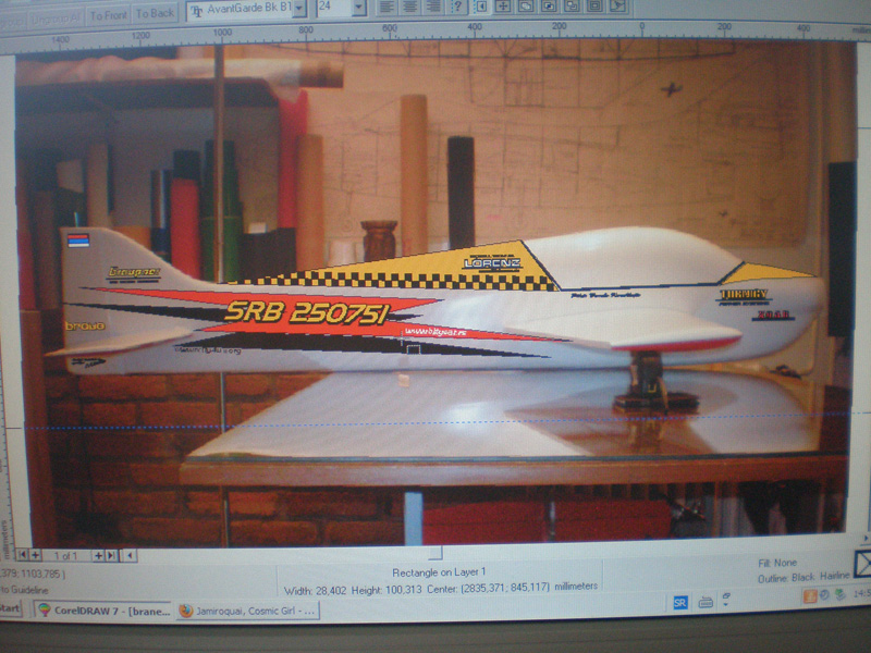

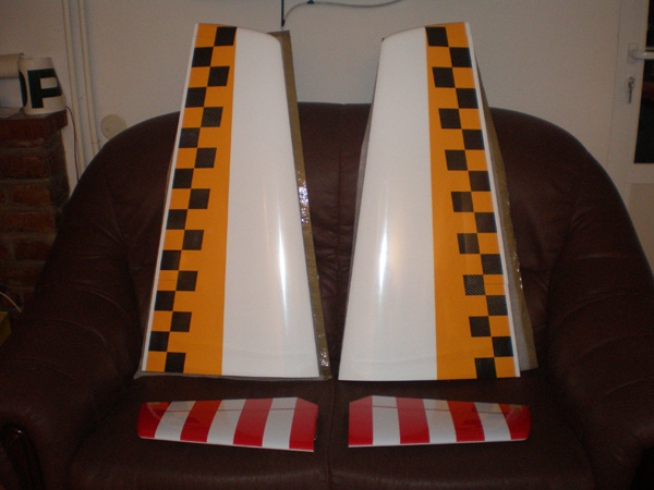

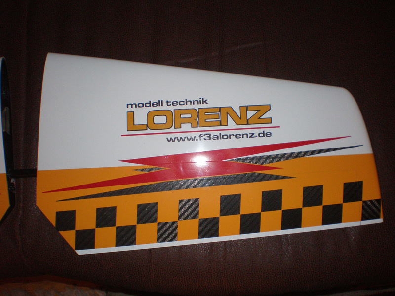

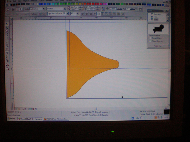

For upper surface I made totally different color scheme. First I draw everything in computer in Corel... I made few proposals, to enable my friend to choose colors, but for me, and for him also, yellow and black was the best combination...
Attachment 2236490

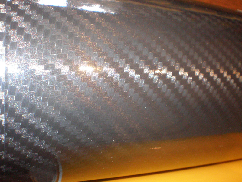

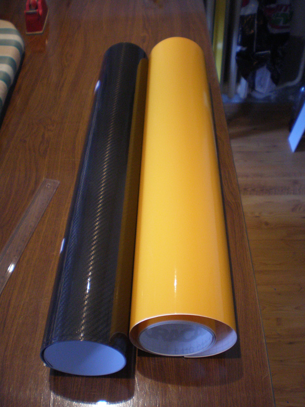

I bought yellow foil, and instead off black I take foil like carbon...
Attachment 2236491
Attachment 2236492

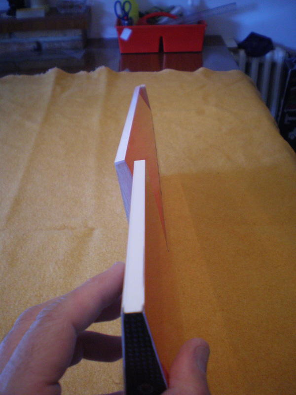

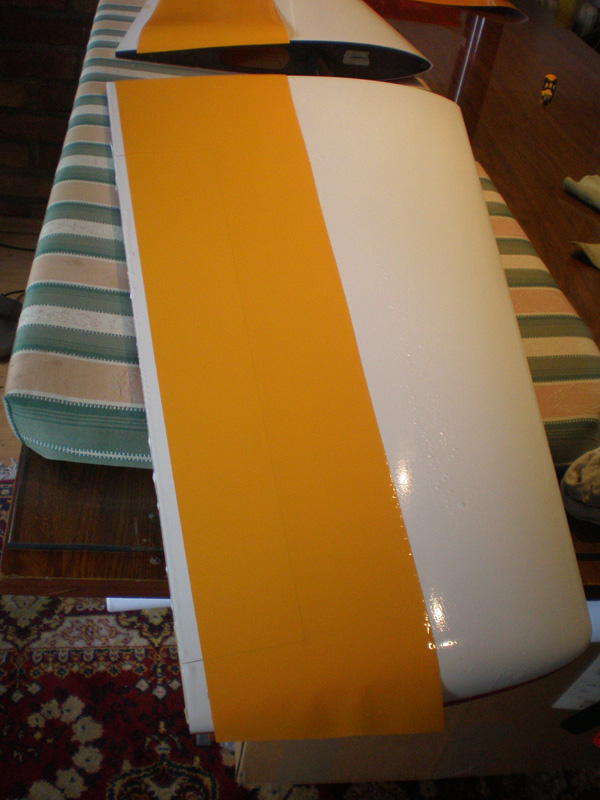

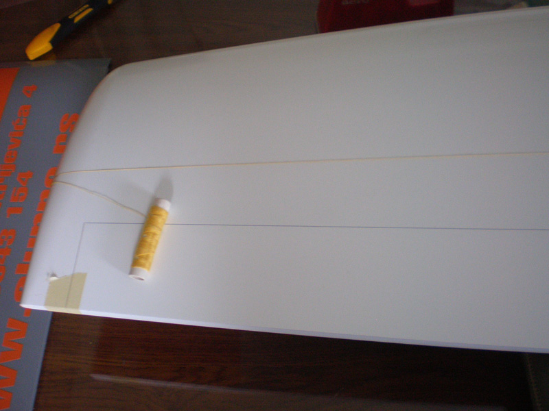

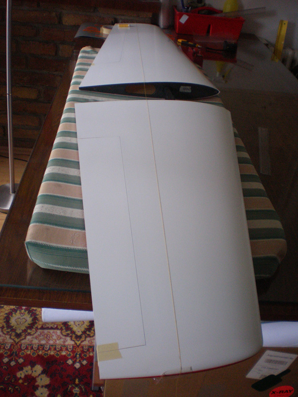

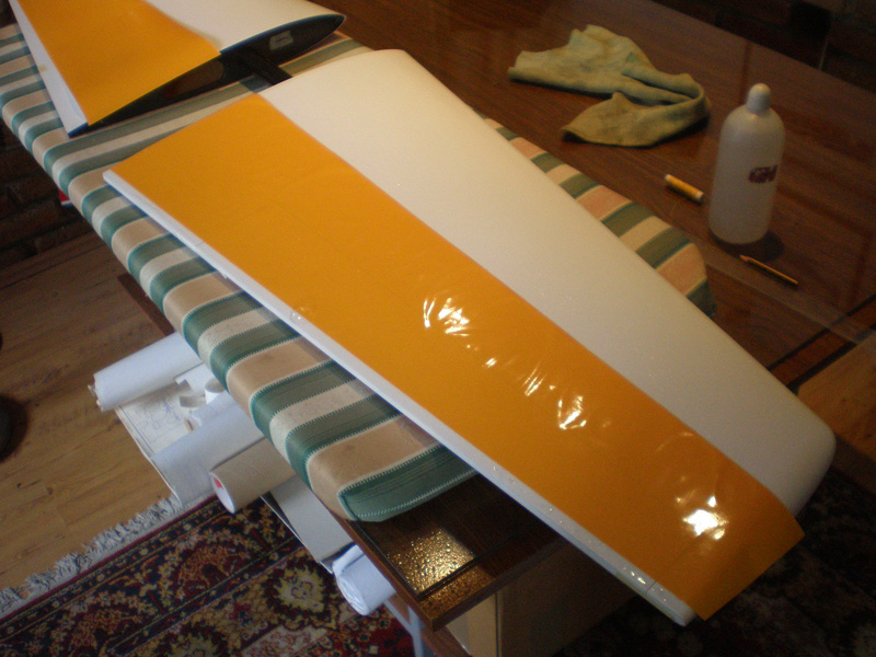

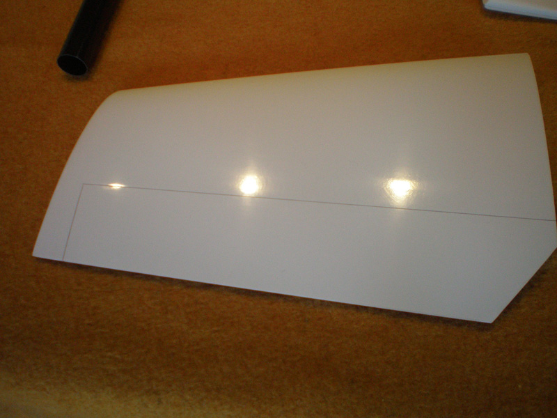

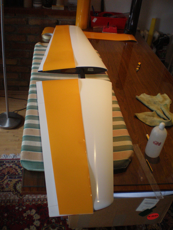

On white wing side, first I add yellow areas, but before that I put together wings to draw a straight line. For that operation I use very "high tech" tool...
Attachment 2236493
Attachment 2236494
Attachment 2236495
Attachment 2236496

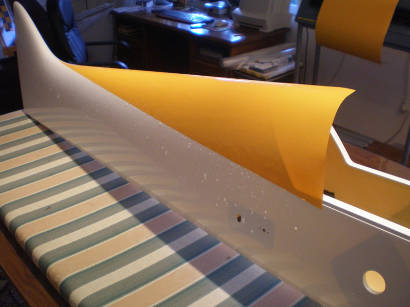

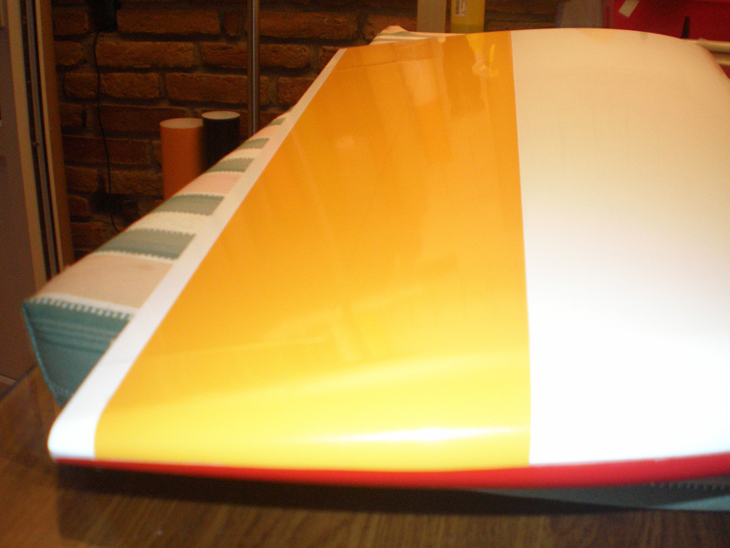

Gluing was again with water...
Attachment 2236497
Attachment 2236498
Attachment 2236499
Attachment 2236500
Technique was same like on bottom side...
Attachment 2236501
Attachment 2236502

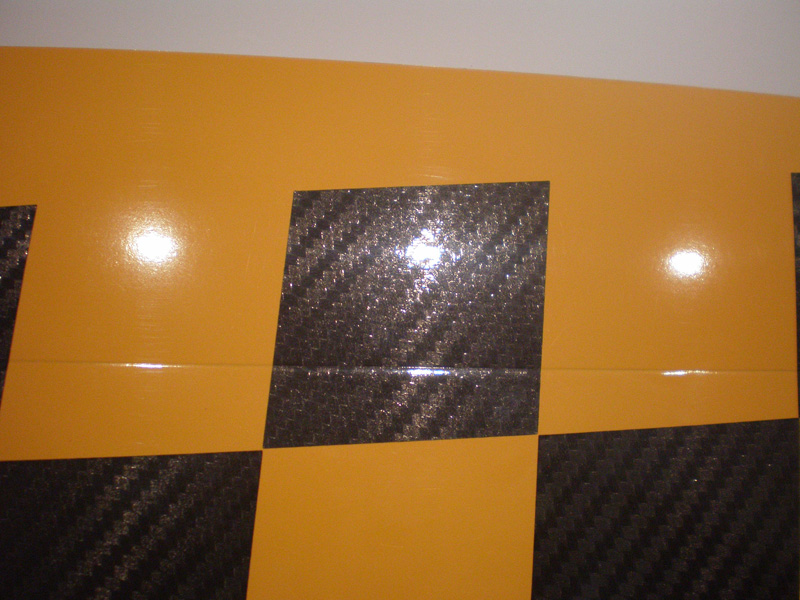

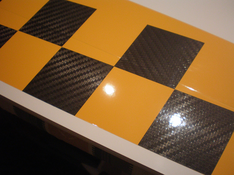

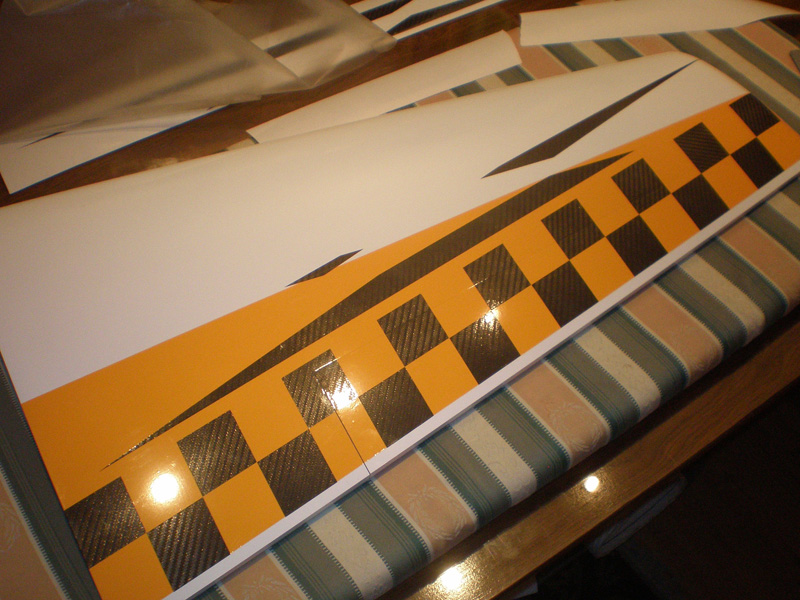

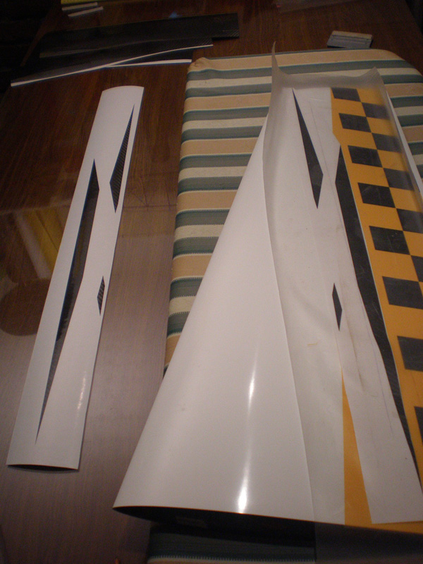

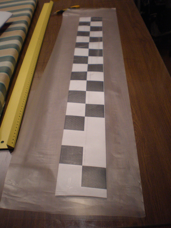

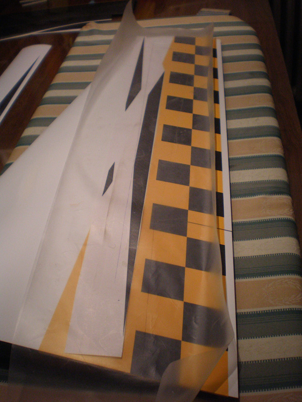

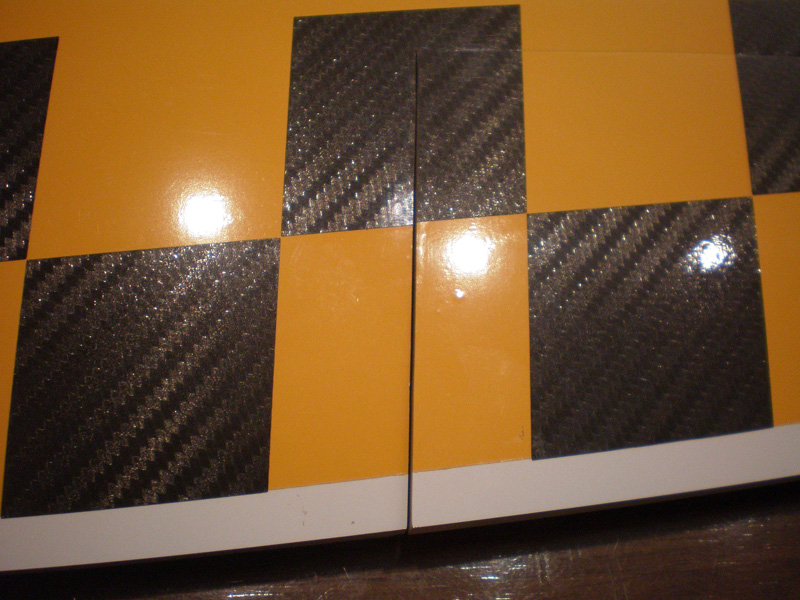

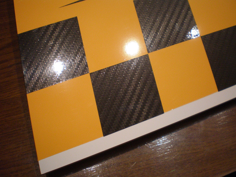

Than I apply cubes made from carbon foil...
Attachment 2236503
I used transfer foil for this...
Attachment 2236504
Attachment 2236505
Attachment 2236506
Attachment 2236507
Attachment 2236508

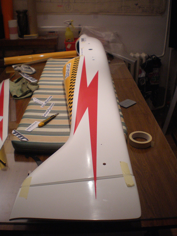

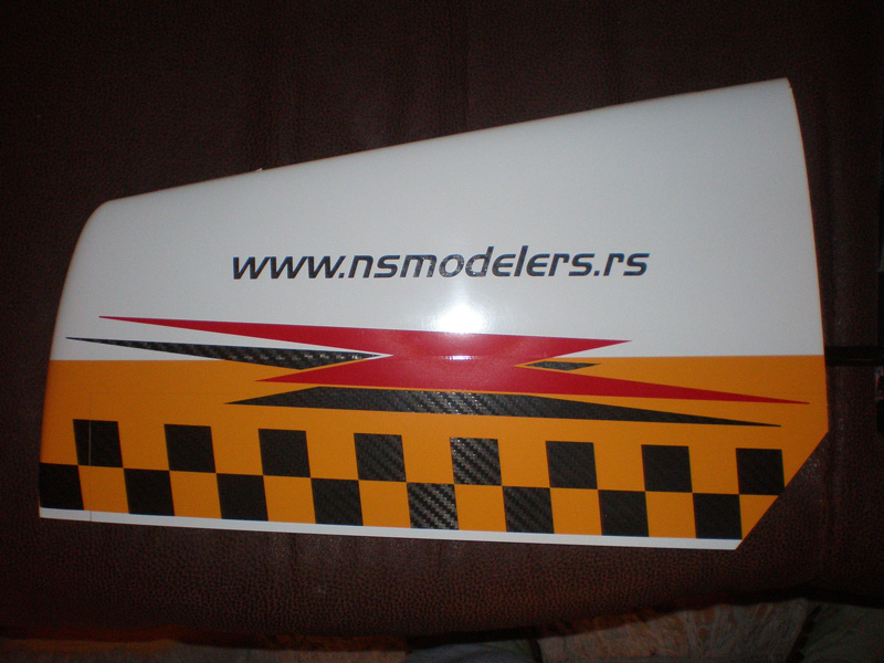

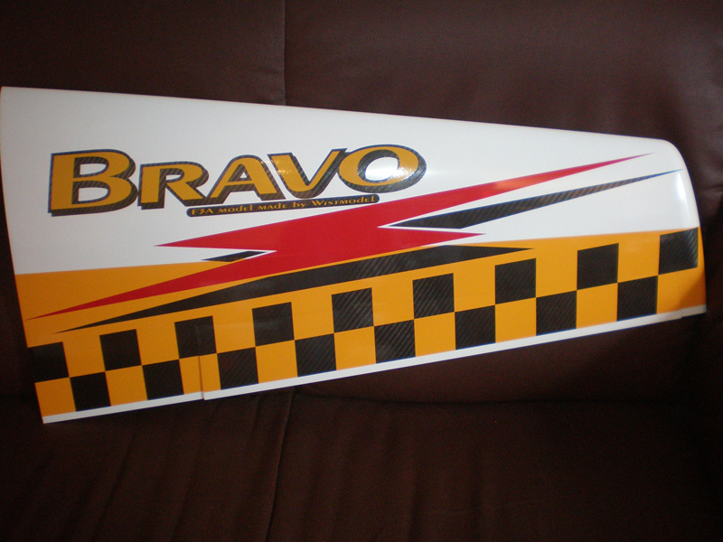

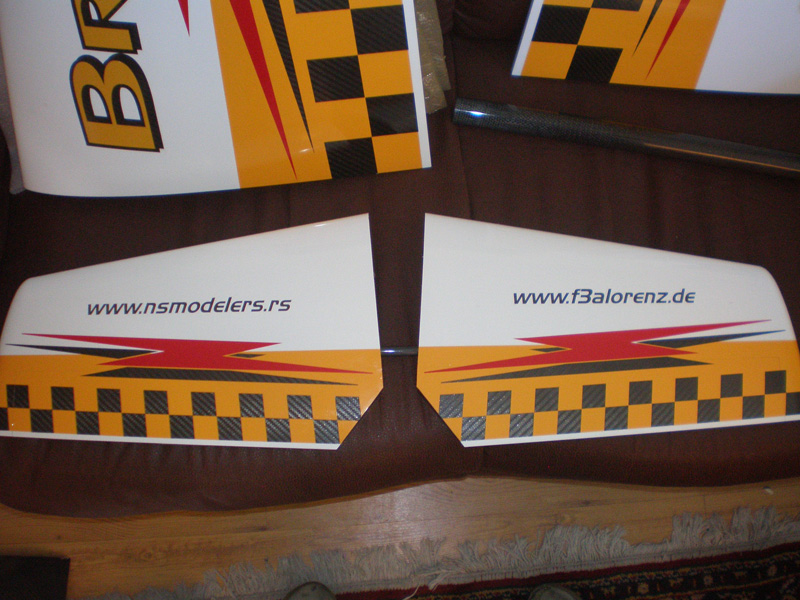

Than I made and apply lightning shadow, which was again from carbon foil...
Attachment 2236509
Attachment 2236510
Attachment 2236511

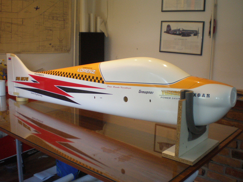

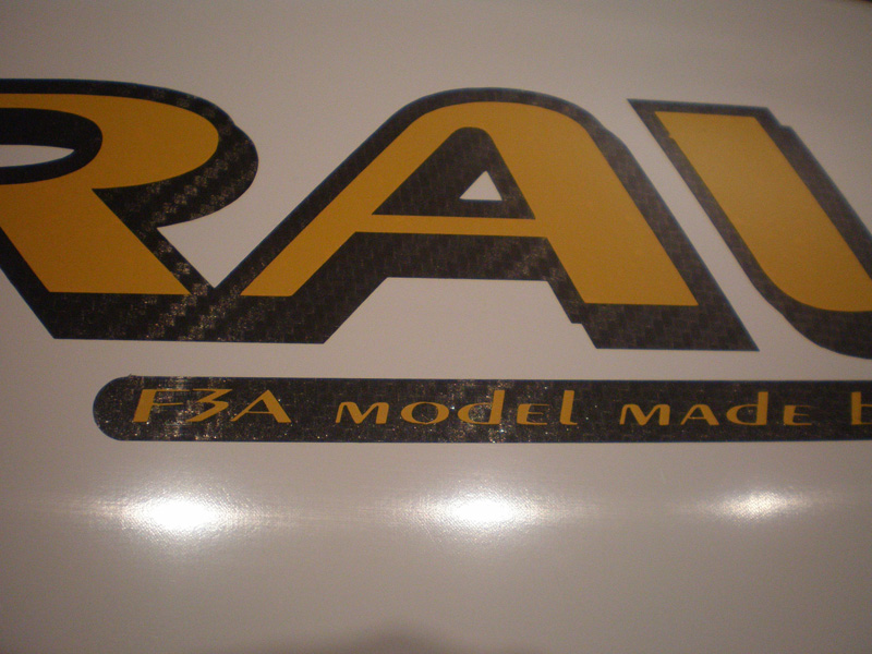

After that letters and finally red lightning...
Attachment 2236512
Attachment 2236513
Attachment 2236514
Attachment 2236515
Attachment 2236516
Attachment 2236517
Same procedures was on elevators...
Attachment 2236518
Attachment 2236519
Attachment 2236520

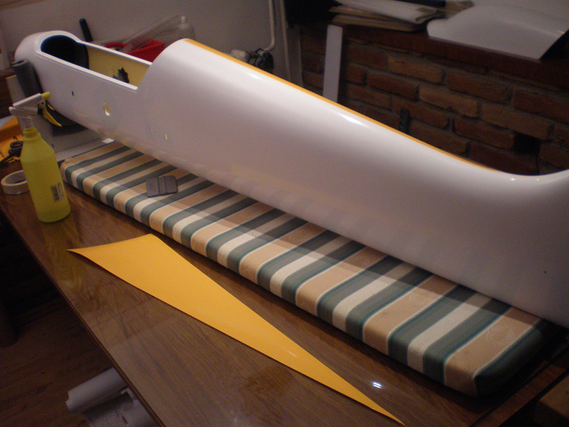

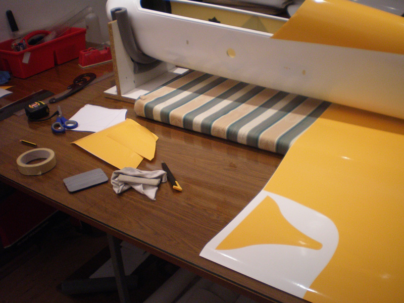

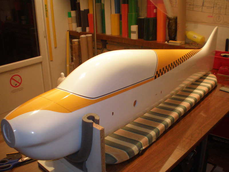

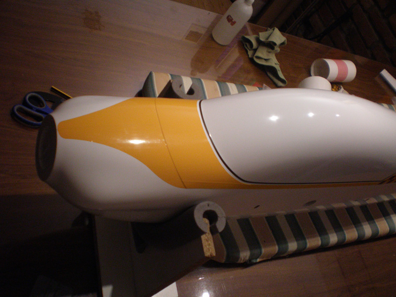

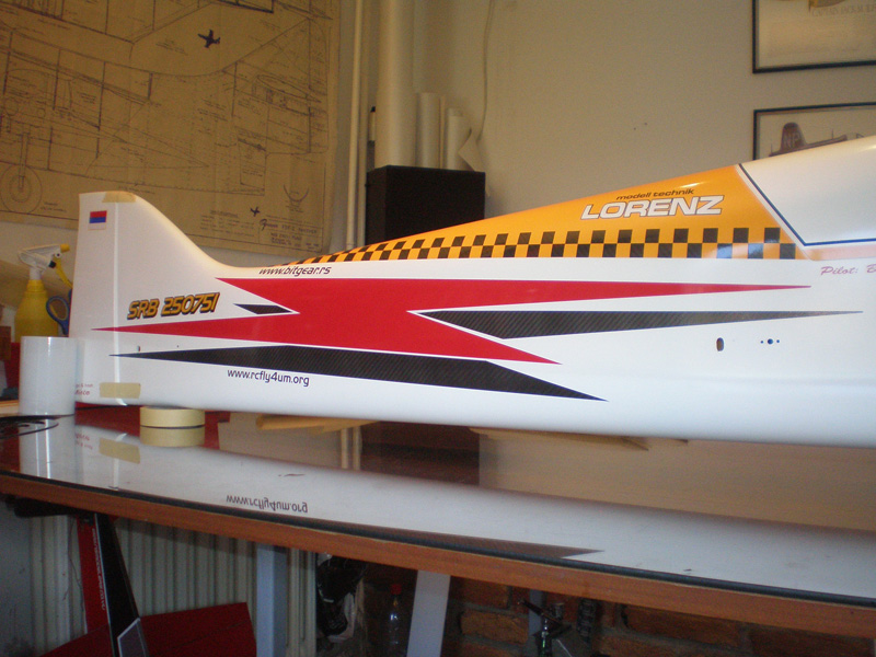

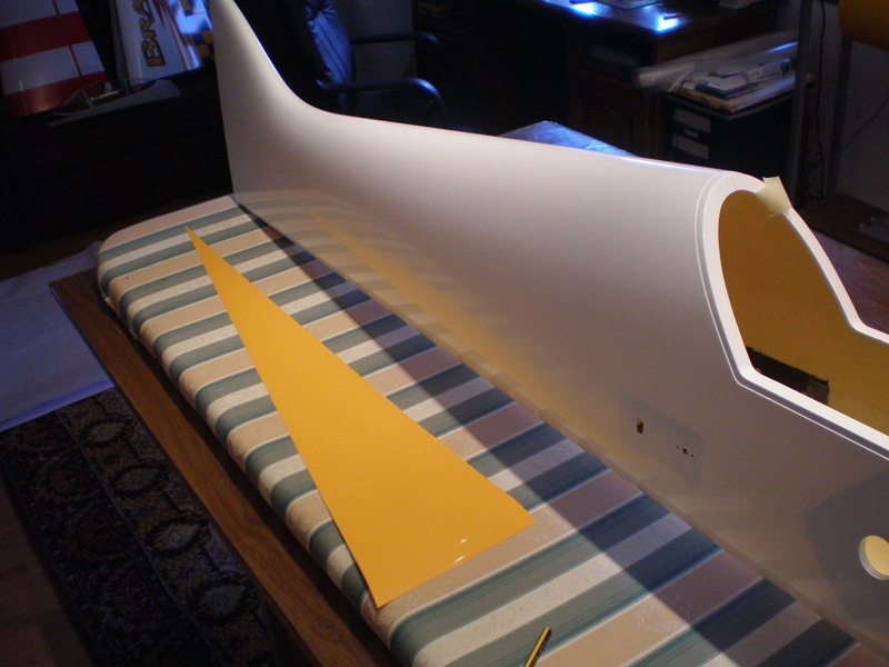

Next was fuselage...
Attachment 2236521
Attachment 2236522
First yellow areas...
Attachment 2236523
Attachment 2236524
Attachment 2236525
Attachment 2236526
Attachment 2236527
I add black stripe for easier cutting...
Attachment 2236528
Attachment 2236529
Attachment 2236532
Than copy - paste everything on other side...

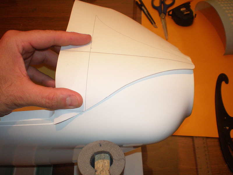

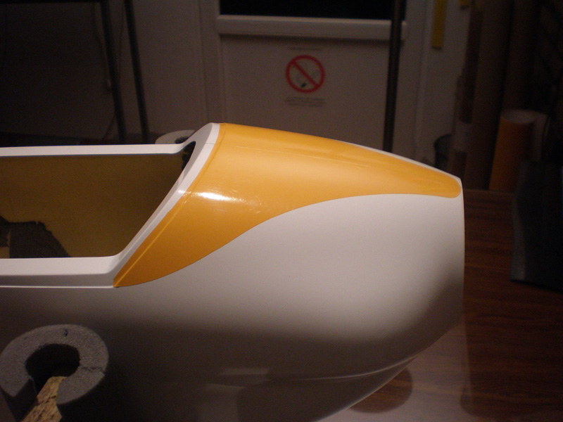

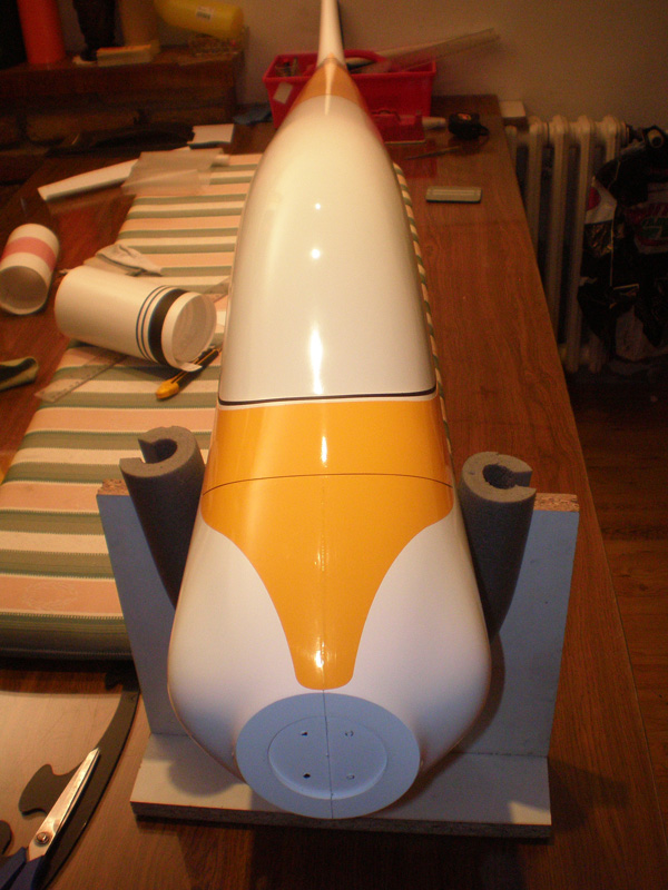

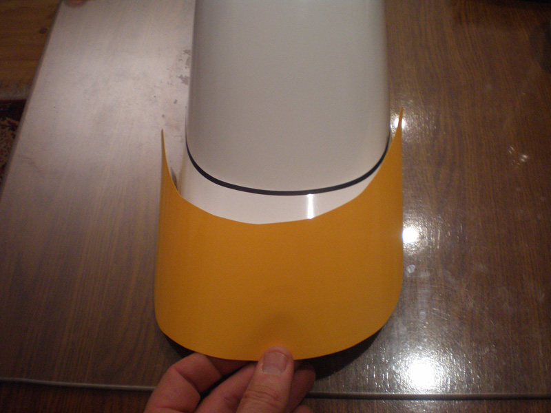

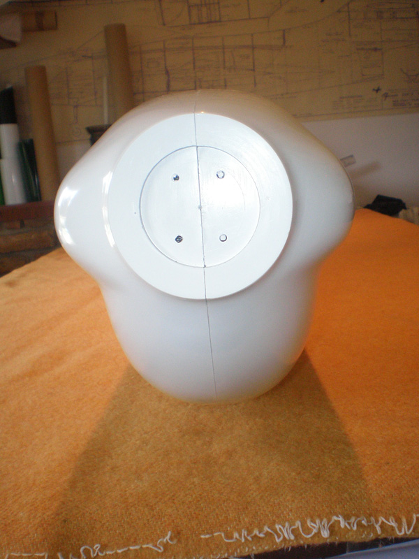

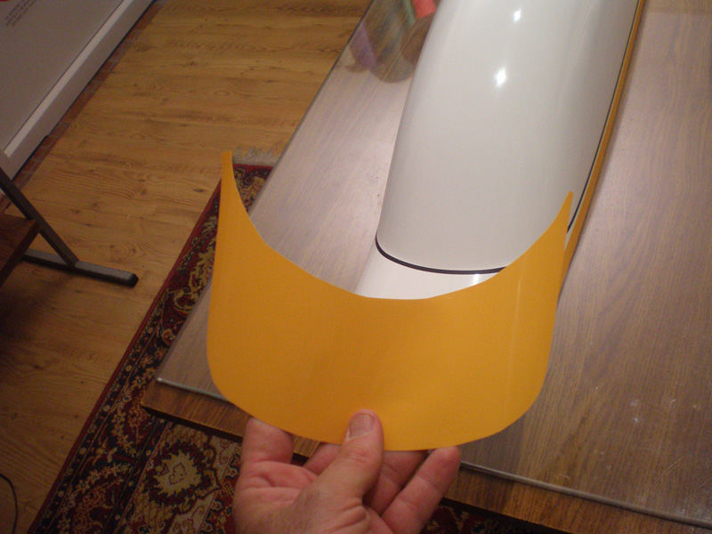

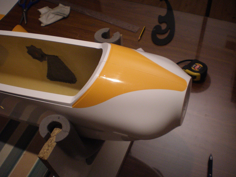

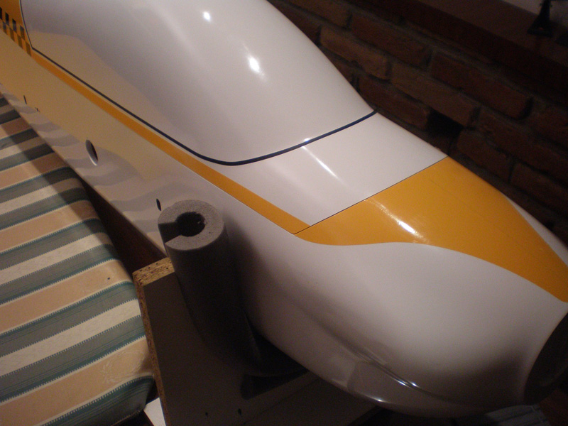

Next was front end of the fuselage...

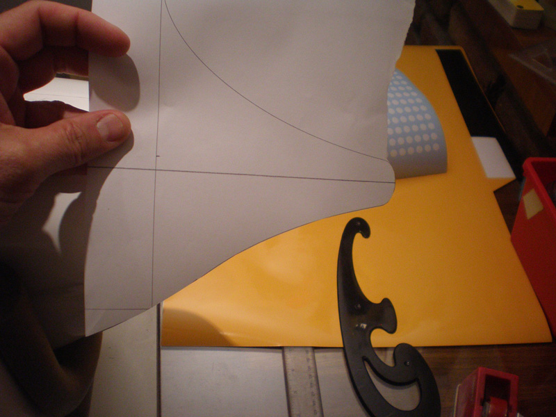

I must made paper template...
Attachment 2236534
Attachment 2236535
Than I scan it in computer and finally cut on my Roland cutter......
Attachment 2236536
Attachment 2236537
Next step was easy...
Attachment 2236538
Attachment 2236539

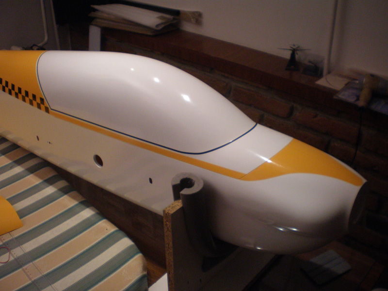

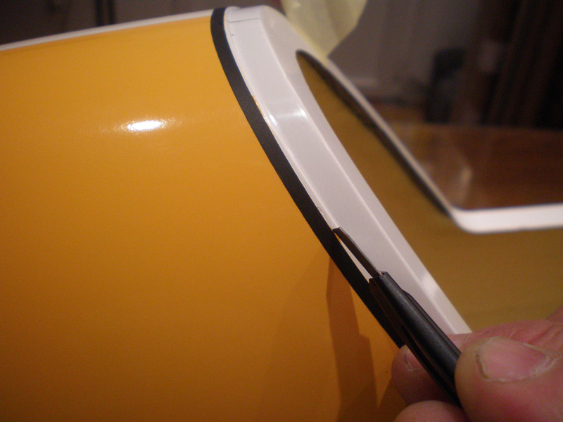

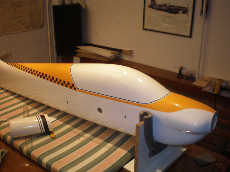

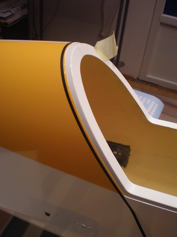

Than I add yellow and black line on cabine. Yellow line connect front and rear yellow fuselage areas...
Attachment 2236540
Attachment 2236541

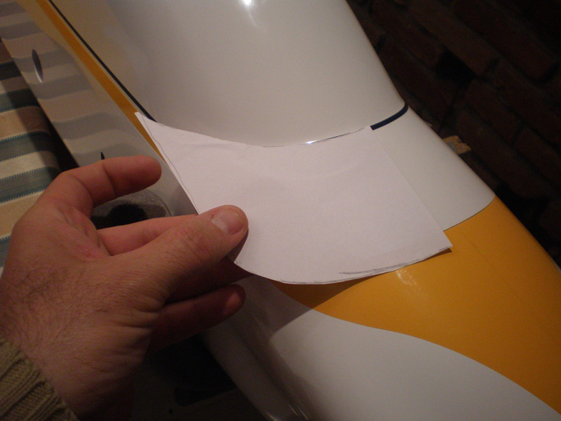

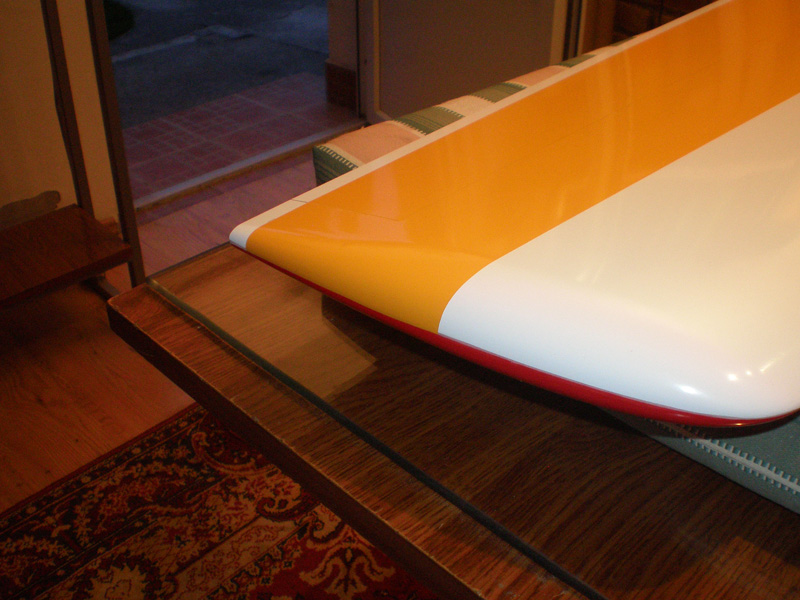

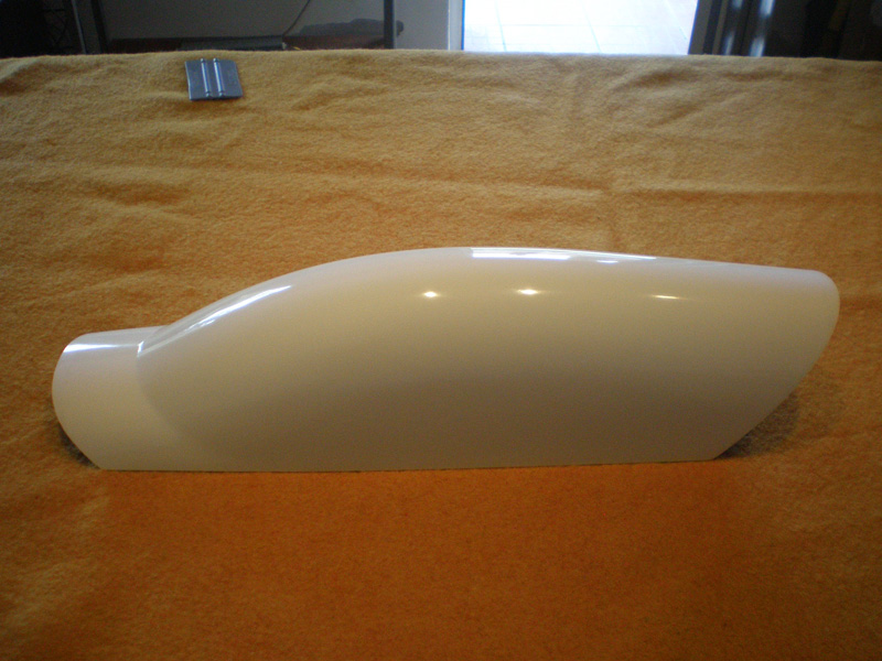

But, when I add cabin on fuselage I saw that in fron was big white area...
Paper templates again...
Attachment 2236542
Attachment 2236543
Attachment 2236544
...little cutting, little trimming and...
Attachment 2236545
Attachment 2236546
Attachment 2236547
Attachment 2236548

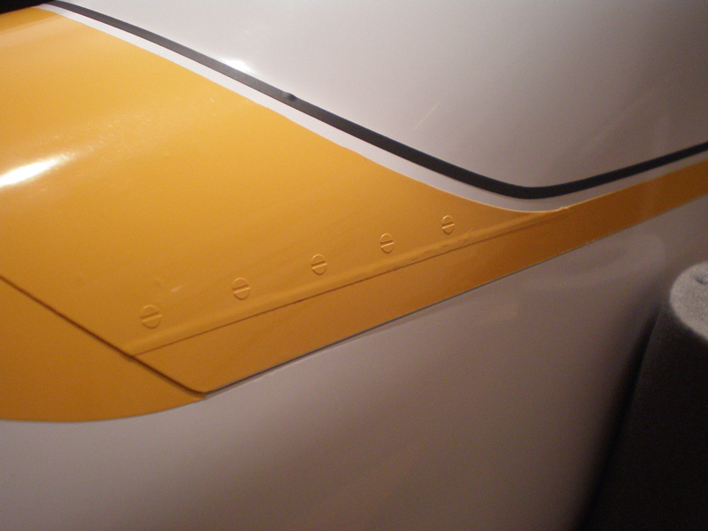

On the foil lap I add "warbird" details - screws...
Attachment 2236549

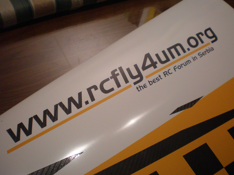

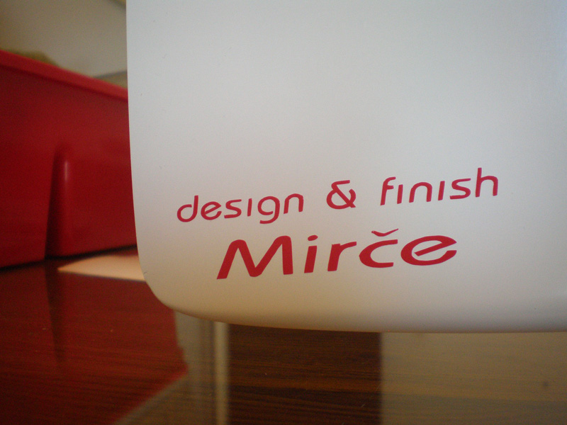

Last touch was adding authors logo...
Attachment 2236559

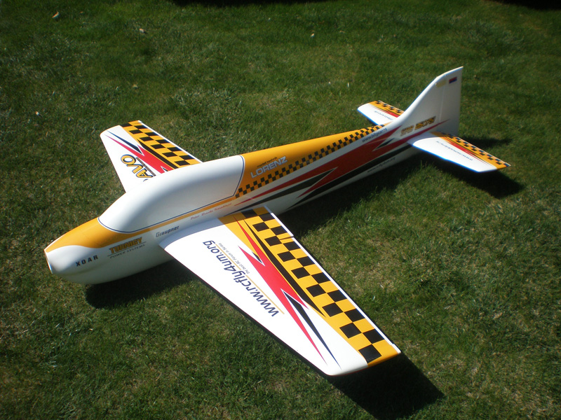

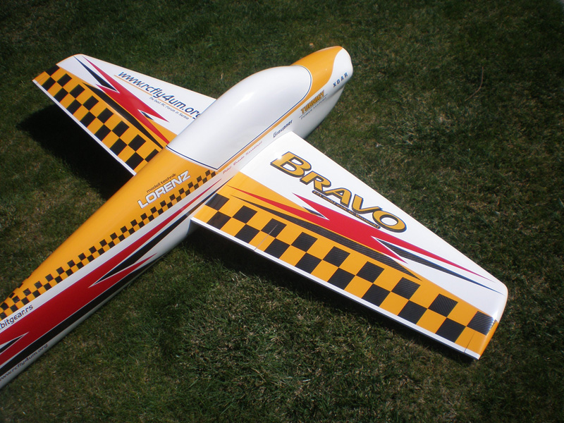

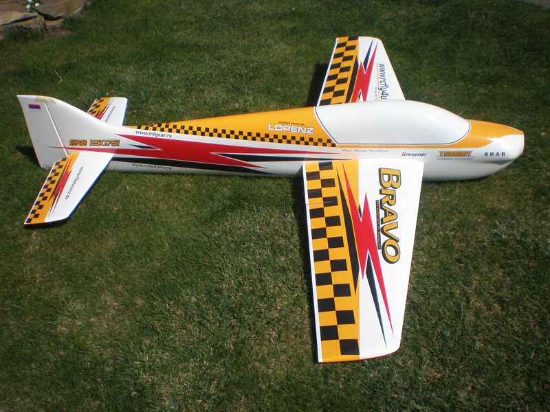

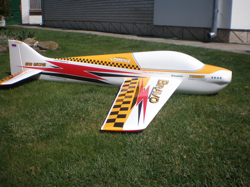

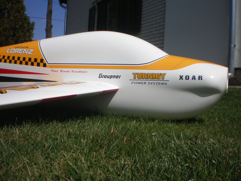

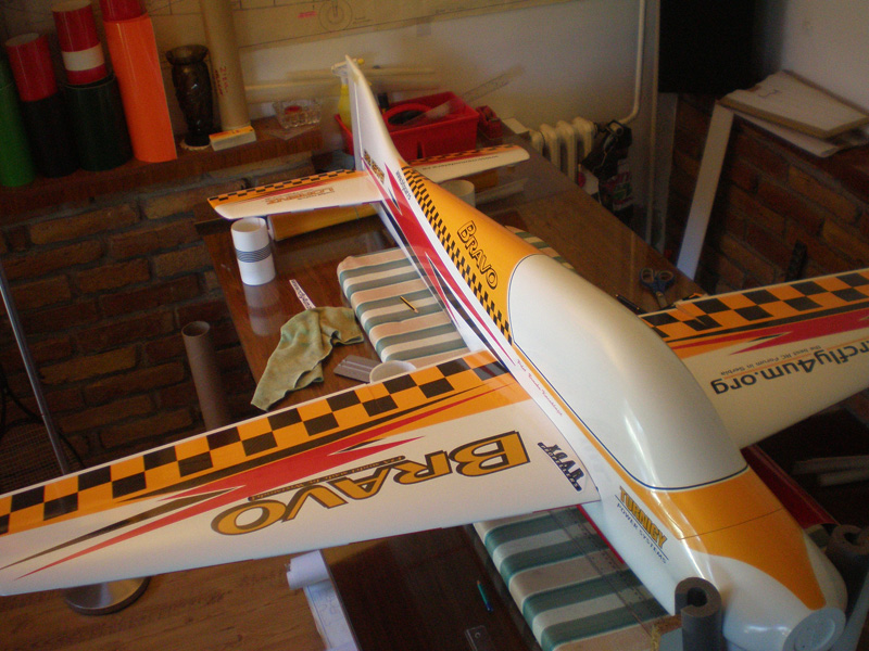

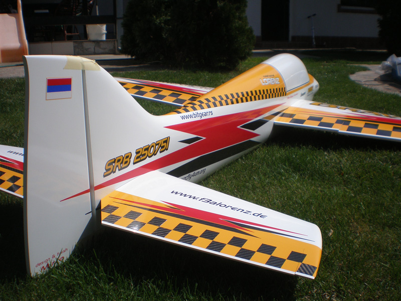

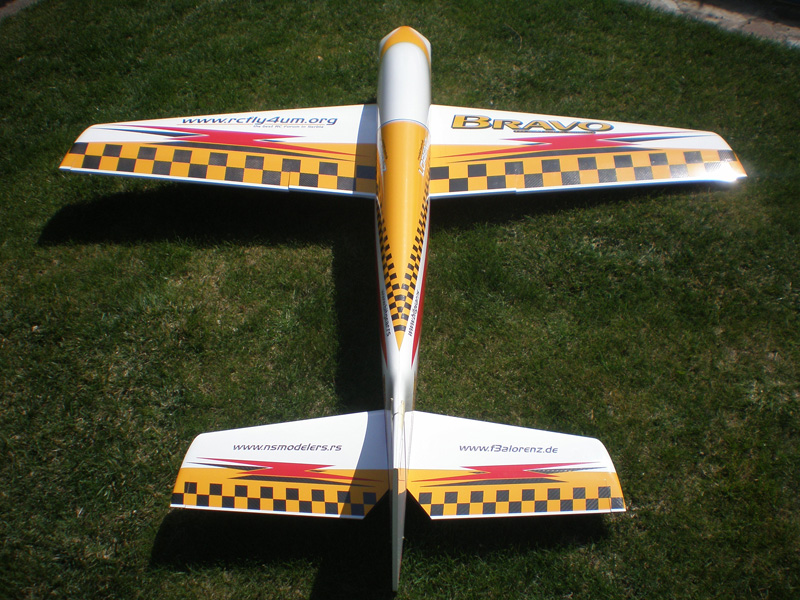

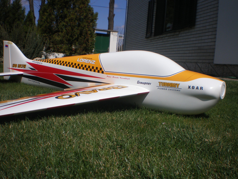

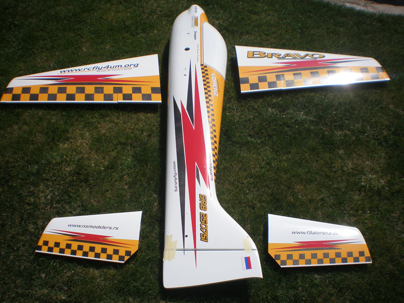

And finally Bravo in full shine...
Attachment 2236560
Attachment 2236561
Attachment 2236562
Attachment 2236563
Attachment 2236564
Attachment 2236565
Attachment 2236566
Attachment 2236567
Attachment 2236568
Attachment 2236569
Attachment 2236570

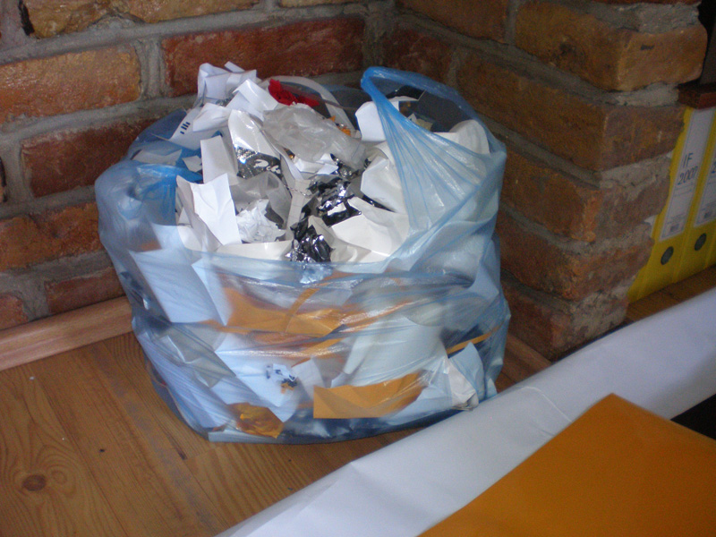

30 hours of work, and full bag of excess foils...

That is a phenomenal way to finish an airplane!  Do you know how much weight the covering added to the aircraft?  I'm curious versus paint.<div>
</div><div>Regards,</div><div>Scott</div>
mirce 04-13-2012 10:03 AM
RE: Color scheme on Bravo from lorenz
Thanks guys...
Scott, square meter of this Oracal foil is 135 gr. For sure I'm not spent so much...
