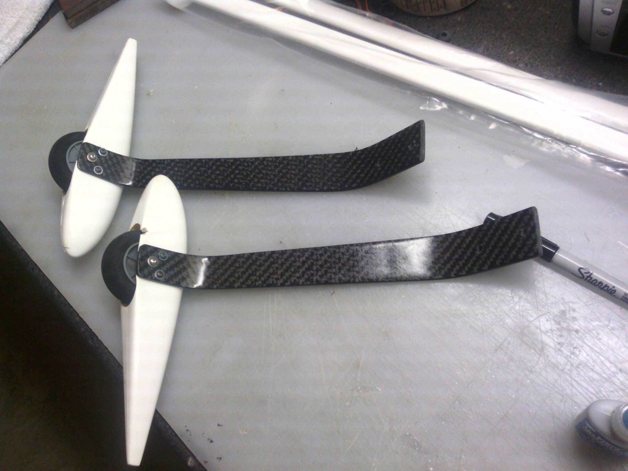

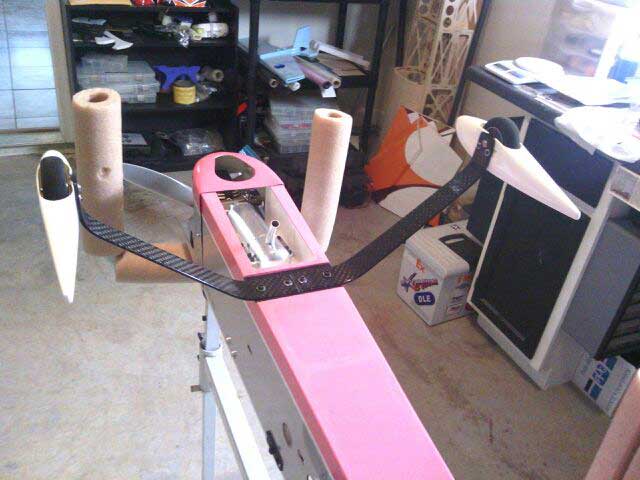

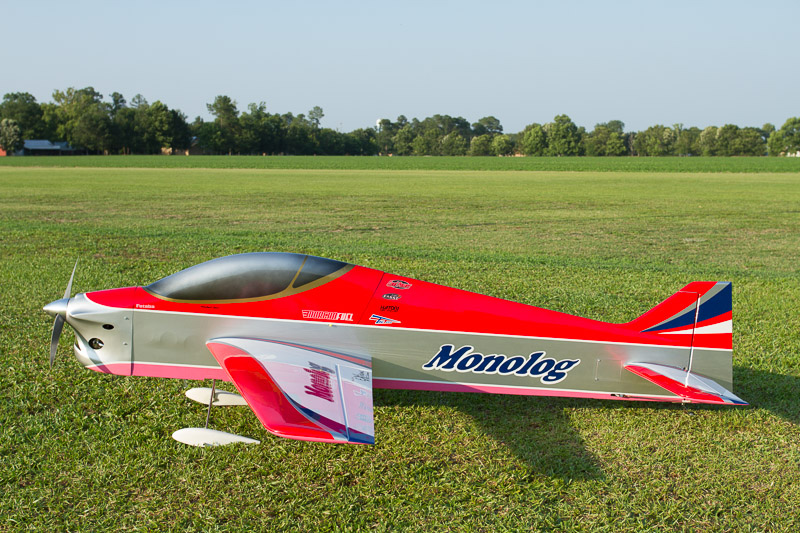

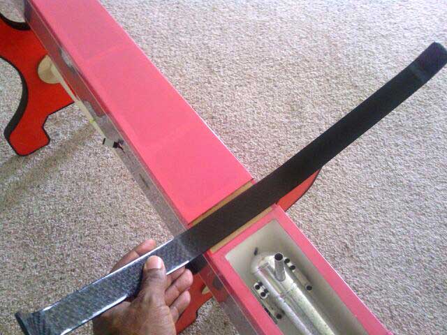

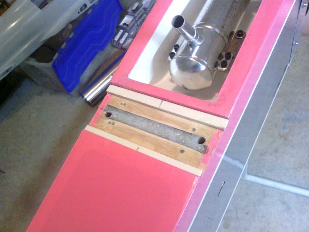

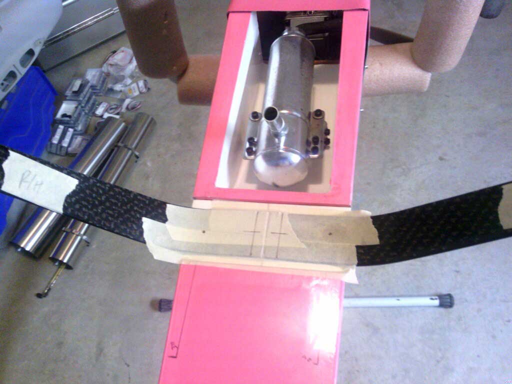

OK, with a little searching and ingenuity I have solved the carbon Fiber gear issue on the Monolog 110. Ordered a set of gear from Graphtechrcshop.com item # 280 a quick trip over to my friend Raiko with raikodzigns.com and presto we have carbon gear! See photos below. http://www.rcuniverse.com/forum/atta...mentid=1906752http://www.rcuniverse.com/forum/atta...mentid=1906753http://www.rcuniverse.com/forum/atta...mentid=1906754http://www.rcuniverse.com/forum/atta...mentid=1906755http://www.rcuniverse.com/forum/atta...mentid=1906756http://www.rcuniverse.com/forum/atta...mentid=1906757http://www.rcuniverse.com/forum/atta...mentid=1906758http://www.rcuniverse.com/forum/atta...mentid=1906759http://www.rcuniverse.com/forum/atta...mentid=1906760http://www.rcuniverse.com/forum/atta...mentid=1906761
Jetdesign 08-10-2013 03:18 PM
Some people will take a small piece of carbon and bridge it across the two gear halves - use the two innermost bolts, one from each gear leg - to spread the load during hard landings.
I like Graphtech gear. I wonder if that set will fit my Venus.
Nice work by the way, looks good.

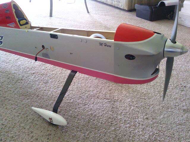

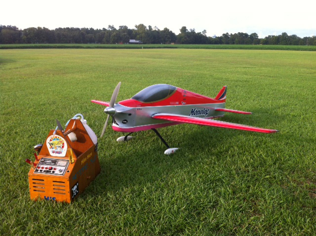

mhare2000 08-10-2013 06:49 PM
5 Attachment(s)

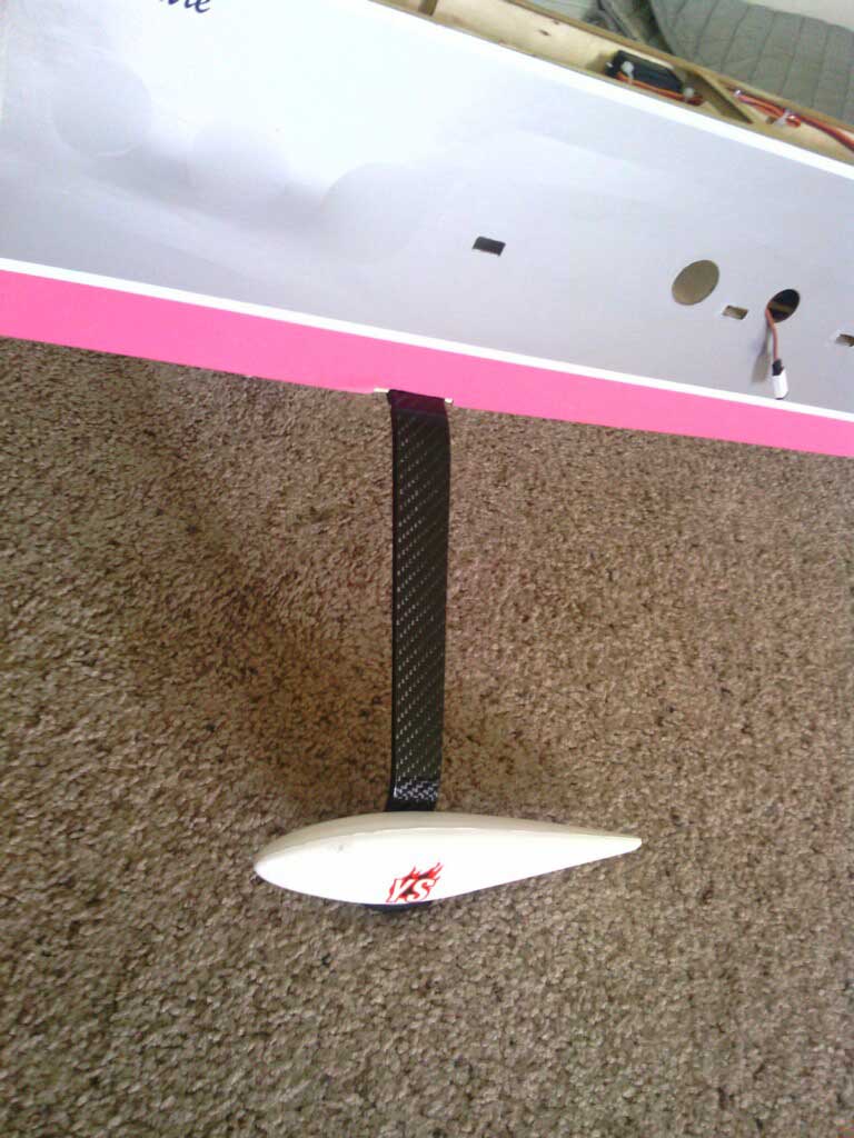

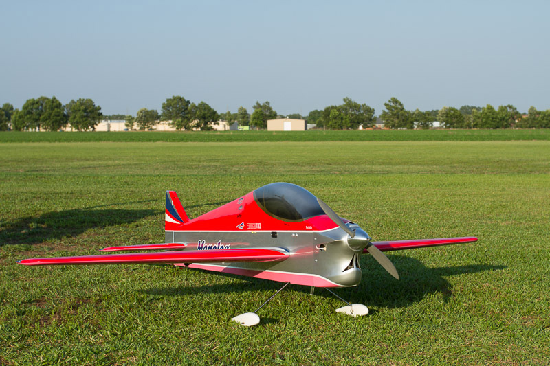

Test Flight over with the new gear! There was no change in flight characteristics! Before and after photos!http://www.rcuniverse.com/forum/atta...mentid=1906875http://www.rcuniverse.com/forum/atta...mentid=1906876http://www.rcuniverse.com/forum/atta...mentid=1906877http://www.rcuniverse.com/forum/atta...mentid=1906878http://www.rcuniverse.com/forum/atta...mentid=1906879
Bob Pastorello 08-15-2013 01:05 PM
mhare - that is a beauty - good looking gear! Very clean glow install, too!
____
I've just completed mine. DLE 20 with standard muffler, standard wire gear with standard pants. Haven't had a chance to maiden yet, but ground runs seem to tell me there will be plenty of punch for this setup. I just had to try making it a gassie, even though it may be a tad heavy this way. Will report back when it's had some airtime; should be soon.

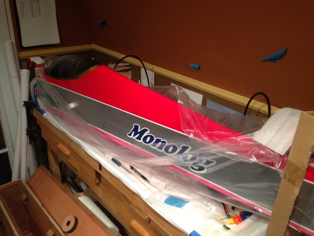

kingconsulting 09-01-2013 09:28 AM

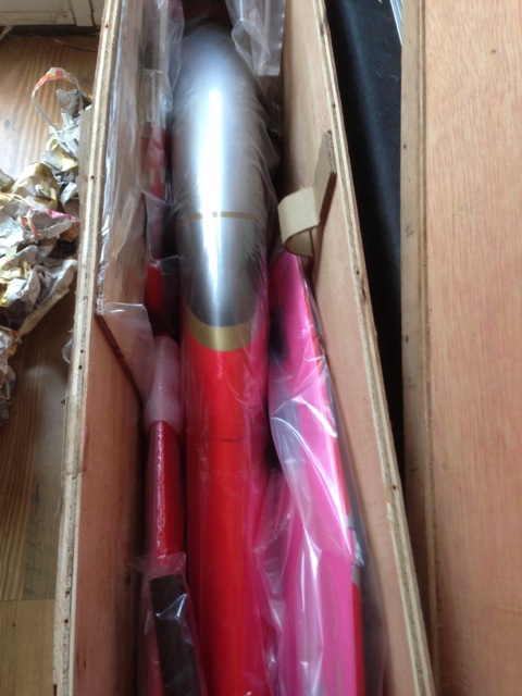

3 Attachment(s)
Lookie what the Fedex guy dropped off yesterday.
Robert

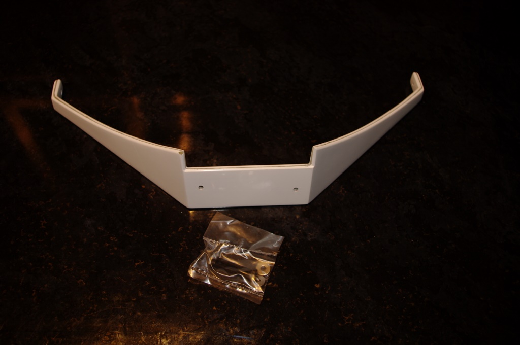

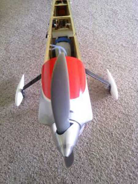

sorry chaps a bit late but here is a pic of the composite upgrade http://www.rcuniverse.com/forum/atta...mentid=1918385
Bob Pastorello 09-09-2013 11:36 AM
If that is BJ's "Composite", it is very flexible fiberglass which flexes far too much, if it's the same as what he did on the ML 70, which is really bad/poor, flexing FAR too much. I have ordered a CF gear from a Chinese supplier on eBay - *if* it is workable, I'll provide all the info here after installed and tested. The fiberglas stuff on the ML 70 is really just terrible.
