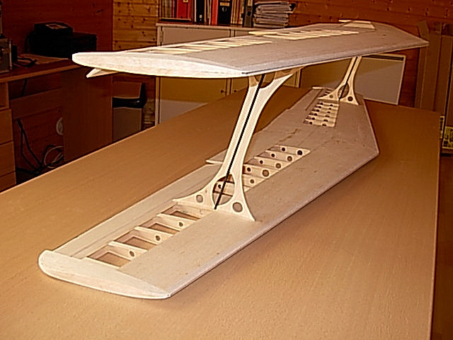

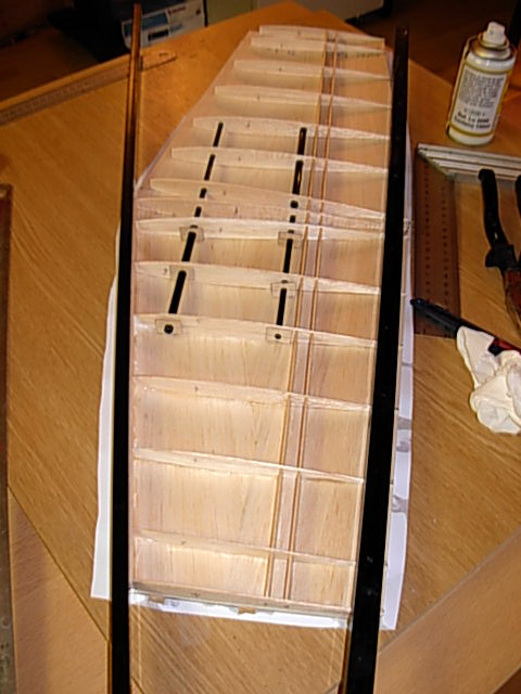

Hello Brian
Friend of mine used
NACA63008a for the wings and NACA 010 for the stab.
Claude

papaone 08-27-2013 10:52 PM
Hello Brian
First version of the bip has wingspan 1,80 m et thickness chord 10 % .
So he wanted to decrease drag and version 2 has wingspan 1,70 m and chord thiness 8 %.
We uses logiciel Tracfoil to draw airfoil :
http://tracfoil.free.fr/tracfoil/accueilE.htm
Thanks to Matt and Doug to answer.

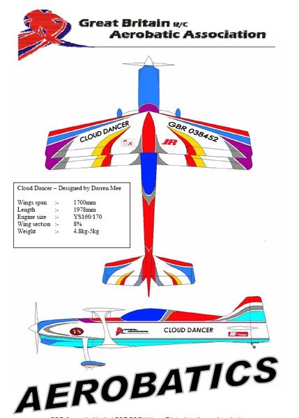

papaone 08-27-2013 11:01 PM
1 Attachment(s)
Hello Brian
I dont know if this project's Daren Mee is done . So Cloud Dancer is designed as the bip of my friend I sent him plans.

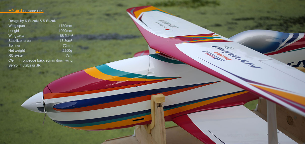

papaone 08-29-2013 07:24 AM
1 Attachment(s)
Hello Brian
Example of awesone biplane with some caracteristics
http://www.oxai-rc.com/en/43.html
http://www.rcuniverse.com/forum/atta...mentid=1914516
