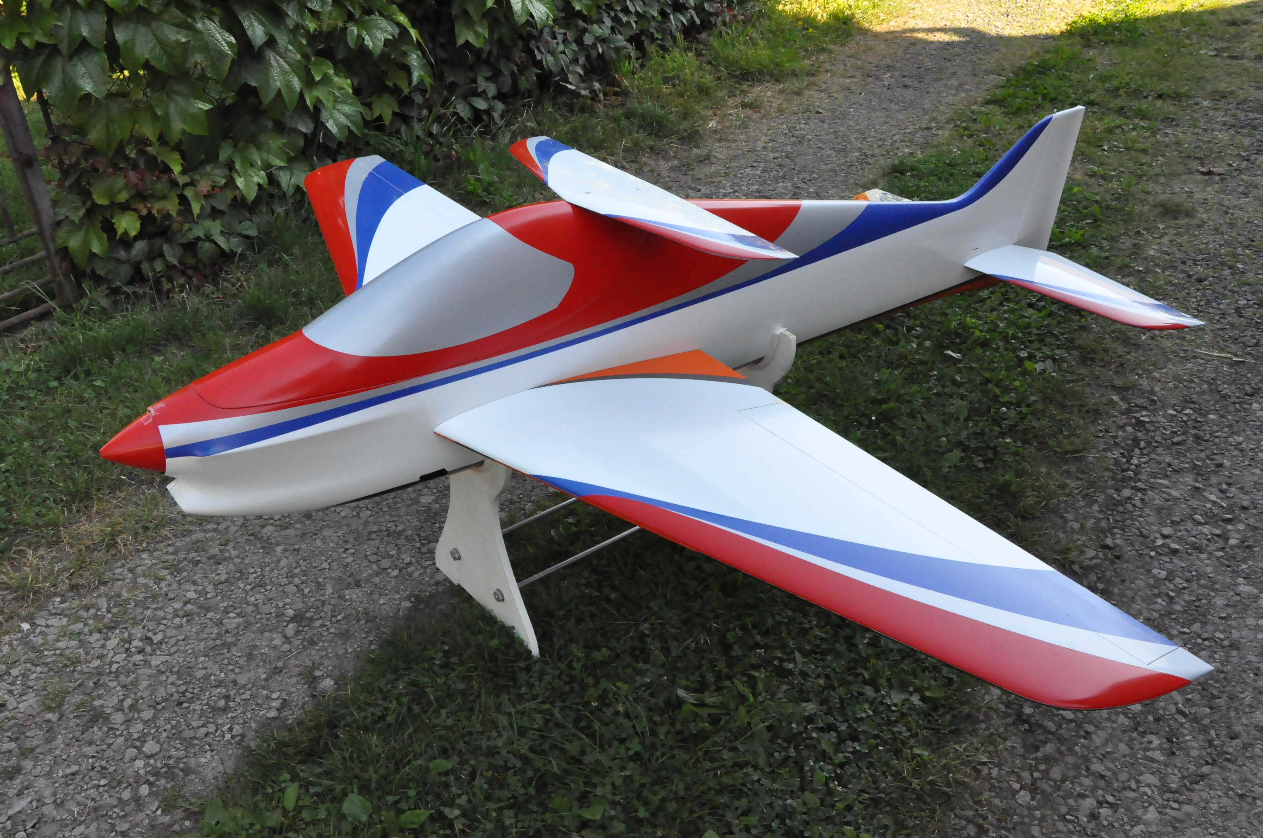

So here is the successor to my trusty Gaudius. Thanks to Ohd for pointing my search in the right direction.
I have not received the model yet but it is obviuos that quality has not gone down, since the last time Mr. Jaroslav made a lay- up.

Eggert 08-16-2014 07:48 AM
1 Attachment(s)
And a picture of the front .....Looking good i think ! http://www.rcuniverse.com/forum/atta...mentid=2022790

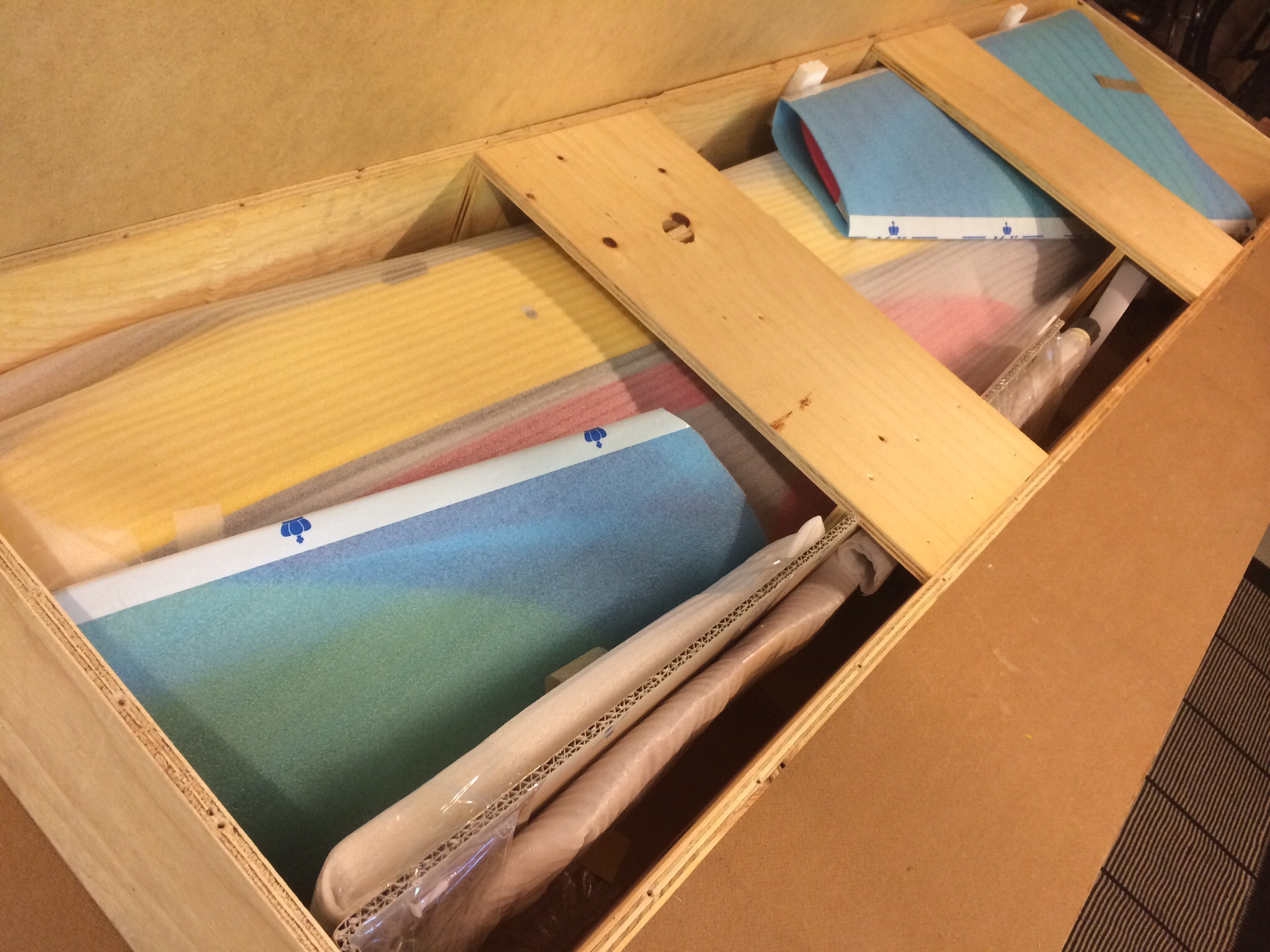

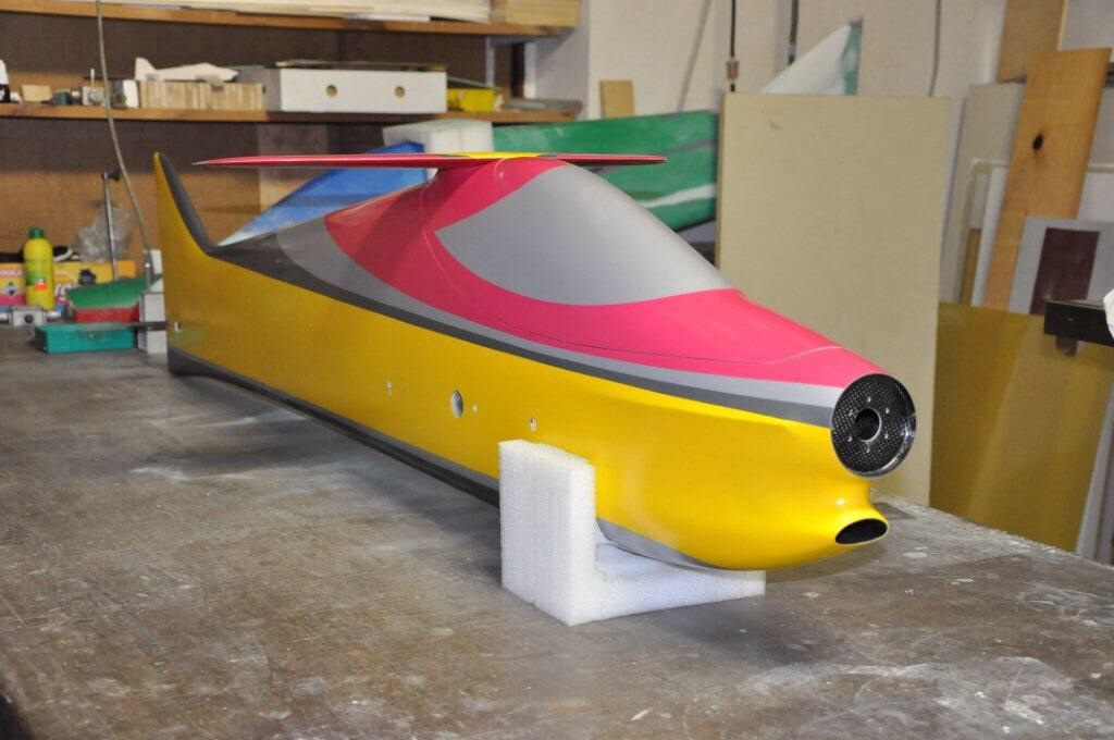

....and so it arrived. In a wooden box and packed so no damage is possible :D
http://www.rcuniverse.com/forum/atta...mentid=2026460

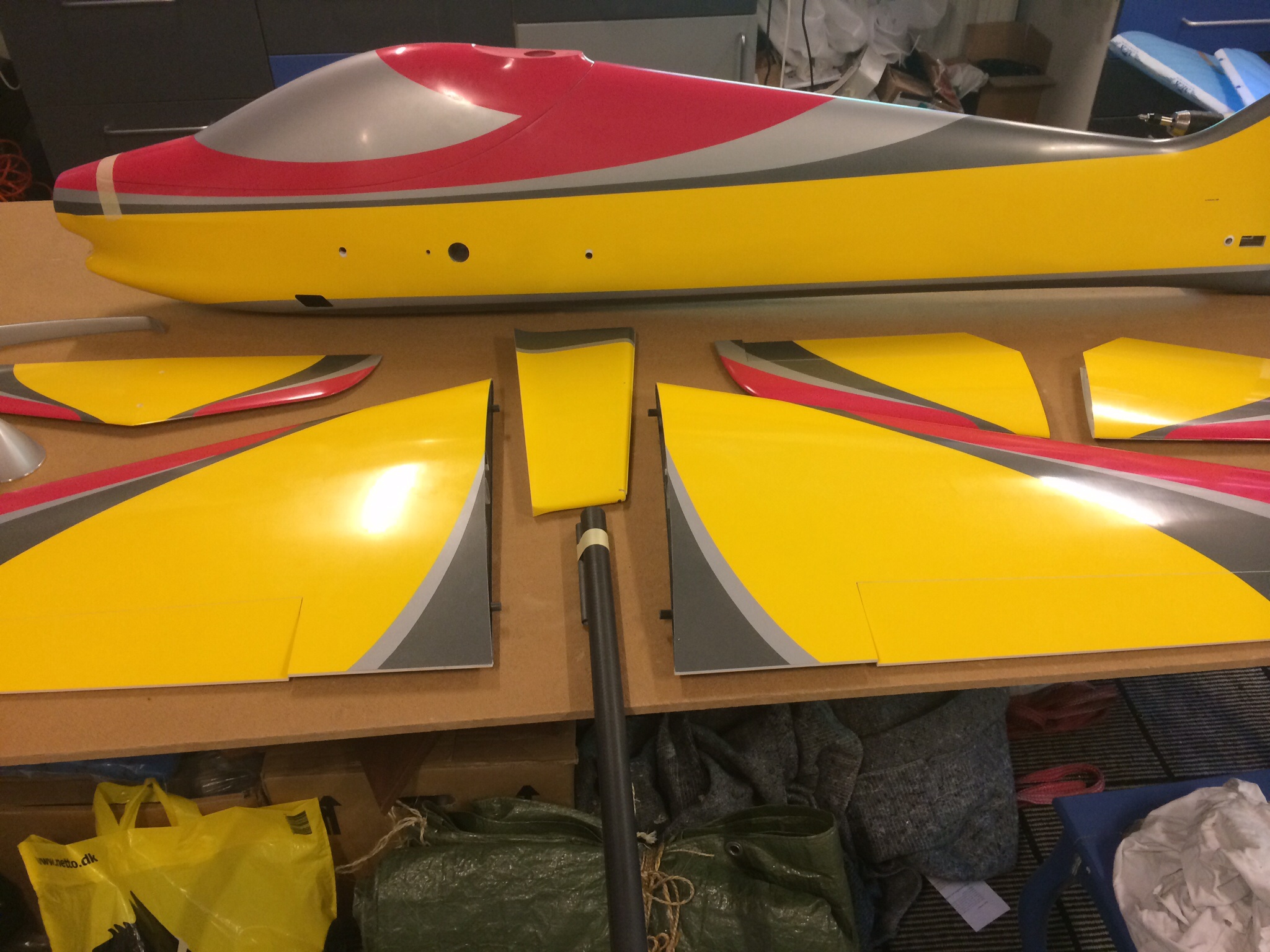

2 Attachment(s)
and going through the different parts, it is just a pleasure to see the quality.http://www.rcuniverse.com/forum/atta...mentid=2026463http://www.rcuniverse.com/forum/atta...mentid=2026464

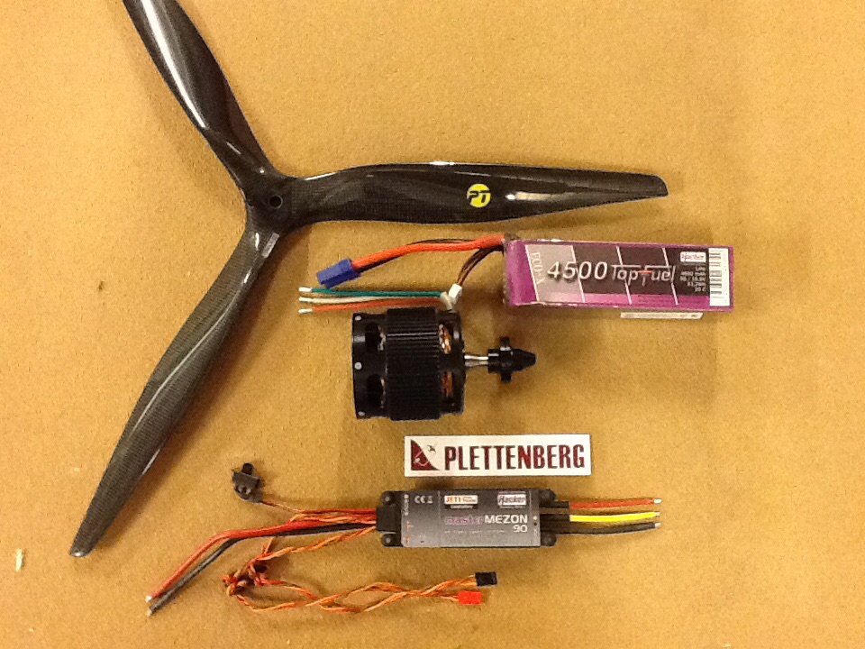

Eggert 10-01-2014 10:20 AM
1 Attachment(s)

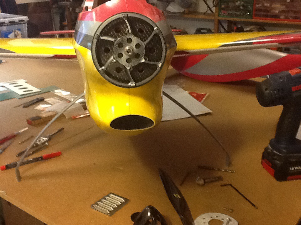

I'm still working slowly ahead on this one ......Have the motor and propeller and frequency converter in place. And the first set of batteries ;). http://www.rcuniverse.com/forum/atta...mentid=2036537

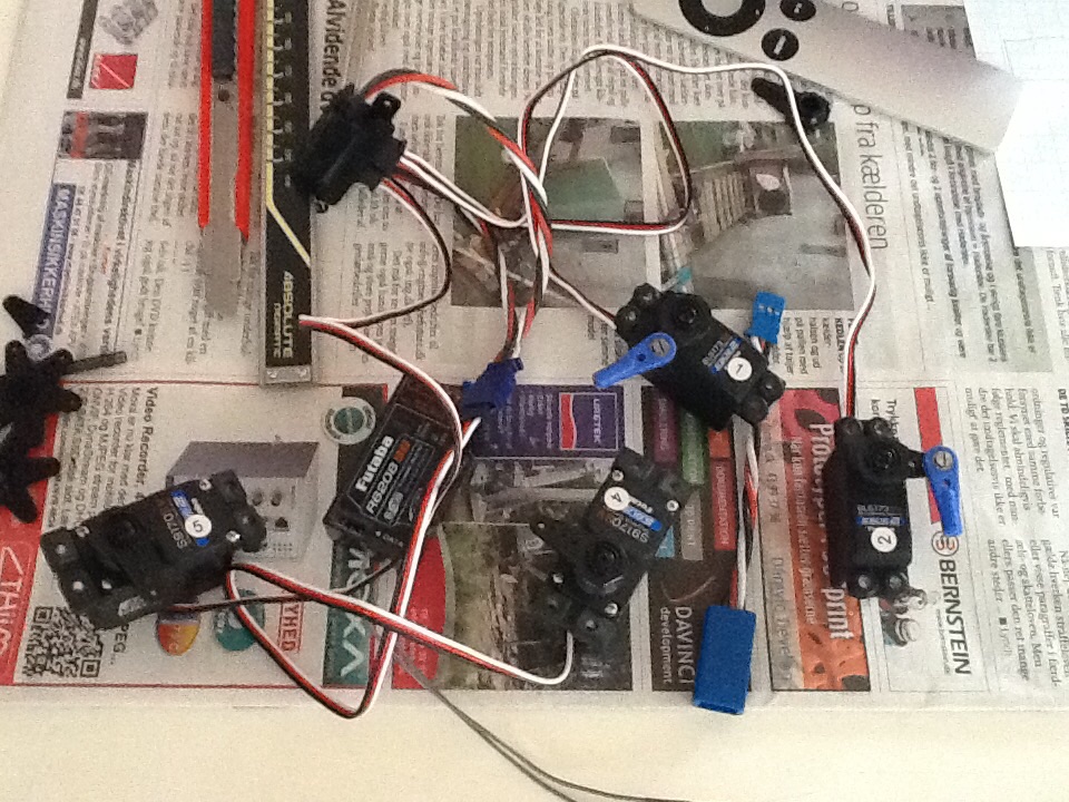

I'm right now working on the install of servos and connections. First plane of mine with hv servos, and also first plane with power supply to rc gear from drive accu, and also first plane with s-bus. Lots of firsts :Dhttp://www.rcuniverse.com/forum/atta...mentid=2036539

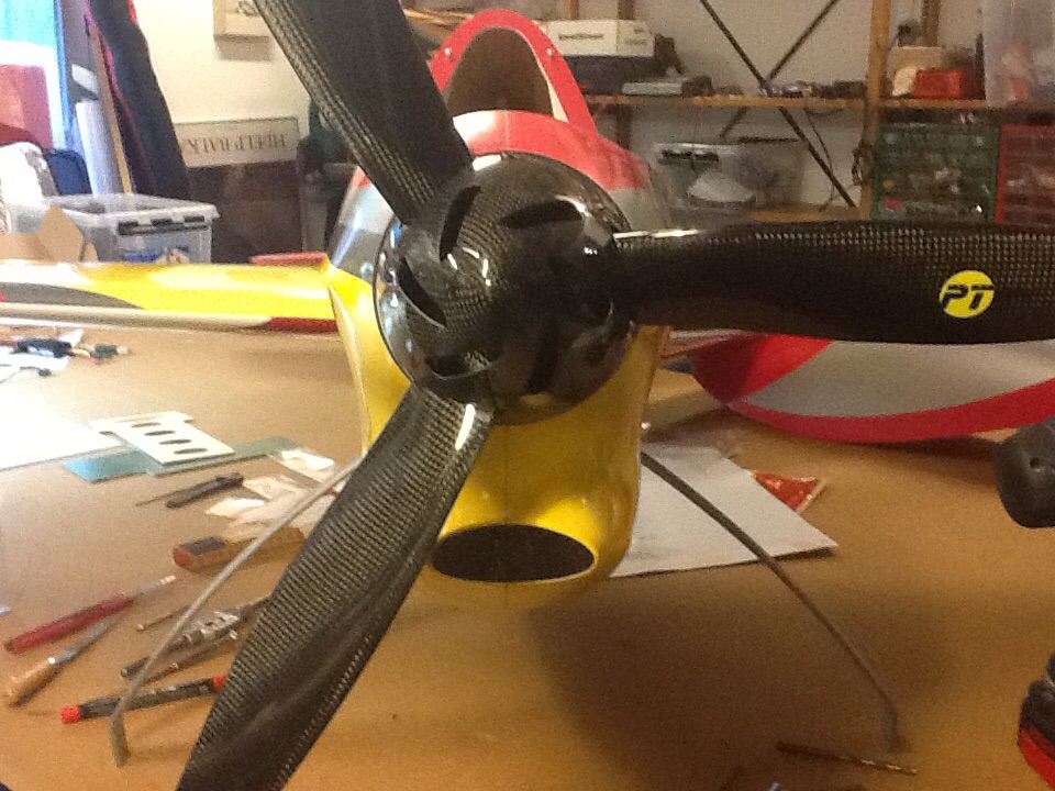

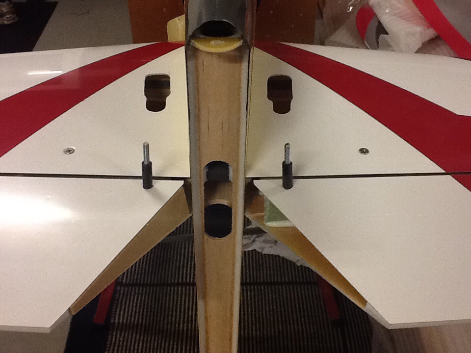

Besides fiddling with servo linkages i also managed to install the tail feathers. And for the first time my motor will get a falcon spinner...http://www.rcuniverse.com/forum/atta...mentid=2037407

And with the prferred prop http://www.rcuniverse.com/forum/atta...mentid=2037409

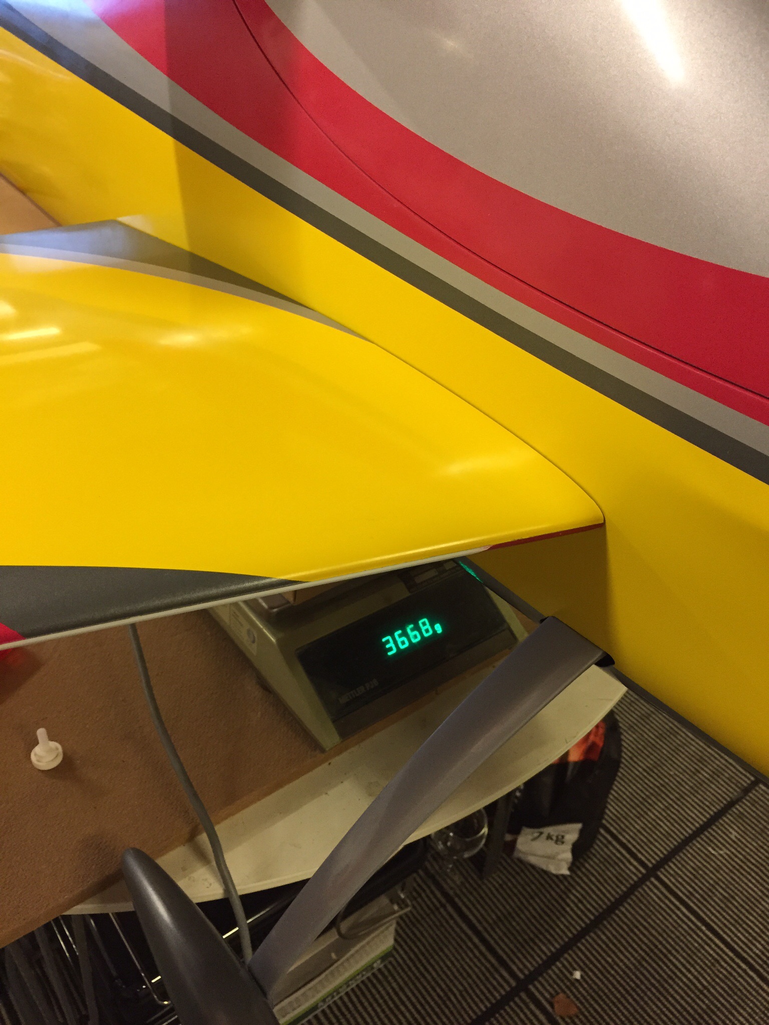

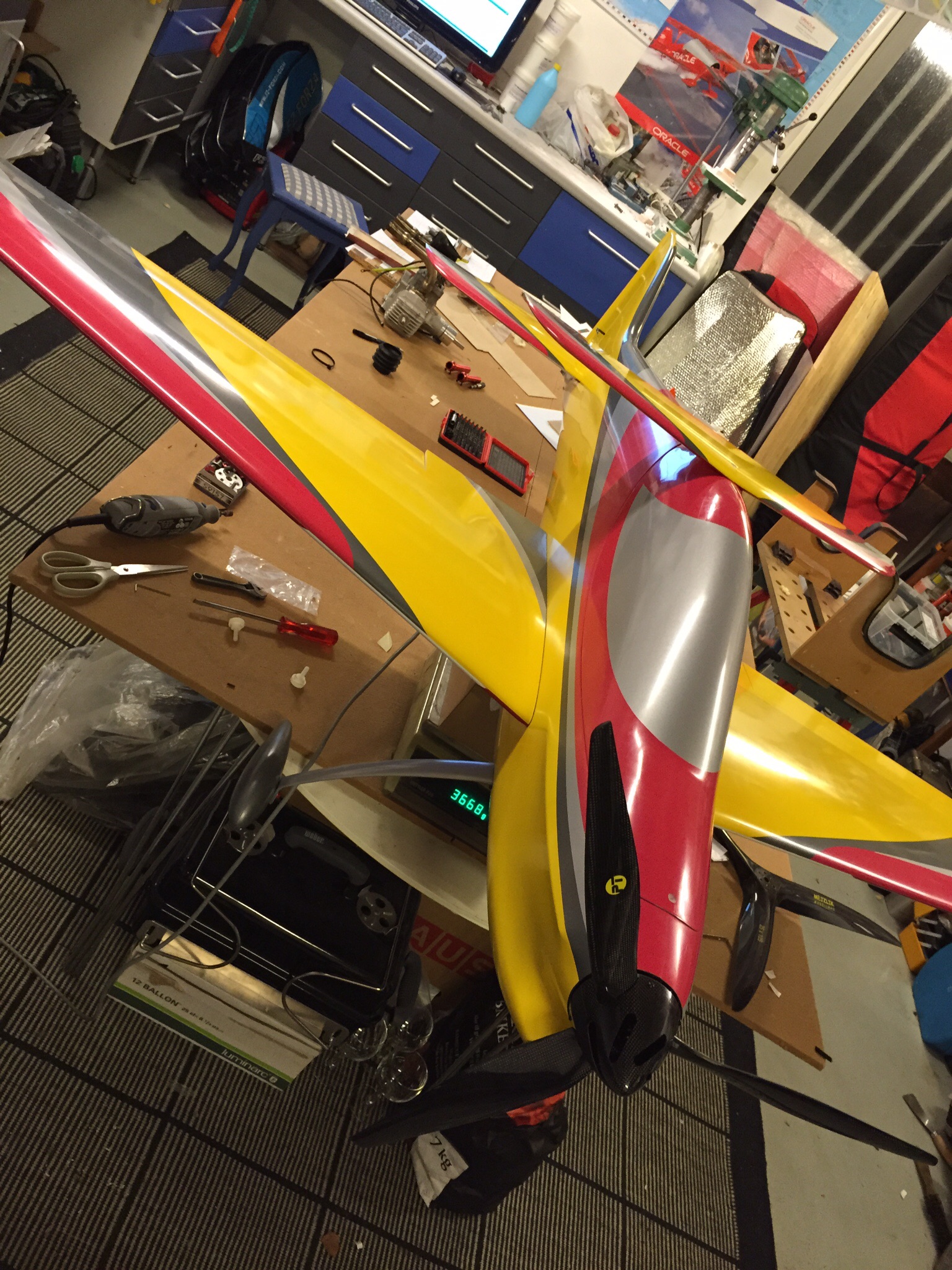

So it is done ! Good weight
I will probaply glue the top wing, when i have trimmed the airplane http://www.rcuniverse.com/forum/atta...mentid=2051943
Eggert 12-03-2014 01:49 PM
1 Attachment(s)
http://www.rcuniverse.com/forum/atta...mentid=2051944

Eggert 06-24-2015 11:44 AM
I have now more than 100 flights on the M14. Had to lift the small wing's trailing edge some 5 mm.
Rolls are good and performed with very very slight added rudder. Incredible stable level flight with good tracking. The overall drag makes it kind of slow, allthough it feels very smooth ( makes sense, right ? ;)). The Plettenberg and Mezon kombination is working well and especially low end used during landing is super easy to handle and makes for the smoothest landings. I fly with the BEC from the Mezon. No backup battery. It works fine and is so easy........I am off to the charging. Got some flying to do.....
