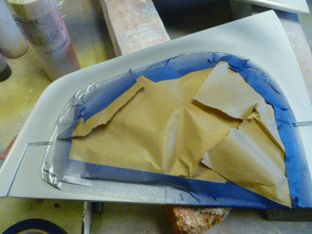

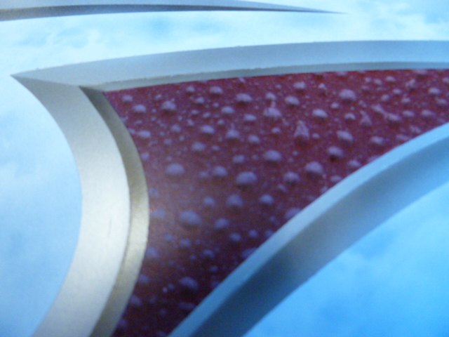

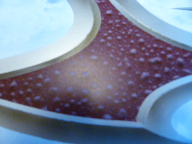

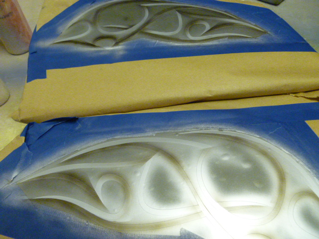

Portlandflyer 01-02-2016 04:55 PM
3 Attachment(s)
So I then came in and built up the background with a bit of red and white. Here is the finished product. I still have to do all the little touch up on the exposed edges of the ailerons and it will be ready for clear. It looks good now, but it will look a whole lot better after clear and cut and buff.

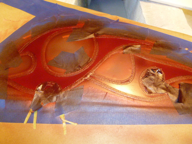

Portlandflyer 01-02-2016 05:08 PM
2 Attachment(s)
Here is where you need to stay flexible with this stuff. On the center portion of the graphic I intended to use a cool paint method call the "water drop" trick. It's very easy to do and looks just like water drops. What you do is spray water drops on the surface and just airbrush a light color from one direction at a low angle. You then let the water dry and shoot some candy over it to lock it down and shade the water drops.
I had it all done, but I got an ugly color shift when I shot the candy and it looked muddy. I didn't like the look and re shot it back to the red. http://www.rcuniverse.com/forum/atta...mentid=2139344http://www.rcuniverse.com/forum/atta...mentid=2139345

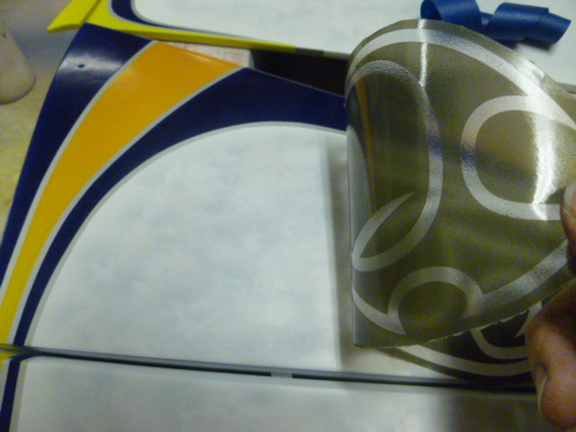

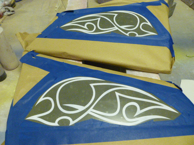

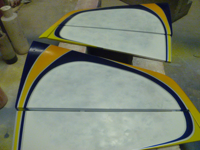

Portlandflyer 01-05-2016 09:21 AM
2 Attachment(s)
Here is a different picture of one completed wing.
I have also attached a picture of the masking film before they are placed on the wing. You can see I have removed the 1/4 inch section ahead of time. That portion becomes the "outside" bevel.

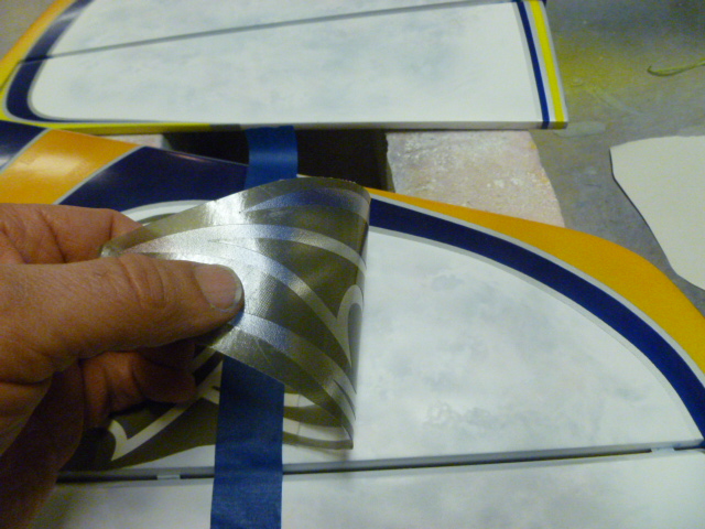

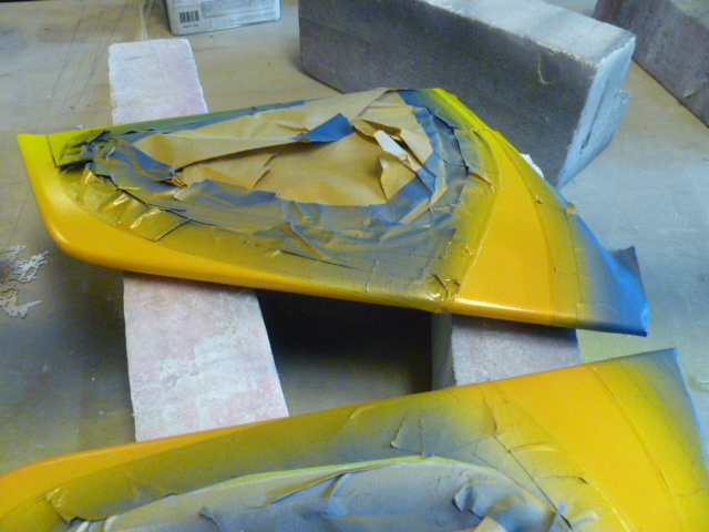

Portlandflyer 01-05-2016 09:51 AM
1 Attachment(s)
I won't be posting much for a while as I still have one more wing and both stabs to complete, which is just a repeat of what we have gone over so far.
Let's go over what I would call more advanced masking methods that will create very clean results in much less time.
As I said before, I am always trying to mask to not have two colors butt against each other. Painting pinstripes like I have done on the wings can be very time consuming if we don't plan them ahead. I will have several on the fuselage that I will show the following method of painting and masking.
I have attached two views. One looking at a cross section and the other viewed straight down.
Let's say we are doing a silver pinstripe and we will be painting yellow on one side of the pinstripe and blue on the other (which I will be doing). On the cross section view you can see how the silver is shot on the surface with no masking tape. You can see how it tapers out on each side and does not create a hard edge. What I then do is lay out the pinstripe by just covering the silver that has been painted.
What I would then do is mask one side off on top of the 1/8 inch pinstripe tape and shoot let's say yellow. I would then pull the masking, leaving the 1/8 inch tape. I would then mask back over the yellow on top of the 1/8 inch tape and shoot the blue on the other side.
Now when you pull all the masking we have an extremely clean (and uniform) 1/8 inch pinstripe with only an edge from the yellow and the blue to clean up.

Portlandflyer 01-05-2016 03:09 PM
Every time I make a post it reminds me of something I forgot about. A couple of things.
In my example above where we were painting yellow over the sliver area used for the pinstripe, I would not shoot the yellow over a white base with that small amount of silver showing on the edge. The first rule when shooting yellow is "if it can show through, it will". Yellow is likely the hardest color there is to get coverage without flaws or unwanted colors showing. In the case above I would just dust on a little white over the silver before I shoot the yellow. It probably won't show, but why take the chance. You don't need to cover the silver heavy with white.....just a few passes.
On that matter, shooting yellow over a silver base is perfectly fine, I just want it to be a solid base of silver or white. I would never shoot yellow over anything other than white or silver. I am sure other base colors will work, but I won't take the change.
One other thing about sanding or cleaning up the ridge edges after pulling masking tape or film. You have to be very careful about knocking that edge down over an area like a graphic that has been airbrushed or air gun shaded. Also on the wings I am painting (and fuselage) I have orange fading over yellow. On those ridges, you can not sand them or you will take off some of the ultra fine paint sprayed over the other color. In my case I am shooting orange over the yellow. If I try to sand those edges I am going to cut into the orange and have an ugly area to try to fix.
What some painters do is shoot what is called intercoat clear over those transition areas so they can sand them flush. Intercoat clear is just paint with no pigment in it. I have tried it and don't use this method because it is very easy to sand past the intercoat clear and you are right back with the same problem. Here is how I handle those areas. It may sound crazy, but I have the best results just waiting a day or two for the paint to cure and I lightly scrape off those high ridges with my thumbnail. I just use my nail like a scraper. I have tried other things like a scraper or razer blade, but I have better control with my thumbnail. On ridges that are solid paint, you can sand those down with 600 wet sand paper.
OK...I thought of another issue. When I say to bring your paint level up to 100%, what I am talking about is "saturation". Let's take red as an example. If we start shooting red, it will start out thin and bright if shot it over white, but as we continue to build it up, it takes on a whole different look. The term 100% simply means we have shot enough paint that the color does not change .We could shoot another 20 coats and it will still look the same. This is extremely important if we are embedding an image (graphic) like I did on the wings with the "AUSTRAL" ghost graphic logos. Remember when we pull the masking film we had white under the letters that I dusted yellow over to knock them back so they would barley show. If I had not brought the yellow up to 100%, when I dusted the yellow back over the white letters, I could of had a darker (more paint) level over the letters and they would stand out with a dark blob or a halo around them...pretty ugly.

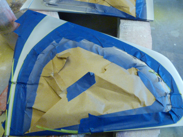

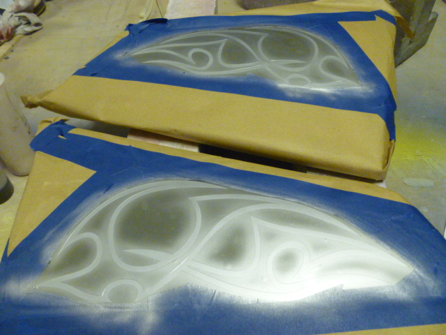

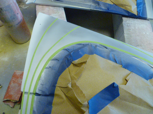

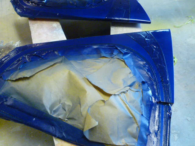

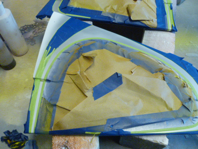

Portlandflyer 01-09-2016 09:31 PM
8 Attachment(s)
OK, both wings are close to done.
Let's go over some masking methods that will help create fast and clean pinstripes. Using this system cuts the time in about half. This is another reason the plotter is so helpful. On the stabs I did a single bevel on the central graphic. All I did was drop out the inside line on the graphic that created the inside bevel on the wings., The reason I only do a single bevel on the stabs is the size of the inside bevel would be so small when reduced, it would be very difficult to work with.
The first thing I do is print the graphic out on the plotter to establish the layout the same as I did on the wings. http://www.rcuniverse.com/forum/atta...mentid=2140577
Here you can see the center is masked and the areas that will have pinstripes are shot with silver (Metalume). http://www.rcuniverse.com/forum/atta...mentid=2140578

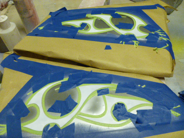

What I then do is just lay down 1/8 inch tape that covers the silver. These areas will become the pinstripes after everything is unasked. http://www.rcuniverse.com/forum/atta...mentid=2140579
Now I continue masking so the only areas exposed are the ones to be painted yellow. http://www.rcuniverse.com/forum/atta...mentid=2140582

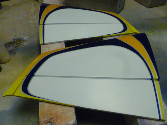

Yellow is shot. http://www.rcuniverse.com/forum/atta...mentid=2140583 Orange is faded from front to back.
Now the yellow is masked and the areas to be blue are exposed. http://www.rcuniverse.com/forum/atta...mentid=2140587
Blue is shot. http://www.rcuniverse.com/forum/atta...mentid=2140592
That's it. When we unmask, all of the pinstripes are exposed. http://www.rcuniverse.com/forum/atta...mentid=2140593

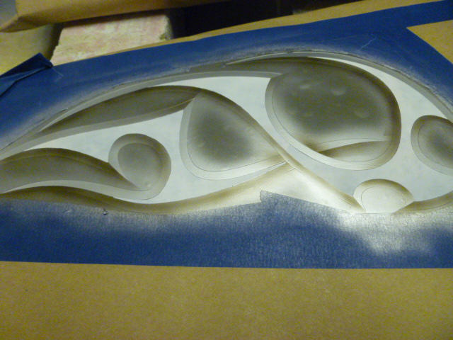

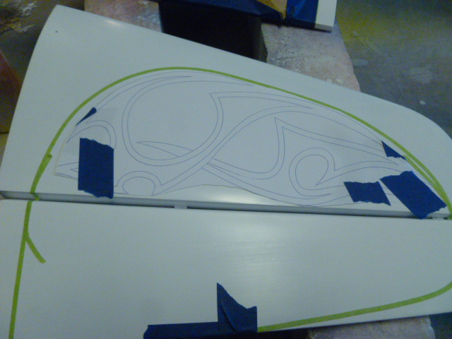

Portlandflyer 01-09-2016 09:46 PM
10 Attachment(s)
Now the single beveled center graphic.
The first thing is to lay down a bit of background texture. http://www.rcuniverse.com/forum/atta...mentid=2140598
Half of the graphic is attached. A single piece of tape is used to hold the graphic in place. http://www.rcuniverse.com/forum/atta...mentid=2140599
Now the other half. http://www.rcuniverse.com/forum/atta...mentid=2140600
Graphic is down and masked off. http://www.rcuniverse.com/forum/atta...mentid=2140606
Silver (Metalume) is shot. http://www.rcuniverse.com/forum/atta...mentid=2140607
Bevels are painted. http://www.rcuniverse.com/forum/atta...mentid=2140608
Center is pulled. http://www.rcuniverse.com/forum/atta...mentid=2140609
Bevel is masked. http://www.rcuniverse.com/forum/atta...mentid=2140611
Center of graphic is shot. http://www.rcuniverse.com/forum/atta...mentid=2140612
Unmasked. http://www.rcuniverse.com/forum/atta...mentid=2140613

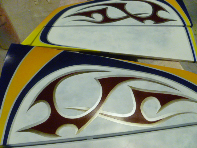

Background needs to be cleaned up, drop shadow painted under graphic and highlights on the graphic.
MTK 01-10-2016 10:01 PM
Pat,
Your shading with black or grey then coming back with white in the center of some lines, gives them a tubular or rounded look. I see why you insist on a good quality airbrush.
The only gun I have is a decent quality HVLP touch up gun, but an airbrush is a must for this type of detail.
Beautiful work
Portlandflyer 01-10-2016 10:54 PM
Matt,
Great eye. I was wondering if anyone ways going to pick up on that! :D
Actually it's easier than it looks. I am using thinned down black only....no white. Interestingly if you shoot white over the silver, it actually looks like a dark line or spot...really ugly. Here is how it's done. Take a look at the close up photos of the wing and you will see all I have done is kept the thinned down black shading close to the 1/8 inch bevel. In other words I am shooting black on only the upper half of the 1/4 inch band (bevel) and leaving the lower part silver. It plays a trick on the eye that the unpainted part is catching the light and it looks concave. The 1/8 inch bevel is too thin so I just shoot it with solid black, but keep in mind I am only shading the black, so the silver still shows through.
All shading should be with transparent paints so the under color shows through, so you would never want to use grey as grey is made by adding white to black so it would become opaque which you would never want as it would just look muddy (dark). That's also, why you would never shade with white for the same reason.
Now the highlight spots shot on the bevels that look white are actually three different layers. Again if you just shoot white on the silver it will look like a dark spot. Remember white is an opaque. What I do for the highlights is shoot a heavy coat of white followed by a dusting of white pearl and then just a dusting of the same silver (Metalume) over the pearl. It just takes a few seconds to do. When you do it this way, when the sun actually hits those highlight spots, they kind of glow, due to the pearl.
Like I said before, most of this stuff is a lot simpler than it looks. All you have to do is give the brain a piece of the puzzle and it fills in the balance.
Just like shooting the AUSTRAL letters, It's all an allusion, If we paint black on the side of the light (direction of light), and white on the other side, it tricks the brain to think it's concave. If we do the opposite, it appears to be convex.
Yes, all the little shading must be done with an airbrush. The good thing is, we don't need high dollar brushes to do a great job. It's not the brush, it's the guy behind it.
Portlandflyer 01-10-2016 11:19 PM
1 Attachment(s)
Here is a side view of the bevel. If we keep the black on the upper part it looks concave. If we paint the black low on the bevel, it appears to be convex.
