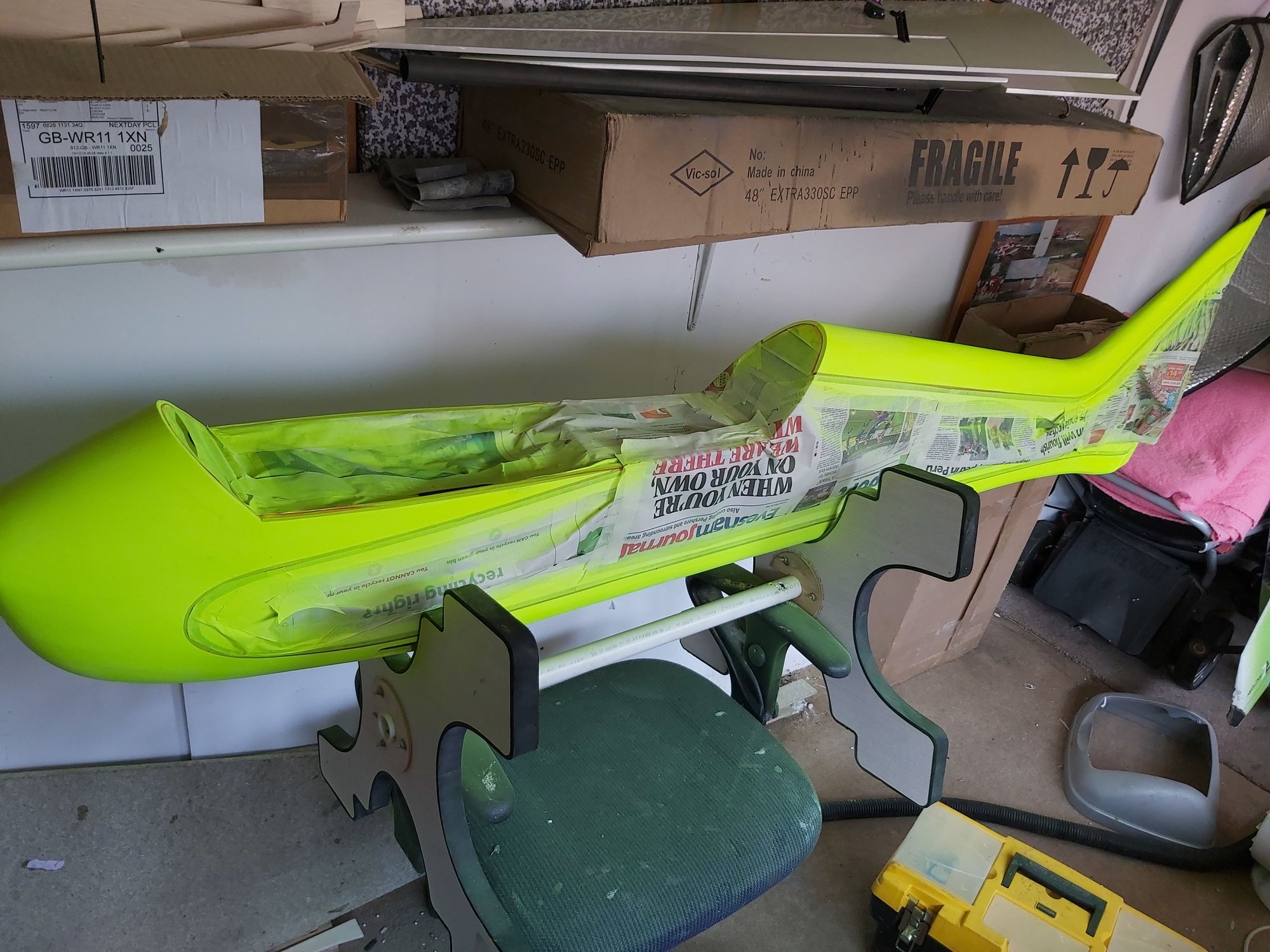

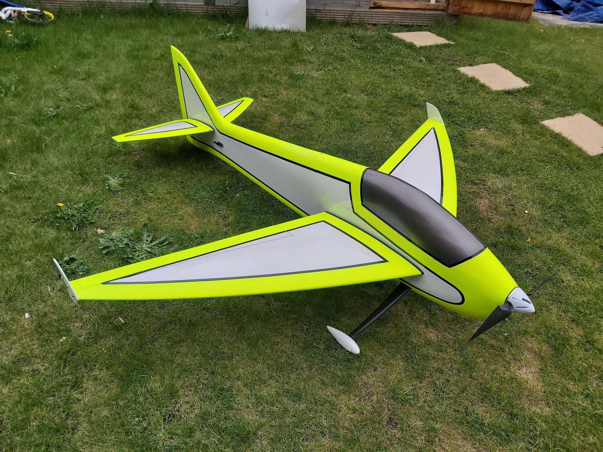

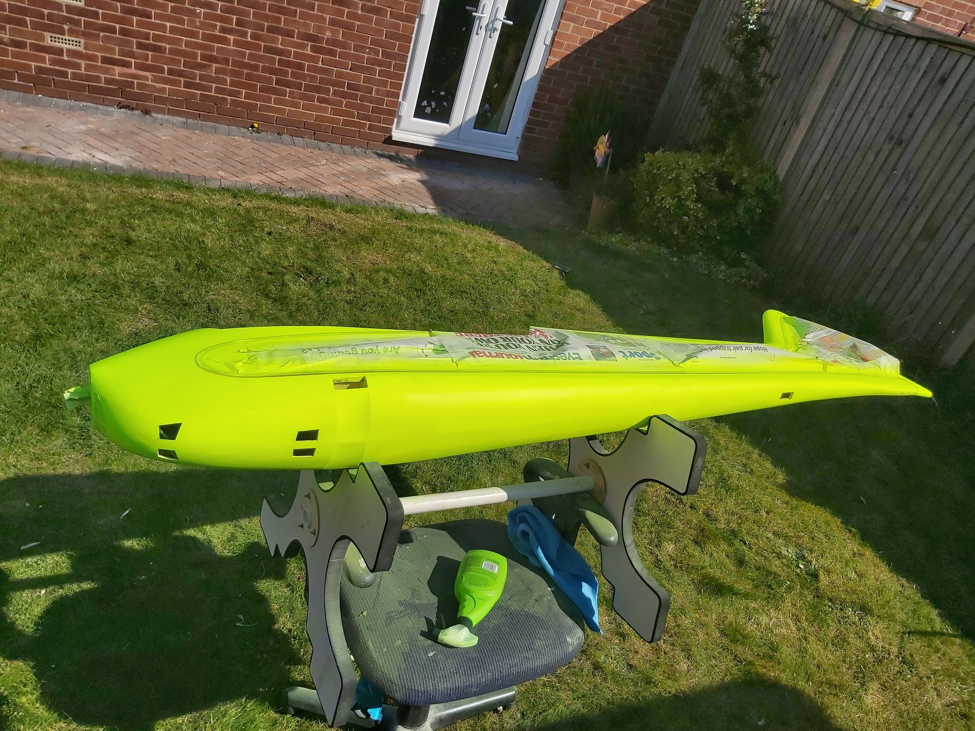

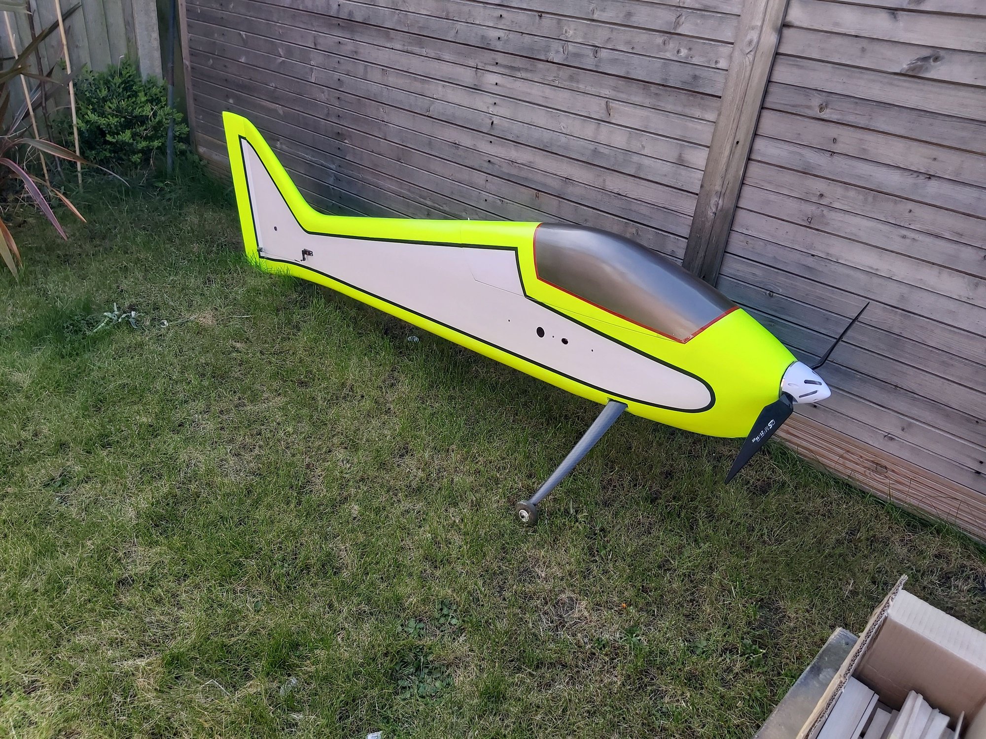

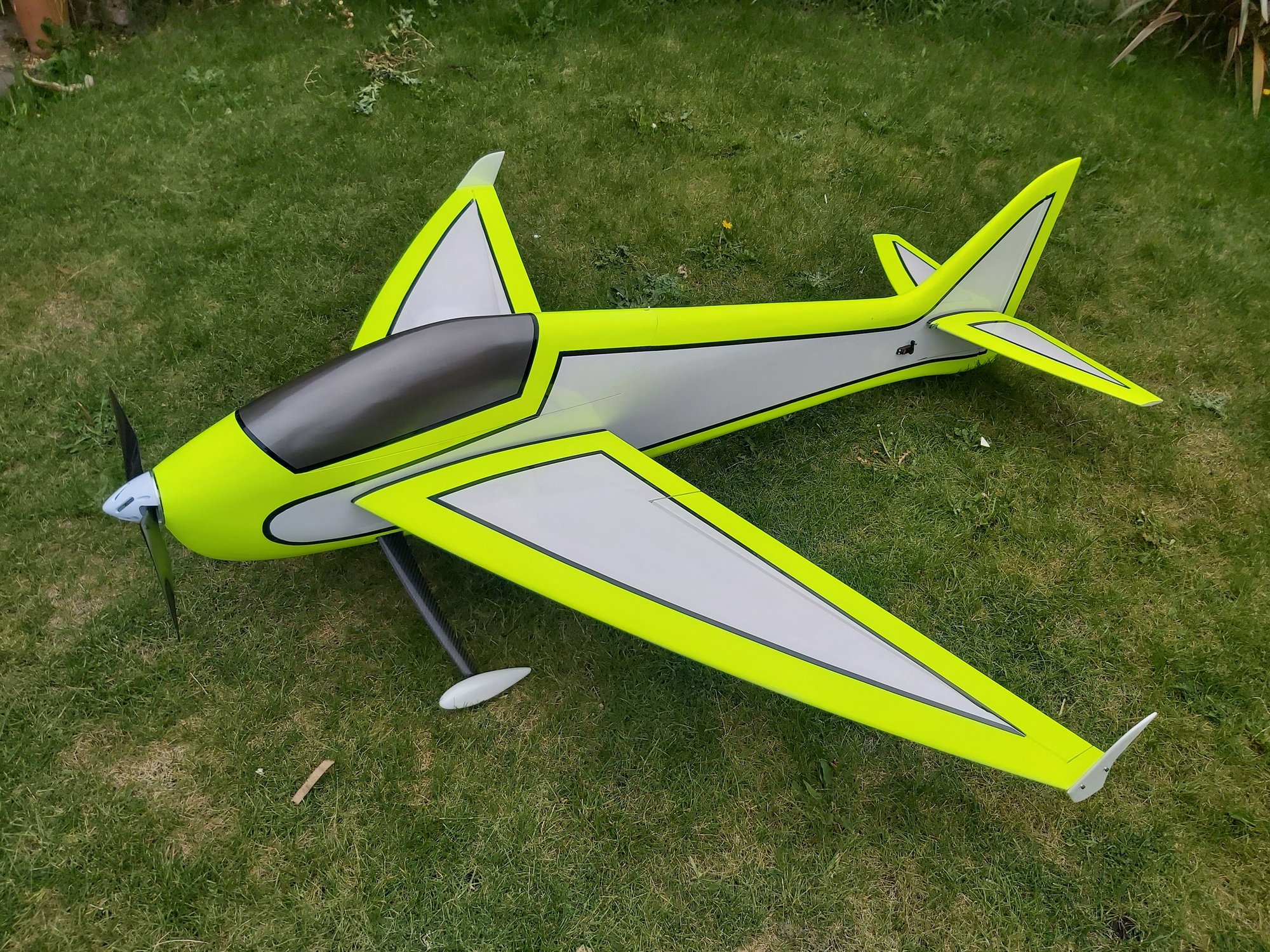

workers 05-06-2020 12:14 AM
Its finished now. Its all sprayed up and ready to go.
Im pleased with how its come out, it was a bit of a learning curve as i've done minimal spraying in the past and i was spraying onto covering.
I made sure the covering (easycote) was properly ironed down because if i wrinkles in the sun there is no way to iron it back down with the paint on.
I started with the fuselage, all the black was put on first to outline the design then masked up. I made the mistake of using 3m tape and not testing it as it bled a lot, its not that noticable but a bit annoying. I rubbed all the white with a scotchbrite pad to key it and cleaned it degreaser.
I do have a compressor for spraying but thought i'd get a couple of cans from halfords first to experiment, they worked well enough for me i just did the whole model with them.
I used insulation tape to mask up the wings, it worked much better leaving a nice crisp line, bit trickier to put on its quite flexible and harder to keep straight.
So overall i'm happy, how well it will hold up though is another matter!
