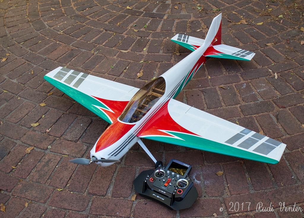

Rudix 08-23-2017 05:27 AM
1 Attachment(s)
I have now assembled the Angel and I must say I am really happy with the quality of the Sebart kit.
Attachment 2229139
I have now also acquired a Sebart MythoS 50e and a MythoS 125, thanks for these great planes Sebart!
