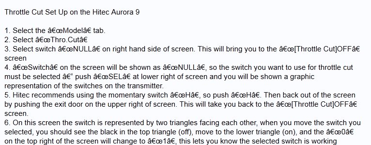

Maybe it is my computer, but the instructions have a lot of characters around some words or phrases that make it confusing to read.
I took out all of these to make it easier to read for anyone else having the same issue.
I have included part of the original instructions to see what I had before edit.
I saved it as a .txt file, so use word wrap when viewing or printing.
Wayne...thanks for taking the time to post this.
