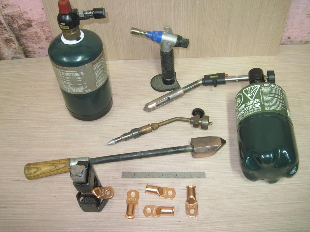

This is my experience and opinion only and works well for me. Others may have a different way of doing things I will be the first to tell you I am self taught and by no means an expert.
Soldering, do not use the same irons for acid flux that you use for rosin flux. I even keep my supplies in separate containers and the irons separately as well.
Acid flux is associated with mechanical joints like landing gear wire and sheet metal connections. Usually these irons have a higher working temperature because the areas they must heat are larger.
Electrical connections range from very small like ultra light servo wires and pc board work to heavier wire for large batteries. You will need a few soldering irons to easily do these multiple jobs or you can invest in an adjustable soldering station. I have found soldering guns a poor choice.
An open flame directly on an electrical joint is a poor choice as the flux burns quite easy and will contaminate the joint. In the case of very large wire and heavy lugs you can heat the outside of the lug without getting the flame on the joint but you still have to watch the temp that you do not overheat it and set the flux on fire.
An open flame on a mechanical joint works well you just need to practice to get the right technique of applying the flame to the work. If I can I still prefer to use a soldering iron and I have made up a few that fit on the end of a torch.
I have a separate soldering system for the tabs on lipo batteries. It is a liquid flux and a special soldering wire for the aluminum tabs. Because I am not sure if this is an acid flux or what it is I have a separate soldering iron I use for just this purpose.
As you can see I am fussy about not cross contaminating my soldering stuff between applications. Especially with electronics contamination can cause failures that could result in loss of connection.
This first picture is my mechanical soldering tools some of which can be used for soldering the large copper lugs shown in the picture. When I do this if I am using an iron I will completely clean the tip of all solder/flux from any mechanical soldering applications so it will not contaminate the electrical connection. If I am using an open flame the flame is played on the outside of the lug. Two torches one propane one butane. Then you see two home made tips that fit on propane torch heads. These get hot enough for just about any job and work exceptionally well soldering up to 3/8 wire for landing gear. The bottom soldering iron is a large head that is placed in a flame and the head retains enough heat to do the job. I use these for mechanical joints but after cleaning I have used them to solder the large lugs in the picture. First the wire is crimped using the crimping tool to the left then heat is applied to the outside and the solder is fed down and inside the lug.

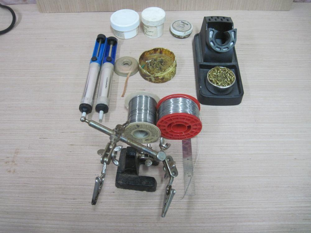

Some handy and some necessary supplies left to right across the top then down.
Two de-soldering vacuum syringes press the button and it will suck the solder from the joint releasing the wire/part from the joint. The three containers across the top are tinning agents for the tip of your soldering iron. On the right hand side is a soldering stand with a brass wool tip cleaner. It does a better job if you stab the brass wool with the iron before heating your connection. A clean tip offers better heat transfer. Rosin paste to facilitate a good solder joint and copper braid used for absorbing excess solder. Two thicknesses of solder and last is a third hand to help hold what you are soldering.
When you are soldering or tinning a wire the heat should be applied to one side of the wire then the solder to the other side. When the wire becomes hot enough the solder will flow along and through the whole joint. The finished solder joint should be smooth, bright and shiny. When soldering Deans type connectors make sure you plug them together it will act as a heat sink and keep the connector from melting. With EC style connectors I have a wooden block that I can push the connector into standing it upright. I tin the wire and heat the outside of the connector filling up the cavity about 2/3 full with solder. Keep the heat on the connector to keep the solder fluid insert the tinned wire into the cavity. Keep the heat on for just a bit longer then remove and let set up. The joint should be smooth and shiny with no solder slop on the outside.
