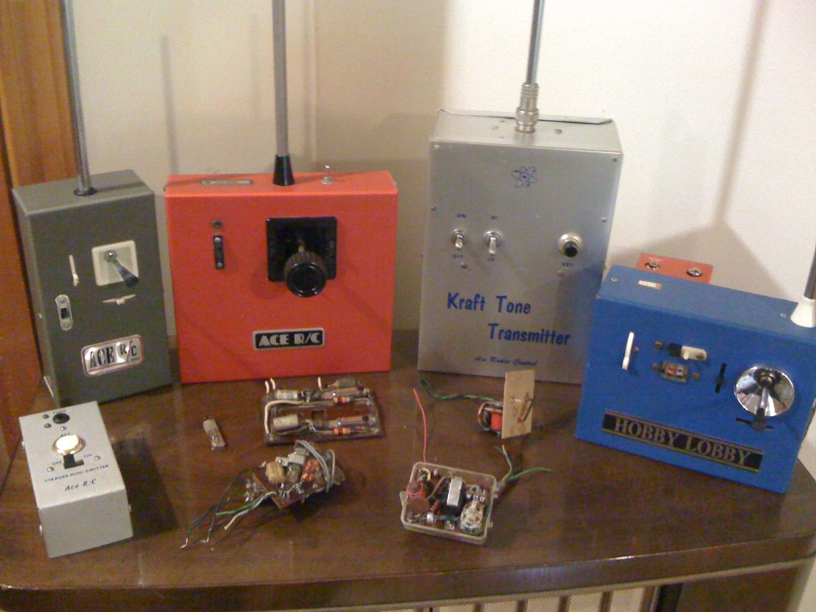

Originally Posted by init4fun
While I keep a dozen or so of my old favorites around for nostalgia, I only fly with modern up to date radio equipment. At some point it's gotta be more about what's best for safety than about nostalgia.
ok..I gotta ask..what in the world did the Kraft tone control?

ok..I gotta ask..what in the world did the Kraft tone control?.....
Hi Txmustangflyer, Welcome back !
The Kraft tone controlled a "tailwagger" , an RC plane that had rudder control only. In the beginnings of RC it was more or less of a way to "suggest" that an otherwise free flight model would (hopefully) stay within the confines of the field it was being flown at. The single button control triggered an "Escapement" that got it's physical power from a wound rubber band and would wag the rudder left or right. One push of the button gave a left turn and once the button was pushed and a left input happened the next push would give a right turn. Both the TX and RX are vacuum tube units requiring multiple batteries, kinda wild how far we've come since the 1950s, that's for sure
This pic is not my plane, all of my planes of that vintage are long gone, but is a great representation of what they looked like way back when........
