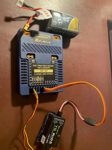

Thanks, Tony. I was able to get it to work by making Pin10 Sbus Out and connecting to RX1 in, and Pin9 S.Port and connecting to RX1S.P. I now can access the RB-30 under Device Config and get appropriate responses from out channels, and the gyro is active.

I really appreciate your help on this, Tony, because this system is going into a $5K jet. Here's the advice I got from "mawZ" on RCGroups"
IN general the procedure is:
1. Register and Bind your receiver(s)
2. Plug each receiver in use into the relevant Sbus and S.Port plugs
3. Power everything on and then go to Model->Telemetry and discover sensors. Check that the RB-30+ sensors are there.
4. Now you can do the setup from the Device Config menus. Note for the Gyro use the SxR calibration and SxR menus for setup
Make sure your ports are set correctly on the TD R10, Pin10 needs to be Sbus Out in this configuration.
Id suggest setting Pin9 to S.Port and wiring that into the RB-30+ RX1 S.P connector instead of the 4-pin header on the other end.
My response:
That seemed to do the trick! By making Pin10 Sbus Out and connecting to RX1 in, and Pin9 S.Port and connecting to RX1S.P., I now can access the RB-30 under Device Config and get appropriate responses from out channels, and the gyro is active.
It also looks like I can connect Pin10 to "RX3/SBUS OUT" and Pin9 to "S.PORT" and get the same response. Is one preferred over the other?
Thanks so much for your help!

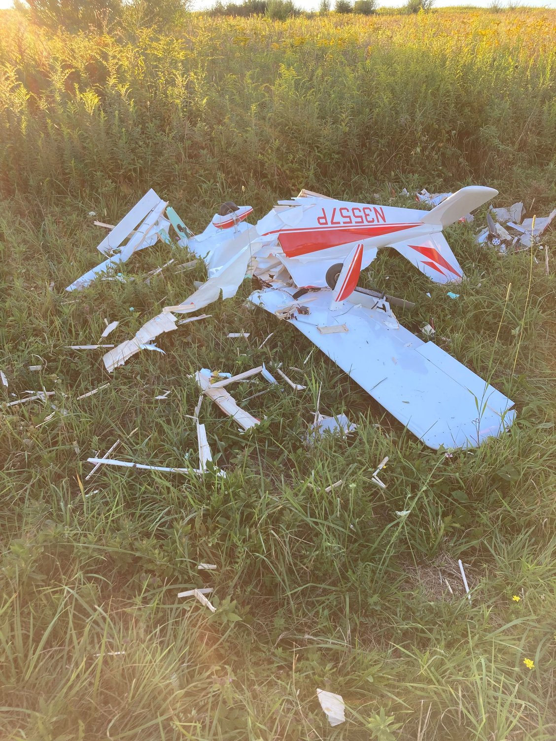

Mawz is the man, knows his stuff. Not sure why I had it in my mind that you were using a SR10 receiver. I see now it is a TD. I'll stand by what I said about channel 10, my results are shown below. You can use two TDR6 receivers as redundant, plug them into RX2 and RX3 and joint the Smart port wires and plug into the RB30+. This would provide a triple double redundant setup. Probably overkill. Use RX1 as I am fairly certain it is the main receiver and SBUS signals from RX 2 and 3 are used during fail over. I would use two receivers as even though the TD is redundant, you still have a single point failure of the the SBUS connection
