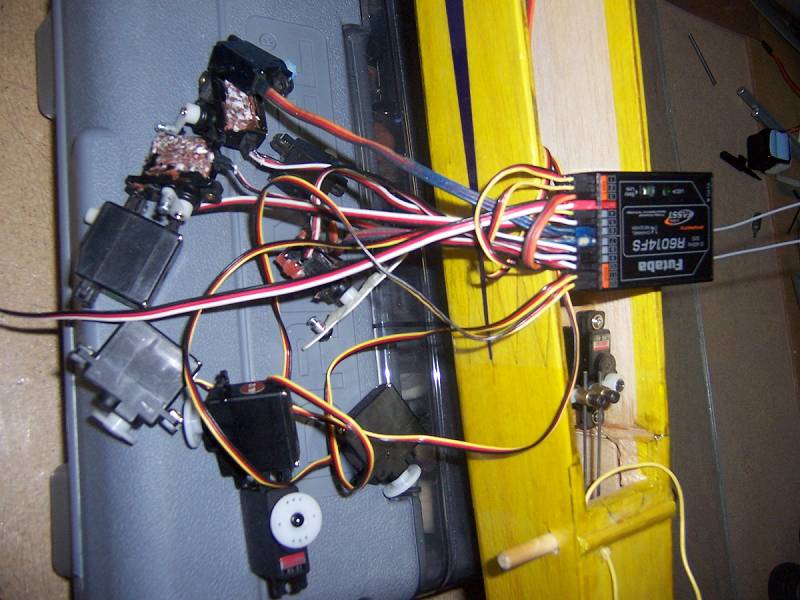

Powered up the RX with 12 mini-standard servos in, these are not blazing fast, HS-81, Hobbico CS-11, JR NES241, GWS naro and finally Futaba 9201, 9152's. I will test again with 8 - HS5955TG's in a 36% plane with DA100 running and smoke pump on tomorrow.
The rx just blinked green at me, it was not binded.
I had to bind the RX to the TX, very simple push the button for 2-3 seconds and all done. worked flawlessly.
Nice leds, easy to see for quick indicator. WIll check in bright daylight if not cloudy or gloomy tomorrow.
RX binded now (CA anyone?) and it was off to the races.
Did the wiggle test, all servos moving smooth and nice.
Executed the servo movement test. All servos moving smooth and not jerky.
Everything works as expected.

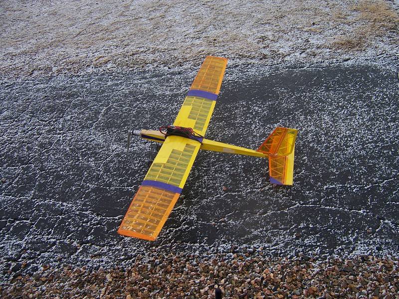

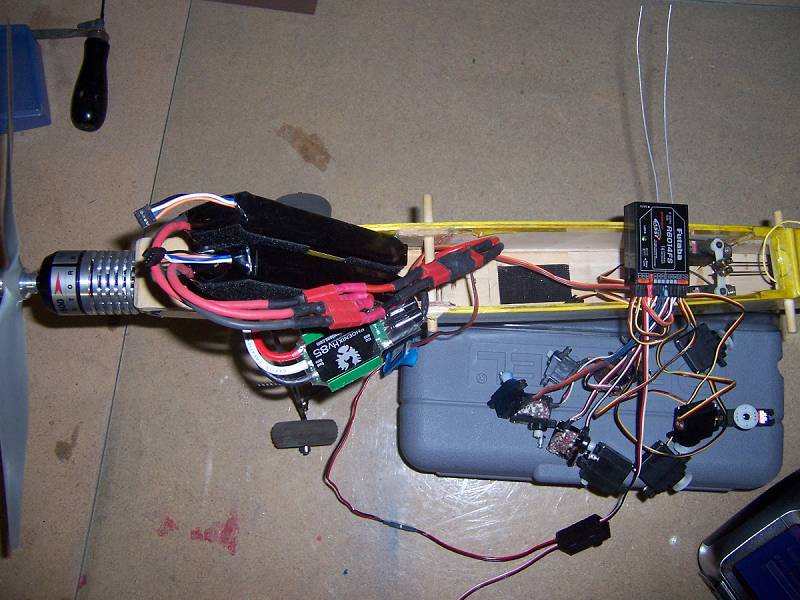

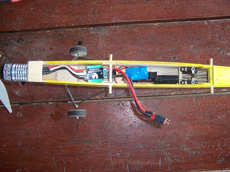

The first test bed, Gentle lady electric glider with PJS1500, custom heatsink motor mount, APC13x7, CC85HV, Medusa 3.5A reg and with 11 extra servos moving also.
Ground check.
Test run full-moving throttle LOOK 87AMPS at 25Volts = 2100+ WATTS of stupid power, the RX is within 7-8 inches of everything and works fine even with the range check test at ~30 feet.
Ran the servo test and let it do it's thing for ~2 minutes, warmed up the motor and heat sink. I had to stop, I burnt one motor up already due to brass balls. Racing my electric gentle lady glider against a 46 gas pattern plane. He beat me in the turns but not on the straight. I had the wing tips flapping like ??? on the straights. The motor let the smoke out on the last leg.
The setup works as advertized.
First flight.
Got in one short 7 minute flight on the hill side here. First time I flew in the open park spaces.
No problems, hard to tell the latency with the glider, but no glitches. only running 3 channels.

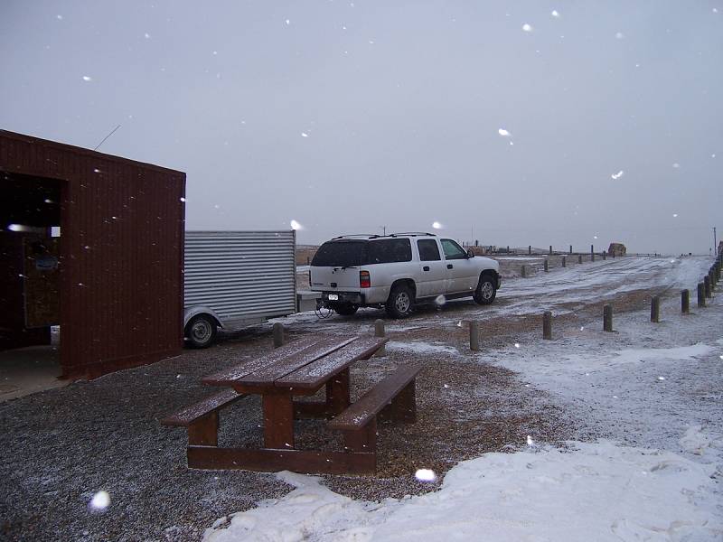

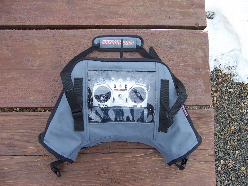

I got in 3+ solid hours of ROCK solid flying in this morning. That's actual flight time counted when wheels leave the ground to touching for landing.
28F, windy and rain-snowing ocassionally. Snow is bad for 2.4GHZ freq as it reduces the signal, same as satellite TV. Used the RAYDIOWARM TX glove to protect the TX and keep it and hands warm.
2+hours of flight time in the glider and 1 hour flight time in the Banchee. Used two TX batteries up on this
day out flying.
Charging batteries as fast as the triton and tp1010c could.
Go up come down change batteries and go up again and repeat for a little over 3.5 hours of time.
I had to sit in the truck with the heater on a few times to warm my feet.
Flying in the snow with the glider as high as I could see it and no issues.

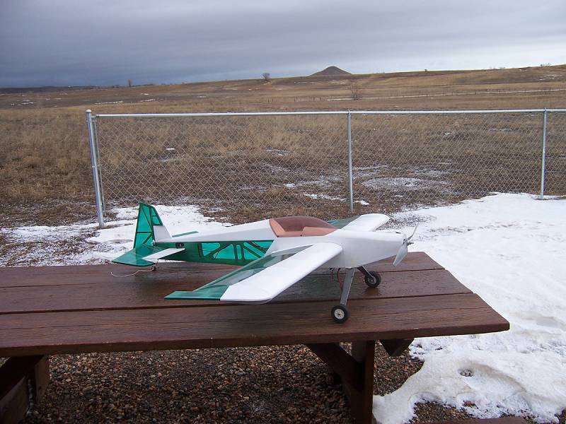

Flying the Banchee I did notice a quicker stick to servo-plane movement, controls were quick and responsive. I am only a casual flyer and I can tell, so a hot shot should be able to critic more.

The white spots in one of the pictures is snow.

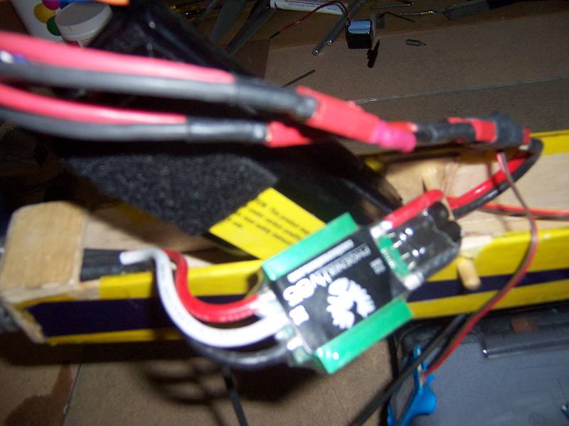

The RX is next to the servos, Medusa 3.5A reg and CC85HV speed controller exactly as shown in the picture.
