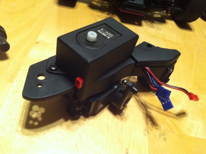

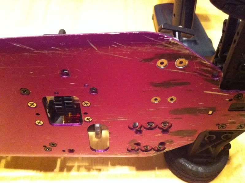

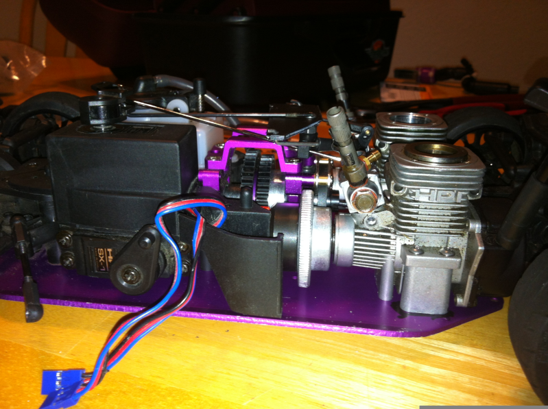

ive started working on my twin engine build. does anyone know of anyone else that has attempted or completed this build before?
here are some pics of my progress.

Won't the engines be battling themselves trying to turn the drivetrain different ways, or was something internally flipped to make them work together?

I had to think about this one for a min, but you are right. motors would have to spin oposing direction.

No they don't they will be spinning the spur gear in the same direction.
You have them setup fine, both engines spin clockwise from the rear, spinning the spur in the same direction.

thanks for drawing the picture. thats what i was going to do. yep this setup will work. i figured out how to run the linkage also. ill post pics tonight. im also going with the nitro star t3.0 engines. got the first one in yesterday. waitin on the other.

yes I was thinking about this again on my drive home from work, and as the drawing shows, the motor setup is right. Brain fart on my end. Synchronizing the carbs will still be a challenge. I have faith tho. Challenge #2 will be routing the exhaust for the new motor. I can't wait to see a video of this one running around!

Think about it. Engines mounted on either side of a driven gear need to turn in the same direction. One engine (left side) drives off the up rotation the other (right side) drives off the down rotation. They will not fight each other but will turn the driven gear easily.
