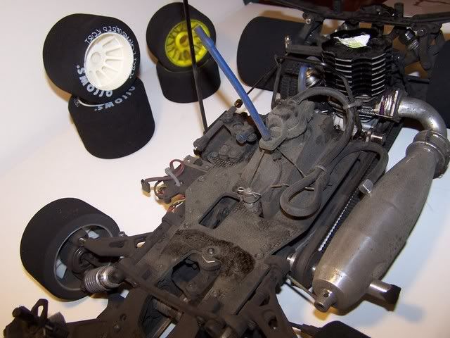

Ok, I hope everybody is ready for this...
I wish the car would always stay clean, but I did not buy it to become a shelf queen. It is very rare any of my cars go the shelf route.
All this happened in a relatively clean parking lot area. I had much better luck this time, the surface has plenty of grip and is not that dusty after all. There was a spot here and there, but next time I will bring a broom and dust pan to clean up some areas. Overall it was one of my best days so far, a few scuffs happened now and then since I am still getting use to the car and the new place I just found.
The O.S. .21 is no speed demon, its ideal for me. Easy to tune, very reliable; I would say its the easiest to tune from the many low budget engines I have had so far. Currently running 20% Traxxas, temperatures are in the 200 to 245 range depending on temp of the day and how hard I go WOT.
If you notice, the rear belt is a little bit scratched, a pebble got stock and shred just slightly the outer surface. I will buy one ot two next week. Also, in the rear it has some scratches right on the tail because I did not see a small piece of pebble when it was doing about 40mph and the car went airborne doing a wheelie (scary as hell), I let go of the throttle and gravity did its part. Once it hit ground a punched it and went straight like a rocket.
The new Power Racing tuned pipe is awesome, sounds super sweet and delivers a good punch overall somewhat in the midrange side.
About 1/4 to 1/2 an inch was cut from the wing, for me it was dragging to much and holding the car on top end. The way it is right now it has good downforce and still maintain consistent high speed passes.
I do like the car, the little things that have happened to it is because I have been careless and I am not running it on the best locations. Right now I am practicing on my power slide which is almost like drifiting so I can go faster on turns. I am thinking of making a hole on the front windshield of the car for ventilation, but dont know if it is recommended or not. this XR8 body does not expose the crown like the Lolas. I have had a blast so far, now comes the bad part, cleaning all the parking lot dust. The engine has after run oil so maybe I will clean it some day next week. About the tire truer I am thinking about it, I dont race because here is super lame the R/C environment. All the racing happens south of San Francisco, San Jose, and its about a 2 hour drive. I ask about the tire truer cause I did not want to spend all that cash if for me it was not that necessary.

Nice! Sounds like a riot...I'm not a fan of touring style bodies on 1/8th racers myself, but I see your point about the added protection. You should DEFINITELY cut a large hole in the front and rear windows to aid ventilation, but that's going to make your dirt problem worse.
A tyre truer is a great purchase and they are expensive, so if you have the opportunity to get one cheap, go for it.
Powersliding...hmmm, well, I'm gonna have to be a grandfather here and kill your joy. Firstly, you will EAT rear tyres doing that, and it really isn't the fastest way around a corner (though I understand that you are not racing and therefore, you should do whatever gives you the most fun). However, I recommend you concentrate on developing your skills under traction. The main advantage of these cars is the extreme traction they provide, especially with a racing body on them.
Like I say though, fun is the important thing, and it sounds like you're having plenty!

psi i had the same problem with the rear belt, pebbles getting caught up and shredded my belt. i took
that back piece off and dremeled it out some to allow the pebbles to pass thru freely. as for motors i
found a cheap onroad motor at hobby people. for a 133.00 i figured i would try it. the power and speed
surprised me for the cost. a friend is running the mega motor and for the most part my cheapo motor is
running with him. im just bashing, dont want to break the bank

The rear belt cracked from a small pebble. I got to dremmel the back so it does not happen anymore. Today I received the new belt from Larrys and by the way ordered spare plastic gears, side and front belt, centax clutch shoe etc.
The Porsche body resulted to be a bummer, they did not have it in stock.
