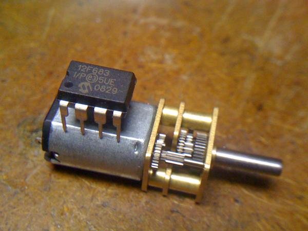

Well, after having given up on Lado... ([link]http://www.rcuniverse.com/forum/m_8425919/anchors_8425919/mpage_1/key_/anchor/tm.htm#8425919[/link]) ,the DIY guy that I am... I designed my own DIY version last night...
Here's a vid of the first prototype.... used a miniature 50:1 gear motor attached to a pc. of 4-40 threaded rod that pushes/pulls the existing mechanism of an older (Hobbico?) servo-operated retract mechanism. My next project will be retrofit actuators for my Robart 630 retracts (easier actually)... but still awaiting a few custom couplers my Dad is machining for me... Next task is to design the controlling electronics (will use a 8-pin PIC interfaced to an H-bridge with current sensing circuitry to sense end positions... no limit switches needed). Might soon be looking for a CNC manufacturer! [8D]

Hey... I'm curious.... how many of you would rather retrofit existing air/servo-controller retracts (i.e. Robart, Century, etc...) with an actuator replacement (remove air cylinder & replace with electric actuator).... rather than buying a complete set that is electrified? Just trying to see if there is a market/need for just the actuators.
If any one also has any comments/suggestions... please reply.

Looks good so far...just don't forget to add a torque limiter or such so that if the gear do hang up somehow, they shut down rather than burn out...or is that what you mean when you mention a current sensing circuit?

Yes.... my idea of a current sensor (built into H-bridge chip I plan to use) will hopefully allow me to sense increase current at both ends of throw... motor would hence stop automatically. It would also stop any time it senses an increase in current due to unexpected binding (i.e. obstacle). I ordered a sample chip ([link=http://www.freescale.com/webapp/sps/site/prod_summary.jsp?code=MC33887&fsrch=1]Freescale MC33887[/link]) and will experiment more when it comes in. Some PIC code will also have to be written but should not be all too difficult... so I hope!
Right now, I'm thinking of seperating the controller from the mechanism... not only to save space in/on the retract, but to also protect the controller from the elements, sheilding it inside the aircraft. Plus it probably wouldn't be too hard to have one servo controller board control MANY servos for various applications (maybe even with onboard options such as speed, stagger, delay, etc... functions). I also pondered the idea of auto retracts where when the aircraft (controller) senses altitude (via sensor) and when a preset altitude is reached, the retracts automatically are triggered, bringing up the gear.
I am more of a small DIY parts guy (supply small elec gadgets, kit parts, etc...) so if any one else is interested is a possible partnership of some type... please PM.

These gear motors I'm using are built will all-metal gears... and tiny as heck (but alot of torque)

They look a lot like the old, what we used to call J250s motors. <orig app electric shavers I think> Had a bucket full of them at one time =)

So whats a motor gear box unit like that cost and where do you get one?
The key element here is going to be the electronics I think.
Lots of guys could do their own motor gear box mods - if they had a source for the parts.
The electronics will stump most of us though.
Probably the majority will want a plug-n-play setup though.

$18.99 Robot Marketplace
http://www.robotmarketplace.com/products/IL-SAN50.html
There are cheaper suppliers if you want to buy in bulk. Its a fairly common antweight (combat robot class) drive motor. Different gear reductions are available.
For the electronics, just dismantle a standard size servo. Remove the motor and wire in the new gearhead motor. Remove the potentiometer and wire in a new 5k linear potentiometer that is attached to the nut of the retract mechanism. Seal the servo board with heatshrink and some hot glue. Instant proportional retract mechanism that can plug right into your receiver. You can program the endpoints with your transmitter.

The gear motor is manufactured by Sanyo. Part number 12GN-0348. You may search for "12mm gear reduction motor" to find similar products.

Im not sure Im following you on the servo parts use. These are going to need to turn several full 360 degree revolutions to go from UP to DOWN.
Oh wait - thats what the linear pot is for?
If Im understanding you thats a cool suggestion!
That would work well for everything except the gear getting jammed. A current sensor would still be needed I think. Or at least a nice addition.

Yup... you guys are right... Sanyo gear motors they are, with a 50:1 ratio. This allows me to spin my 4-40 rod (that drives the retract actuator) at such a speed that it takes roughly 4-5 seconds to retract or deploy... Many Robotics outfits sell them.... and the ones I have were purchased from Pololu.com
As for the electronics, you certainly could use scrap servo parts but there is really no reason to make these "proportional", using a feedback pot. To sense limits, I plan to use the increase in current when it reaches both ends, rather that limit switches and/or a feedback pot. Attaching a potentiometer to this mechanism is not all that easy either... look at my setup and you'll see what I mean... no easy way to connect to the nut being driven my the threaded rod.

Well... I was able to easily modify one of my large-scale Robart retracts to operate electrically rather than via air....
Here's the first vid..... works amazingly well for a large/heavy gear mechanism... that's a 4" wheel there... (this was pulled from my 1/4 scale A6M5 Zero).... can't wait to start working the electronics....
