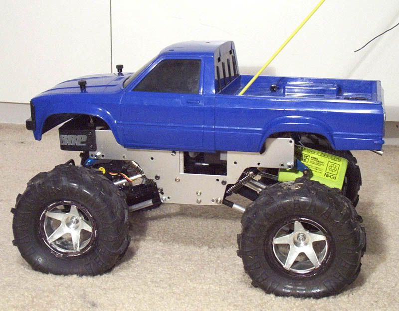

Hey check out this Crawling Video! There is only 1 Rig in it (Black w/Yellow Flames Clod) thats not a TLT running a Stampede Tranny in a Bulu Chassis[link=http://www.rcuniverse.com/forum/m_3037439/tm.htm]"TLT-Circus Vid"[/link] Most of these Trucks are between 12 & 13", running Masher 2000 2.2 tires, Traxxas Drivelines, Lathe Motors, Traxxas links(for 4-link suspension links) or Booty fabbed themselves a 40/60 link setup, Smaller Batterys like GP1100's or Mini-t packs, 3.5-4" shocks(no cantilevers). You don't have to have a BULU Chassis, but it is a Super Tough Chassis and Works Amazingly Well. You can cut off the Bottom of your Stock Chassis and it will be night and day difference.
Here is a pic of my Bulu Chassis TLT
Here is my old TLT With the Cut Chassis
Hope this helps.
