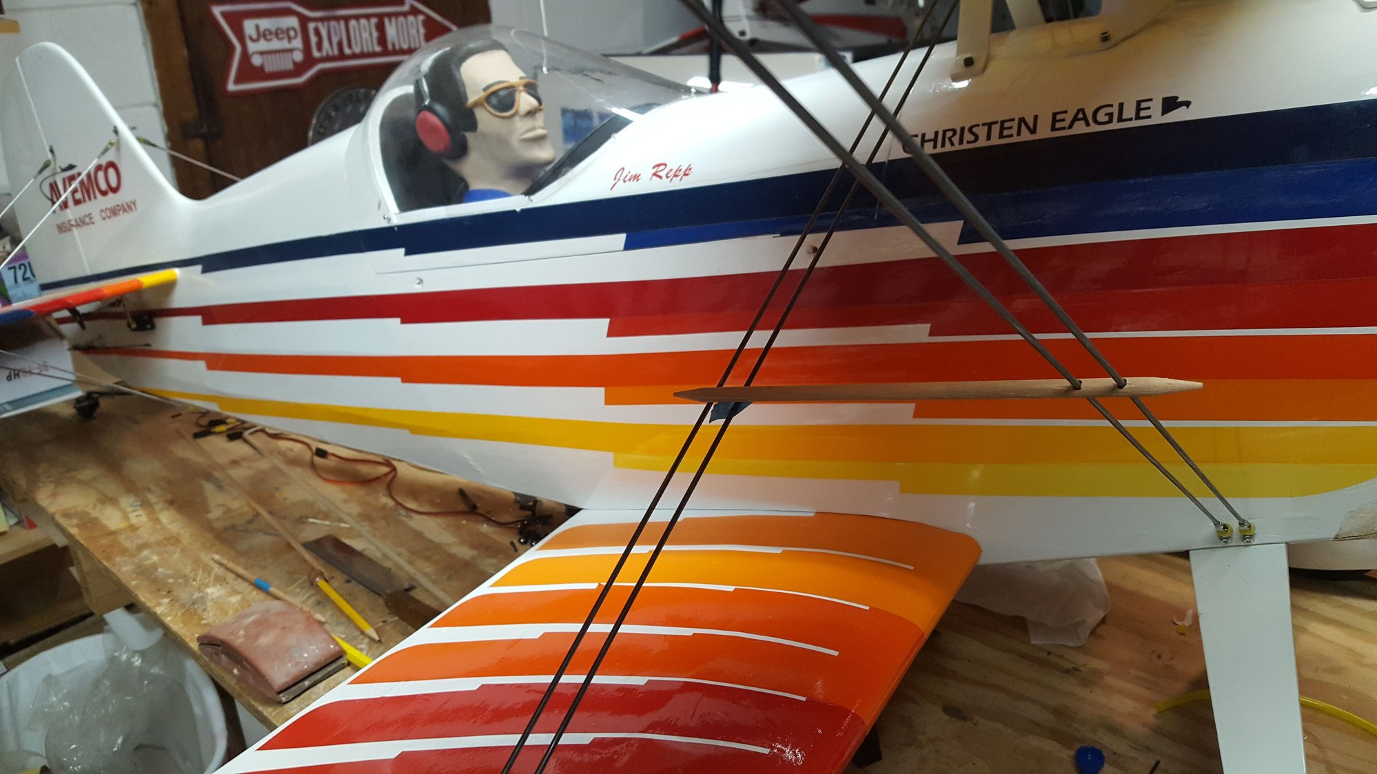

After much searching ... decided no canopy can be found. So I made one fit. This is a much cut down Corsair canopy

A little more detailing and added pilot.

Added flying wires this time as well. These are actually functional. Made from 4-40 rod. Used a swivel mount on bottom of top wing. Why? So wires can fold up to wing for transport and storage. Had to add hardpoint attachments as well

lots of messing around to get wires right. The flying wires are connected by a rod. Thats a dowl drilled through on the front two wires. The rear wires snap on so its easy to remove and swing wires up to wing for storage

Here is the rod painted up and installed. Next? Figure out how I want to handle mufflers in the new engine.

Just clarify.. the first plane was essentially destroyed. Totally my fault, dont tumble at low altitude without power to pull out. This is a full rebuild, but used parts of the original plane. Like the tail.. and engine box.

Canopy tinting and installation complete. Radio, switch, and battery all installed and programmed. Ready. Well.... mostly. Just need the mufflers and I can finish it off. But, basically ready to fly. Again!
